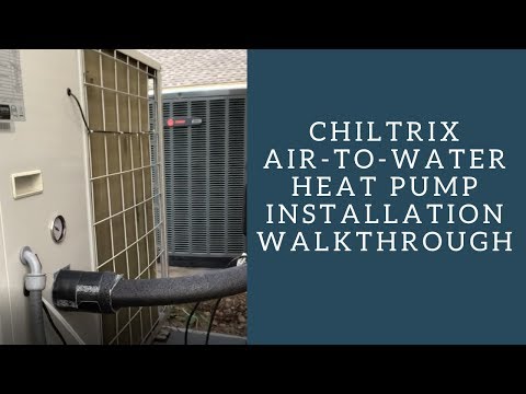

I realize this is an old thread but I purchased a Chiltrix CX-34 Spring of 2018. It has been running for about a year now so I've got some experience in both hot and cold weather. I'm in Fort Worth Texas so cold is 20 degrees Fahrenheit during the day
Caveat, this is a retro-fit not a new home installation. So it is currently trying to condition a leaky home from 1976 with arguably more windows than wall (single pane at that). Still working on sealing and insulating the house better. Our downstairs is 2900sqft but we had the doors closed off to about half of that during the summer. The unit kept up just fine on two indoor FCU's (12kbtu and 8.5kbtu). For the winter we added the master bedroom which is another ~600sqft. There was a day or two when it got down below freezing (teens at night) and couldn't keep the house at 68 where we have the units set. This is with it trying to heat about 2000sqft.
I have uploaded a couple of videos to youtube and intend to upload more if you want to check them out.
General explanation of how I installed my system:
https://www.youtube.com/watch?v=Ti-8542K7ZU

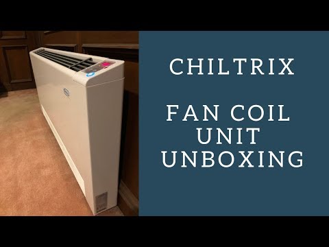

A look at one of the FCU's:
https://www.youtube.com/watch?v=f_ARpll6WZw

Good to hear these things work well. Like all heat pumps, below 20F NET capacity falls off fast as defrost consumes a lot of capacity and hurts efficiency. Conventional heat pumps need some sort of AUX around that point to keep up unless oversized substantially.
