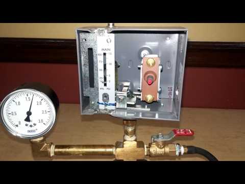

Here is a link to a YouTube clip of a custom rig for testing Honeywell Pressuretrols. If you have any questions, please ask!
https://www.youtube.com/watch?v=3vceuKfVg9w

    Gordo, is that squeeze bulb from a blood pressure monitor?
    You've got me thinking that I can re-purpose an old blood pressure tester (without the cuff, of course) to check my own pressuretrols.
  • Gordo
    Gordo Member Posts: 857
    @Chris_L : It is indeed the same type of squeeze bulb from an old style sphygmomanometer to be sure, but I got that particular one from a controls supply house that sells pneumatic hvac control testing equipment.
    Please do test your pressuretrols, we are finding that most of them are turning out to be way off.

    Here is my homeowner's version of your pro setup--made with a sphygmomanometer and some spare fittings.
    The pressuretrol is one I found on the street from a boiler that was being removed. The cut-out wasn't bad--1.55 psi with the cut-in set at 0.5 and the differential sat at the minimum (1 psi). But it didn't actually cut in until about 0.2 psi.
    For anyone who wants to try this, it would be better to use a low pressure gauge or a manometer than the gauge that comes with a sphygmomanometer if you want to measure below about 0.5 psi. Those gauges typically only read down to 20 mmHg (0.4 psi)
    (Remember, you want your steam pressure to be less than your blood pressure.)

    Here is a clip of what Mr. Gill is talking about.
    The setting on the control is 2psi, and it goes to nearly 3psi before it triggers. And this is the safety control.
    https://www.youtube.com/watch?v=mwLNeDeYW64

    3PSI gauge
  • Gordo
    @BobC: The old Hg bulb pressure controls were easy to see when they cycled, to be sure. And the older ones did seem to work better, overall.
    The one good thing about the new micro-switch vaporstats is they are much easier to adjust. It would be nice if the factory did it instead of us, because you void the warranty if you do.
    I wonder if that is their plan all along...

    Here is a better overall view of the tester:
    https://www.youtube.com/watch?v=mE1-QuUx4_c

    Mine is set all the way down to 0.5 with 1 cut out but it trips at 1.9 PSI.
  • Fred
    Fred Member Posts: 8,542
    You can fine tune/adjust the Pressuretrol by following this procedure:
    Inside the Pressuretrol, right below the micro switch, there is a pivot arm. At the end of that arm you will see a screw pin that is activated by the diaphragm at the bottom of the Pressuretrol. If you look very carefully at that screw pin, you will see it actually has a tiny (I mean tiny) hex head on it. It takes a .050 hex wrench and you can turn it clockwise (Towards the bottom of the Pressuretrol to decrease the Cut-out pressure or counter clockwise to increase the cut-out pressure (which none of us want to do but who knows, your Pressuretrol may be really screwed up!). Turn the power to the unit off first. You may find the first attempt to turn that screw a little bit stubborn (relatively speaking) because it has some Locktite on it but it does turn. Don't turn too much, a fraction of a turn goes a long way towards getting it adjusted where you want it (maybe 1/32 inch turn to start with). You may need to play with it to get it exactly where you want cut out to be.
    RomanGK_26986764589GordoLionA29

    There's a good chance 0.5 to 1 PSI is going to cause that model to not want to reset after it trips.
    For pressures that low you should really be using 4 PSI Vaporstat, not a 15 PSI control in my opinion.

    @ChrisJ : It sure does indeed happen that the Moneywell PA404A will not reliably reset when the pressure drops back, if you try to operate it at a cut-in much below 0.5 psi.
    A few cycles on the "healing bench" as shown above will test it out, however.
    They seem to be reasonably reliable at a tested cut-in of 0.5 psi. But you are certainly right to point out that is the bleeding edge of the control.
    However, the 4 psi vaporstat has issues, too.
    I have found in the past with the old Hg units that even the 4 psi vaporstat did not reset if you went to 1/2 psi! Really, really was annoying! I remember having to fiddle with the wires that went to the mercury bulb and lay them "just so" to get it to work right. Fun times.
    I have not tested a non-Hg 4 psi vaporstat yet.

    @Fred Thanks for your posts on calibrating the Pressuretrol. A year or two before I saw your earlier post on the subject, I tried a different approach--changing the tension spring normally used to adjust the cut-in pressure to a compression spring. (On two Pressuretrols I did this to, the cut-out was too high--almost 2 psi--even when the spring for adjusting the cut-in pressure was removed and the differential set to the minimum.
    With the setup shown, I could get the cut-out pressure down to about 1.2 psi, but the set-up was touchy. Removing and replacing the Pressuretrol would throw off the calibration.
    So after seeing Gordo's post, I decided to try the procedure you described while checking the results with my own version of Gordo's testing rig. With the thread locker used on these things, I could not turn the adjustment screw without fearing I would break the Allen wrench or strip the screw. I found that if I applied some heat near the screw pin with a soldering iron (removing it when I saw or smelled smoke) I could then turn the screw, but still with a lot of effort.
    The result was that I could get the cut-out pressure down to 1 to 1.1. psi with a cut-in about 0.2 psi. (I was trying to minimize the cut-out pressure, not calibrate to the scale).
    I did this on three Pressuretrols. I couldn't get the pressure down quite as low on the third one because the minimum differential was about 1.5 psi, not 1 psi as shown on the switch. In any case, I'll be using the two others this winter.
    I know a lot of people have commented on how inaccurate Pressuretrols are. I don't disagree, but the ones I've checked are very precise (repeatable.) The cut-out and cut-in pressures don't seem to vary by more than about an inch of water from cycle to cycle even if the actual values don't match the indicator. (Using Gordo's testing rig shows this.) So I am not worried that mine won't cut back in after cutting out. But I'll find out for sure in a few months.
