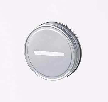

    Attached is a picture of the skimming port they set up. I presume they did this to be able to add some sort of cleaning agent/chemical? It does seem to be a 1.5" pipe and I have been getting sludgy gross stuff out of it from time to time, but for about the last week or so, it's mostly just had a very slight pinkish/reddish hue and no "chemically/oiley" smell like it did initially. (I also let some water sit in a glass jar for an hour to see if I could detect a sheen on the surface and never could...)
    The other thing I need to mention is that my background is in IT. Whenever people typically have a problem, I ask them to demonstrate so I can see for myself. 9/10 times, whatever they were doing suddenly works. I feel like this may have happened to me last night:
    I skimmed again last night before bed (as it would typically run fine for an hour and get the house warmed up before failing to reliably turn back on again until I did a "quick skim" in the morning.) Well, the darn thing ran fine all night long, keeping the house perfectly warm. I went down to check this morning and it was running just fine - the water was totally clear with no hint any sediment in the glass tube.
    Did I seriously fix this problem by simply posting it here? ;)
    (I will, of course, report back in a day or two if I find that last night was a fluke, but given that it DID work reliably all night long and is STILL working this morning, I am suspecting it WAS just dirty water after all, even though it feels like I moved a small lake's worth of water in and out of that thing over the last 2 weeks!)
    Haterasguy - I appreciate the alternative skimming tip - I may give that a try if I still find issues in the next day or two. Are you essentially suggesting a design something like this?
    (Albeit not actually a mason jar with a coin slot haha)

    Make it clear and you could monitor the water level more easily.
    2014 Weil Mclain EG-40
  • SWEI
    SWEI Member Posts: 7,356
    Why not cut a half moon out of the top, so you can see the water level (and potentially allow floaters to pass)?
    HatterasguyvaporvacSlamDunk
