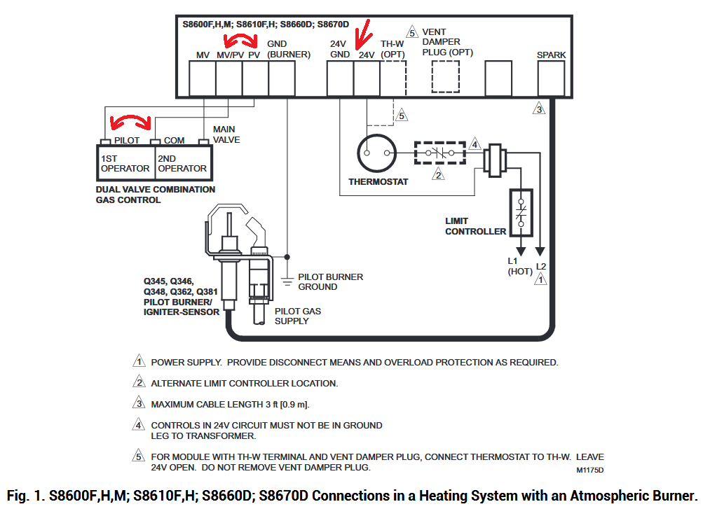

Sounds like no spark from the ignitor. Check the ignitor connections on both ends (maybe you have done that) and check the cable for any spots it may have rubbed on or dried out and cracked the insulation. Clean ignitor and check gap. Check ground from ignitor back to control. See the attached. It may not be the exact control you have but it is a universal replacement and all those controls are mostly the same as far a troubleshooting
Measuring from ground to the Spark terminal or the Spark electrode with your meter when Spark is expected is a bad idea, you may damage your meter or yourself, it is not made for that use (measuring High Voltage).
When the thermostat call for heat there should be 24 VAC between "24V GND" and "24V" terminals. Then there should be 24 VAC between "MV/PV" and "PV" and then to the Pilot valve terminals. With Pilot valve terminals energized the Spark should light the pilot. Once the Pilot flame is proven the Main Gas Valve will open. If all the 24 VAC mentioned above are present yet no Spark at the Spark electrode the High voltage wire can be tested with the Ohmmeter function of the meter. I believe the HV cable should be no higher than 1000 Ohms.
