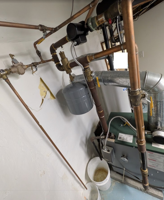

Peerless Boiler MI.05.SV.WPC-05 boiler. Non-condensing 115,000 DOE BTUs Natural Gas. Installed 2004
Cast iron radiators all in one zone with a circulator. Circulator is on the hot side, just after the expansion tank and automatic air bleeder
130degree recommended min return temp per boiler manual
Bypass with ball valve installed from just before return input to just after heater water output, before the expansion tank and circulator
There is no heated water storage tank

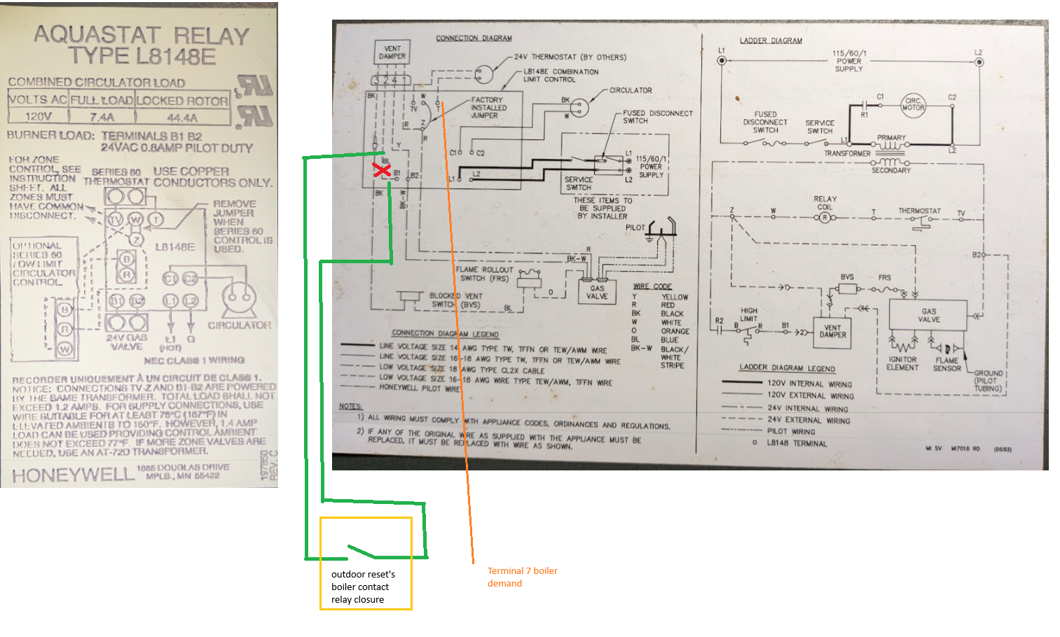

  1. Considering this outdoor reset unit, Tekmar 256 (https://www.watts.com/products/hvac-hot-water-solutions/controls/boiler-and-mixing-controls/256) single stage looks like an affordable option. Installing the outdoor temp sensor and output hot water temp sensor is simple enough However, the installation manual doesn’t have a typical connection and ladder diagram to show where it fits into a system. https://www.watts.com/dfsmedia/0533dbba17714b1ab581ab07a4cbb521/81348-source/639223626220000000/256-d-09.pdf
    How should the boiler demand input on the Tekmar be wired into the existing aquastat setup? Do I tee the existing thermostat call for heat T terminal to the Tekmar Boiler demand, and insert the Tekmar boiler contact closure between B1 output on the aquastat and the blue wire to the electronic damper? See diagram.
  • Thinking about how the control signals would flow, this seems to make sense
if the T-stat calls for heat, T goes low and the aquastat will trigger the circulator relay.
When the outdoor reset sees the boiler demand signal from T go low, it will evaluate the outdoor temp and boiler output water temp sensor inputs and decide whether to fire the boiler or just circulate the hot water.
When the outdoor reset boiler relay closes, connecting B1’s 24vac to the damper, the actuator will open, then provide 24v to the gas valve to light the pilot then the burners
When the boiler water satisfies the Outdoor reset sensor, the boiler relay will open stopping the burners and closing the damper. And the circulator will run until the thermostat is satisfied or until the Outdoor reset demands the boiler again
  • If instead I wired the thermostat T wire only to the Tekmar demand, the circulator wouldn’t run unless the tekmar demanded the boiler, so no hot water would be delivered to the radiators when the Outdoor reset is satisfied with the boiler water temp. which doesn’t make sense.
2. For 24vac power for the tekmar, I’d pick up 24V at terminal Z and Common at Tv or B2. The transformer on the aquastat looks pretty hefty so thinking no concern with a 2VA load per the Tekmar spec sheet

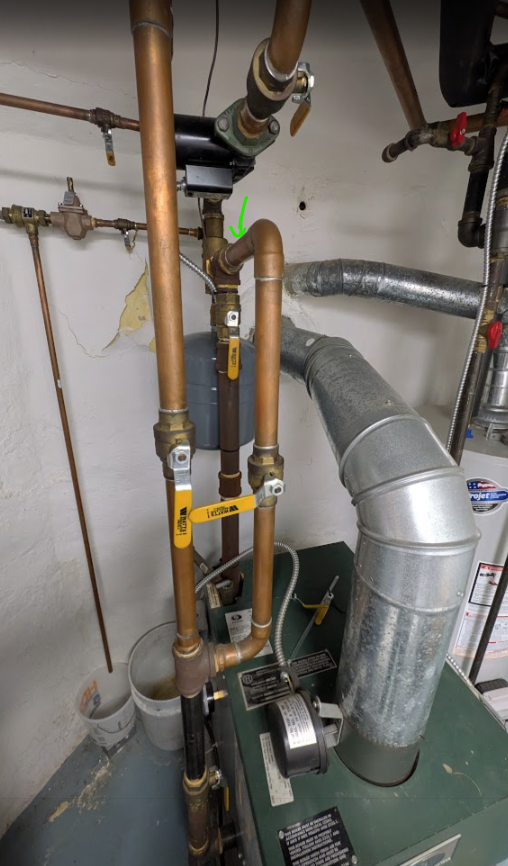

3. I am not sure when/how to adjust the bypass ball valve. If I run the system now with the bypass valve closed, the bypass piping just before the T where it joins back to the hot water output from the boiler (green arrow) is warm/hot. However as soon as I open the bypass a little, that point gets cold, which indicates to me that cold return water is flowing around the boiler input and cooling the output water. But I thought the idea is that hot water from the boiler output should be pulled the other way to warm the input side of the boiler? There is no check valve so water can flow either way.
I have a good DVM meter with a temperature sensor that I could tape the black iron boiler input pipe and experiment to see how to get to steady state > 130F. is that the best approach? How long do I let the system run before measuring and adjusting?
Also since this is a manual valve, I suspect I will need to adjust the valve to different settings for the shoulder heating season vs the coldest part of winter? What would be practical, to find one shoulder season valve position and one cold weather position, and just switch at some point when it get cold enough? or will I be able to find one setting to work all the time?

    just one thermostat? That wires to heat demand, it picks up 24 v frim the transformer you connect to
    5&6 to boiler tt
    Yes the ball valve bypass is a manual setting, a static device on a dynamic system.

    Thanks for the diagram
    What it is missing is the circulator aspect of the system. with what I have, if I connect my thermostat to the Tekmar bolier demand, and then connect 5&6 to aquastat/boiler Tv & T, the circulator will only run when the Tekmar calls for heat.
    So if the tekmar processor says max water temp should be 150F, when that is reached on the output pipe temp sensor, it will kill the burner AND circulator even if the thermostat is still calling for heat. and with the circulator off, the only room heating will be the non-circulating water that happens to be in the radiators at the time.
    that doesn't sound right to me. shouldn't the circulator keep running until the thermostat is satisfied and distribute remaining heat from the boiler?
    I'm sure in new condensing boilers, the fancy processor can control the circulator and burner separately, or somehow modulate the burner output to achieve a lower temp while still running the circulator. But since this is older non-condensing with single on/off for everything, maybe I am just thinking about it wrong?

    Is the circulator controlled by the boiler contact now? Does it run after the burner is off? Nothing would change if that is the case. Or is the pump controlled by some other means?
    Jamie Hall Posts: 28,006
    The whole fundamental idea of outdoor reset is to control the circuiting water temperature at just the right value to provide for the heat loss of the spaces. All the time. So you have one circulation system, powered by one or more pumps, and the temperature of the water being pumped is controlled by the outdoor reset.
    Now you also have a power — heat — supply; in this case non-condensing, non-modulating, fixed output boiler. That's fine. What that means, though, is that the boiler doesn't have to run all the time to supply the load. Sometimes on, sometimes off.
    OK. How do you control this? The most effective method is primary/secondary pumping, or, a very similar alternative in terms of logic, a buffer tank. The heating loop, with its own pump, is constant flow, and has a modulating mixing valve on it, controlled by the outdoor reset,, which mixes return water from the loop with the hot feed water from the boiler in just the right ratio to make the water being pumped into the radiation the right temperature. The rest of the return water is sent back to the boiler, where a second pump pumps it through the boiler and back to the takeoff for the system. That loop is controlled by the boiler's aquastat, which will fire up the boiler when the return water coming to the boiler drops below 140 F (some say 130 F, I prefer 140 F for corrosion protection).
    This is preferable to a modulating bypass, as that has no way of controlling the temperature of the water in the radiation — only the flow — which makes balancing very difficult.
    A fixed or manual bypass is virtually useless. Like a stopped clock, it is correct only for one specific condition.
    you are correct. right now, when the thermostat calls for heat, the circulator is started by the aquastat along with the burner. and when the thermostat is satisfied, the both burner and circulator shuts off.
    although it seems the same, the difference is that in the current model, the thermostat is satisfied when the boiler shuts off. if you add an outdoor reset, the reset supply sensor could be satisfied before the thermostat and the boiler will be off with the radiators giving off their stored heat. Until the water at the sensor drops below the restart temp and refires the burner and circulator, or the stored heat in the radiators satisfies the thermostat. which maybe is enough since it may reduce overshoot.
    I don't have issues with short cycling now where the boiler reaches the high-limit and kicks off before the thermostat is happy. But I do have some short cycling I think caused by the thermostat, which even though it is in boiler/radiant mode, still calls for heat more than I think it should.
    Since boiler is older noncondensing/nonmodulating, and only have a high-cutoff aquastat, and don't have storage tank, my options without major replumbing work seem very limited.

    Having the Tekmar's terminals 5 & 6 control the Boiler's T-TV of the L8148E Aquastat (where the thermostat was), that will shut off the circulator when the Tekmar releases the contact closure at terminals 5 & 6.
    A contact closure between T-TV energizes Relay coil R, this closes contacts R1 (Circulator) and R2 (Vent Damper then Burner).
    So Interrupting the B1, High Limit, R2 circuit as the @dmxart originally had it is one way to avoid circulator shut down during a thermostat call for heat at the expense of cycling the Damper a lot as the Tekmar modulates (duty cycles) the Burner to control water temperature.
    109A_5 Posts: 4,790
    edited October 30
    I think I would do it this way. It checks all the boxes for me. Sadly it needs a relay. Probably could do it without the relay and the extra transformer but that may be more risky.
    Tekmar is on its own power source.
    Circulator and Vent Damper are 100% active during the thermostat's call for heat (Demand).
    The Tekmar's Boiler Control terminals 5 & 6 controls only the boiler's burner.
    In this case with the added relay which draws current from the L8148E's transformer when active, I would use a small relay with the least amount of coil current draw you can find.

    You're not breaking TT or RW at the aquastat from 5-6 N.O. on the Tekmar. You're going to break B1. The burner circuit will open while the circulator continues to run if there's still a heat demand.
    You're system is piped as a boiler bypass.

    @109A_5 's diagram 2 is where i am leaning
    L8148E's label says max 1.2A (1.4A if controls < 77F which they always are)
    The gas valve is 200 mA steady state and 1.25A at ignition
    add on another 125ma for the tekmar. Which makes peak load at ignition 1.375A, which is only about 5 seconds every burner cycle
    direct wiring is just within the 1.4A specs for 77F ambient temp. If I can find a low coil load transformer, then could do diagram 1, otherwise it is a wash.
