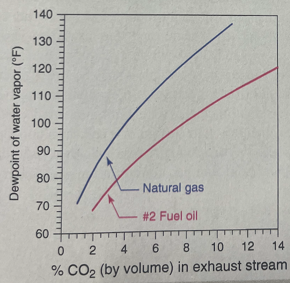

    I suppose it depends on how often and how long it runs at condensing temperatures. With oversized boilers on small zoned systems it could be in that mode daily.
    The temperature depends on type of fuel how the burner is running, Co2 number.. Commonly we hear 130 for NG, 140 for oil
    A post from Burnham once upon a time claimed their sections have a blending provision to help boost return.
    So there is no one size fits all.

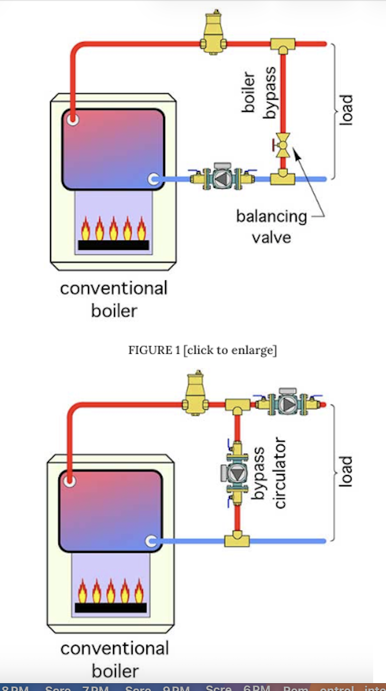

    What is known a thermostatic "thermal clutch" is absolute protection. Some of the boiler installation manuals are starting to mention that.

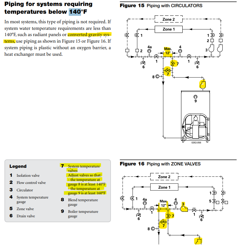

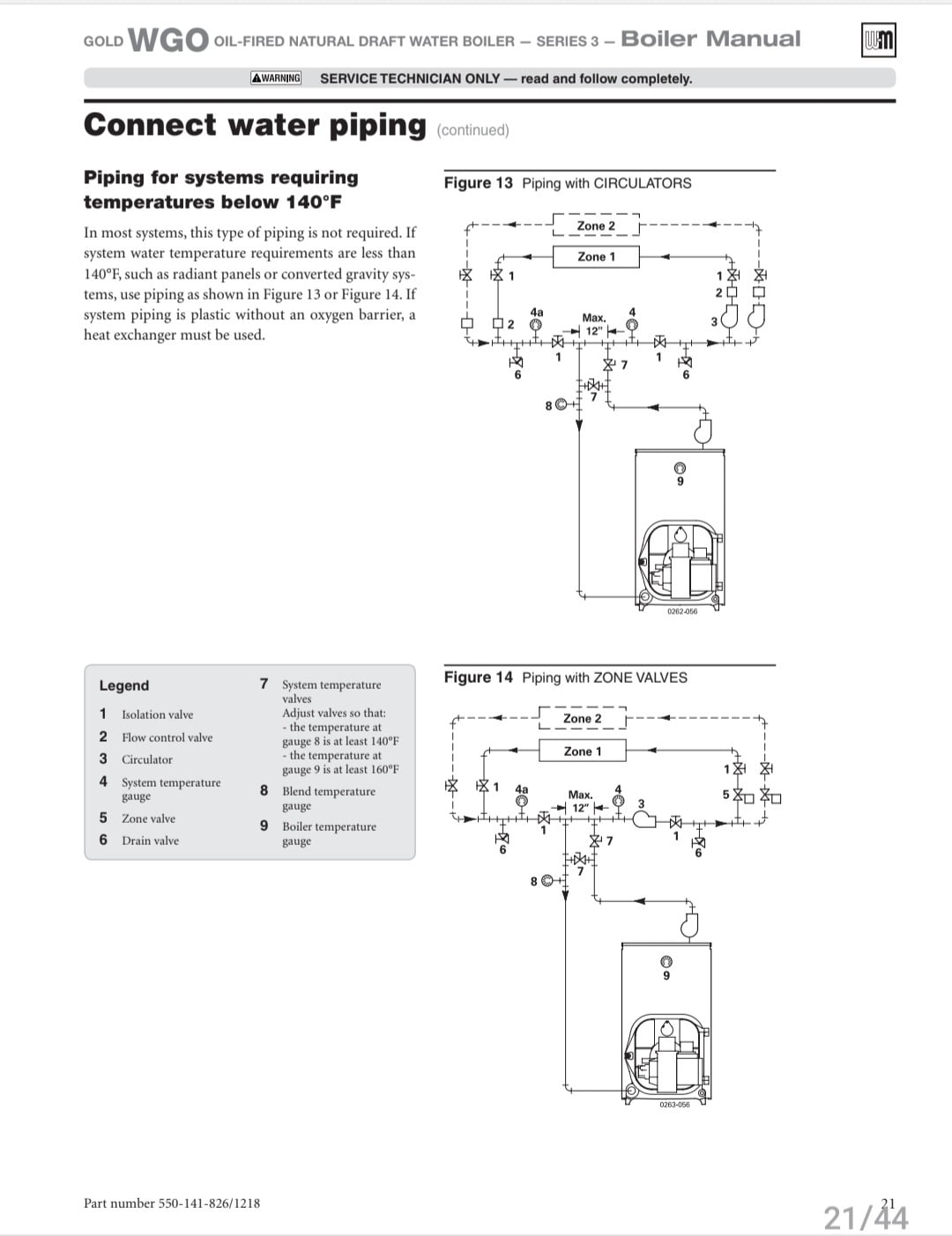

    Personally I would not cut into a cast iron system with 120 or less max return water to add a simple on-off ball valve that I planned to use as a control valve to increase return water to the boiler. Feels like a guess! and not really what that valve is meant for. There are tried and true piping strategies to solve this problem, and purpose built devices to accomplish this task (caleffi for example) if the valve were already installed I would try it sure, but like @Jamie Hall said that manual valve isn't going to compensate for your changing load, which is a moving target through the heating season.
    Just to point out in the WM book where they show "system temperature valves" I am not convinced those are standard ball valves, and they are also utilizing primary secondary piping.
    hot_rod Posts: 28,593
    simple enough, call Weil Mclain for a part number of the “system temperature” valve😏
    The only way to blend with a valve is 3 ports
