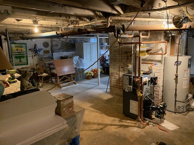

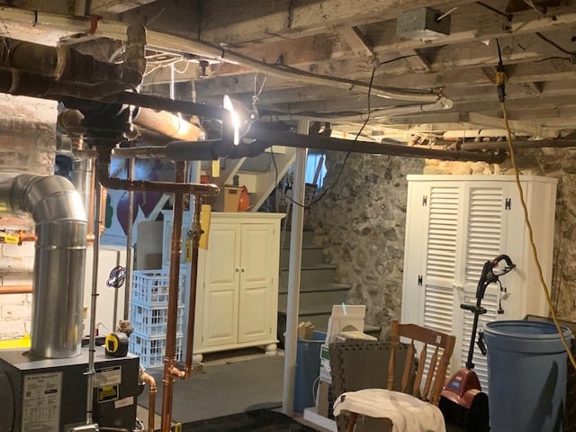

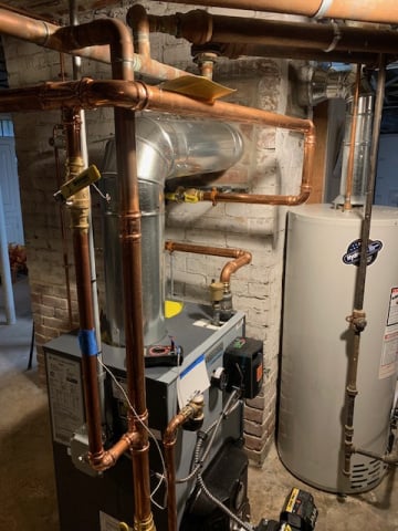

    Yeah, that is a very long time. Like i said it could be a simple explanation. Oversized radiators, old gravity system with unbelievable amounts of water, boiler too small, etc. You need to provide more info to get a better picture of what you have. its all just an educated guess.

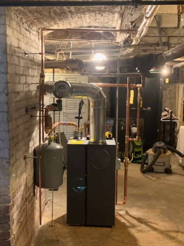

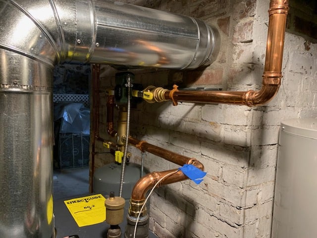

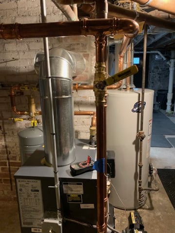

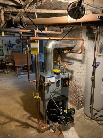

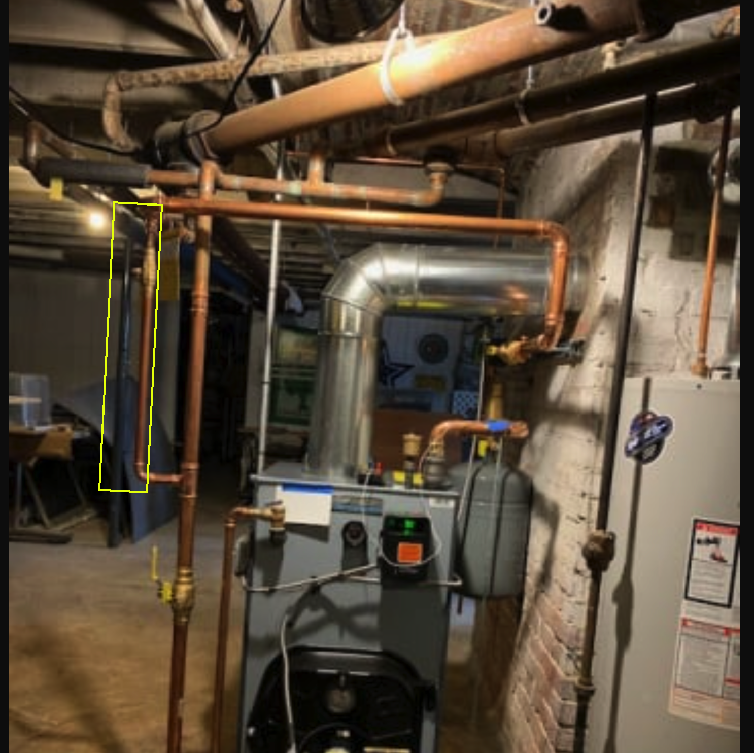

    Pics of your system would be nice

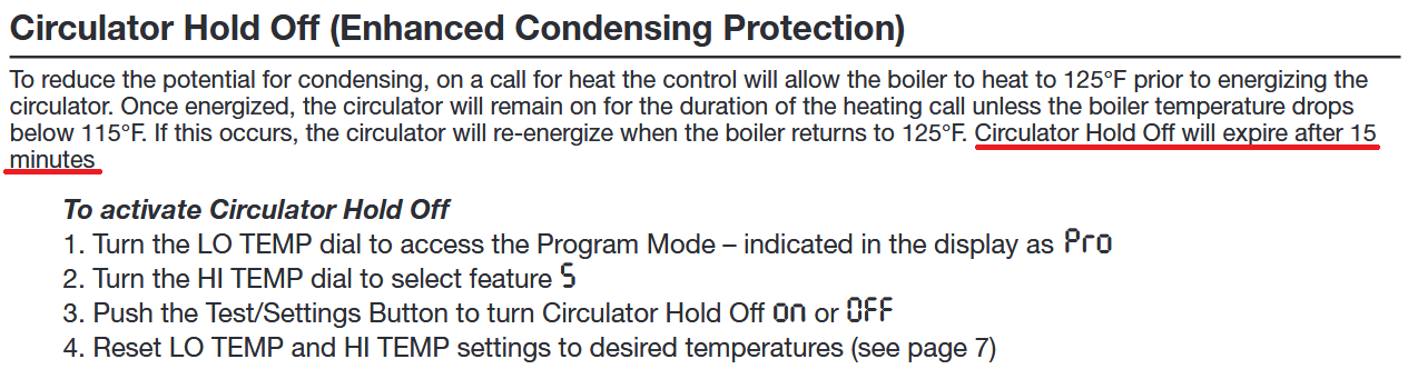

    If you are using the circulator hold off feature on the hydrostat, then you have nothing to worry about.
    But although your run time is fine for a system with that much water content, the boiler temp should be getting up quickly to and above 140, then probably hovering around there until the call for heat is satisfied. Regular calls for heat after the first call will probably run at a higher temp.

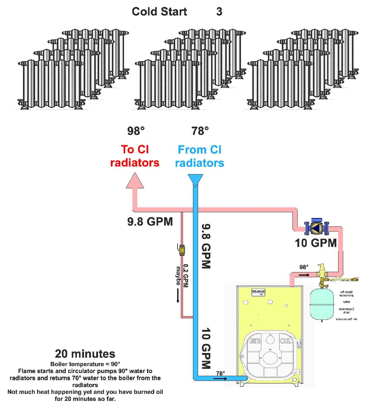

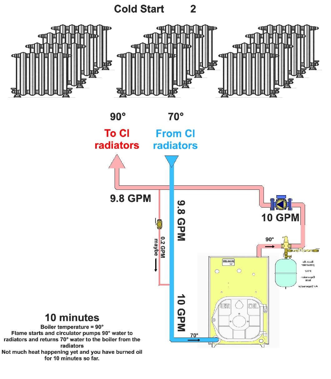

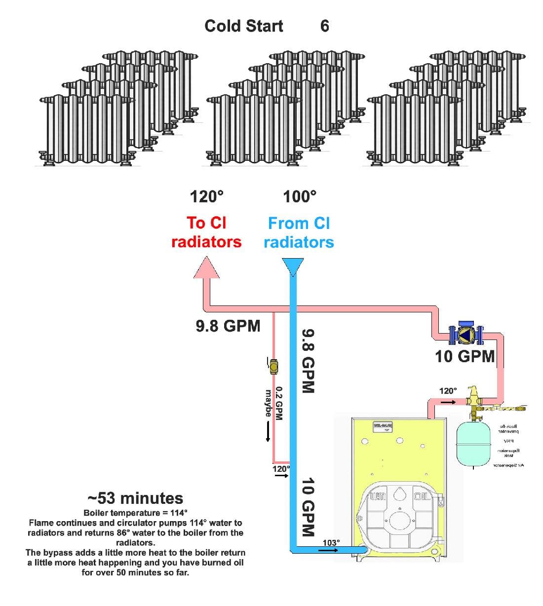

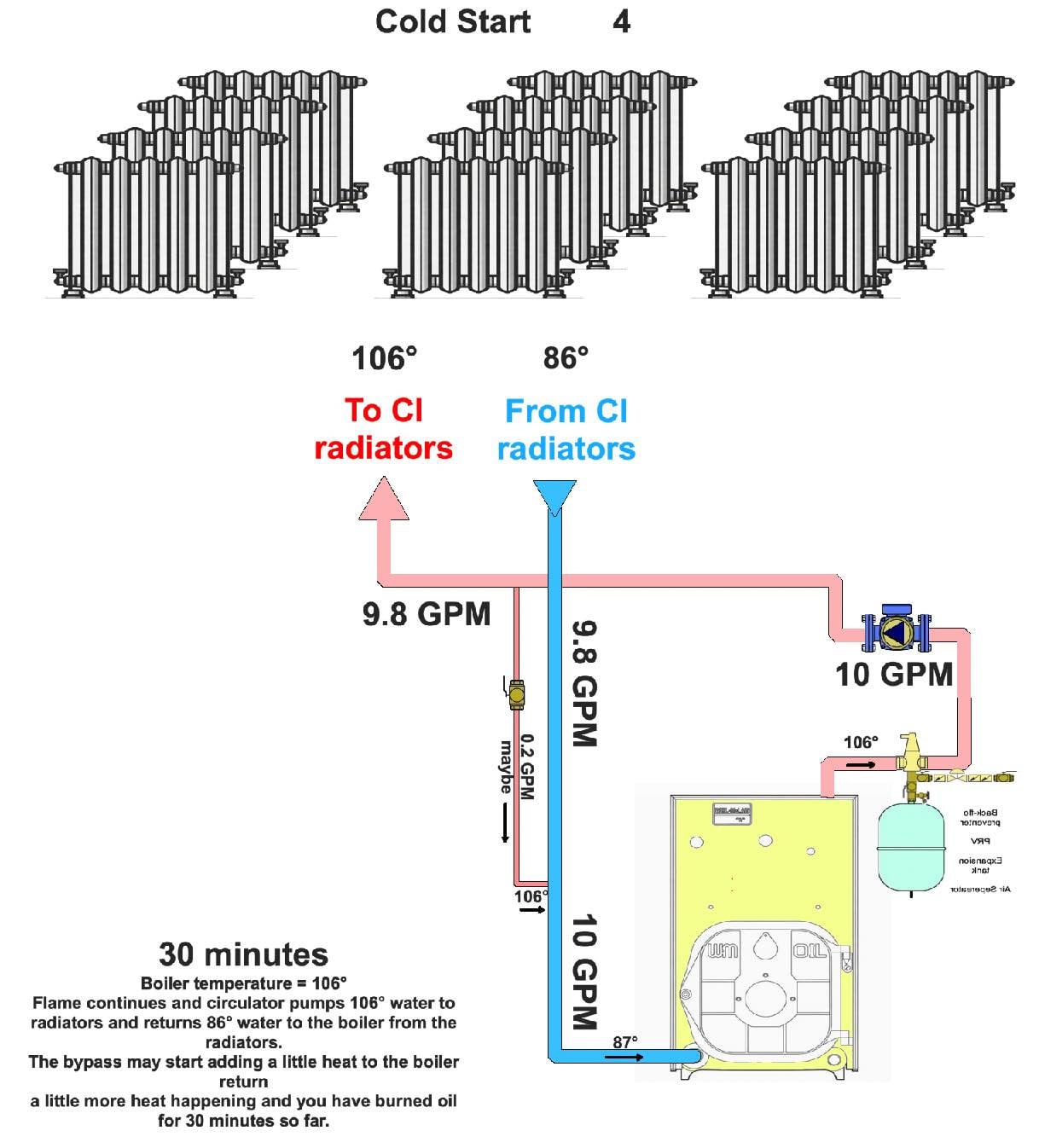

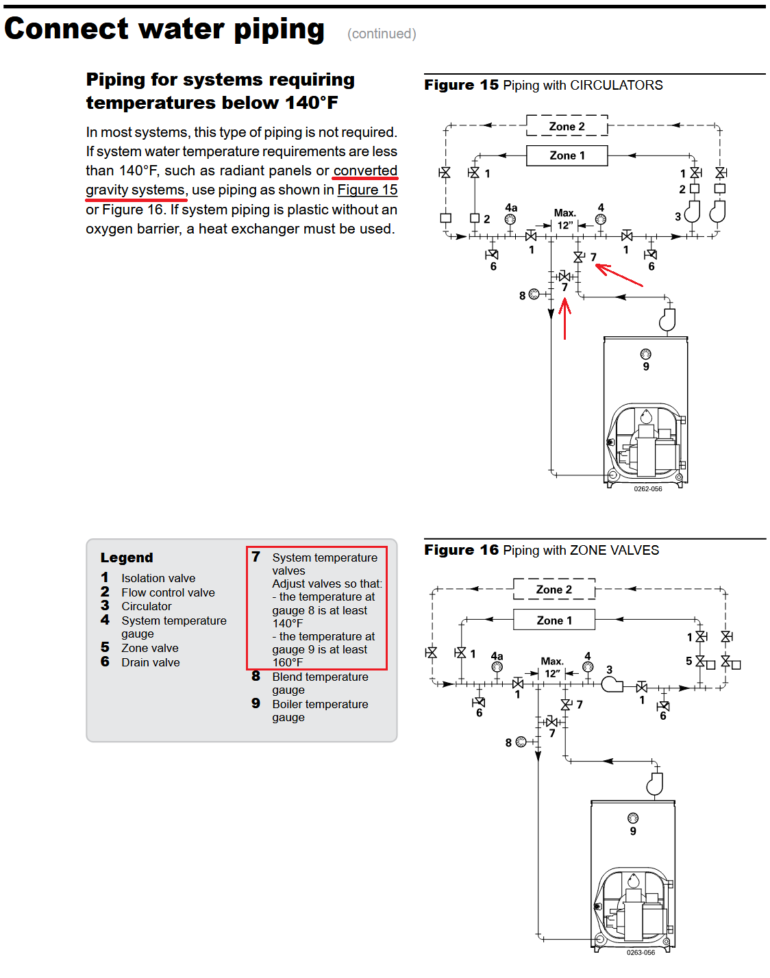

    Chances are your Hydrostat hold-off for the circulator is not doing very much. With a gravity system design, you are likely getting thermosiphoning (gravity flow) even without the pump running.

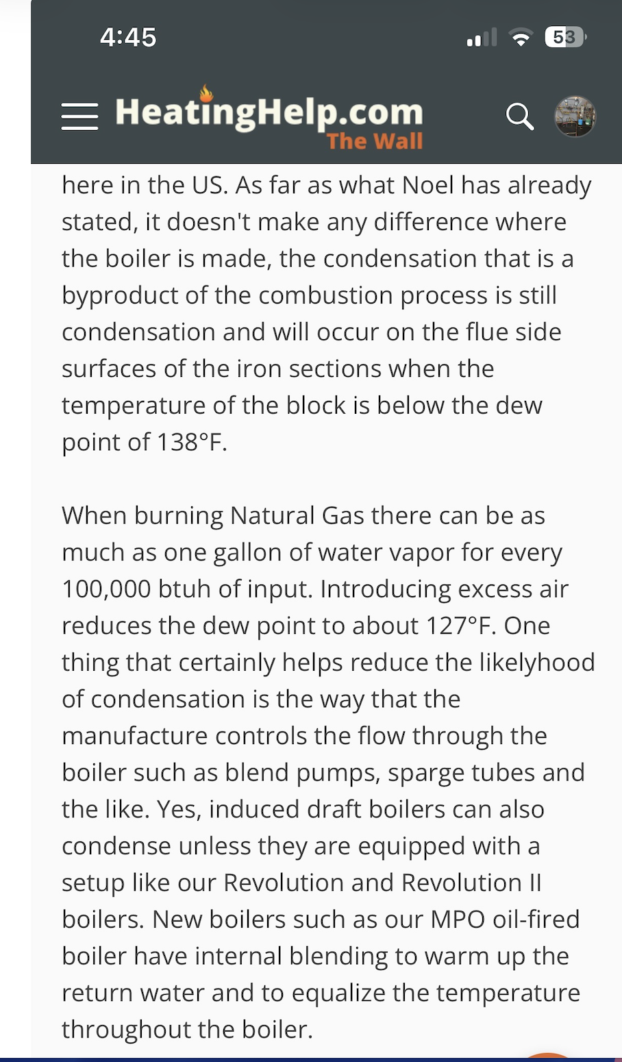

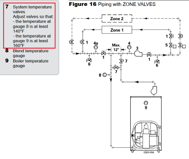

    Your new boiler needs to reach a return water temperature of approximately 135° to 140°F within the first 6 to 10 minutes of operation to prevent prolonged flue gas condensation. Every boiler will form some condensation on cold metal surfaces during startup. What matters is how long that condensation persists—you want that period to be as short as possible.
    Boiler water starting at 60°–70°F (typical basement temperature) for ten minutes is not a problem, even if the burner runs for over an hour. As the boiler heats up, the flue gases will begin to evaporate any initial condensation once the internal surfaces reach a high enough temperature.
    However, if the boiler water remains at or below 120°F for extended periods—such as during long morning run cycles—condensation will continue forming the entire time the burner is operating. This can significantly shorten the life of the boiler.
    You should check the return water temperature at the boiler inlet (approximately 12 inches from the connection) to see how quickly it reaches 140°F. If it takes more than 10 minutes, a system redesign may be needed. If the return temperature reaches 140°F within that time, the system is likely piped correctly and should not be a concern.

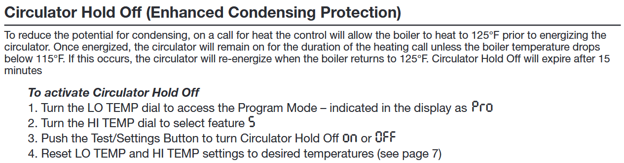

    " the boiler does have the system bypass installed that redirects some of the supply water back into the boiler. "
    Is there a valve to change the amount of bypass water flow ?

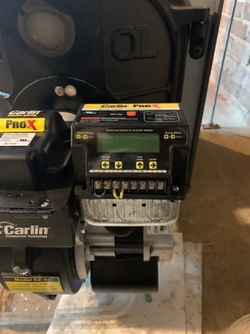

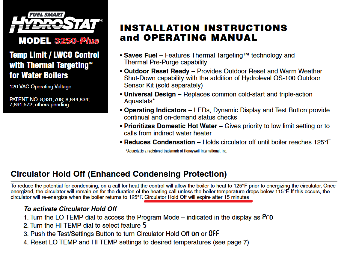

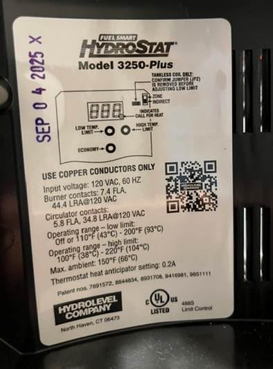

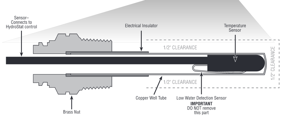

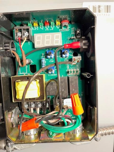

    Make and model of the Hydrostat ? Maybe Hydrolevel 3250 ?
    Although I did not know the Hydrolevel 3250 had a burner duration timing display function. Maybe it was 142 degrees and not 1hr 42 min ?
    If you have a Hydrolevel 3250.
    HVACNUT Posts: 7,784
    @HomeOwner7 , read through the Hydrostat manual. The long run time is caused by letting the house cool off at night. Why, comfort? Even with a bypass and the circulator hold feature, those radiators are ice cold. High water volume? What is the Economy setting on the Hydrostat? You're not saving fuel by going low at night and trying to make it back up in the morning.

    Thanks, Everyone, for the additional info. I have a few questions for now and a comment. I'll provide info regarding the system: boiler model, firing rate, etc. and more about how the system is operating a little later.
    EdTheHeaterMan: If it takes more than 10 minutes to reach 135-140F you say "a system redesign may be needed." What would a "redesign" involve?
    HydronicMike: You say if the Circulator Hold Off feature on the hydrostat is being used there is nothing to worry about. Can you explain further? Do you mean there's nothing to worry about even if the system is operating over an hour at less than 120F - as long as the Hold Off feature is active? Why would that be?
    109A-5: Those were good thoughts about the possibility of my mistaking 1Hr 42Min for 142 degrees, but that did not happen. There isn't, as far as I know, any kind of burner duration timing display function attached on the boiler system. I've been writing down how the system is operating with pen and paper. Lots of enjoyment babysitting it. It, did, in fact, take 1Hr 42 Min, per the Hydrostat, to raise the water temp from 66F to 140F.

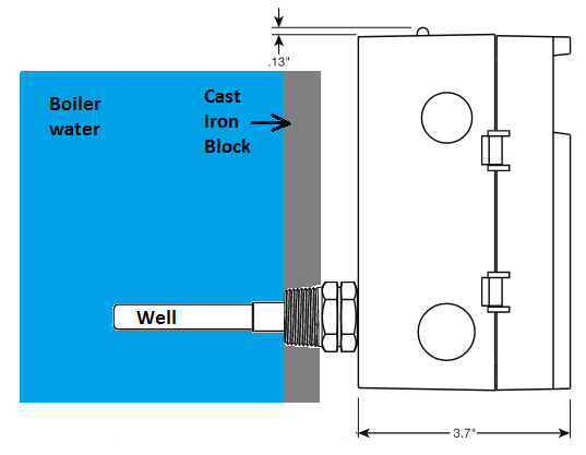

    Thinking about the temp the Hydrostat measures raises a few questions:
    1: What water does a Hydrostat measure? The water in the boiler tank?
    2: How close/indicative of the temperature of the water in return pipes are the temperature readings I'm getting by looking at the Hydrostat? How useful are they?

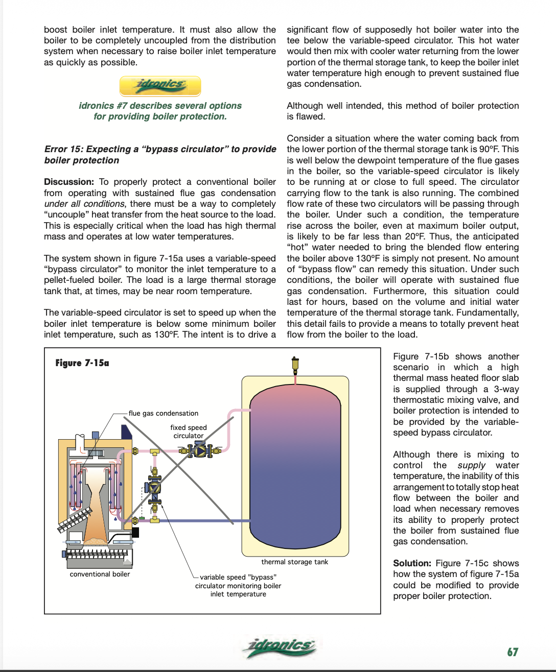

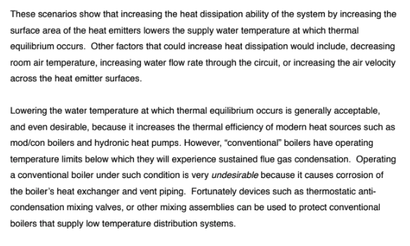

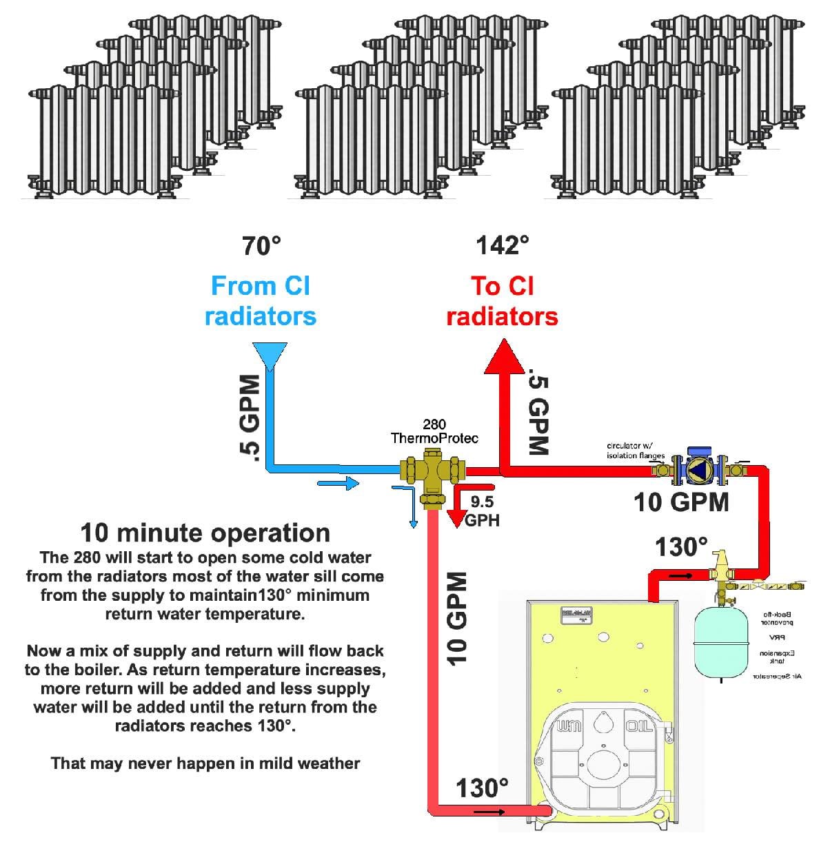

    Anytime the burner is firing with water temperature below 135°, its promoting condensing of the flue gasses. It should never take that long. Maybe an adjustment on the bypass is needed.

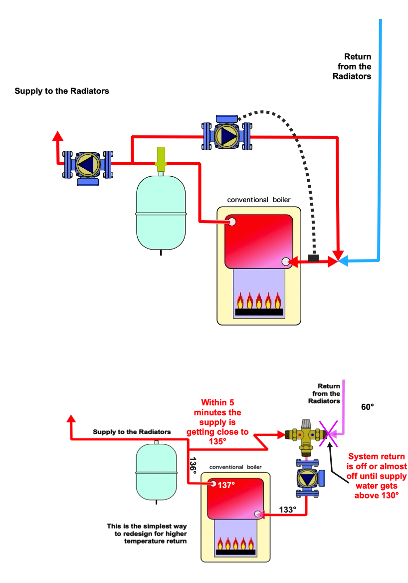

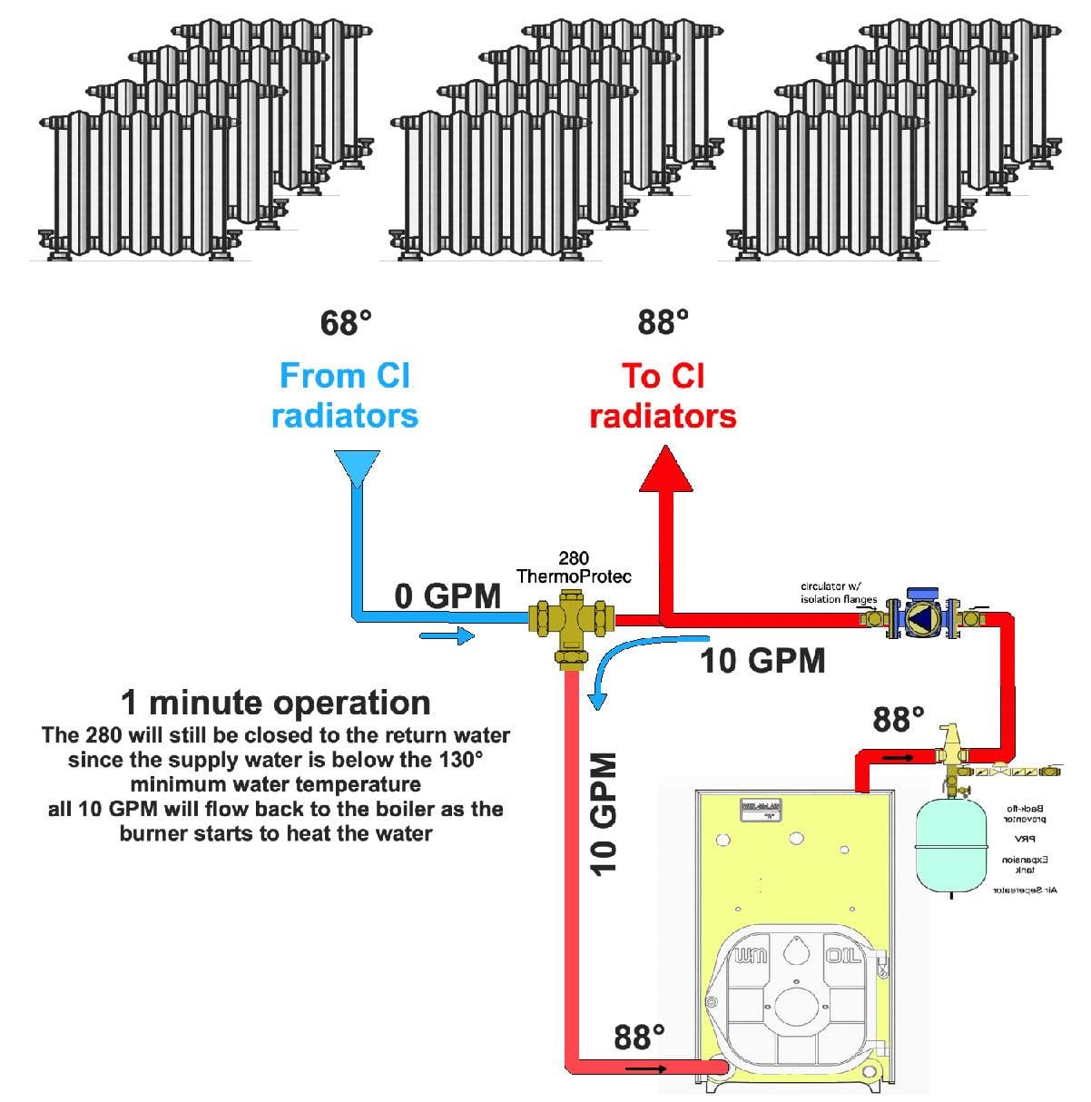

    EdTheHeaterMan Posts: 12,940

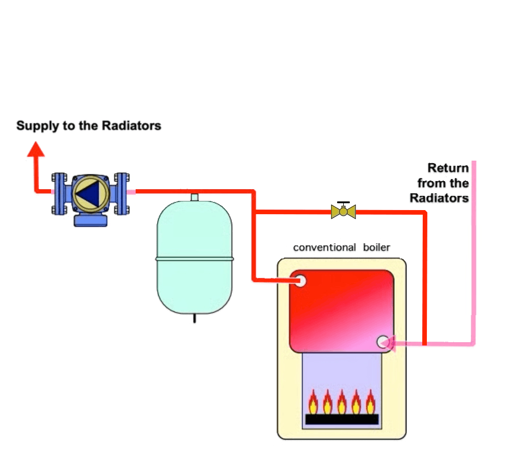

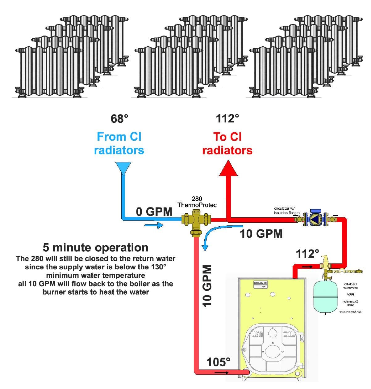

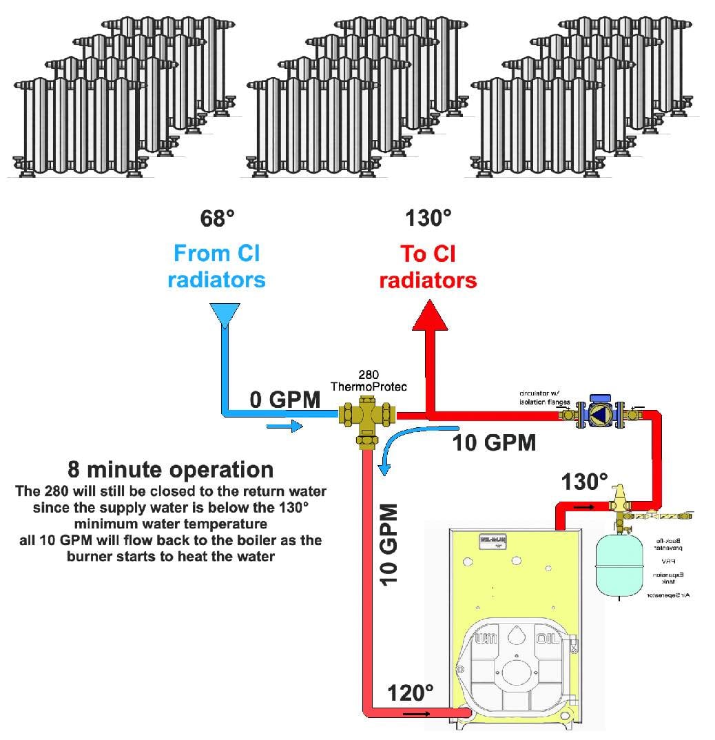

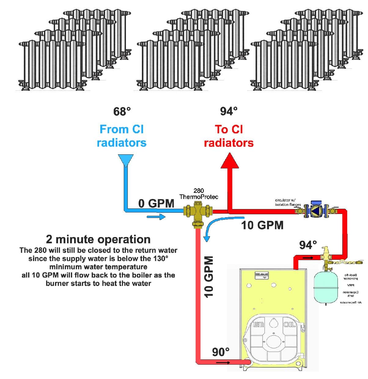

    @HomeOwner7 asked: "EdTheHeaterMan: If it takes more than 10 minutes to reach 135-140F you say "a system redesign may be needed." What would a "redesign" involve?"

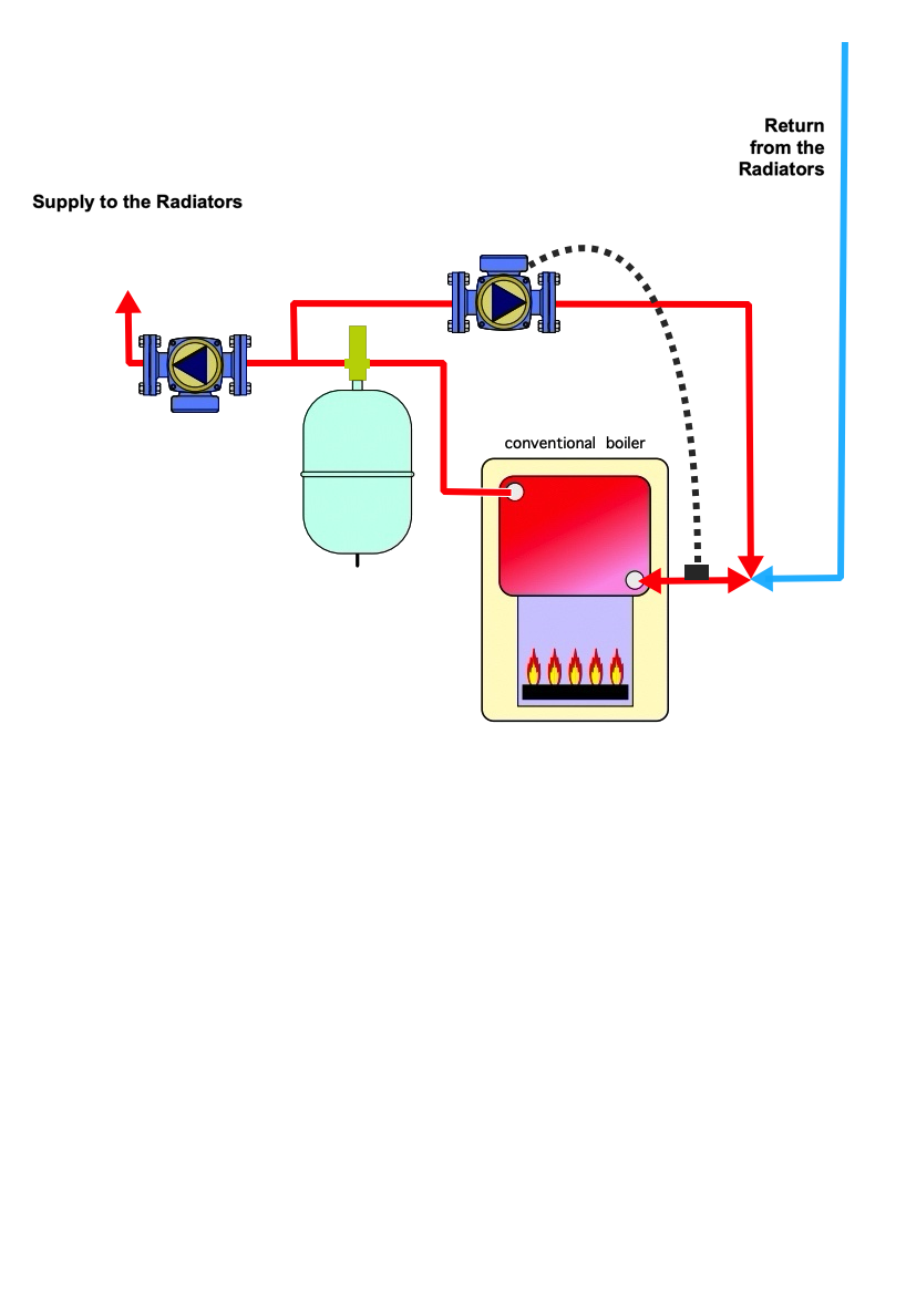

    You may not need the redesign…. Does it take longer than 10 minutes for the return water to get to 135° or 140° (depends on the boiler manufacturer and the fuel you are using)
    If you are operating at lower than 130° for more than 20 minutes then one of the redesigns would be to install a boiler protection valve like this one: Caleffi 280176A. So that heated water from the supply would be redirected to the return for the first few minutes of operation.
    This will not let any heat go to the radiators until the boiler water return reaches 130° or 140°.   When it is placed on the return to the boiler, that boiler’s circulator pump moves the water out of the supply side to the return. In the mixing valve the cold return water from the radiators will stay closed until the mix temperature reaches the setpoint of 130° or 140° depending on the valve model number.
    Here is a diagram of the revised near boiler piping.

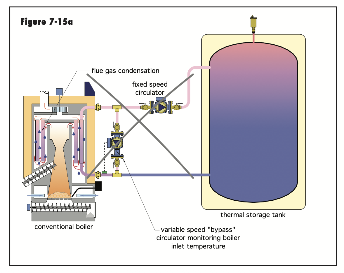

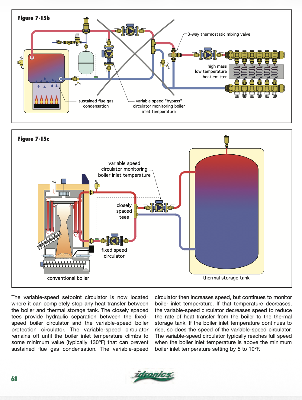

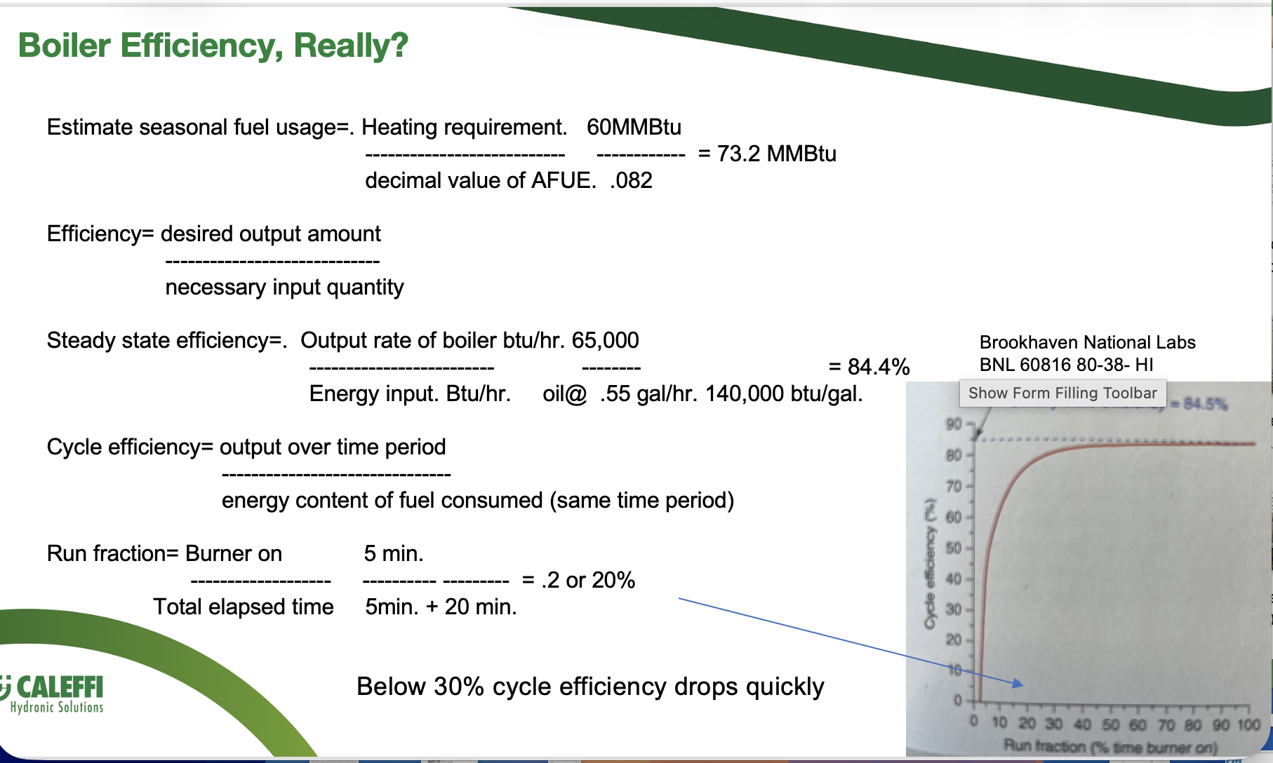

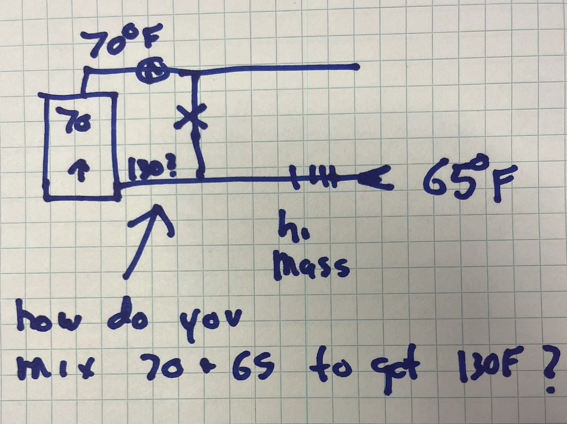

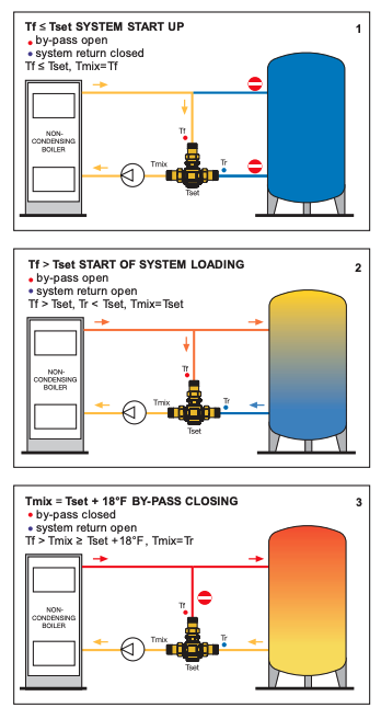

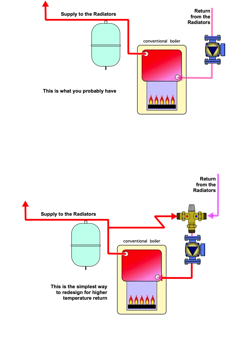

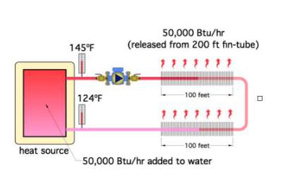

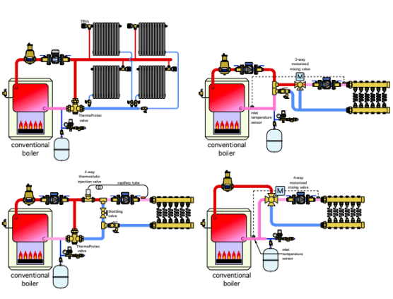

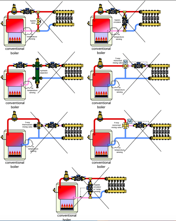

    hot_rod Posts: 28,699
    A properly sized and pumped boiler will raise the temperature from return to supply about 3-5° under load. So with high mass high volume systems that return may raise up from 65- 70°
    With a bypass valve or even bypass pump you cannot mix those two temperatures to get 130 at the boiler return.
    A "thermal clutch" regulated based on temperature at the boiler return is one sure way to protect the boiler, as Ed shows. A temperature controlled variable speed circ, properly applied can work also.
    While holding off the circ with an aquastat does work, it can really short cycle that pump, on/off every few minutes until the system catches up, depending on the water content of the boiler.
    Only adding a thermostatic function do you turn a "dumb" protection method into a "smart" control.
    Granted there are systems with bypass valves or pumps that are somewhat better than nothing, and grossly oversized boilers can "mask" a return temperature issue with sheer horsepower.
    So it becomes system specific, how much mass? How is the boiler sized to the load and heat emitters connected? The heat emitters (mass) and the volume of water in the pipes (gravity conversions) drive the thermal equilibrium of the system, not vice versa.

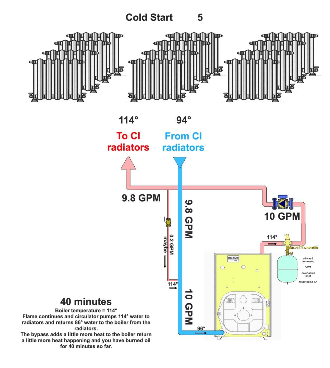

    edited April 22

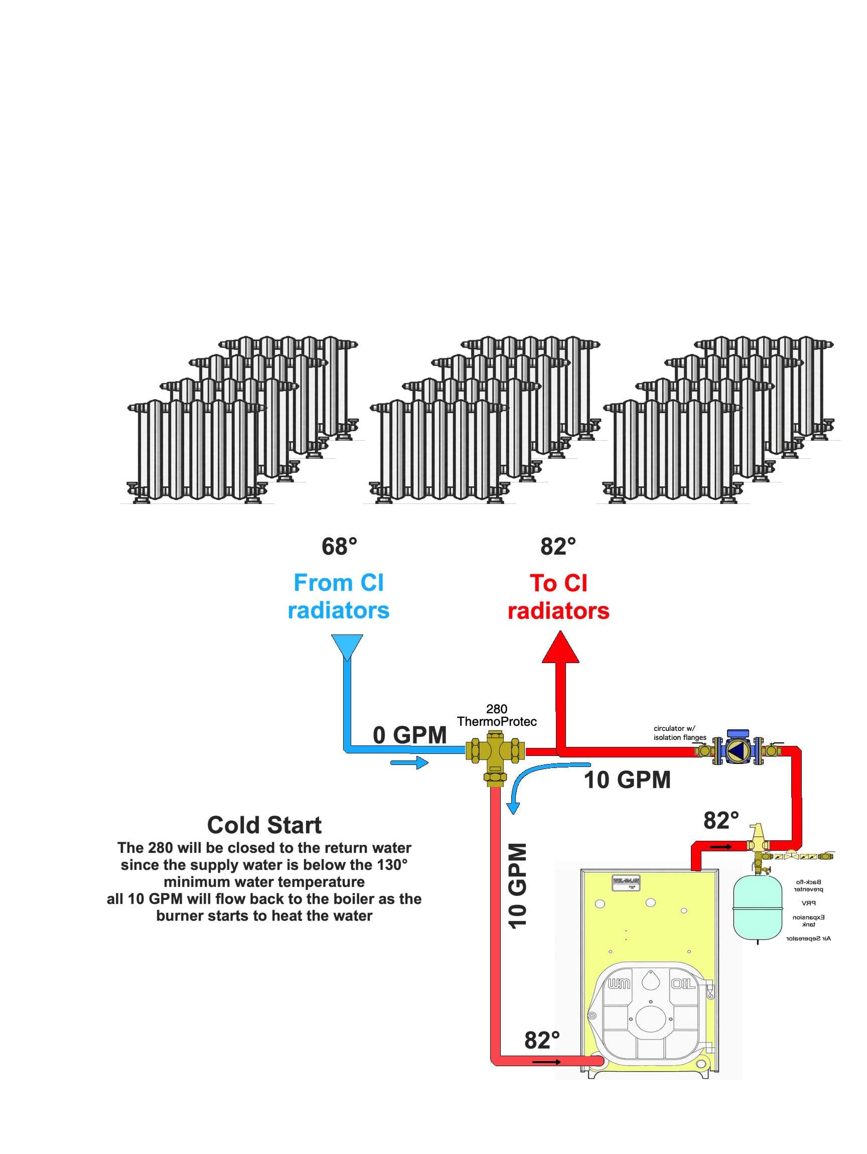

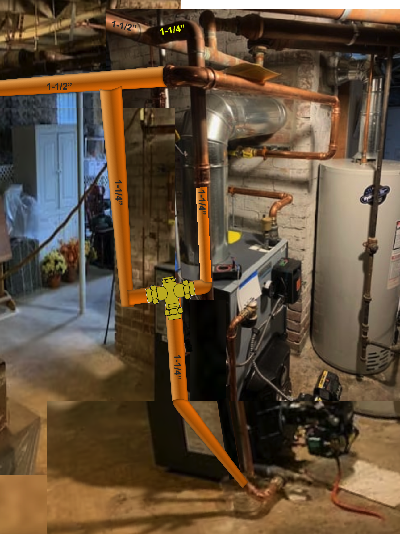

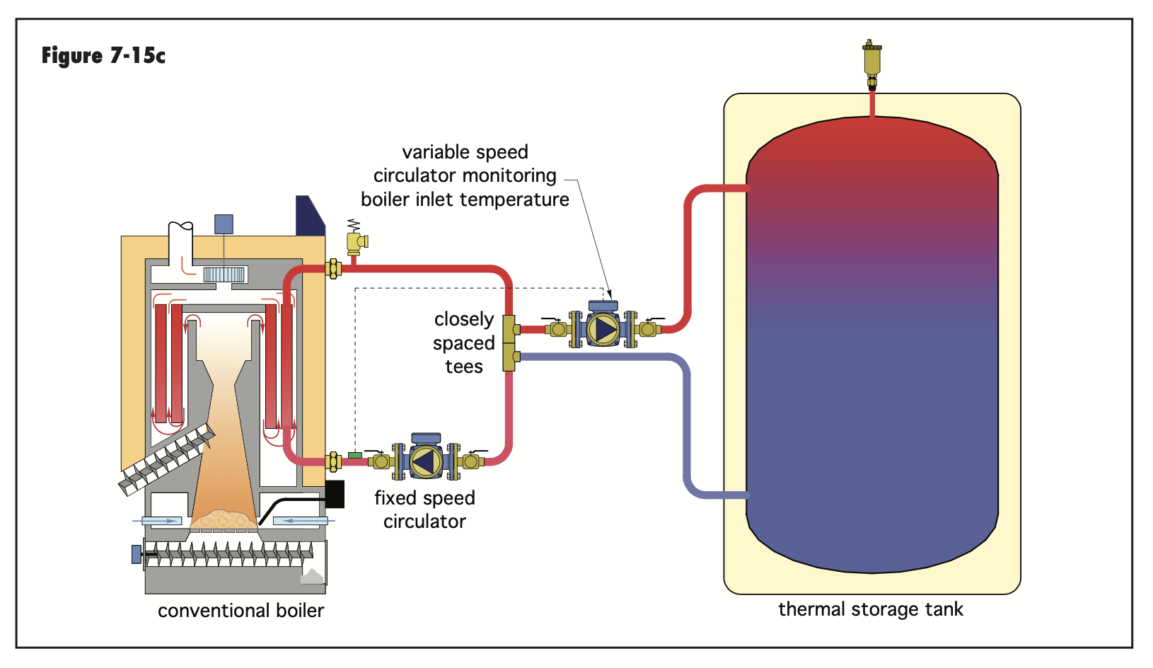

    If you want to go crazy with your near boiler pipe redesign, then you can pump away from the expansion tank to the  system and put a pump on the by-pass  line that is operated by the return water temperature Adding a micro bubble air vent near the expansion tank will get rid of air from the entire system over a short time once the water temperatures get where you want them.
    If your bypass circulator does not get the return hot enough soon enough, then the return temperature sensor can shut off the system circulator and bring on the bypass circulator until the return water is hot enough. This may short cycle between the two circulators, but there are some controls that can allow both pumps to run when the system reaches that sweet spot where the return water and the bypass water will share the return at just the right temperature. But now we are getting past "the simplest thing to do" stage of redesigning the near boiler piping, like the bottom illustration, and the price will reflect this.

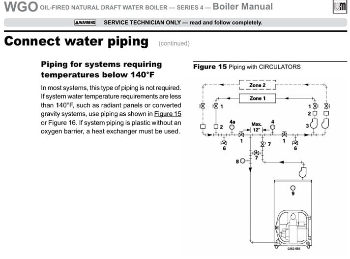

    Ed and hot_rod: I’ve compared the system installed in my cellar to your diagrams.

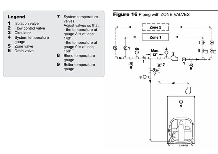

    Ed: In your post that begins with “If you want to go crazy”, the diagram that is at the top (not “the simplest way” diagram at the bottom) is closest to what I have in my basement. Imagine your diagram without the temperature sensor and replacing the circulator on the bypass piping with a ball valve.
    HVACNUT: Your suggestion to stop lowering the thermostat at night, I get how that can help, but not so much for me. I like a cooler house overnight.
    Is it possible that all the system needs to speed up raising the water temp to 120F to 140F in a reasonable amount of time is a few adjustments?
    For instance, adjustments to the “Bypass Water Flow Valve” and ”Circulator Hold-Off Feature* on the Hydrostat.
    I don’t know how these two pieces of equipment have been adjusted or if the Hold-Off feature on the Hydrostat is active and working.
    Your thoughts?

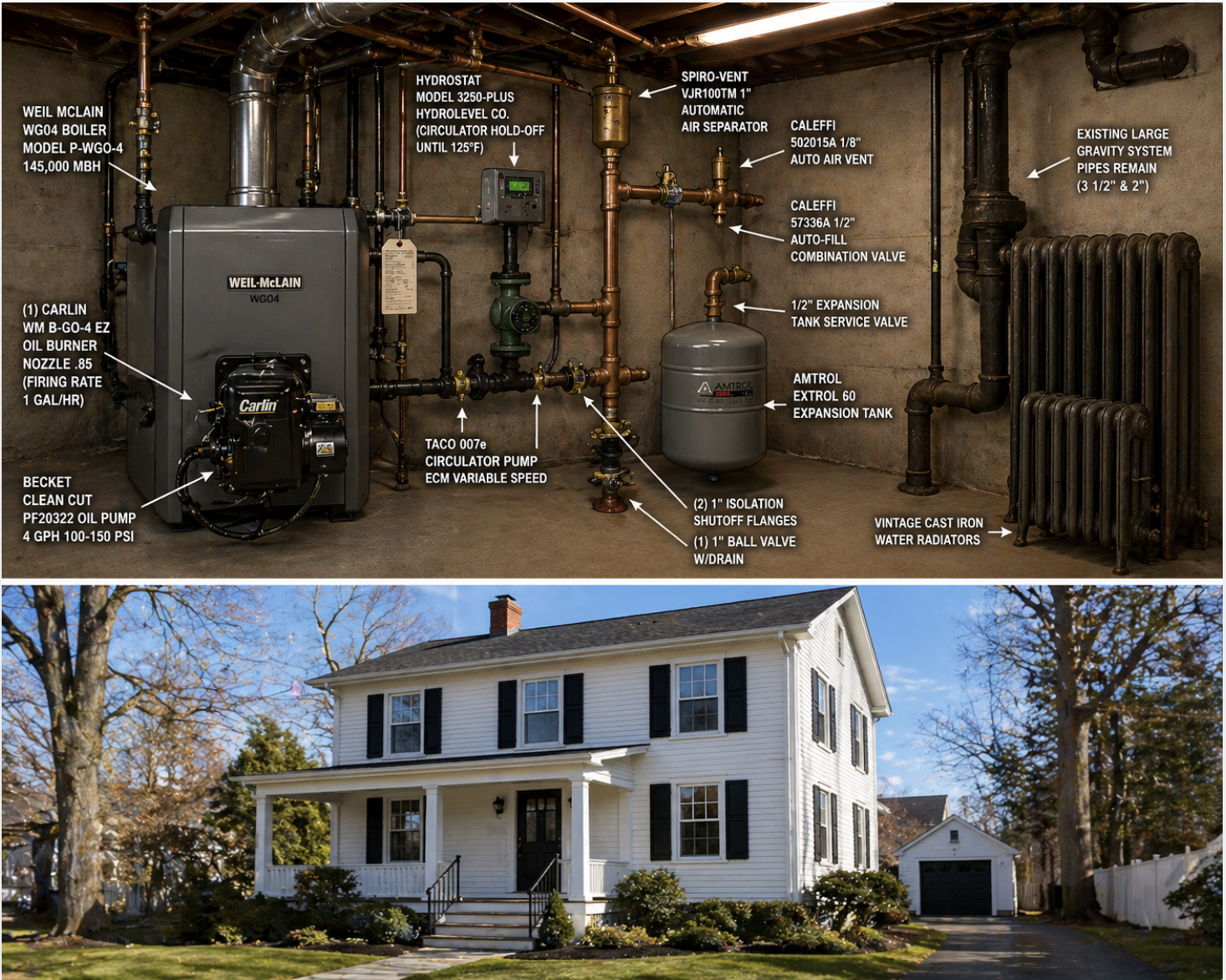

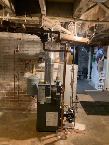

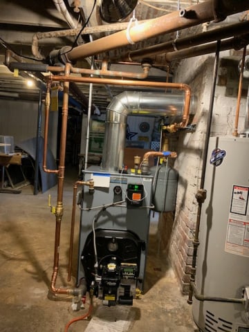

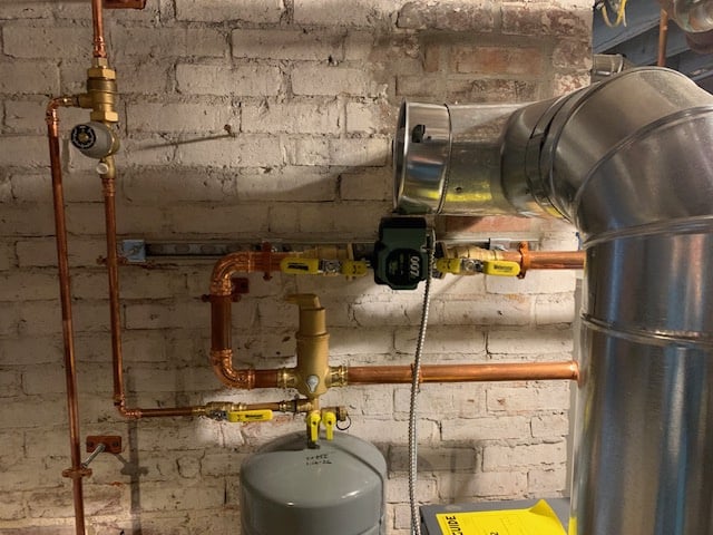

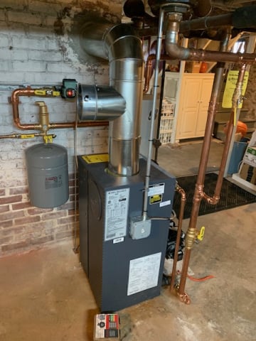

    It was suggested that I post more info about the system that’s been installed. I plan on doing that. It’s gonna be a big chunk of info to digest.
    109A_5 Posts: 4,759
    Enabling the Circulator Hold Off function and opening the bypass valve more or to 100% should be easy and quick to do, and see what happens. Since it appears your system has a large volume of water it may not shorten the boiler's run time during a recovery from an overnight setback but it may help reduce the condensation the boiler is exposed to.

    I live in an area where we have gravity hot water systems still working. When we need to replace the boiler, I have had great success by using variable speed injection to not only protect the cast iron boiler from low return water temps, but it also allows the system to work with temperature modulation based on outdoor temp. These systems have design water temps typically in the 140F - 160F range and the homeowners always say that they love the warm radiators - not HOT - and the even outputs. We can keep those desirable traits while keeping the boiler from condensing during the burner cycle. The piping is not difficult, just make sure everything is sized according to actual heat load of the house. Tekmar #356 is the one we use.

    *“Enabling the Circulator Hold Off function and opening the bypass valve more or to 100% should be easy and quick to do, and see what happens. Since it appears your system has a large volume of water it may not shorten the boiler's run time during a recovery from an overnight setback but it may help reduce the condensation the boiler is exposed to.”*
    109A_5:
    I’ll ask the installer if the Circulator Hold-Off is enabled and about opening the bypass valve more or to 100%. I’d like at a minimum to reduce the condensation the boiler is exposed to. The new system was just installed in January of this year. I'm more concerned about the condensation than the system operating an overly long time to heat the house. The install of this system was not inexpensive. I’d like it to last as long as possible.

    The water pump on the system in my cellar is a Taco 007e. I don’t see anything on the Instruction Sheet about variable speed nor variable speed injection so I assume it doesn’t have that feature. There's no outdoor temperature sensor on the system, either.

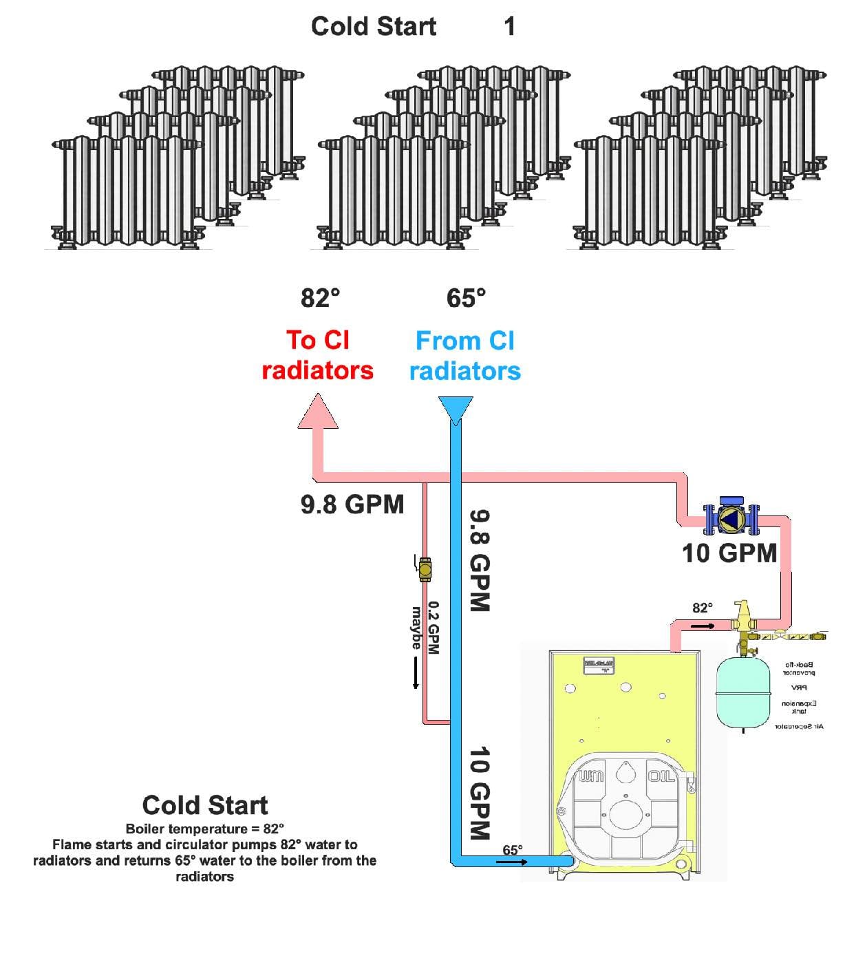

    @HomeOwner7 replied: "Ed: In your post that begins with “If you want to go crazy”, the diagram that is at the top (not “the simplest way” diagram at the bottom) is closest to what I have in my basement. Imagine your diagram without the temperature sensor and replacing the circulator on the bypass piping with a ball valve."
    So this is what it sounds like your have:
    In this diagram there is nothing to prevent the heated water from leaving the boiler and the cols water from the radiators from returning to the boiler when the circulator pump is operating or when the circulator pump is off.
    There is also nothing that will direct the hot supply water to the return even of the bypass valve is fully open. as a result the boiler will take a very long time to get up to 140°. For that reason you will not get the bypass to do much of anything for you in preventing Flue Gas condensation.
    Untitled Image
    As illustrated in this diagram by @hot_rod , without the pump to forcibly move the supply water back into the return to increase the temperature more quickly, you may as well just leave the valve closed on that bypass.
    My reply to your question, “What would a redesign involve?”, assumed that the circulator pump was located on the return, as many systems still have that design flaw.
    With a mixing valve and the circulator on the return pumping into the boiler, the “mixed” water entering the boiler will initially come entirely from the supply pipe of the boiler. The system return (from the “COLD” port on the mixing valve) will be effectively closed, while the “HOT” port is fully open. This allows progressively hotter water to be fed back into the boiler until it is producing water hot enough to maintain approximately 140°F (or at least 130°F, depending on the model number) at the return inlet.
    Then, as the boiler temperature rises, the combined effect of gravity and circulator flow will begin to draw more water from the system return, allowing a greater proportion of cooler return water to mix in and supply the radiators with a greater amount of heat.
    If you do have a circulator on the supply side of the boiler and it is pumping away from the expansion tank, then the redesign is straightforward: install an ECM circulator on the bypass and let it run full speed until the return water reaches about 135°F to 140°F. At that point, the pump can either shut off or ramp down to a lower speed, as long as the return water temperature to the boiler stays above the desired non-condensing temperature. Like the “If you want to go crazy” diagram… because you are already there and repiping for the mixing valve with the pump on the return will defeat the purpose of pumping away to remove air from the system.
    I hope this makes it as clear as mud!

    Ed, hot_rod, Everyone:
    I’m attempting to digest all of the info. My brain is getting fried.
    I mentioned earlier that I plan to post photographs of the system. I’m getting those ready. In the meantime, here’s the info about the system. It’s a lot of info. I’ve attempted to make it easy to view.

    WEIL MCLAIN WG04 BOILER
    --Model P-WGO-4
    --145,000 MBH
    (1) CARLIN WM B-GO-4 EZ OIL BURNER
    --Burner Nozzle Firing Rate: 1 Gal per Hr

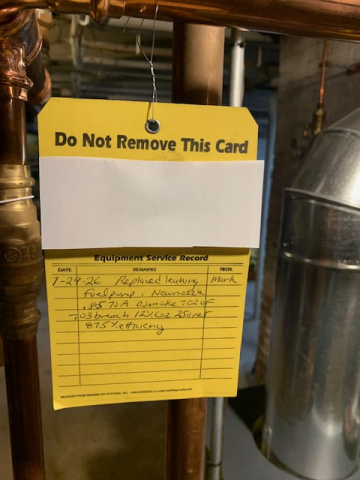

    ---The “1 Gal per Hr. for the “Burner Nozzle Firing Rate” noted above is stated on the Proposal to have the boiler installed.
    --The HVAC Tech who tuned the system wrote on the “Do Not Remove” tag that is hanging on the boiler system: “Nozzle .85”
    HYDROSTAT: MODEL 3250-PLUS
    H=Hydrolevel Company.
    --Has “Circulator Hold-Off Feature” that “Holds circulator off until boiler reaches 125F”.
    --I do not know if the “Hold-Off Feature” is active.
    VALVE TO CHANGE AMT OF BYPASS WATER FLOW:
    --Is installed as part of the system.
    --The lever that operates it has been disconnected.
    --Is hanging by a string tied to the copper pipes.
    D0nt worry about your photos, I have a picture in my mind what you have based on your description.
    I know that some of the details might be off, but at least AI included them in the photo of the boiler room. even if they are not in the right place. How's my idea of what your house looks like?

    Ed: In my earlier post I said - when describing the bypass - that the system in my cellar is just like a particular diagram of yours - only with a valve in the middle. I’m sorry to report that is wrong. The valve is downstream of the pump. I will post photos of the system to show exactly how it’s configured.
    TerriS: I hope the photos I plan to post will provide the answers to the questions you asked. I’m not sure if I have a 2-pipe setup or single nor if there are multiple returns back to the boiler. Also, when I commented LOL when you referenced an “ocean” in one of your posts….. I think I’m catching on that “ocean” is a term HVAC industry professionals use. I didn’t have a clue.
    I’m sorry I screwed up and gave the wrong information about where the bypass valve is located.
    The AI generated image you created, Ed, that’s pretty cool. Thank you for taking the time to make it and post it here. I’m going to study it but if it’s based on the wrong info I wrote about the location of the valve, I’m thinking I still should post photos? The way the boiler is situated resulted in the pipes being routed behind the boiler - maybe seeing exactly how the pipes are routed is another reason to post photos?
    Should I post the photos?
    The second image in your post: That’s a fine-looking house but nothing like mine. The design of my house is best described as Arts & Crafts or Craftsman with Swiss influences.
    109A_5 Posts: 4,759
    @HomeOwner7 Post your photos. That AI hallucination is goofy, it is only for amusement.

    Is it a HydroStat 3250 with an outdoor reset sensor installed? With the outdoor reset sensor installed the economy dial becomes the reset ratio control. If the reset ratio is wrong and the boiler temp is too low to satisfy the thermostat, the outdoor reset Thermal Boost feature will boost the reset temperature by ten degrees at thirty minute intervals, until the thermostat is satisfied. According to the literature.
    If the outdoor reset sensor is installed maybe try disconnecting it to let the 3250 Thermal Targeting take over and see if things improve.
    109A_5 Posts: 4,759
    Wouldn't that shut off the burner to limit the water temperature ?
    Also @HomeOwner7 stated " There is no outdoor temperature sensor on the system. "
    edited April 26
    I thought AI did a great job of confusing everyone. Just shows that Artificial Intelligence isn't ready to take over the job of boiler room repiping. My version of AI would be to use Actual Intelligence for setting up your nar boiler piping. Your installer may not have had any Actual Intelligence regarding flue gas condensation and why you dont want that to happen.
    Please post some Photos!

    Quote by 109A_5:
    “…That AI hallucination is goofy, it is only for amusement.”
    Quote by EdTheHeaterMan:
    “I thought AI did a great job of confusing everyone. Just shows that Artificial Intelligence isn’t ready to take over the job of boiler room repiping.”
    109A_5, Ed: I’d only given a quick glance at that AI image before I posted last time. The AI’s idea of what a system with those components would look like is bizarre. We can’t always trust AI, that’s for sure.

    Regarding the Hydrostat: I tried to find out what the Hydrostat is measuring and got what seems like two different answers. Online resources state Hydrostats measure the temp of water in the boiler, but a Weil McLain Customer Service Rep told me Hydrostats measure “the boiler block which is the heat exchanger”. “Boiler block” sounds to me like something other than water is being measured. Are those two answers essentially saying the same thing?
    I’m finding I’m not a big fan of the “learning/Adaptive Recovery” feature on the HoneyWell thermostat that was installed. I plan to disable the “learning” function and program it so I will know exactly when it is going to command the Boiler to kick on.
    I’ve been relying on the Hydrostat so far for temp readings of the water in the Boiler. I also want to get a good idea of the temp of the water leaving the boiler through the copper line, in the return pipes, and traveling through the bypass, and learned about a gauge that can be strapped onto the water pipes, so I went ahead today and ordered two of these:

    The boiler block is the Cast Iron Heat exchanger. The temperature the Hydrostat is measuring it the water inside the boiler or Cast Iron Heat exchanger. The Hydrostat typically has a Well that enters the Cast Iron Heat exchanger to sample the water temperature in a place where the Well is surrounded by water. The sensor is in the Well.
    109A_5 Posts: 4,759
    edited April 25
    109A_5 Posts: 4,759

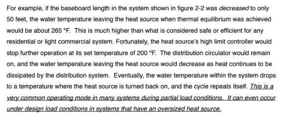

    Your overall system has so much water in it that when the boiler fires the water in the boiler needs to be almost stagnant until it gets to a temperature that minimizes condensation. Then slowly the water is circulated into the rest of the system while managing not to cool down the boiler too much. As the overall water temperature increases the water flow could increase. There are different ways to manage this process. Some work better than others. Some cost more than others.

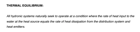

    The best information is gained by observing the boiler operate. Set up a chair and record data there.
    When you fire up the zones, how long does it take for the return, right at the boiler, to reach 130°? Ideally every time the boiler fires it should reach 130 within 10 minutes or so. If you can do this on a cold day you get a realistic pic of design day operation. Record data on a mild heating day also to notice the run time differance.
    The boiler also needs to operate long enough to assure the venting warms up to prevent condensation damage in the flue or chimney. A good run cycle is around 10 minute to warm return to 130, and a 20 minute run cycle when fired.
    These numbers crunch together to determine your "run cycle"
    In a perfectly sized system, the boiler would run non stop on your coldest design day. The boiler adding heat energy at the same rate the home ids losing energy.
    With todays modulating boilers that is quite attainable. You system will cycle as loads change, shoot for longest possible run cycles.
    The best boiler protection methods are like "slipping the clutch" blending the flows as the boiler operates at a safe temperature. This requires a device that measures and responds to temperature at the boiler. It can be a valve, or and injection pump piping method.
    It always comes down to how much time and $$ you want to invest to getting the best results?
    This slide explains the various efficiencies, and the bottom line to where the boiler is actually running. In this example the boiler on for 5 minutes, off for 20. The run fraction is 20%. Plotted on the graph the boiler is running below 80% efficient, around 75% or less.
    Notice the steady state is more like 84%, a realistic number.

  • TerrS
    TerrS Posts: 203
    We really need to see pictures of his boiler setup i need to see his return and supply lines. Because with those pipe sizes he is boiling 2 oceans of water to 180 degrees
