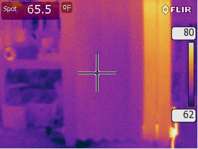

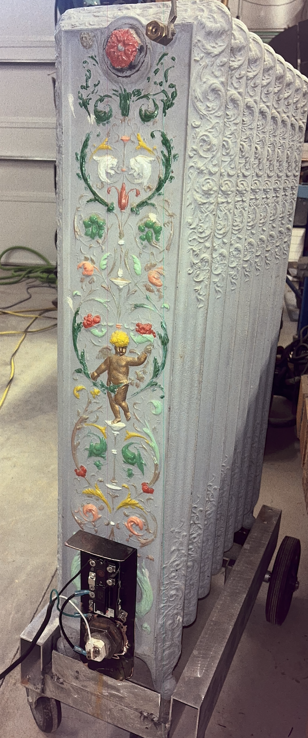

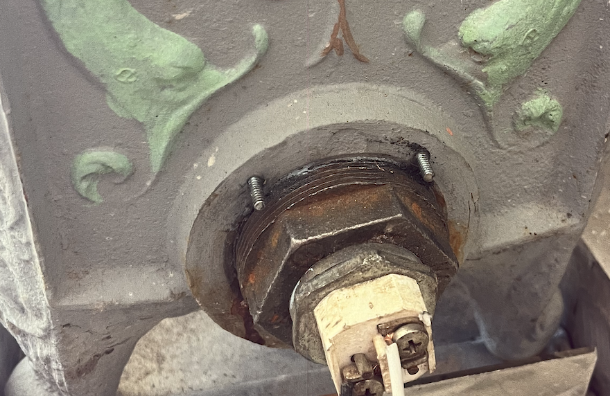

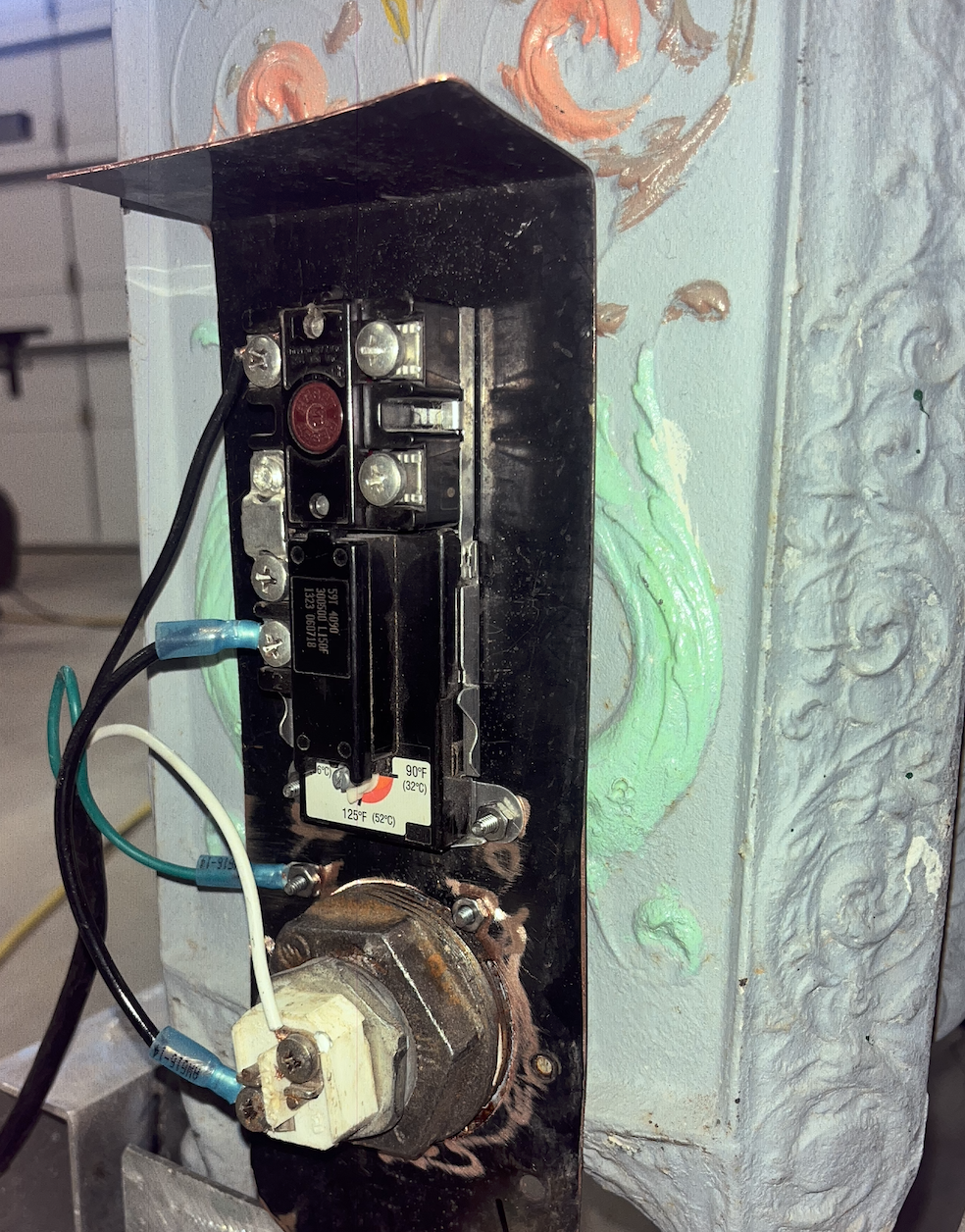

A put a 1500W 120V elememt into one end, filled the radiator about 80% with water.
A copper sheet bolted to the radiator with some tapped 6-32 studs epoxied in. A ty
typical electric water heater overload and t-stat. Set at 150°
Vent cap is loosened so no pressure build up.

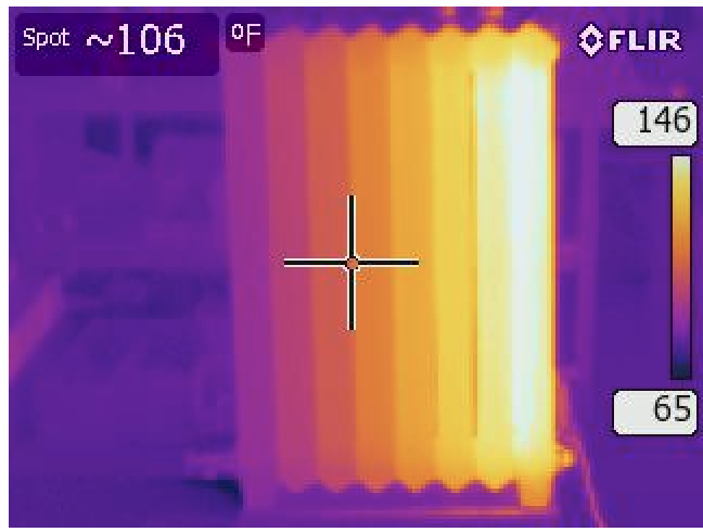

Pic shows 15 minute and 1 1/2 hour run time.
Electrical cover in the works.
Screenshot 2026-10-28 at 8.09.41 AM.png Screenshot 2026-10-28 at 8.09.24 AM.png Screenshot 2026-10-28 at 8.01.54 AM.png Screenshot 2026-10-28 at 7.59.37 AM.png

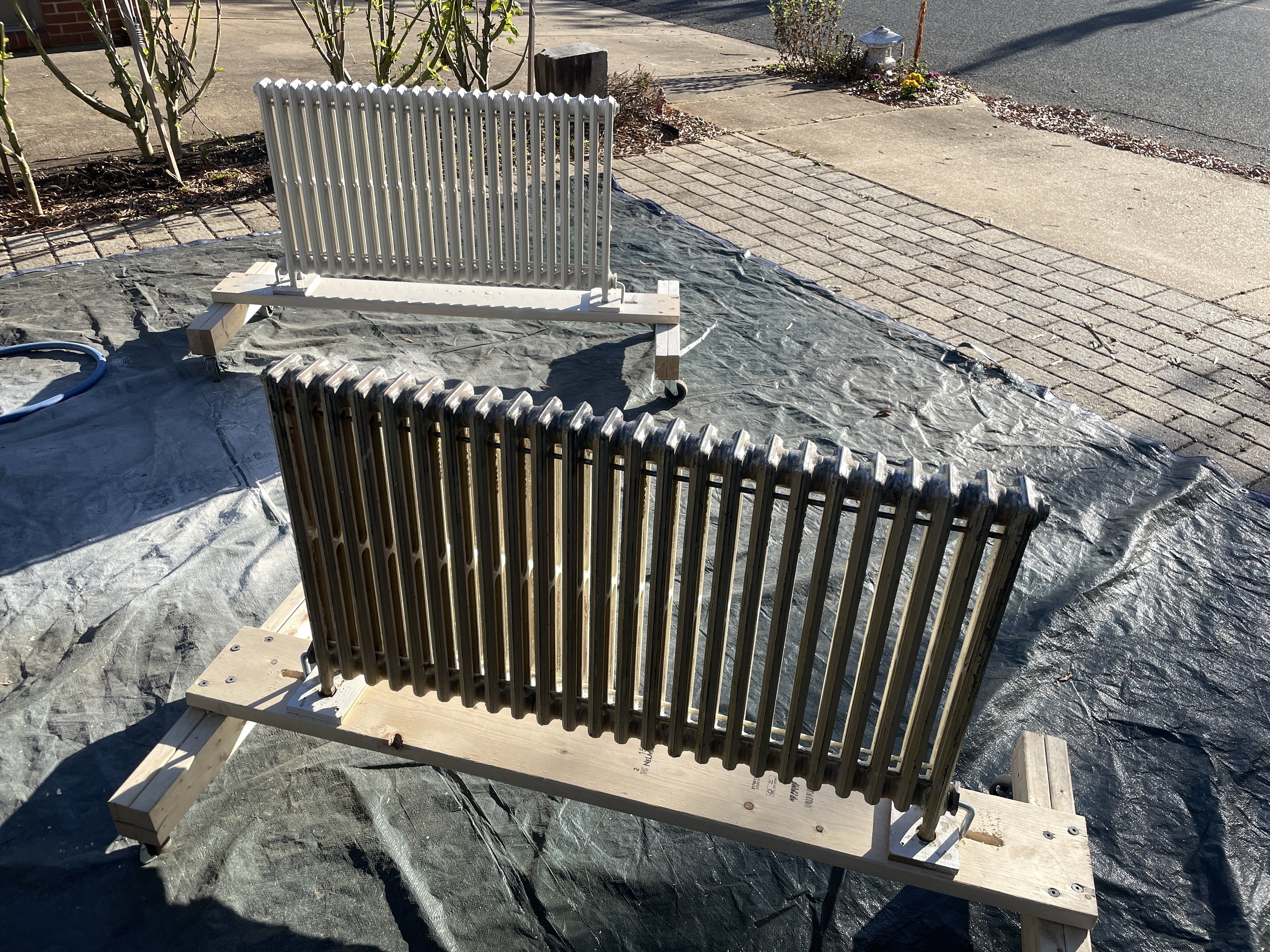

    nice radiator, cart makes for nice portable heat.
    Just built a couple carts for two radiators I am stripping and repainting

    doesn't castrads do that? is that an arco detroit pattern or whatever they call it?
    could probably put a small rupture disc in the vent like they do with pressure cookers.
    EBEBRATT-Ed Posts: 21,243
    Just needs a low water cut off, a water feeder and a sight glass.
    and a humidity control to control the steam coming out the vent.😎😎😎😎

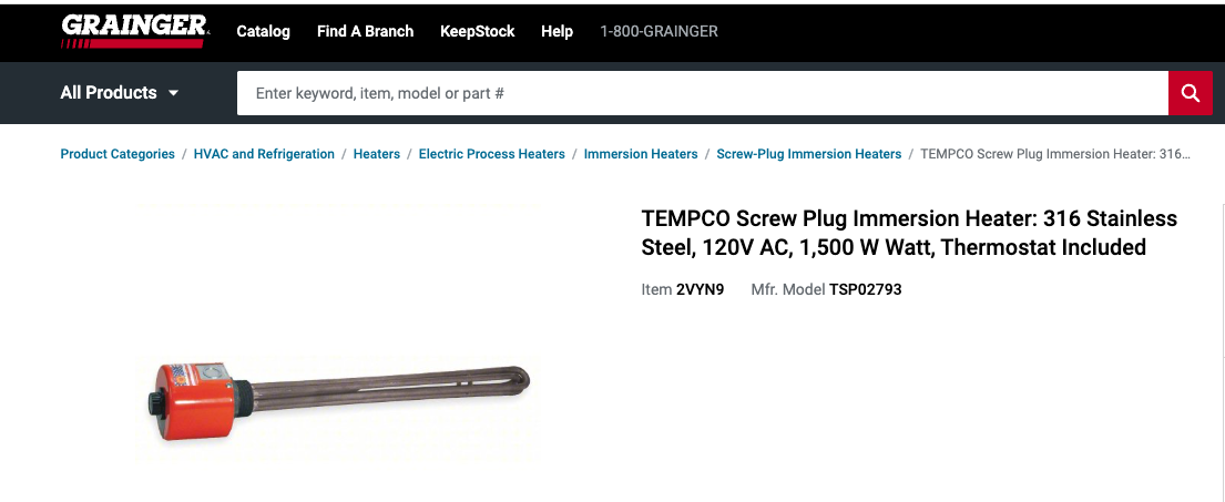

    hot_rod Posts: 28,593
    Something to set next to the desk for intermittent use.
    Yes, you can buy factory built elements. $329. for this one pictured.
    This was built with misc parts in the shop.
    If you have expensive power, just use a 1000W element😉
