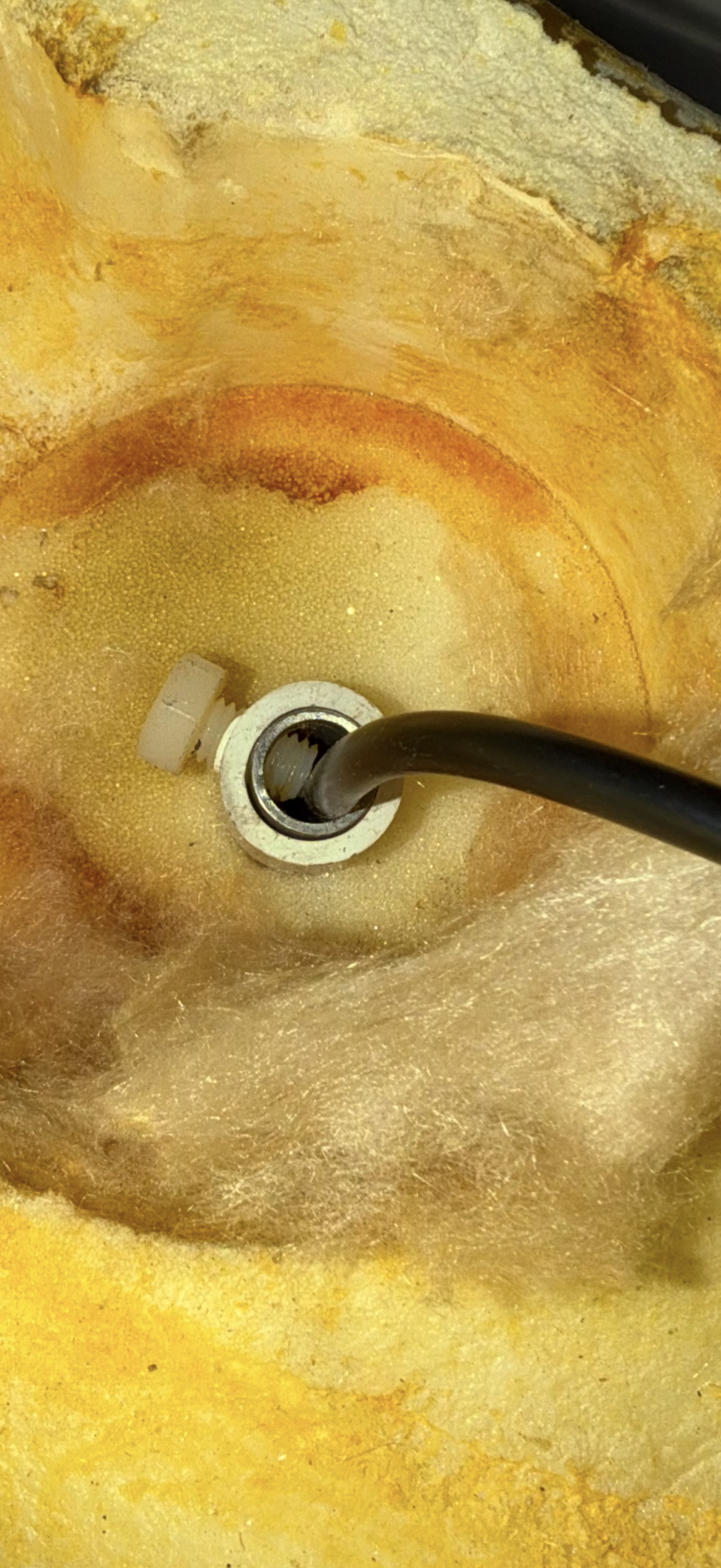

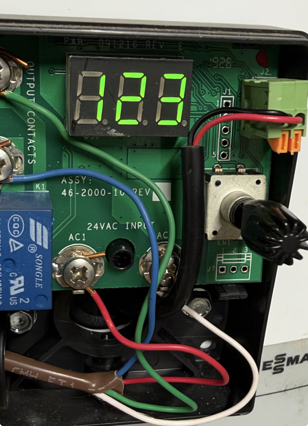

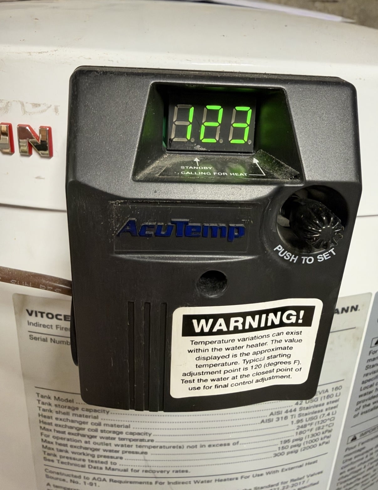

I have a Viessmann Vitocell EVIA 160 indirect water heater.
After taking a quick 7 minute shower and then doing the dishes, the water was not as hot as it usually is. I also did not hear my boiler fire up as I was washing the dishes like I normally hear.
I have pin pointed the POSSIBLE issue to the temperature sensor. I removed the temperature sensor from the TS Well to see what I’m working with. It’s a black cable with a metal cylinder on the tip.
I blew on the metal tip to get it to cool down and then the boiler turned on and the valve opened. I put the metal tip back into the TS Well and the boiler shut off after a few seconds.
So I believe the temp sensor may just be out of spec or something. Is there a chart for me to measure resistance / temperature? I’d also like to have the part number so I can order the correct replacement.
I also confirmed the boiler was working by turning on my hydronic slantfin baseboard heat.
Here are some pictures. I forgot to take a picture of the metal tip.
Thank you
  • Seems that the sensor has lost its calibration, like you said. You may only need a new sensor (20K?), but here is the whole kit. Doesn't get good reviews.

    I ordered and installed the AcuTemp model. I replaced the temperature sensor and the control unit thing.
    The old temp sensor measured good according to the 10k ohm chart you guys posted. It matched the new one. But I just replaced everything.
    Thanks.

  • A few years back, I took over maintenance for a property that had about 28 of these controls on Weil Maclean indirect water heaters. About once a month , we would have these controls fail or just plain act odd , and I would have to replace them. So I called the manufacturer, And what I was told , these controls are very fussy on power supply. Terminal AC1 has to be connected to the C terminal of the transformer. Terminal AC2 has to be connected to the R terminal of the transformer. Tech support also told me this control should be the only item on the transformer. And the AC1 terminal should be grounded to the tank. If the transformer terminals are not marked, Take a voltage reading on the transformer terminal to the ground and the one with the lower voltage should be the C terminal. I discussed this with my electrician, he said it sounded right , but he didn't like the idea of grounding it to the tank. I put every control on its own transformer wired to the terminals as directed and haven't had a problem since. ( Never done the tank ground though)
