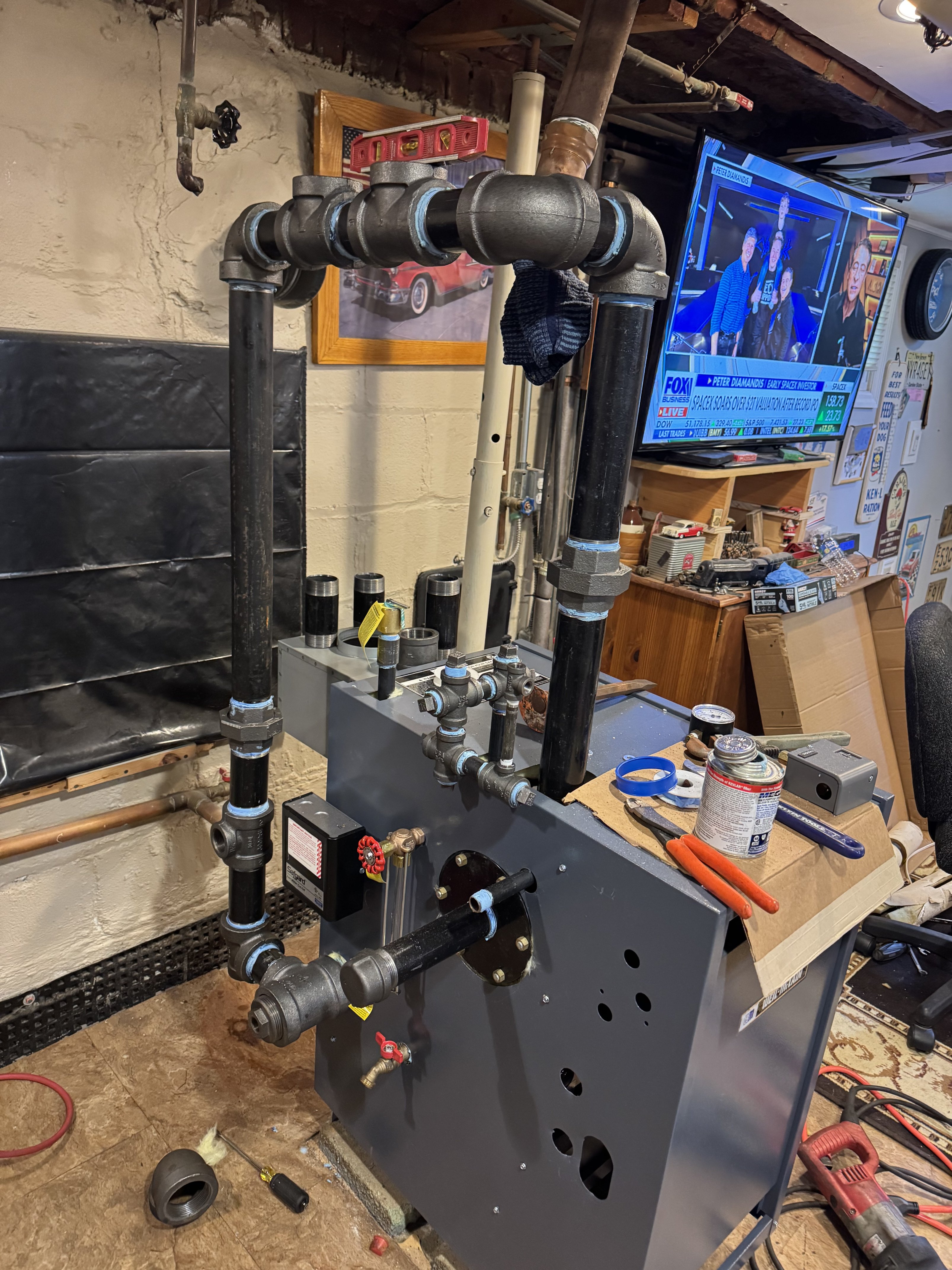

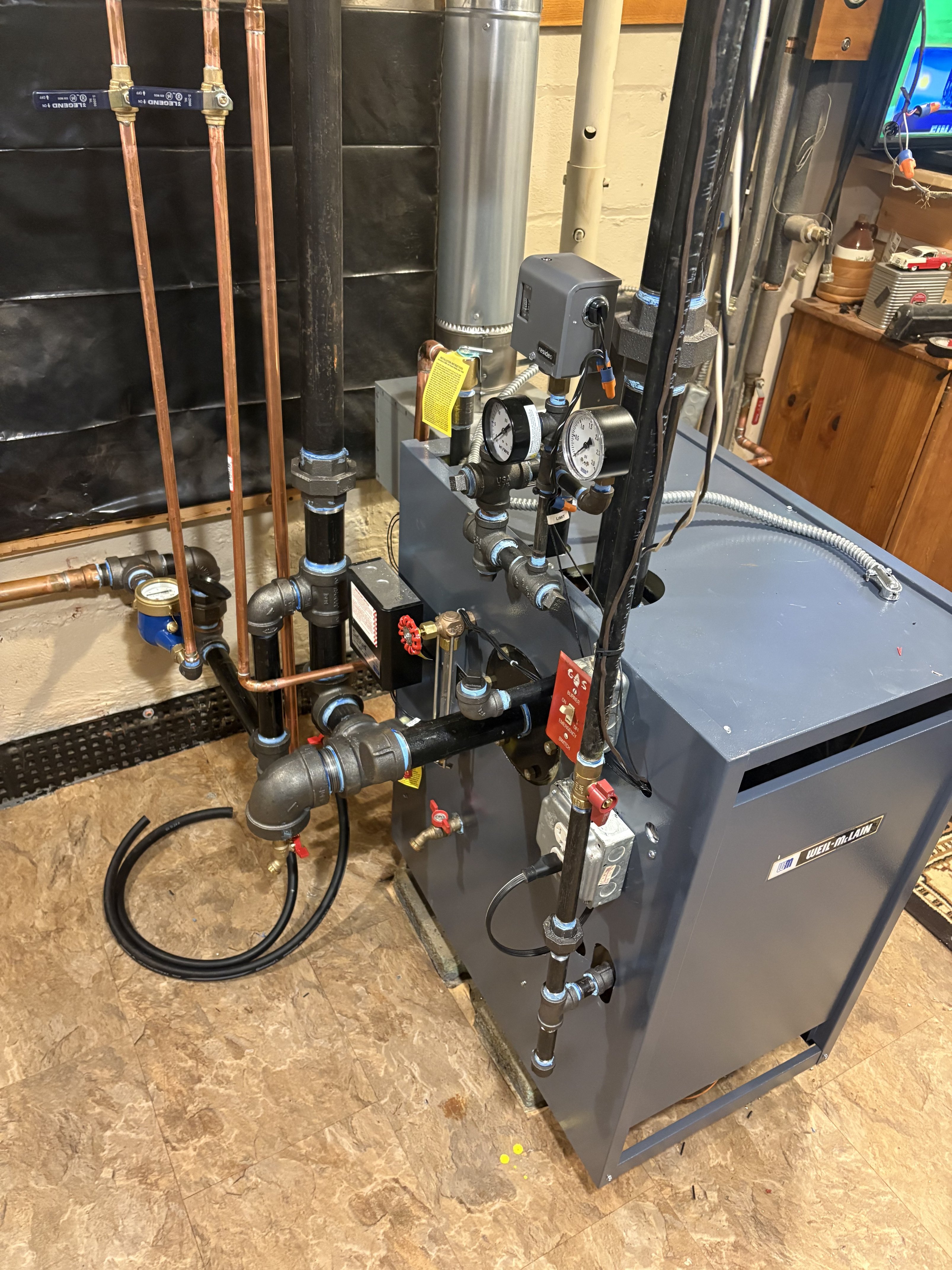

Replaced another Steamer

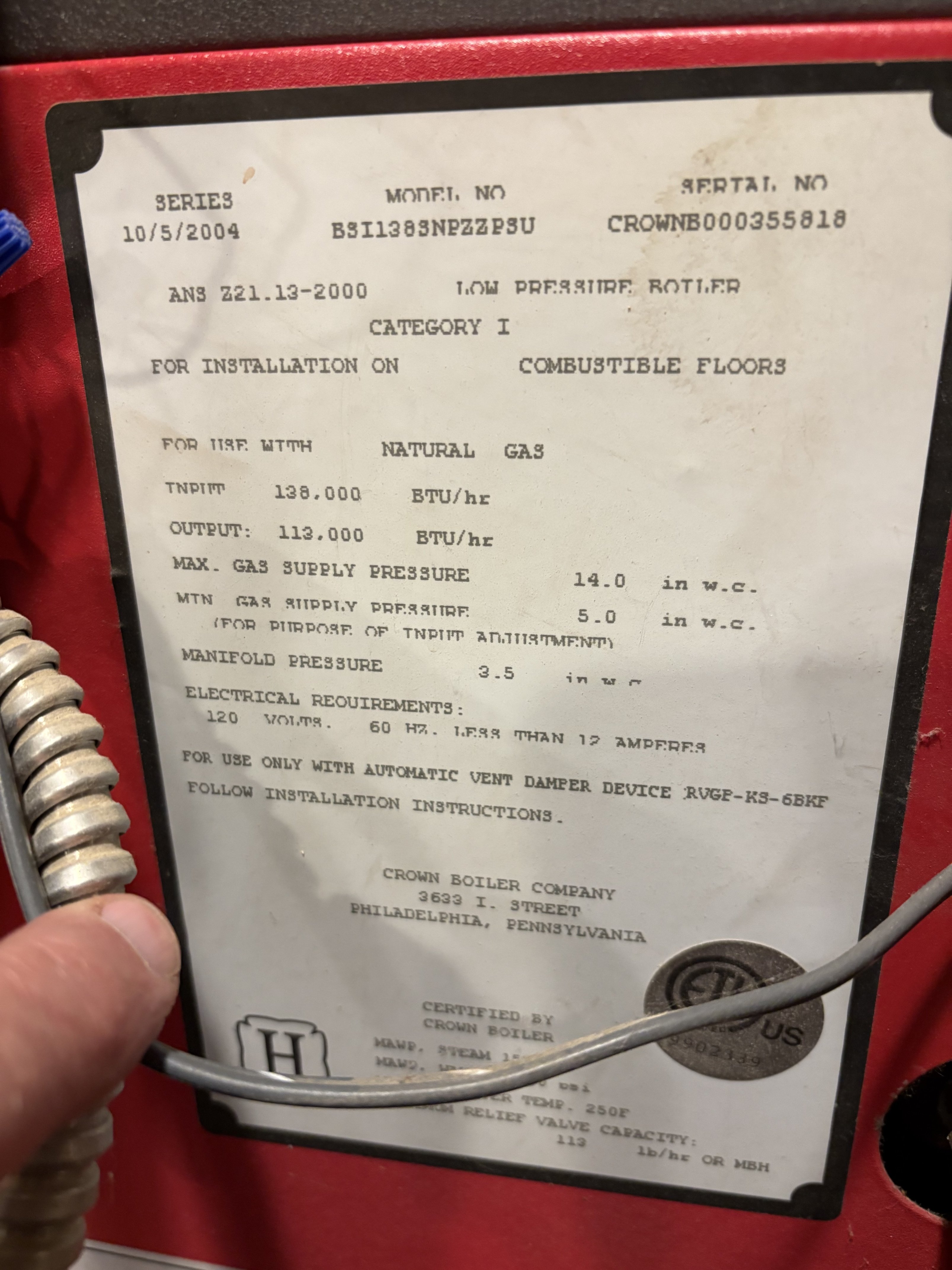

A good friend asked me to replace his rotted Crown that he installed himself back in 2004, which he oversized by a lot. He only had 178 sq ft of connected load so I put a EG30 with tankless in for HW loop. Simple little install no elaborate piping just a 2” header, and it works beautifully. The homeowner did the electric himself because he had some convoluted generator setup for it.

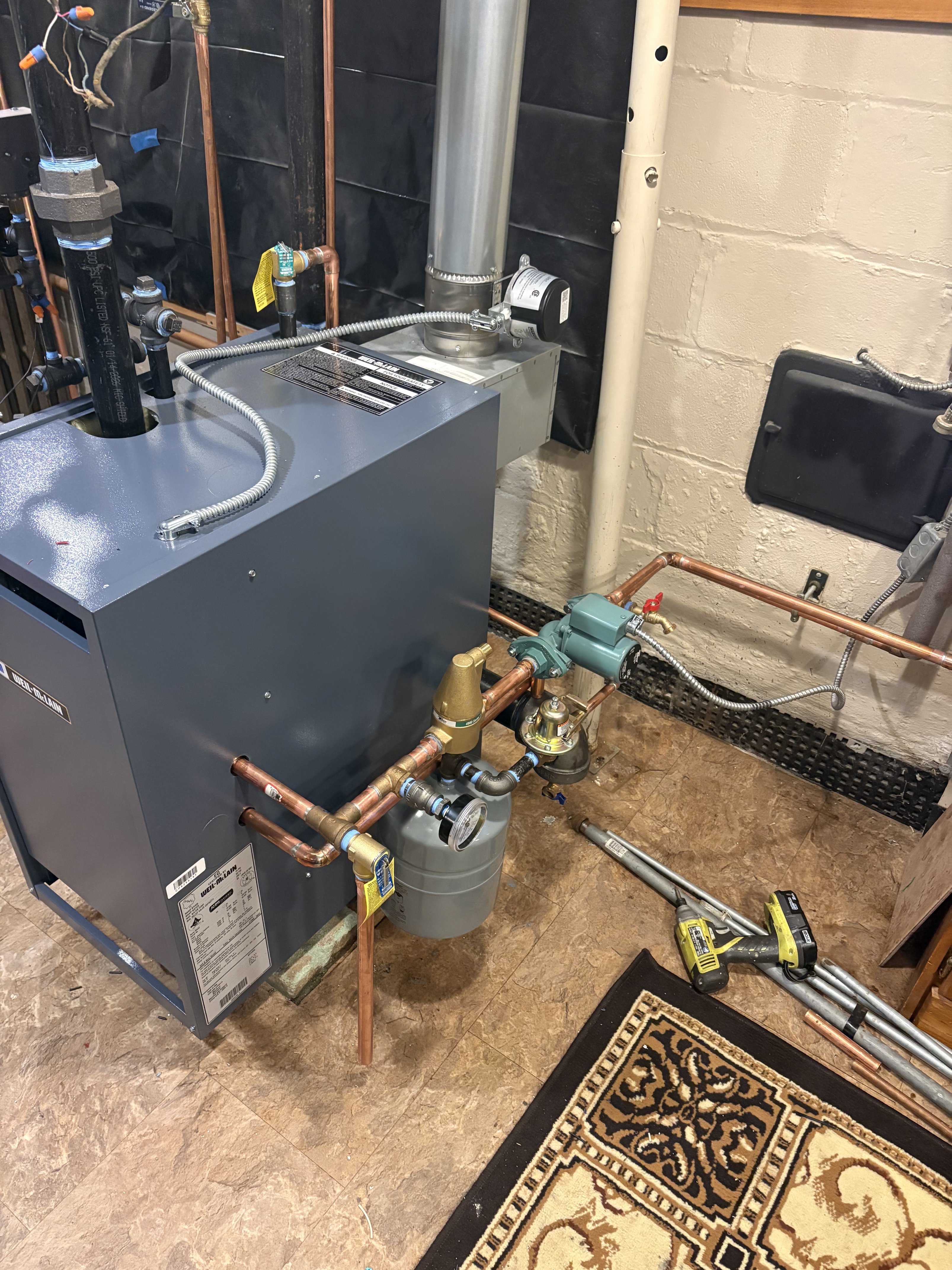

Looks great! Does the pressure relief valve need to be installed vertically?
Wow look how long the wire on the vent damper is.
Did they start doing that so it can be mounted up away from the drafthood?
I replaced the wire on mine so it could be up out of the way when I tried out the barometric, but decided to leave it because the motor was in a much cooler location.
even has a water meter so you can tell how much water it actually is using.
Yeah it’s in Livingston NJ they have really bad water there

Hey @Dave0176 have you ever had an inspector give you crap about having a hand-built water trap like that for the pressure control and gauge?
Mine in Cedar Grove made me remove it and put a pigtail back on
@ethicalpaul I never had an inspector question a homemade water trap. There is something in the code if you build one it has to be a minimum pipe size to use black pipe. I think the minimum is 1/2" if black. Can't remember if the plugs for clean outs are mandatory although a good idea. It's been too long.
1 -

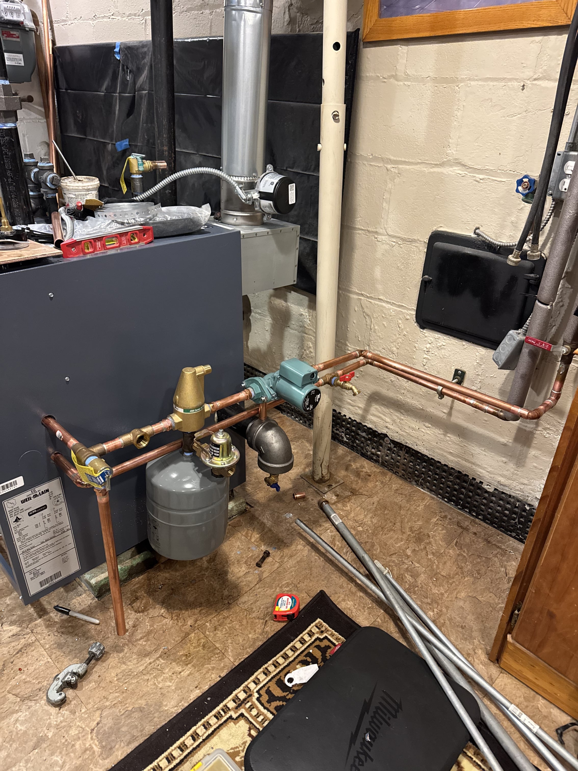

yeah I don’t know what the one on the side is for
@ethicalpaul the one on top of the boiler is for the heating system. he is using the boilers tankless heater to heat a HW zone which is why it has its own expansion tank.
Water heater frequently have a T & P valve on them mounted horizontal. IDK if that valve should be verticle ot not I suppose it should be but I don't see a problem.

@ethicalpaul Only once has an inspector had an issue with the water trap and it was In Brooklyn NY he wanted me to resize it to 1” and still put the pigtails on, so of course I did not argue and did what he asked. In NJ never been an issue.
DL Mechanical LLC Heating, Cooling 732-882-2267 Specializing in Steam Heating
1 -
And yet, that inspector would probably fail you if you used two pigtails in line and that's exactly what he had you do.
You mean like this?
