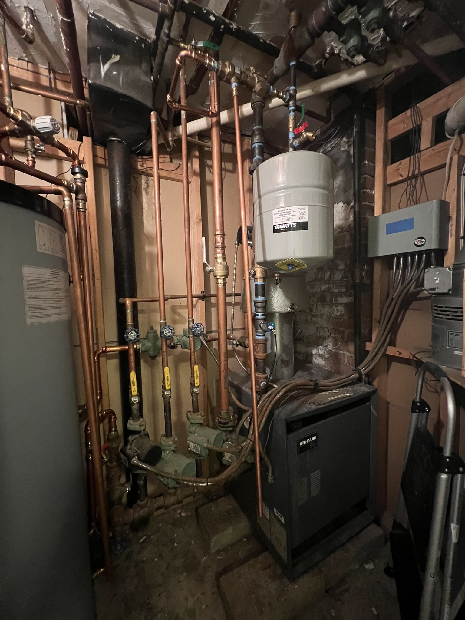

I moved into a house last year with a Weil McClain CG hot water boiler.
It has 4 heating zones and a domestic hot water zone connected to a
storage tank. The largest heating zone is for the 1st and 2nd floors of the
house and contains 12 cast iron radiators. The other 3 heating zones are for the
basement, kitchen, and attic zones which are all baseboard heat.

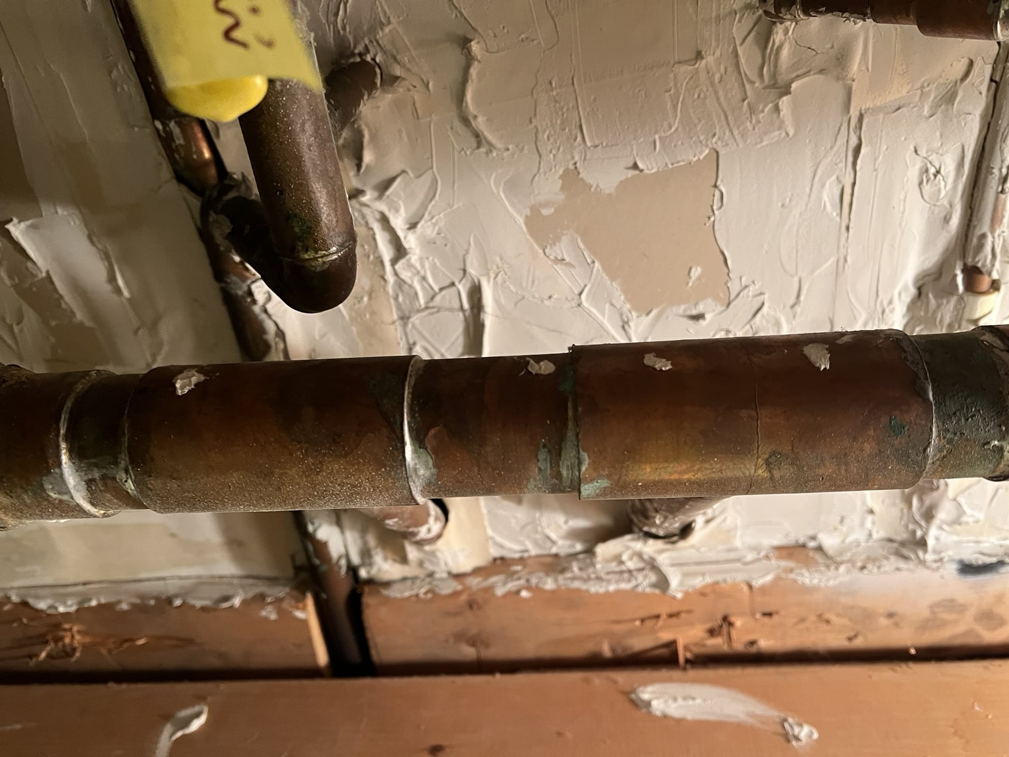

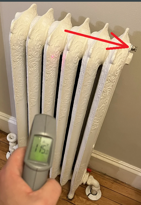

When they did this work they accidentally ordered the wrong size
spirovent air eliminator for 1.5” diameter pipe even though the piping coming out of the boiler was 1.25” in diameter. They went ahead and adapted from 1.25” to 1.5” to
add the spirovent air eliminator and then reduced back to 1.25” before
any of the flow checks or take offs to the cast iron radiators.

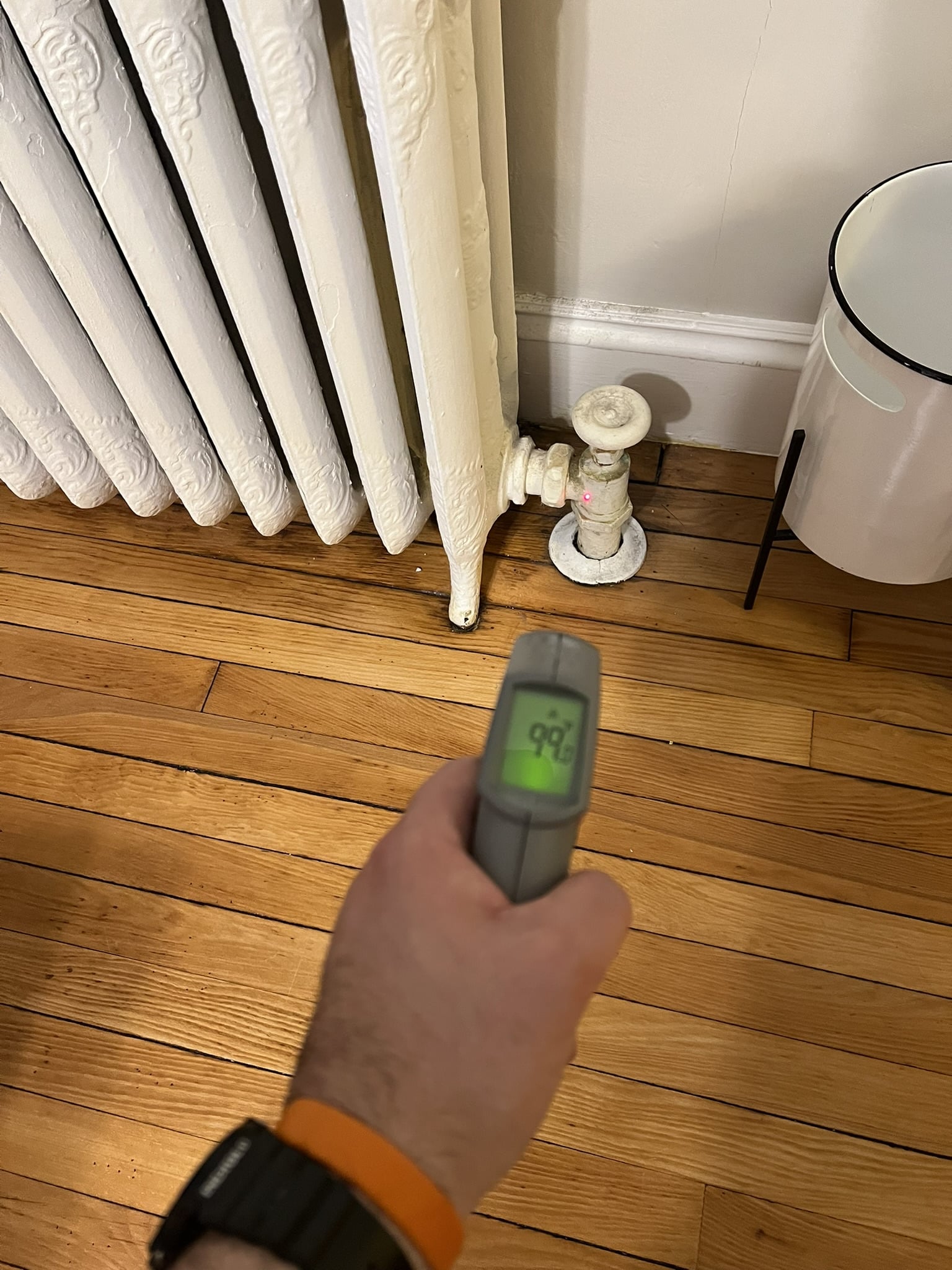

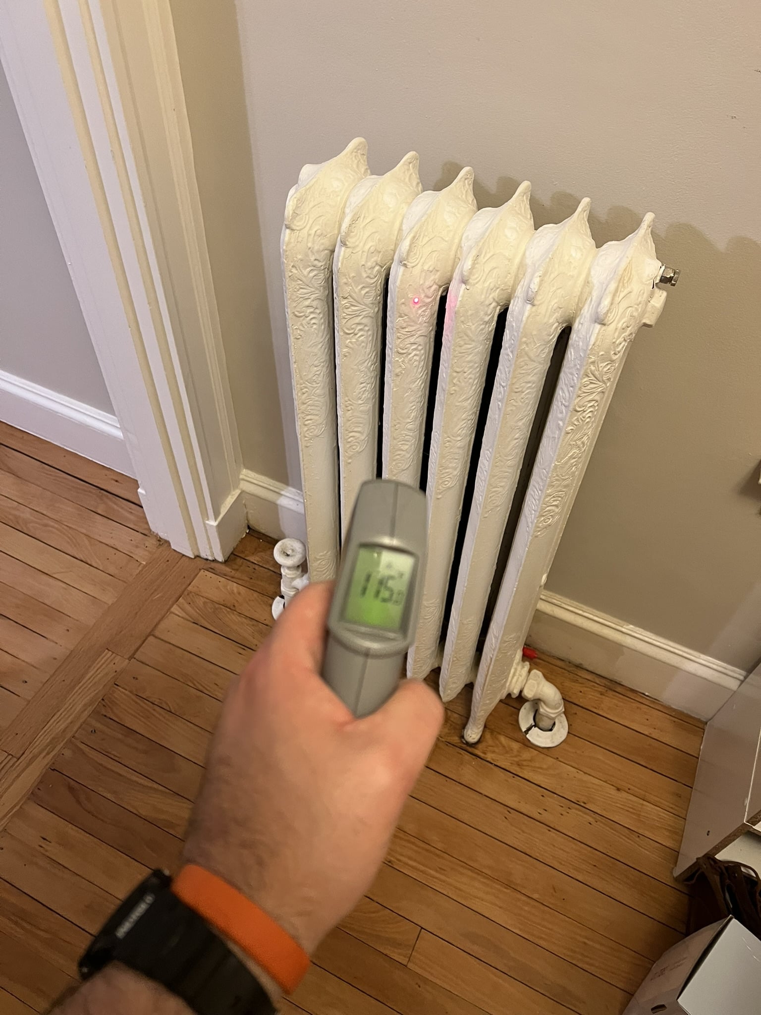

They had to drain the system to do this. When they connected it all back
and repressurized the system, 2 of the radiators furthest from the
boiler no longer heated well or at all. One radiator gets warm at the
handle, but even after 2-3 hours will not heat. The other radiator will
get warm (around 115°) but not hot like the other radiators that work (which all reach
about 155°).

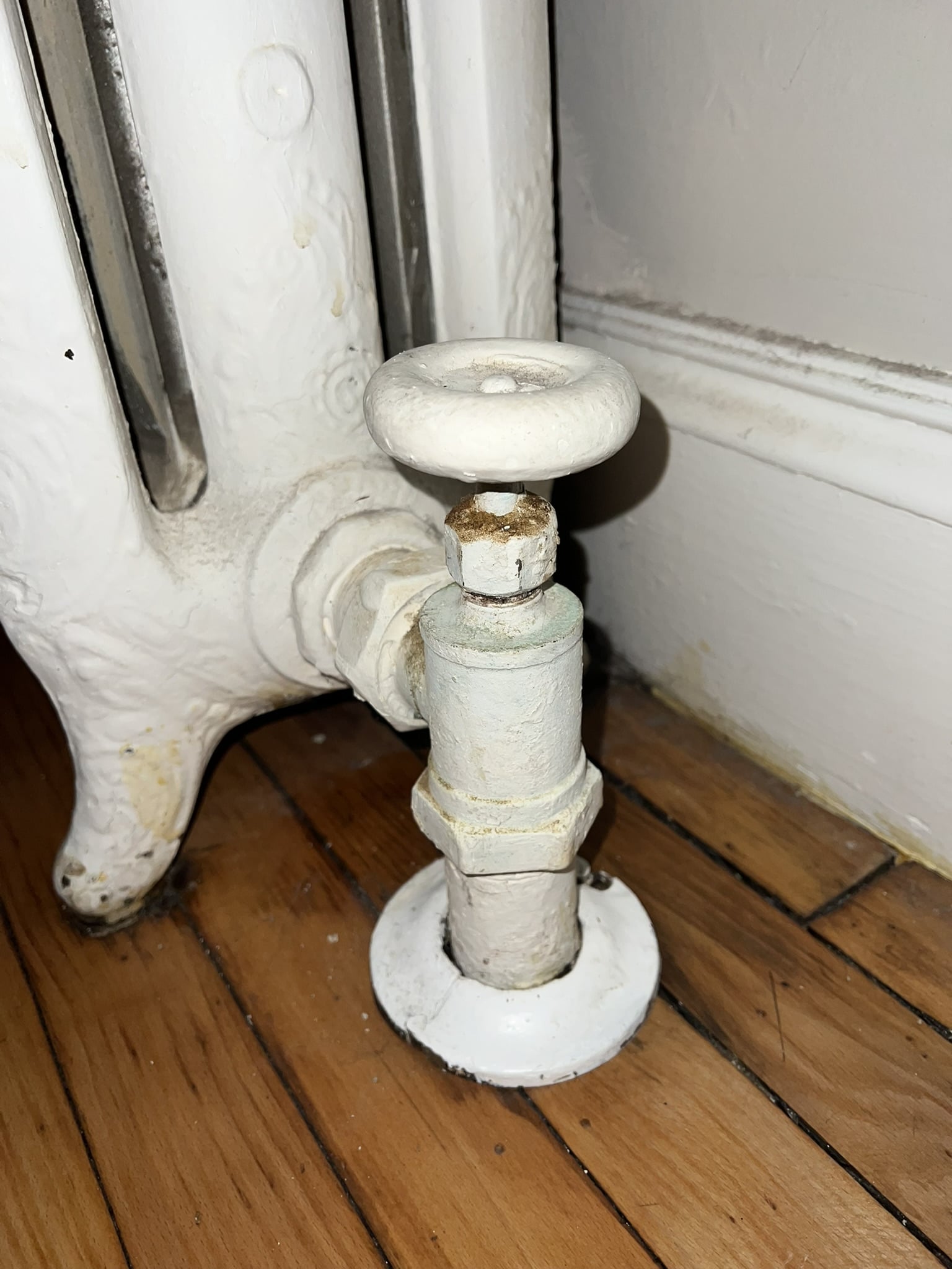

The tech thinks the radiator handles at the non heating radiators may
have disintegrated or have something broken to be causing a problem. The radiator that heats to115° seems to be heating backwards from the return to the supply valve
and the other non-heating radiator isn’t really heating at all - it just gets warm
at the supply valve handle. The tech is suggesting replacing the
radiator valves on the 2 problem heating radiators to fix the issue.
I’m wondering if the problem is the radiator supply valves or instead
the increased 1.5” supply pipe size out of the boiler that is causing
a flow/ short-circuiting issue (or something else I’m thinking of).
Everything was heating well before, which is why this is so frustrating.
What do you all think is going on? Could a 1/4” upsize in diameter of a couple feet of
that supply pipe cause this issue or is more likely to be the individual radiator valves for the 2 problem radiators? Please let me know what you think! Thank you in advance for your help.

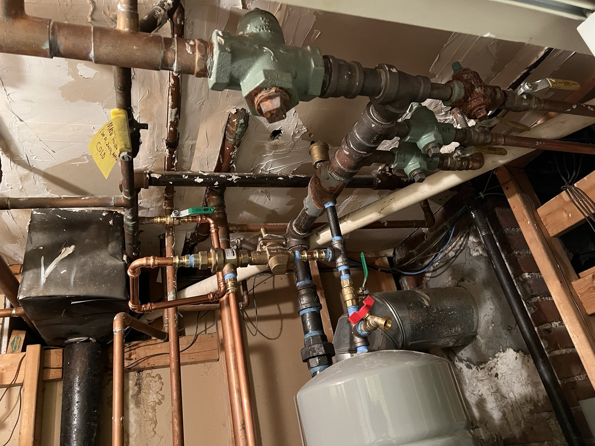

Weil-McLain Model CG Hot Water Boiler.JPEG Weil-McLain CG Boiler Card.JPEG System Pic.JPEG Supply From Boiler.JPEG Supply from Boiler Pic 2.JPEG Supply to 4 zones with flow check valves.JPEG Large Flow Check to Cast Iron Radiator Loop.JPEG Returns to Boiler.JPEG Radiator #1.JPEG Radiator #2.JPEG Radiator #2 handle.JPEG Radiator Valve Handle.JPEG

    I would highly suspect the old valves at the radiators, AFTER making sure they are free of air. You made this statement:  "has lines that  T off of the main line at different points:" Are these "monoflo T's"? If so, these can be problematic.

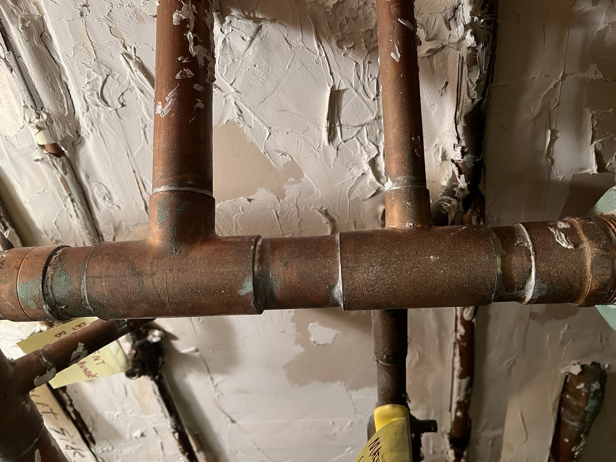

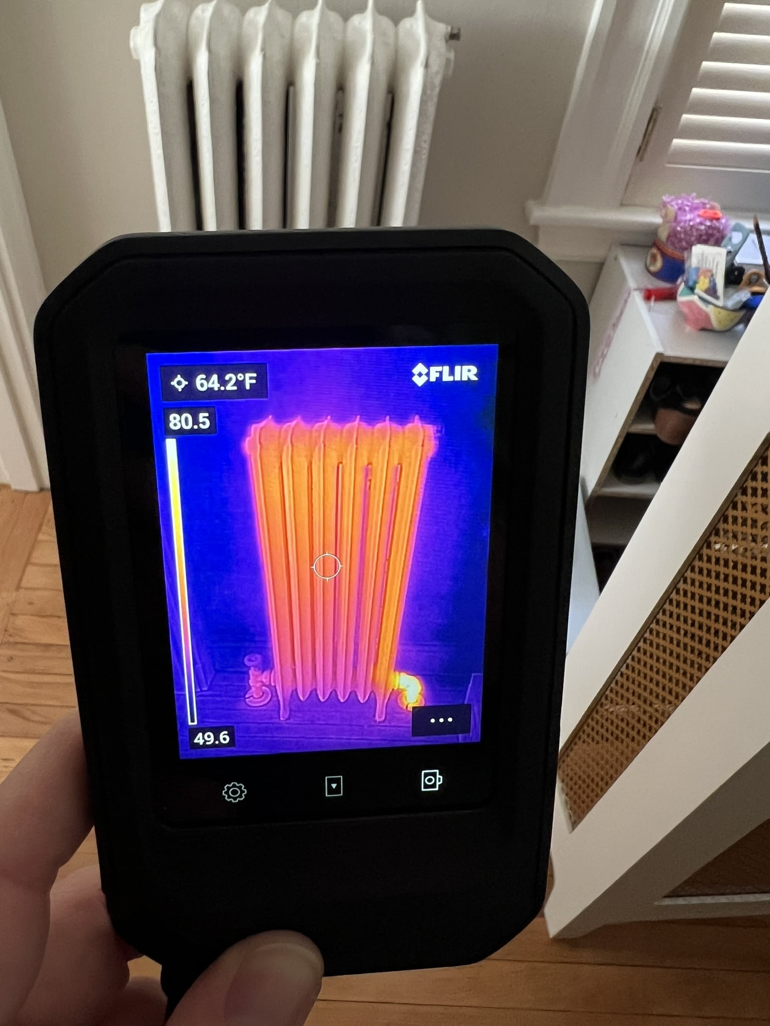

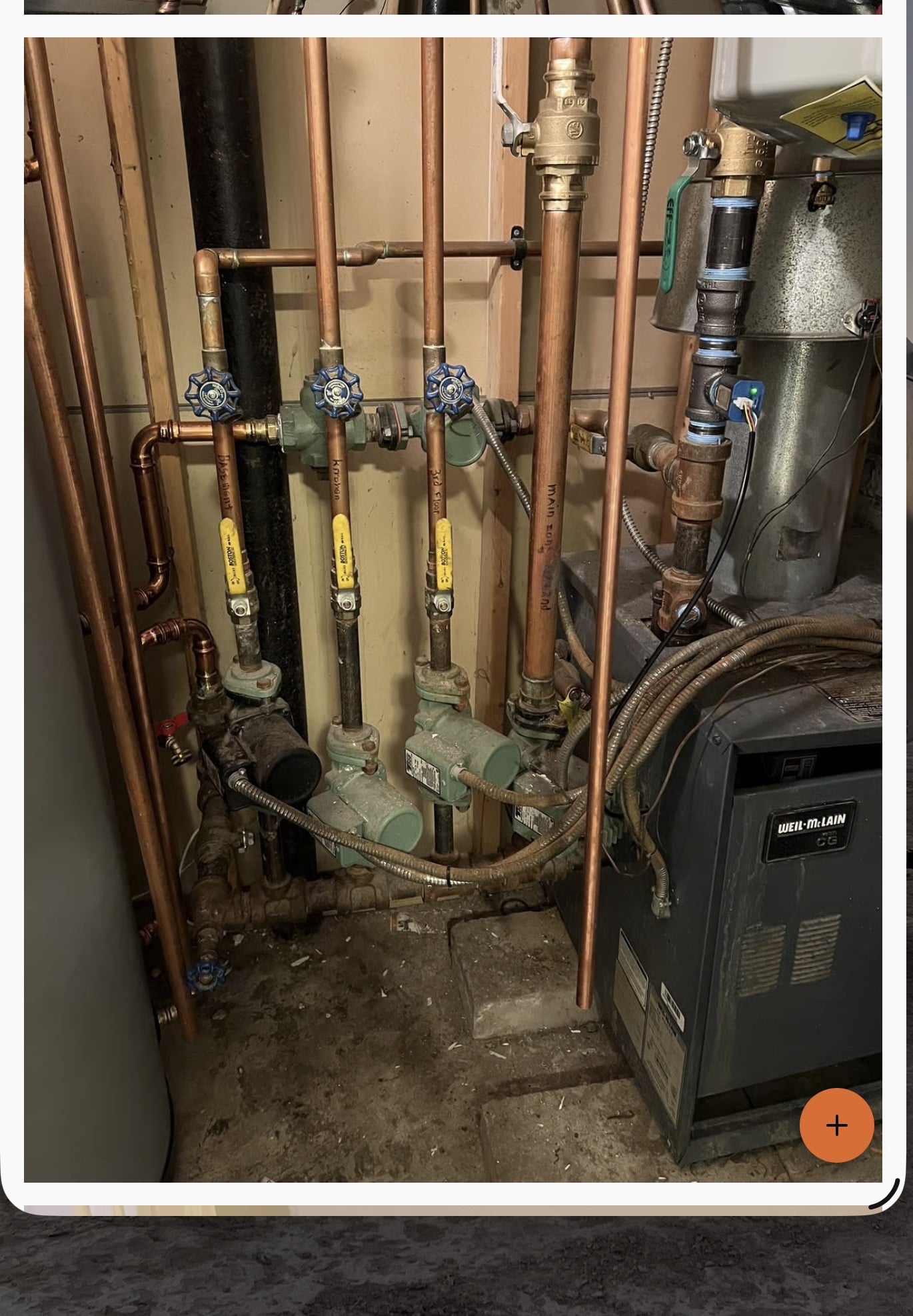

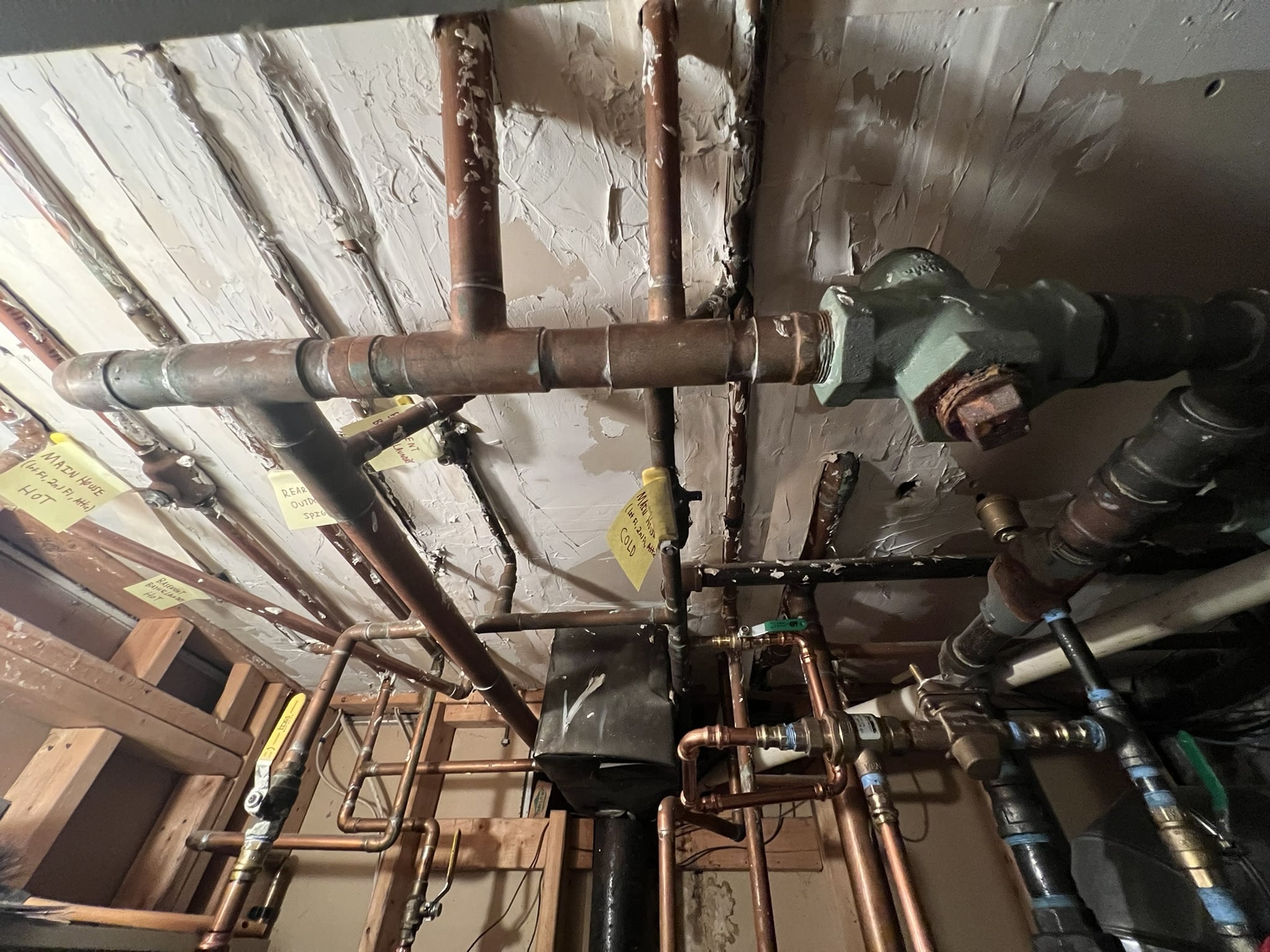

    hot_rod Posts: 28,696
    maybe try manually opening those green flochecks, see if that changes flow,

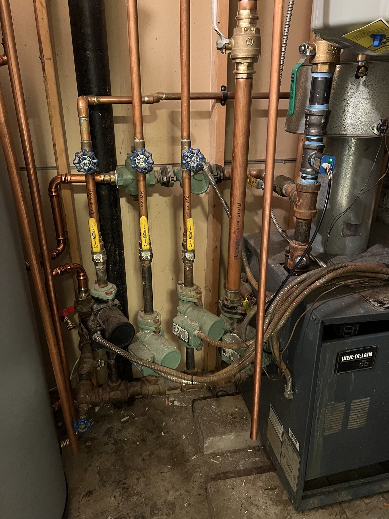

    looks like you have individual purge points on every zone, should be an easy purge. Raise pressure to 25 psi to purge.
    Sadly circs are on return. One on the supply for some reason,but before the purger and exp tank?
    If they were on the supply pumping away it would self purge in minutes 😉

    @pecmsg - I tried bleeding the individual problem radiators from the bleeder valves again while the heat was running. No air came out - only cool water. I also tried opening and closing the ball valves for the supply and return on the cast iron radiator heating zone while the circulator for that zone was running - I don't think that did anything.
    As of now the heating company is planning to come back next week to replace the supply valves on the problem radiators. I really hope that fixes them, but if anyone else has other ideas or thoughts on this, please let me know.

    This may be too obvious, but did they ever touch (close) those radiator valves during their work? The closeup of the one radiator valve shows paint and crud on the stem, looking like it hasn't been closed in a long time. And if they didn't close the valves, how are valves now the problem? If air is in the system elsewhere, replacing the valves is only going to add more air…
    And what is your water pressure now? Try raising to 20 psi

    maybe the circulator is locked up, or not getting power.
    Does it get really hot when powered? That can indicated a locked impeller.

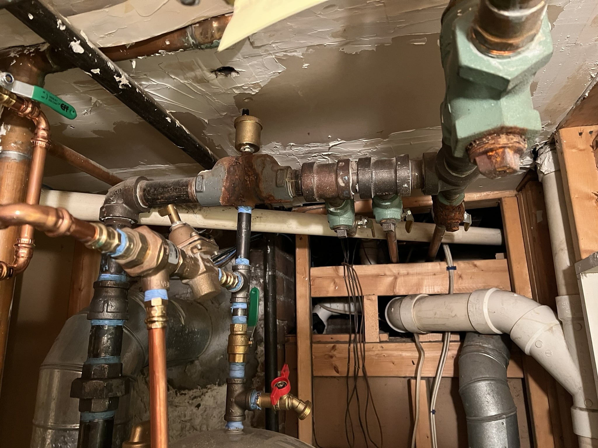

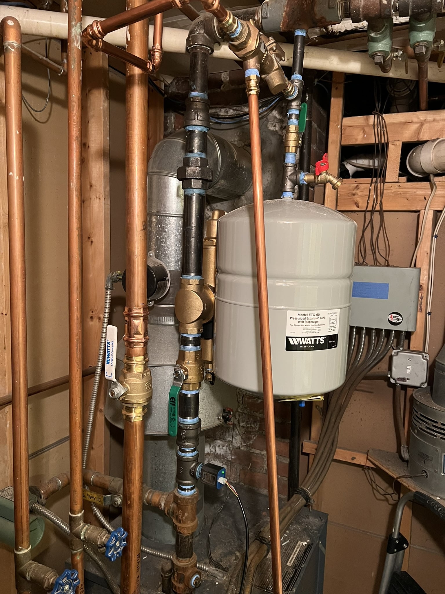

    So I will ask this question: "Is this a before or after photo? If it is an after can you point out the Spirovent?"

    @jesmed1 - I don't think the techs touched any of the radiator valve handles. After a couple of hours with the heat on, I tried to touch the valve to see if it would move and when I did the packing nut started to loosen as I turned the handle. It was all basically stuck together so I left it alone ; I didn't want to cause it to leak. The lead tech said something in the interior of the valve could have broken or disintegrated causing an obstruction. He did say it's an unusual thing to have happen, but there was always a chance it could happen when the water was drained and then system was filled back up. It looks like the pressure gauge on the boiler is reading 22psi right now. That's around where I've seen it when things were working before this work was done.

    @hot_rod I don't think the circulator is the issue, but I'll check it again the next time I run the heat. I think I did touch it after the problem started and didn't notice it being too hot, but I'll look again. There are 12 radiators on this zone and 4 of them on the 2nd floor are getting plenty hot all around the same time as each other. One working radiator is actually one room over from the problem radiators. I think if the circulator weren't working, they wouldn't heat very well or at all.

    @EdTheHeaterMan - I know, I'm kicking myself a little bit now, but the intent was to be prepared. I had several radiators enclosed with permanent covers that were completely inaccessible and I needed a contractor to make access to the covers and cut some small holes in some areas in order to make access to change the radiator bleeder valves. I didn't want to get into a situation in the dead of winter where we had to drain the system to change a circulator pump or something and then not be able to bleed the air from bleeder valves that were inaccessible or broken. It's an old house from early 1900s and we've already had to do way more work than I wanted to do under more urgent circumstances. At the same time I figured better venting with the spirovent would be prudent etc. Anyway… As you said, what's done is done and now I just need to fix it. See below for a few pictures of the spirovent including packaging. The photos I attached are all AFTER photos so what you circled in your pic is the old air eliminator which they left in (I suppose they could have just plugged it). It's hard to see the spirovent in the pictures because it's behind the Watts expansion tank on the vertical supply piping coming up from the boiler (right above the green ball valve handle). I included a few different angles in the pictures below.
    EdTheHeaterMan Posts: 12,931
    Yep there it is! Hiding behind the expansion tank.

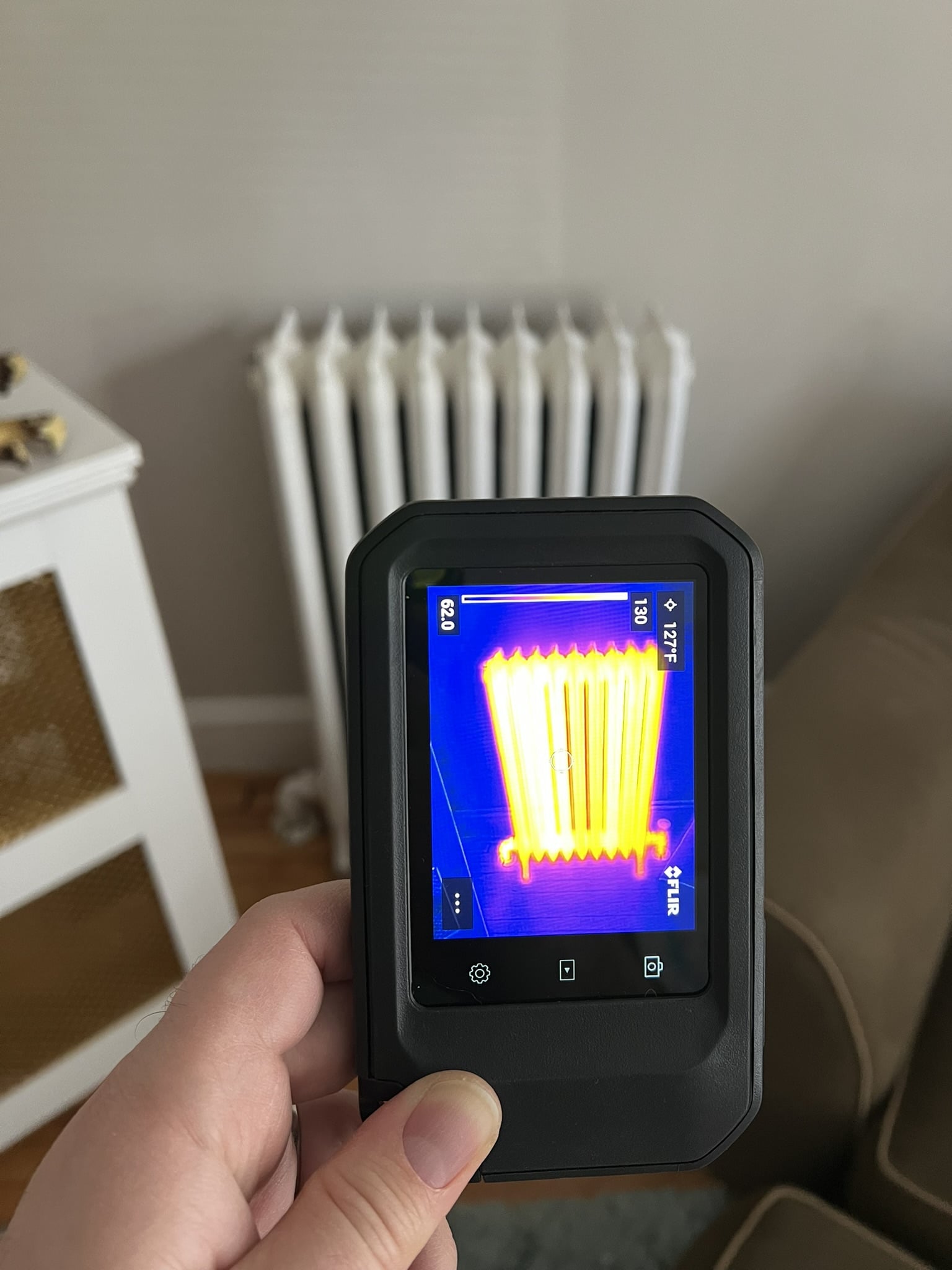

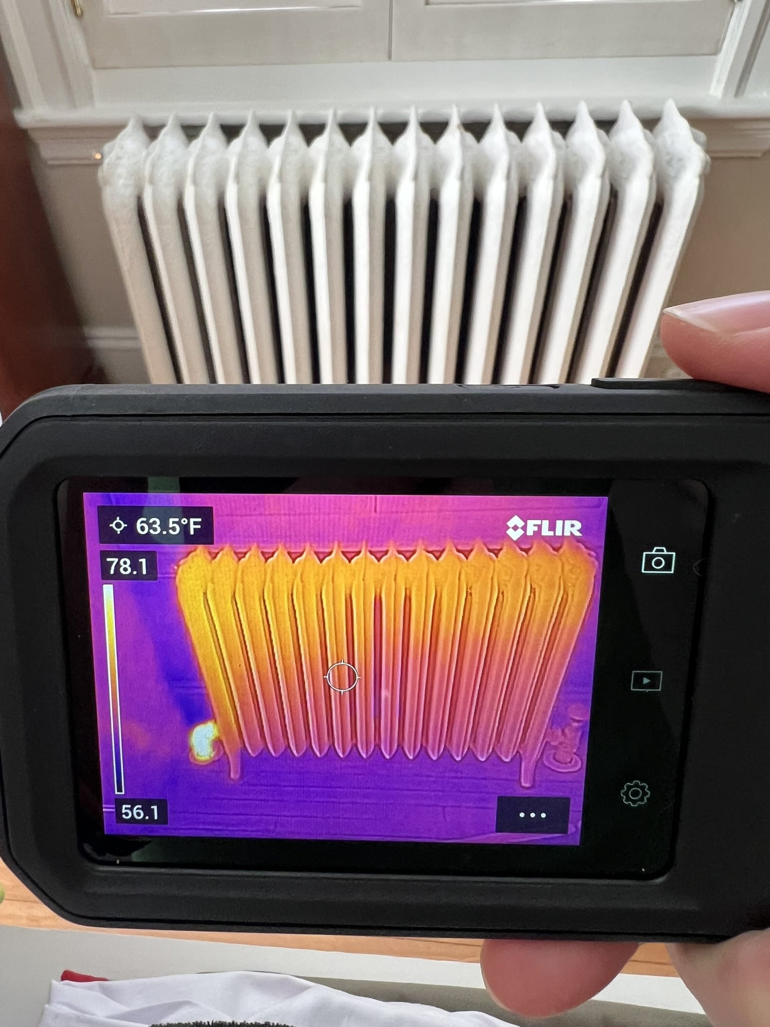

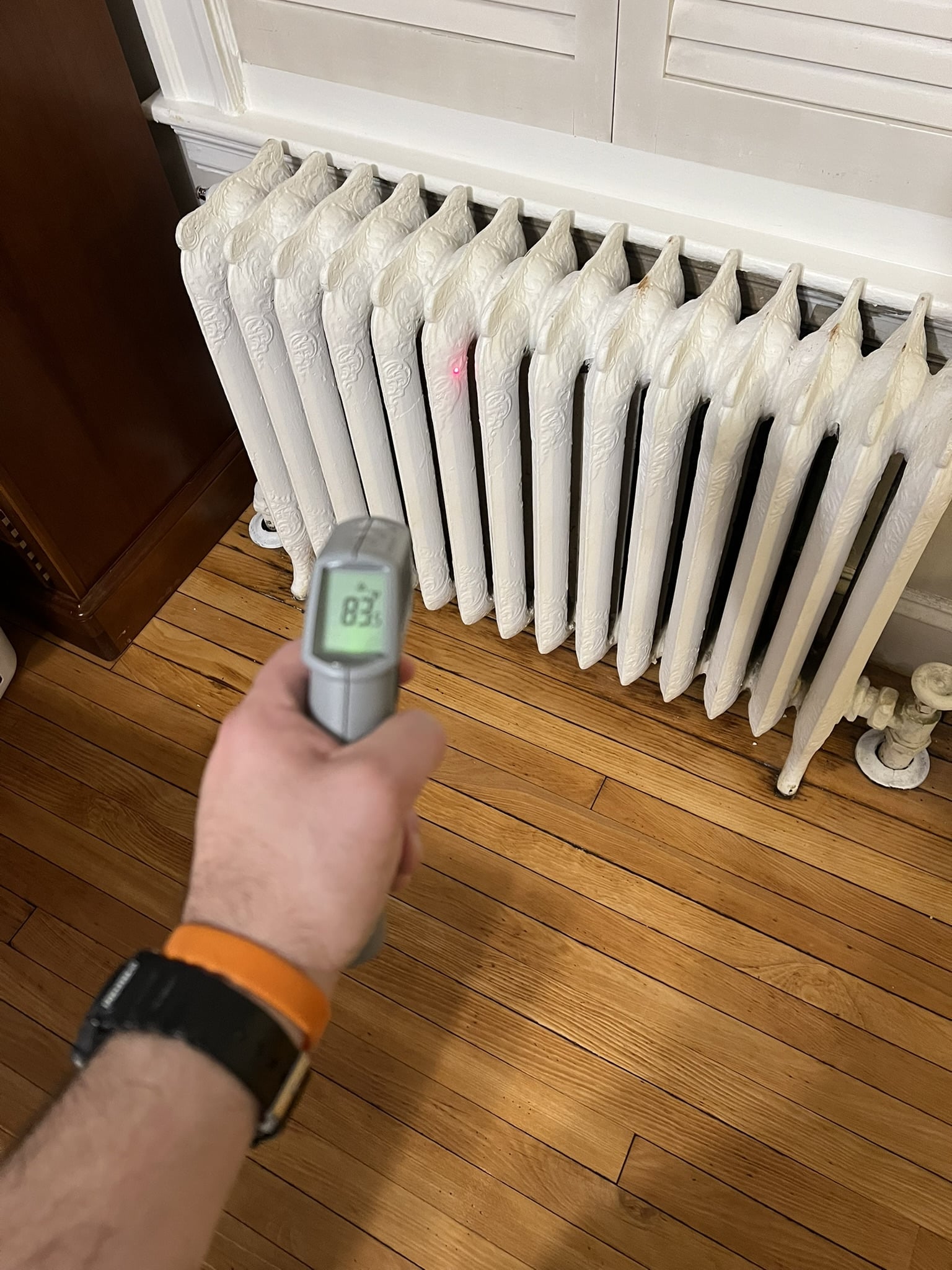

    it takes some time for those chunks of cast iron to warm. What is the delta from one end to the other delta x flow gives you the btu being transferred.

    So, if I understand the problem correctly, you have one older zone with cast-iron radiators that appear to be from an original gravity system. When additions were made, copper-tube baseboard radiators were installed.
    To remove air from these two different types of systems, you need two different procedures.
    The copper-tube systems, or zones, can be purged easily. The water flowing through a 3/4-inch tube will entrain the air and force it down any vertical riser until it reaches the purge valve. When you get a solid flow of water for about 15 seconds, you can be reasonably confident that you have removed all the air from that zone.
    Since those zones are operating properly, there is no need to fix anything there.
    The older system appears to have been modified at some point in the past. The old gravity-system iron pipes, which were head knockers in the basement, may have been removed and replaced with similar-size or even smaller-diameter pipes installed closer to the ceiling.
    Purging will not work on this system because of the design, so don't try to purge it.
    Since you are using circulator pumps to move the water, you no longer need the lower, head-knocking piping to maintain the proper pitch required for gravity circulation, or thermocycling, to move the heated water. The pumps will force the water up and down through the system.
    To remove air from a system like this, you need to bleed the air from the high points of the system, namely the radiators. However, if the redesign has created other high points that cannot be opened to let the air out, you need to figure out how it was done in the past, since the system worked without problems before.
    The redesign of the main piping may be the problem, as illustrated in this drawing.
    This is an exaggerated gravity system, where the pipes in the basement are in the way, making the space useful for little more than servicing the heating plant. Gravity allows the hotter water to rise to the radiators and the colder water from the radiators to fall back to the basement, returning to the heating boiler.
    here is the same system after a new boiler and some piping modifications to get rid of the low hanging pipes
    Notice the one poor design pipe connection where air can get trapped in a high spot and there is no easy way to get the air out. (see the white portion of that pipe indicates air) It might only be a partial air blockage, but enough to cause a problem. If it is on the supply side of the radiator, that could explain what appears to be a reverse flow, as the "Ghost Flow" happens to the problem radiator. Read about Ghost flow in this booklet Zoning Made Easy at the top of page 12. It is not called Ghost Flow in the book but it explains how some heat can get in a radiator without proper circulation.
    I believe this is the best explanation of what is happening with your system.

    looks like the radiators are connected bottom to bottom. So a small air pocket at the top should not stop flow. That pocket of air in the top of radiators is sometimes called secondary expansion tanks.
    You do need a good flow to push air through large pipes. Use the fast fill function on the fill valve so you can get around 8-10 gpm. A fill bypass, even better.
    This radiator looks to have some flow based on the S&R pipe colors on the IR scan?

    I still believe that if there is air, you won't get it by purging the zone with CI radiators. there are too may tee fittings. and where there is a tee fitting the water will push to the direction of least resistance. If that is in the direction of the outlet of the tee that does not have air, then the air will stay.
    In this illustration the radiator on the left has an air lock by poor piping design. Purging will not get that air out because the path of least resistance is thru the other radiators in the system that don't have an air lock. Venting at the radiator will not move the trapped air.
    You could try increasing the pressure and operating the circulator at a lower temperature in order to get that air to be absorbed in the water (google BOYLE'S LAW) and carried off into some other place in the system where it can be vented or purged.
    The increased pressure may be enough to compress the air pocket so water can move past the air pocket and absorb more air over time. After several hours of this procedure, reduce the pressure and operate the burners and see if the problem is resolved.
    Just a thought . . . because the only other option is to spend lots of $$$ with professionals that may not be able to solve this since it is such a rare problem. Do this with all other zones off and only the CI radiator zone operating

    Not a pro, but I agree with Ed. If there was no air pocket on the supply side, your IR pics would show the supply pipes heating right up to the supply valve, even if the valve was closed, because of the ghost flow Ed explained. We have that phenomenon in our gravity conversion heating system where one radiator doesn't heat because the occupant of that apartment won't bleed the radiator, so no flow goes through it. But both the supply and return pipes still get hot after long boiler runs because of the ghost flow Ed described.
    Don't waste your time swapping radiator valves. They're fine. Find the air pockets.

    @EdTheHeaterMan - I have one picture from the previous owners of the house from about 30 years ago when they renovated the basement (see pic below).
    They moved the boiler from the middle of the basement about 10 feet towards the back of the house (which would be to the right in the picture above) when they finished the basement. Supply and Return piping must have been re-routed to accommodate the new boiler location but the pipes in that picture still seem pretty high up. What you're saying about the copper-tube systems makes sense and yes those are easy to purge. What you're saying about the cast iron zone is making sense, but there are some concepts and terminology you used that I don't quite fully understand.

    @jesmed1 - Would the supply valve get heat if it's completely shut off or obstructed? Or would the water not move up the supply pipe because there's no flow? I do think the tech I'm using is pretty knowledgeable. He knows a lot, but the issue we are having seems to be a pretty rare kind of situation…

    Thank you @EdTheHeaterMan and @hot_rod for your latest responses and help so far. I have some questions and want to go through your responses when I have more time, but for now just wanted to let you all know about a new development. It seems the larger problem radiator that got almost no heat and seemed to be getting warm from the return side is now getting a warm from the supply side (barely warm, but something is getting in there - temps are only like 70 degrees so it's still not working in terms of heating normally) See pics below. I even put the focus right on the supply and return in the last 2 pics so you could see the temps (78.4º at the supply valve and 63.1º at the return). I observed this last night and this morning. Does this change any assumptions about the cause of the problem? I found it odd so figured I would post about it.
    The smaller problem radiator may still be heating from the return (temp 85.8º at return vs. 80.1º at the supply), . See IR pics of the smaller radiator below.
    I was trying to use the camera to see into the walls to trace the supply and return piping. I can see where there are some hot pipes in the wall, but it's not powerful enough to really get much more information such as which pipe in the wall is a supply or return, or if there is some kind of air pocket where there is lack of heat, etc.

    Assuming all valves are open, pumps, including the impeller are spinning.
    After any repair work or commotion on the piping, debris can get loosened and lodged in the pump impeller. It is another easy check.
    You have fairly good isolation on the circulators, the yellow handle valves, and the large green valve, and the yellow one below it, would work without losing much water.
    Once I add water to increase the pressure, you mentioned lowering the pressure to 12PSI while the boiler is cold before firing it again. I assume I just need to open the draw off to let water out in order to lower the pressure, right? Will this introduce more air to the system though? Does it not matter because I have that spirovent? Also, while I'm running the circulator on the cast iron radiator zones should I shut the ball valves on the supply and returns for the baseboard heating zones? Does it matter?
    When I run just the circulator without the heat, you mentioned shutting the gas to the boiler so it doesn't fire. You're suggesting shutting the gas valve that leads to the boiler as a way to do this? Like this one in the pictures below? Will I need to do anything besides just opening this valve after to get the boiler to light again? Thanks.

    " This is why I was asking about the pipe size, but no one seems to think this could be part of the issue. Am I missing something? "
    Yes you are missing something and it is simple to explain using a highway analogy.
    Picture a 3/4" pipe as a one lane roadway and all the cars are moving at 60 mph. When that happens you get 66 cars to pass a given point X in the highway every minute as long as each car has 3 car lengths between them.
    Now, think of a 1" pipe as a two-lane highway. If you want a total of only 66 cars to pass point Y, with 33 cars in each lane, the cars will need to move at a slower speed than they would on a single-lane highway carrying 66 cars.
    At 30 MPH, 33 cars will pass point Y in each lane, for a total of 66 cars passing that point in both lanes per minute.
    Does that make sense?
    The same principle applies to water flowing through a pipe. For the same flow rate in gallons per minute, water will move more slowly through a larger pipe because the larger pipe has more cross-sectional area.
    This is the principle used in the older-style air scoop, like the one you have at the top of the supply pipe in this picture. By slowing the water velocity, the air bubbles have more opportunity to separate from the water and rise to the top of the scoop, where they can be collected and vented.
    That air scoop has an interior equivalent to a 2-1/2" pipe, which slows the water down a lot. This allows the air bubbles to rise to the top because the water is moving so slowly, giving the air in that section of the system more time to separate from the water and rise to the top.
    In the smaller pipes, the water moves too quickly for the air to separate and rise to the top as effectively. Therefore, placing an air vent on a piece of pipe that is the same size as the 3/4" baseboard zone piping will not help remove air nearly as effectively. The water and air bubbles would rush by too quickly for the vent to release the air effectively.
    So, the bottom line is that your 1-1/2" Spirovent installed on the vertical 1-1/4" pipe will slow the water down a little more, basically making air removal a little more efficient.
    After the water, now containing less air, returns to the 1-1/4" pipe and passes the air scoop on its way to the rest of the system, there should be no effect on how the water enters the radiators. So that is not a reason for you radiator problem.

    part of the way a air scoop or air purger works is it creates a "wide spot" in the piping road. The larger the chamber the more flow velocity drops.
    As flow speed decreases, air comes out of the fluid easier.
    That is why the top of a tank, like a buffer tank, is such a good spot to put an auto vent.
    So if anything a larger air sep, both piping, and if the chamber is larger, adds to air removal efficiency.
    They did a nice piping job threading in the ball valve, air sep and LWC, really no reason to change that piping.
