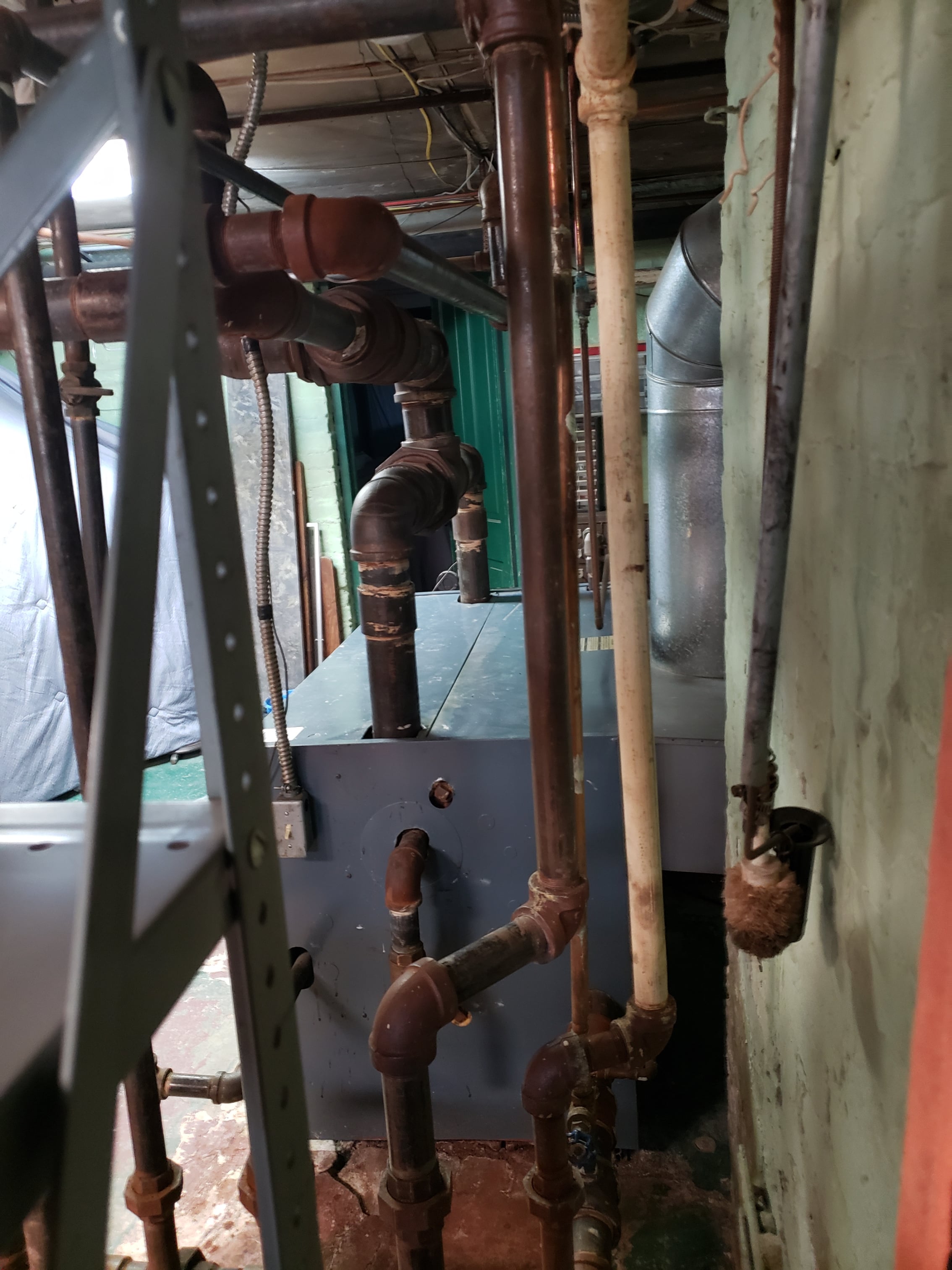

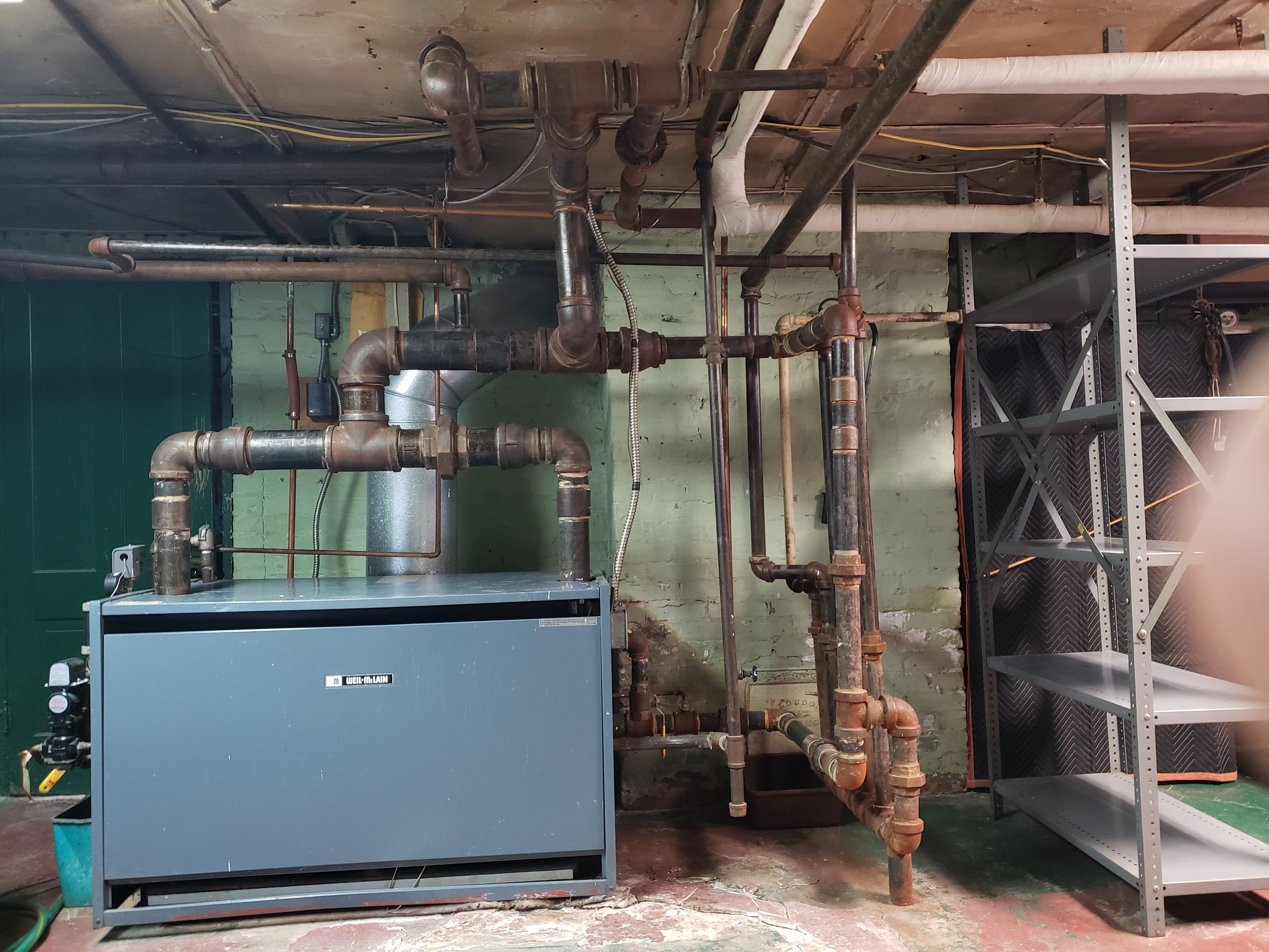

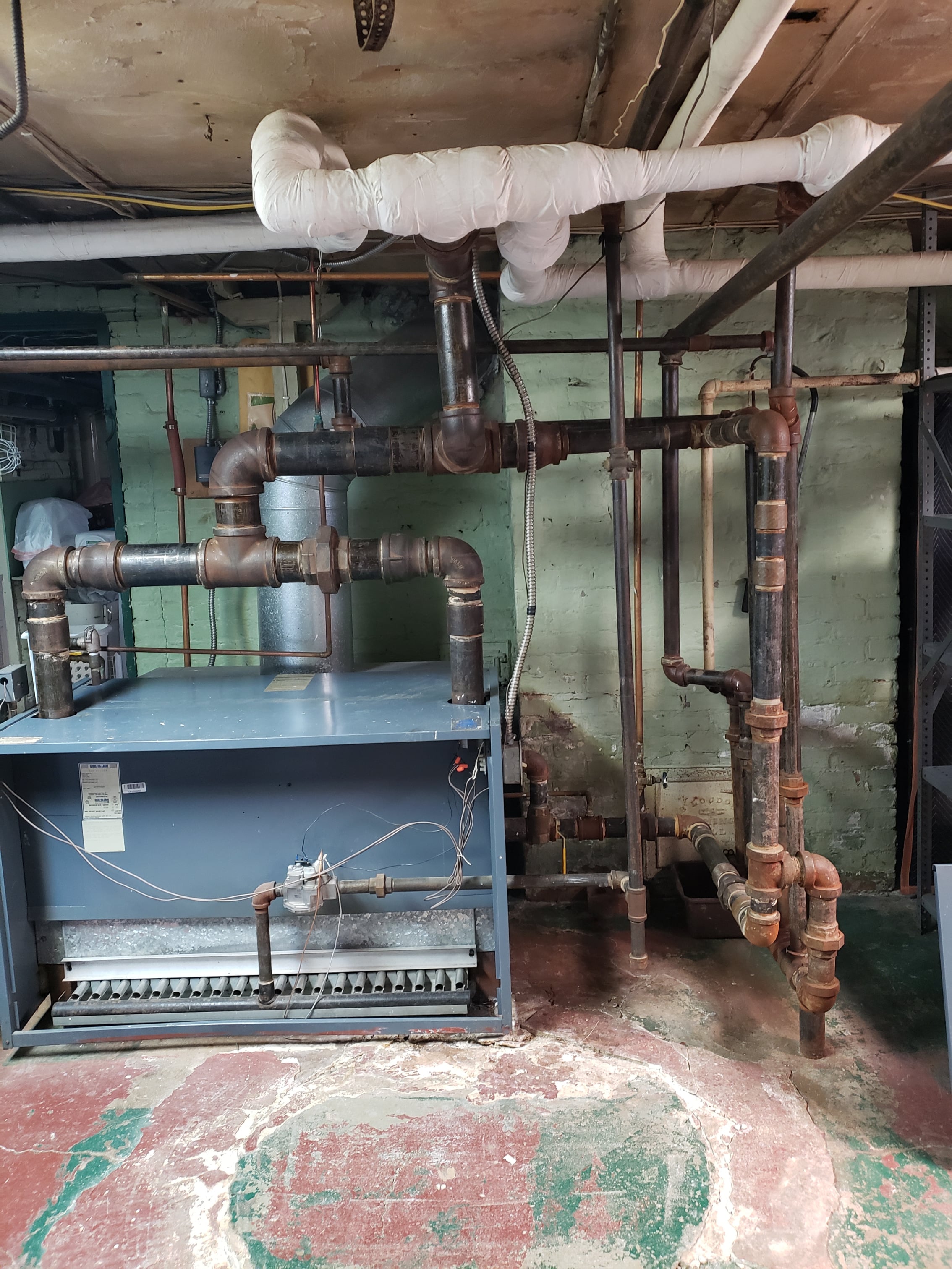

I am in need of a new steam boiler. My current one is a Weil McLean EGH 115. 500,000 BTU's input.
When I first saw it, It was so big that it scared me to death. So I ran out and purchased Dan's book. I knew my house was big-but not that BIG!! After reading Dan's book and doing some research I came up with 19 radiators 741 EDR with 15 feet copper fin-tube hot water loop 37.50 which totaled 778.50 square feet of EDR. So I think I need a smaller boiler. I'm looking at the Peerless 64-07 345,000 BTU's input I think it's the closest match not only that but it's a similar set up. Since I'm old and my long term memory is better I'd hate to walk in the basement and find a complete stranger! This way I'll still be able to somewhat recognize it as time goes on. 😁 After reading Dan's book I thought nothing could scare me more than the boiler until I got a good look at the near boiler piping. I'm going to post some pictures and I would really appreciate the best way to re-pipe this monster. Also thinking of getting the near boiler piping package. That way whoever does the job can't mess it up any worse than it is. I'm in Bloomington/Normal, Illinois . I had a couple of heating contractor's come in and when they said "What's the problem?" I knew I was in trouble! I have someone else coming out tomorrow on the phone they sound a little more promising. It looks like around here there's not a lot to choose from when it comes to steam. If you have any suggestions it would be greatly appreciated. I've seen the amazing help you have given others on this site. I've never been very lucky, so if you're not able to help me don't worry it's not you it's me!😥
In first picture left insulation on to see layout better. Not asbestos.

    you have the header from the old boiler there. there are some contractors in il here, look at the find a contractor t the top. mostly in chicago but some ight do work up there.

    Doesn't look too difficult to fix the piping up.

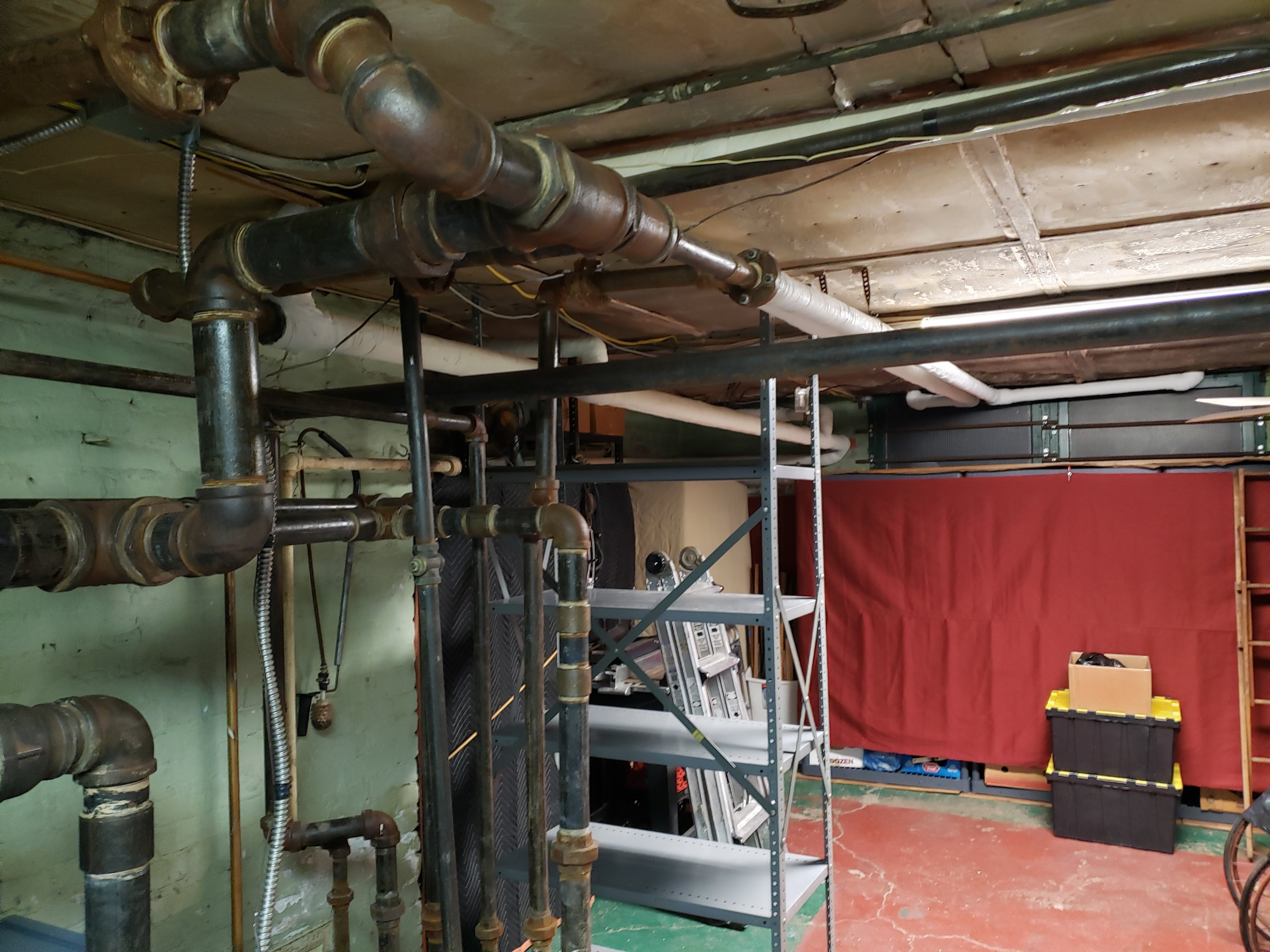

    identify the start of the mains at the ceiling, identify the ends of returns at the ceiling or floor,
    cut there, and remove everything in between,
    looks like a couple boilers been there before, and they just tied in where they saw, , ,
    pipe the new, right sized boiler as per the install manual piping page(s),

    Everything around the boiler should be reworked IMHO.
    The boiler has to be installed with a new header the way it shows in the install manual. None of this connect here connect there"
    Each steam main supply (looks like you have 3) shouldn't be teed together. Each main should be brought down to the new boiler header separately.
    One main looks like it may be counterflow so that would need a drip if it is counterflow

    each main should drop down to your header separately,
    I saw that tee up there, looks like it wasn't right from day 1, that's why I said identify the main(s) and cut, start fresh from there down to the header,

    the header in a box probably isn't the right choice if you have 3 mains. it could be modified but you might need the person that just knows how to do it.
    there are multiple ways to do 2 pipe in 1 pipe. some of them would use a radiator vent so it could be ok. you need to be careful about steam following the return and closing the vent before the radiator vents.
    that tee is the header from the old boiler that wasn't removed

    The manufacturer's kit may use only one riser from the boiler. Two is better but not imperative. You will need to modify some of those kit pipes anyway to accommodate the three system risers to the mains. I might cut back even further and have 4 risers and 3 returns. Connect those returns at the floor level so they are well below the water line. That way steam or air from one main will not find its way to the other mains thru a return. If you can find the 4th return from that other main, then connect that one below the water line also. That is mentioned in Dan's book.
    No wonder there are leaks in the end sections. I would bet money on the gaskets that hold the sections together were compromised as a result of the piping you have existing. there are no swing joints so that connector may be prying the sections apart and drawing them back together as the temperature of those pipes change. That poor WM never had a chance for a long and prosperous life when it was piped that way.
    in addition to the 2 risers both flowing in the same direction to the risers to the mains, there should be some sort of swing joint so that the sections of the boiler can move a bit, the way you have it the boiler and header could potentially pull each other apart as the expand and contract differentially.
