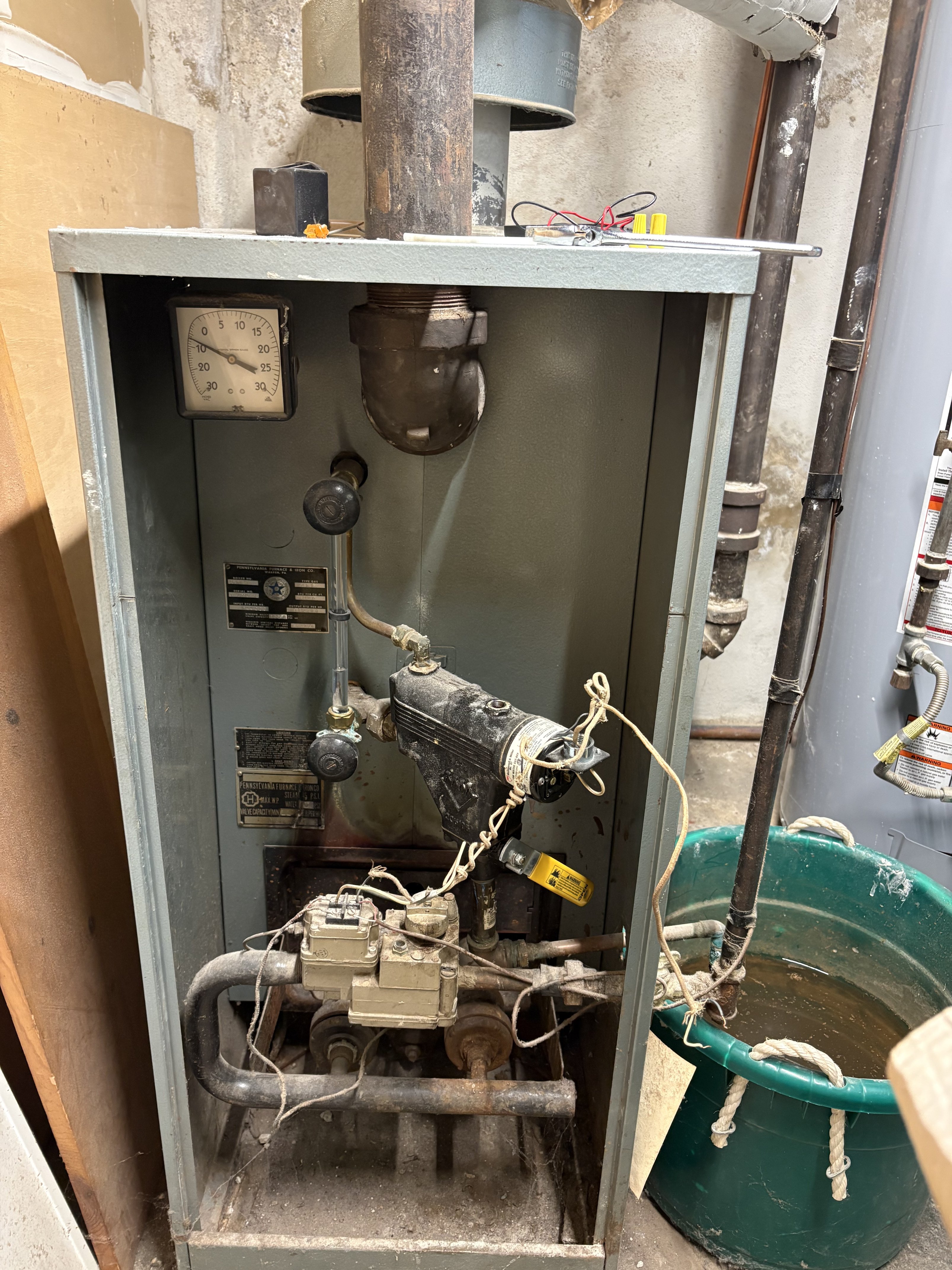

I want to get the Pressuretrol out from inside the boiler cabinet. Can I put about a foot or two of brass pipe between it and the pigtail on top of my McDonnell & Miller 67 Low Water cutoff? or should I put the pipe right into the top of the 67 and put the pigtail directly under the Pressuretrol up top outside the cabinet?

    Having the pressure control and the pigtail above the boiler water line is best practice IMHO. I would use brass pipe and a brass pigtail if you can I know its more $$$.
    If you have another spare tapping on top of the boiler that would be even better. Some put a tee between the safety valve and the boiler.
    The reason is the #67 LWCO and sight glass tappings below the water line are prone to partial plugging etc. If you keep them clean then its a non issue.
    pecmsg Posts: 7,634
    What's with the bucket of water?
    Unions are not supposed to be inside the cabinet.
    Where is the pressuretrol now?
    Can we get a picture from a little further away?

    I drained the boiler to remove the pressuretrol line to get to the stuck float. I had to use a wooden dowel coming in from the top to free it from the rust. Its free now.

    When I bought my house 35 years ago, the old owner had the blowout directed straight down over the right gas tube. you can see how rusty it is. she had a small soup pot from a stove top sitting over the burner tube to catch the water. She must have rarely blown it out, as the previous M&M 67 was completely rusted like it was under the sea for the prior 30 years. I replaced it soon after moving in with the one you see here. I punched a hole in the side of the cabinet and added piping to route the blowdown water away from the burner tube. That tub is full today because i had to drain the boiler to get inside the cutoff to free the float.

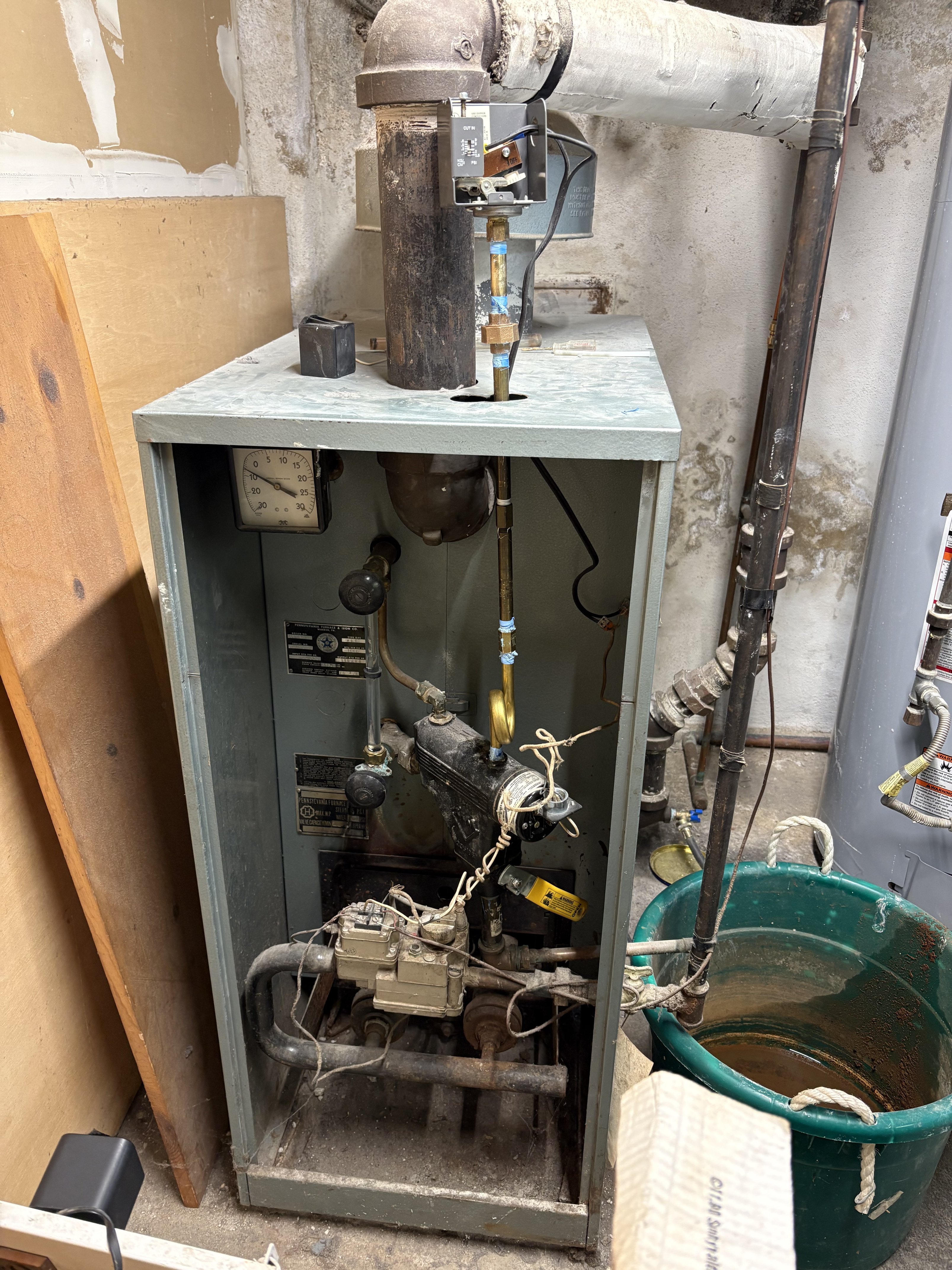

    My finished hack job. Note the Wyze Wifi camera on the lower left that I used to keep an eye on the water level since the float was rusted stuck last year. I might go out to the garage and get an old asbestos shingle to slide between the riser and Pressuretrol to protect it from heat. Does anyone think that is overkill? Its about an inch away from the riser.

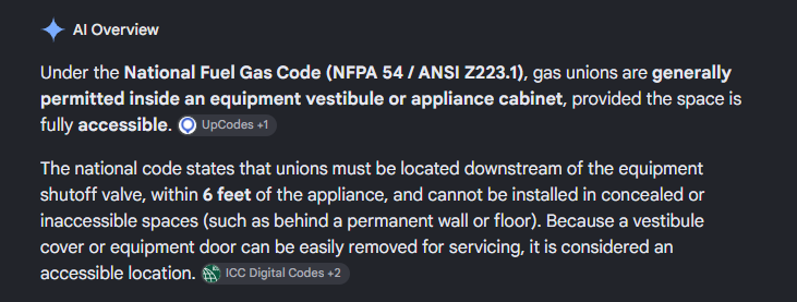

    After I had to change my gas valve I added a union inside of my cabinet. Some boilers come with a union inside the vestibule which then makes it ok per code. Apparently.
    I've heard others say this isn't allowed by code and I tend to believe them.
    However, I'm curious if anyone can point out where any local code says this?
    Here's AI's "opinion" on it as far as the national fuel gas code goes.

    @Old_Steam What you did is fine. Looks good
    Maintain the lwco and make sure it cuts off the burner when you drain it. I don't remember how often they should be flushed but I think M/M recommends weekly. Pressure control and the LWCO and pigtail should probably be cleaned yearly especially with an older boiler.

    Oh yeah, I almost forgot. I would use two elbows and an additional nipple or two or street elbows to offset the Pressurtrol away from the riser.
