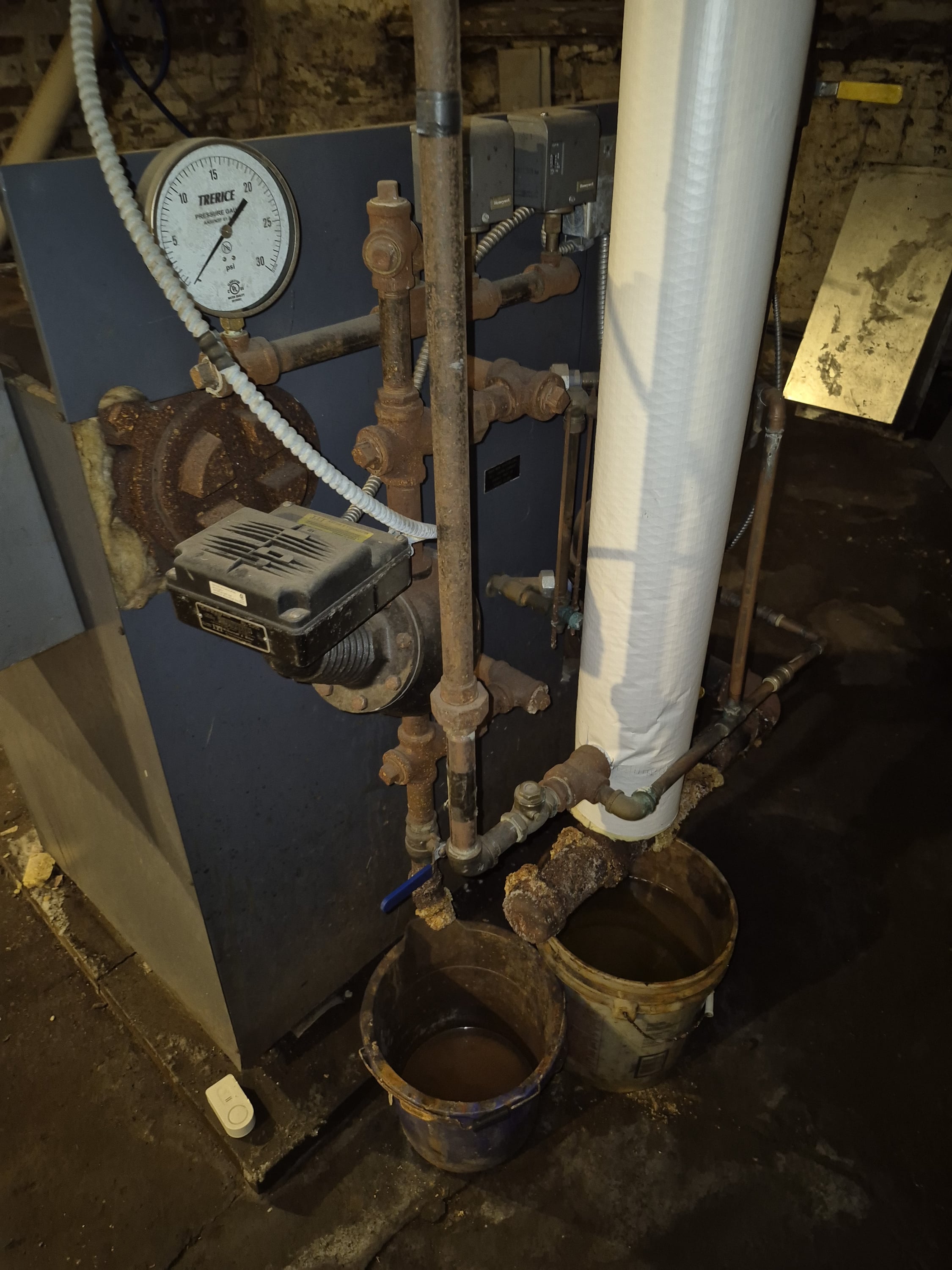

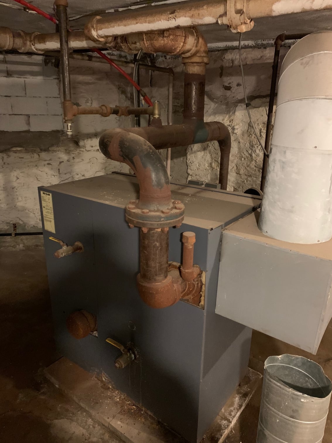

Background:
  • I've been talking with many contractors to try to get my steam boiler replaced for my giant 7000 sq.ft. house with 30 rads, and hopefully made it more efficient and less likely to fail in only 20 years.

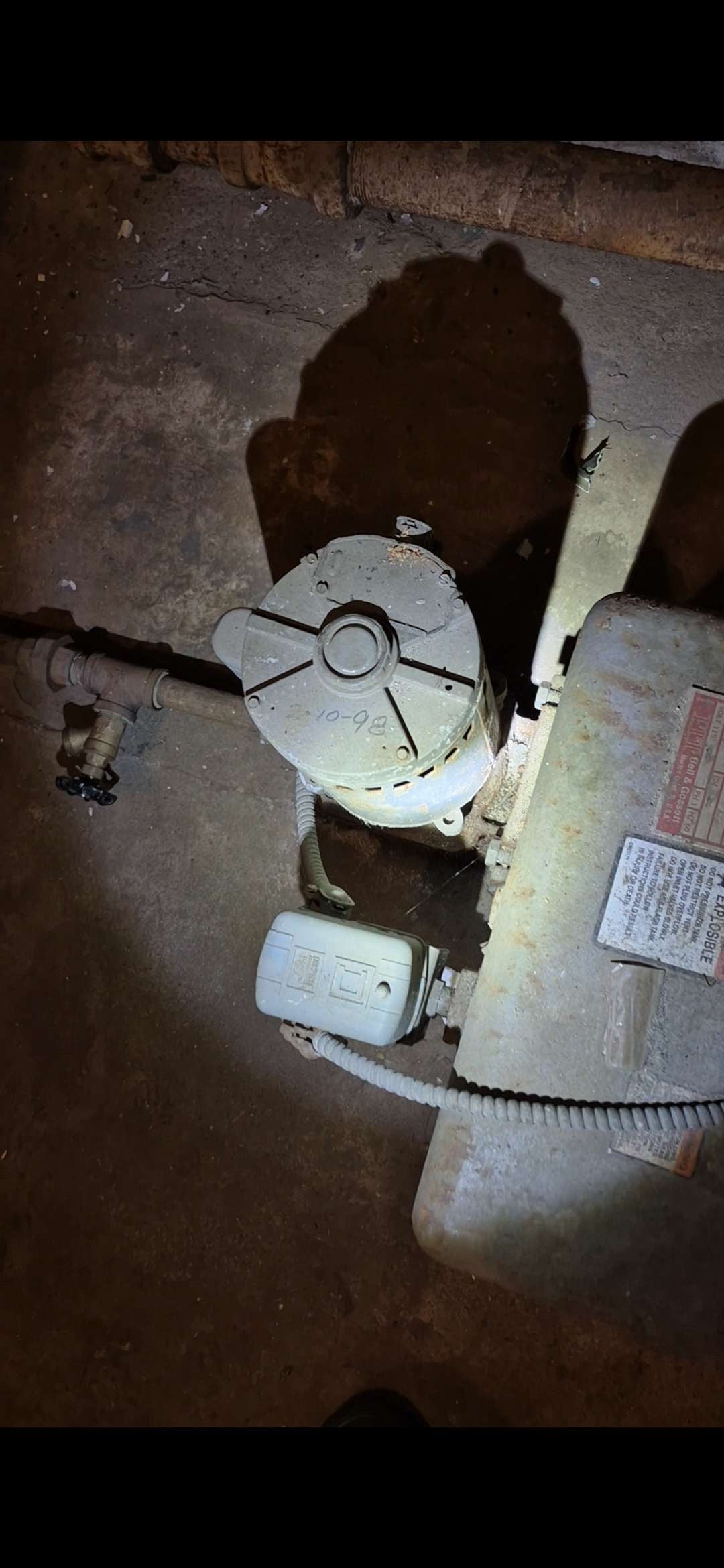

  • My 1998 condensate pump has had an issue of running continuously, thereby flooding the boiler to the top, thereby accelerating rusting and cracking. We opened up the wiring boxes to find that the condensate pump is NOT connected to the boiler's sensors in any way, despite clear correlation with blowing down the boiler on the one sensor's side (first image) remedying the condensate pump.(And according to several contractors so far, the main pipe size is too big compared to the return pipe size to consider hydronic without a massive overhaul.)
Question:
A few contractors I'm talking to are recommending omitting the condensate pump and just using gravity to return the condensate to the boiler. Others suspect that would not be a good idea, thinking the pressure would not be enough or there would be too much condensate buildup in the wet returns that might make them burst or leak perhaps.
Edit: I guess a better question to answer is: "what are the pros and cons of using a pumped resevoir vs a gravity return?"
What do you all think?
(Any other advice for this project would be massively helpful. I am very new to this, but learning fast. I got some of the holy books, have not read them yet.)

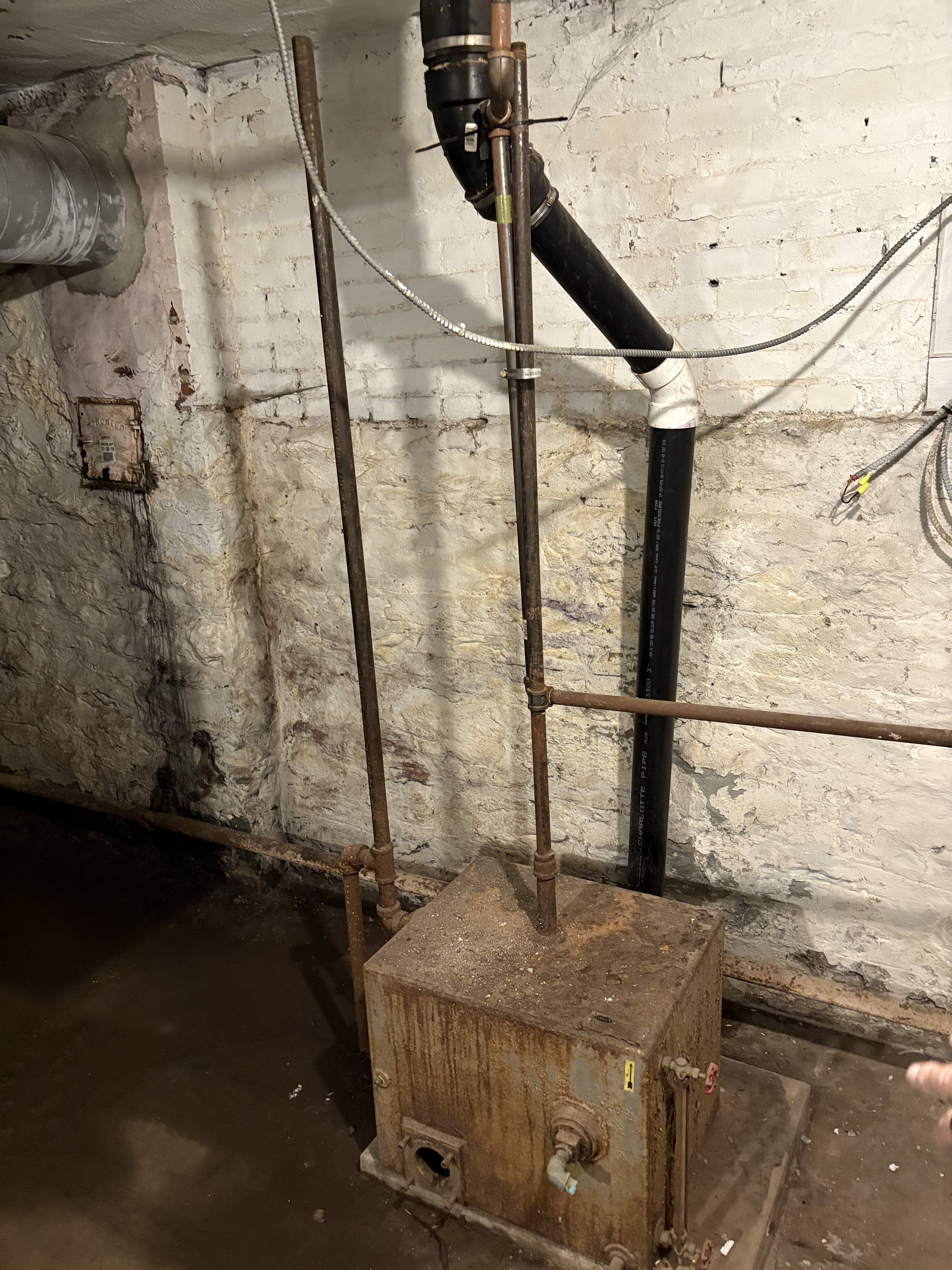

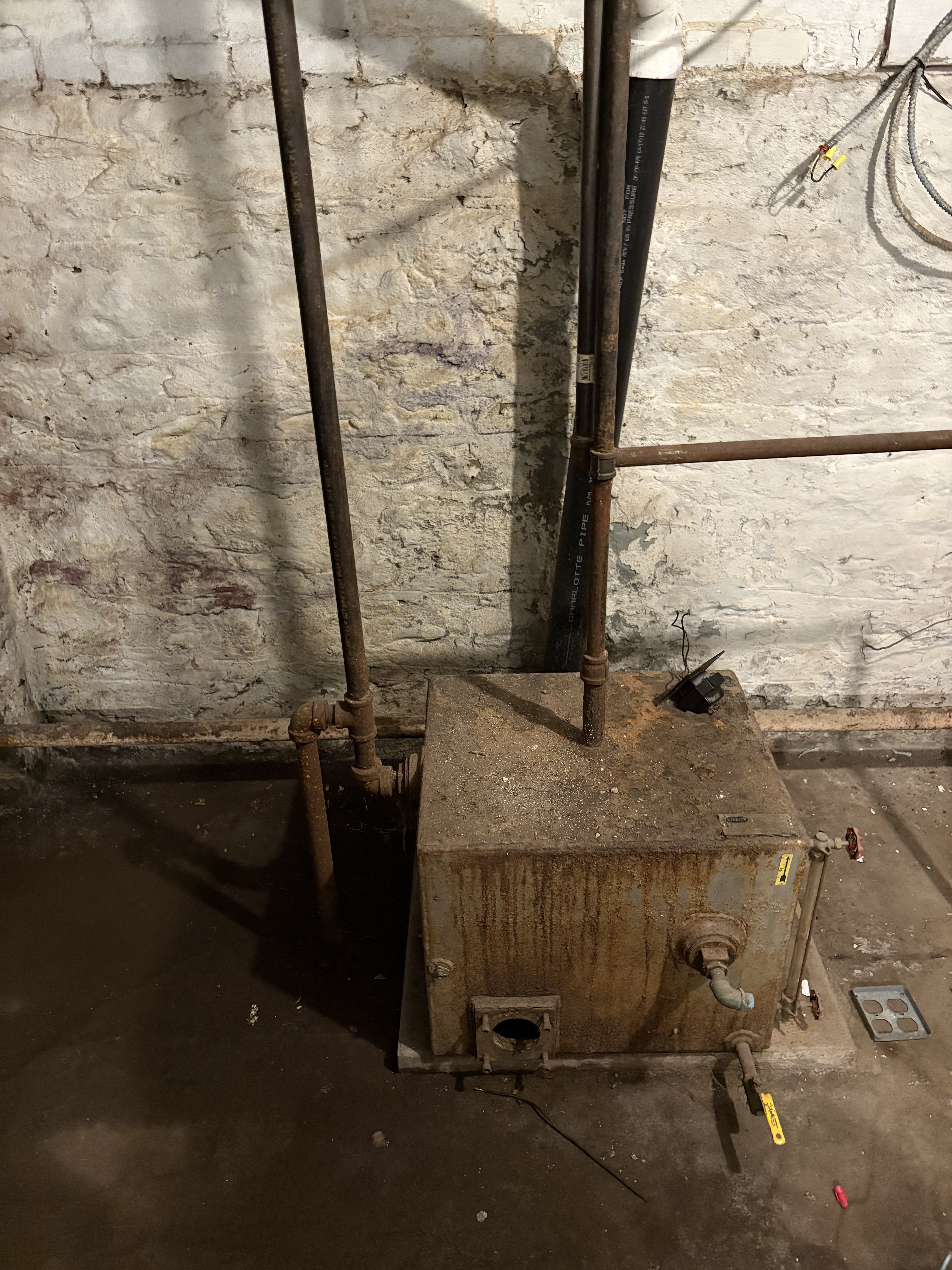

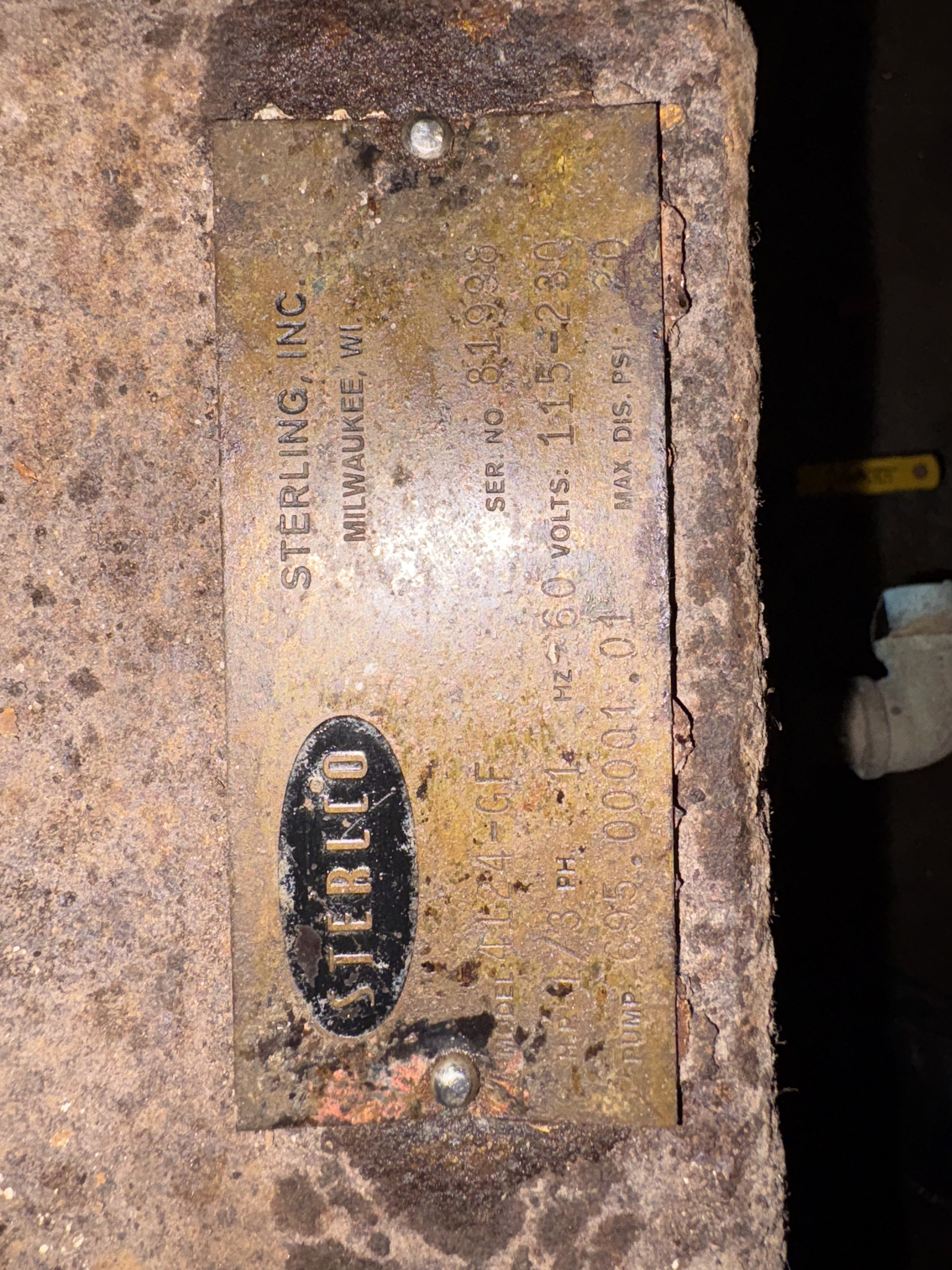

  • [DISCONNECTED ] Sterlco - Sterling inc - 1/3 HP Pump??: Installed 2001, same day as boiler. Looks completely defunct and gutless

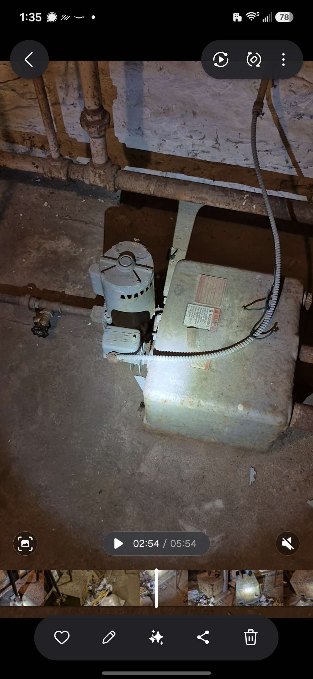

  • Smaller condensate pump: installed 1998 - but still connected (didn't get the make/model)
Screenshot_20261016_133543_Gallery.jpg Screenshot_20261016_133554_Gallery.jpg

    the pumped vs gravity return has to do with the water content of the boiler. If the system has too much of the water from the boiler in the system in the form of steam while the system is running, the water level in the boiler may fall too much. bigger boilers have more water content but modern boilers have less water content than older boilers did. if the boiler doesn't have enough water content, more volume can be added with pieces or large pipe or a passive tank that is set up as a reservoir. Usually there are better options than a pumped return.
    the other reason to have a pumped return is if you have emitters below the boiler so that the condensate can't return by gravity.
    Where are you located, there may be some pros here that are nearby.
    GrockMan
    Lose the condensate return pump and rely on good old gravity. The only reason why you might not be able to do that is if the piping is such that somewhere a wet return is above the water level in the boiler or if there is a radiator which is below the water level in the boiler.
    There is a possible pressure concern as well. If this is a true two pipe system, any dry returns must be high enough above the boiler water level so that they don't flood. I can't tell from the photos whether or not this is the case. This is not usually a problem, but easily checked.

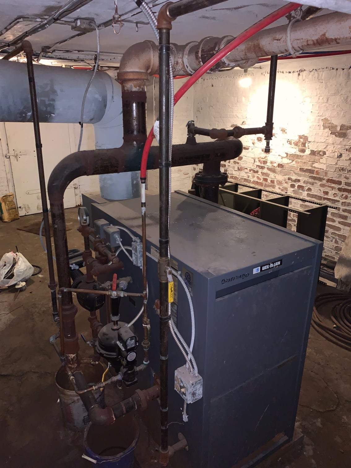

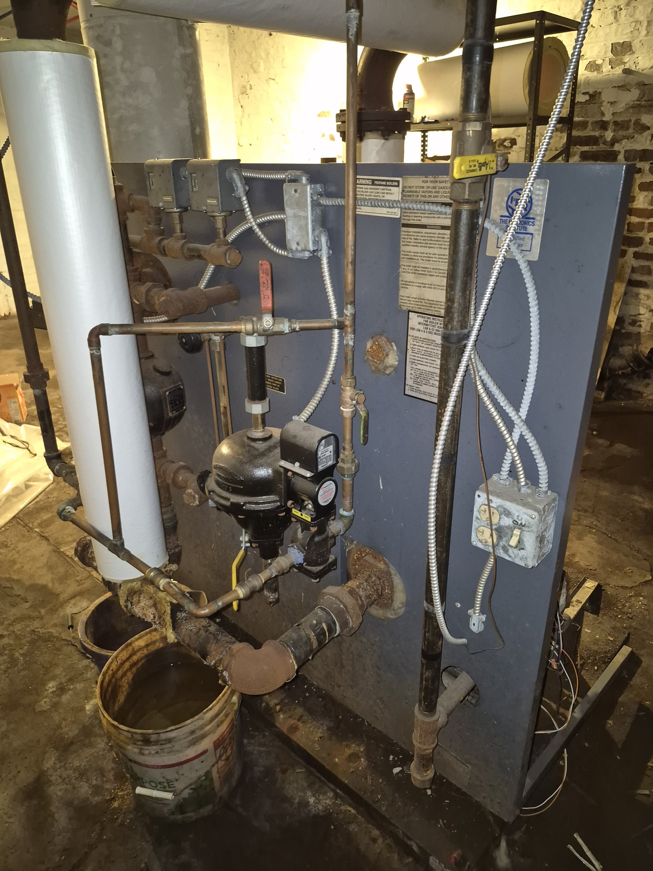

    More info:
    All rads are above the dry return line, and the wet return is pretty far below the boiler.
    Here are the dry and wet returns with relation to the boiler.
    Boiler, decomissioned pump, in use pump:
    Steam Trap central where everything returns:
    View of the return piping up and back down (and disconnected piping):

    "All rads are above the dry return line, and the wet return is pretty far below the boiler.:
    Given that I have to admit that I really can't see much point to having the pump. Gravity is pretty reliable…
    And with that reservoir pipe (II love that! Someone was really thinking!) you shouldn't have to worry about total water volume.

    The fact that the tank is right next to the boiler speaks volumes to me. Gravity is already working at the level of the boiler. Even with the boiler running, the pressures should be extremely low, well under 1 psi if they size the boiler correctly, and 1 psi requires no more than 28" above the boiler water line in a worst case scenario. To my eye you have way more than 28" to work with. Many times the pumps are added by unknowing contractors who think "its big it needs a pump", that's just not how it works.
    If, and it's a big if, you need extra water volume the tank that @JUGHNE shows is a much better and simpler way to go. The pumps on these systems just add complexity and in your case, based on what I see in the pictures you have absolutely no need for a pump.
    For my bolding above, it seems you have contractors with a varied level of abilities coming into your house. The sizing is critical and you get one chance to get it correct. It's super simple, but gotten very wrong a majority of the time. I'd be sizing things up myself if that was my house. If you want to go down that road we can assist.

    Thanks you all, and after consideration and deliberation with my local guy, we agreed on replacing the disconnected Sterlco reservoir/pump with a new Sterlco reservoir/pump, connecting it and disconnecting the other condensate pump, and feeding fresh water into the Sterlco reservoir pump.
    We decided on this for a few reasons:
    1. Because freshwater flooding was the cause of the last boiler dying, we wanted to mitigate it happening again, by having the condensate return directly in charge of adding more water if needed.
    2. We want the boiler to have control over when it needs to be filled, so that it does not overfilled, get flooded and then have trouble heating water to produce steam.
    3. This gives the boiler a reservoir to pull from, it is just not gravity powered.
    Thank you all for your comments, if you still do not think this is the correct move, I am still interested to hear why! (There is still time to modify the choice.)
