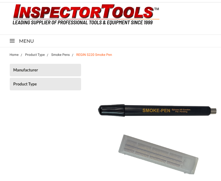

    hot_rod Posts: 28,689
    Warm air will rise, the cooler air will fall, so there will always be some movement and warmer temperatures up top.
    These smoke pens are handy for finding any leaks to the outdoors. Typically used with a blower door, but with that much movement it would be an easy first step.
    Even receptacles on outside walls can be a leak path.
    Watch some You Tube on blower doors in use to see how they track down infiltration.
