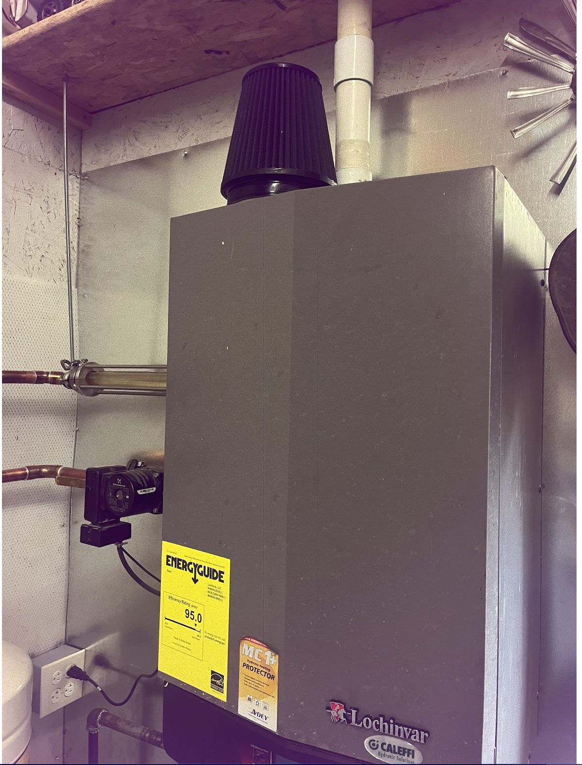

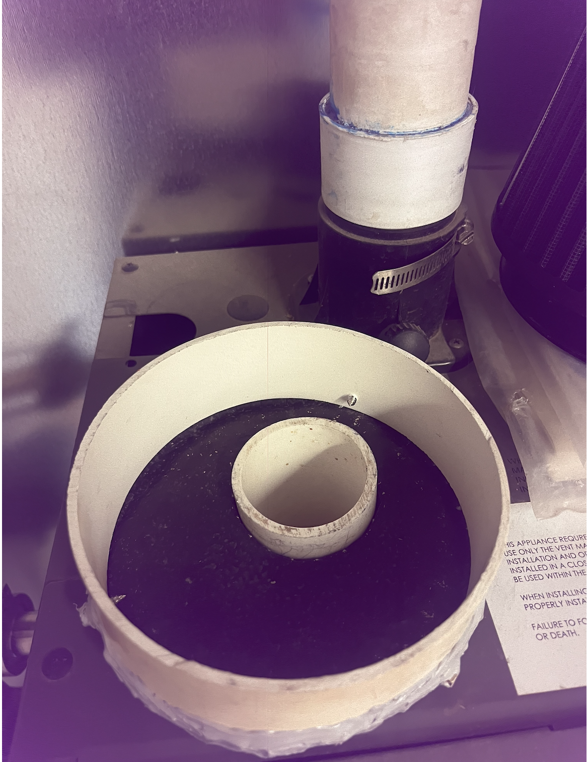

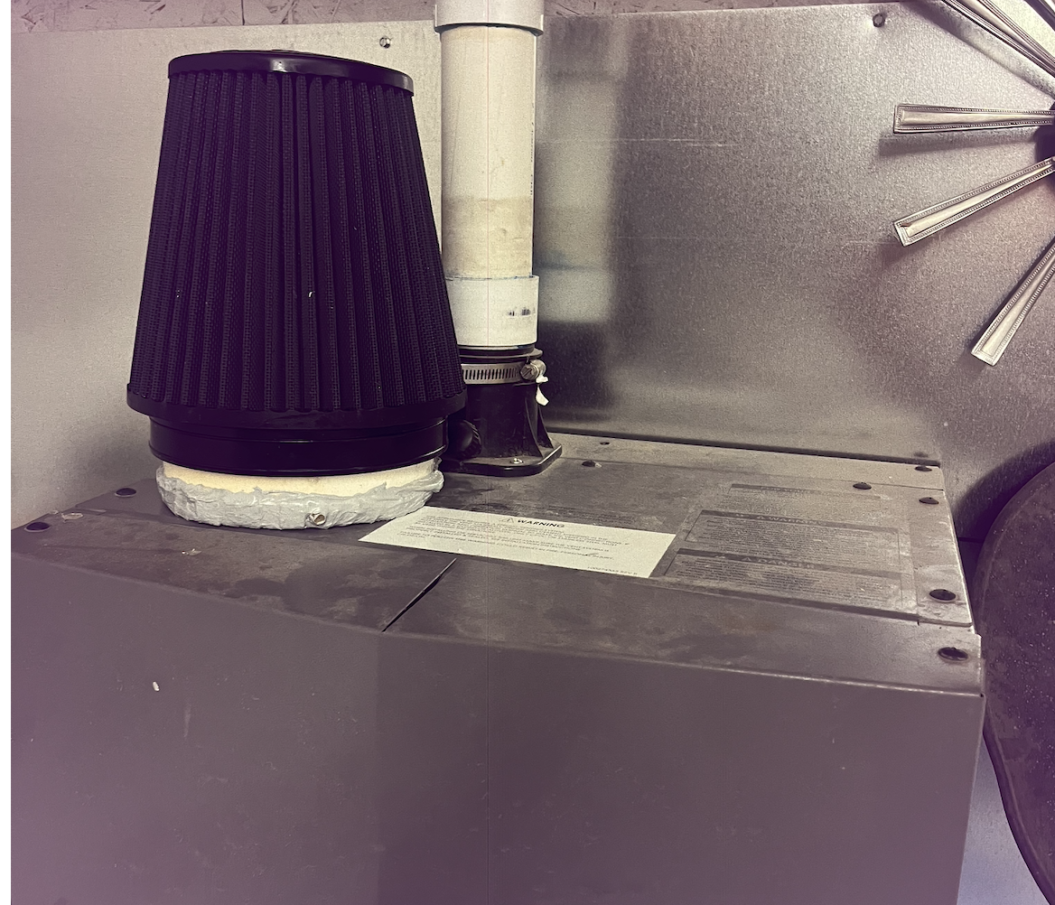

Using a common K&N universal filter. No name knock-off of this filter for around 35 bucks. This model slips over a piece of 6" PVC thin walled PVC. I imagine you could find a 2" version.
The aluminum adapter plate just slips over the 2" intake PVC.
I want to keep woodworking dust out of the machine.
I doubt a manufacturer would approve this without some extended testing?

    I believe you are doing the testing yourself at this point. How often would you need to service/clean/replace the filter would be determined by the amount of dust collected by the filter.

    previous I pulled outside air into this boiler. It did have a number of bugs in the burner when I serviced it last year.
    just moved it across the shop, thought I would try inside air this time.

    this boiler is allowed 40’ of 2” pvc intake.
    I don’t think this filter would be a restrictive as the much piping? Obviously as it plugs up the resistance increases.
    I think chocking the intake reduces the firing rate.
