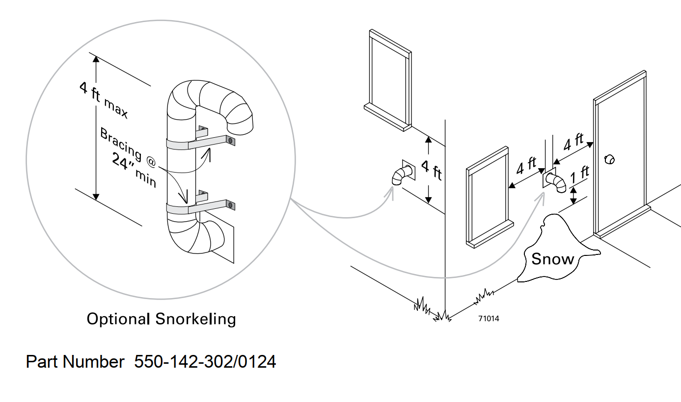

Does this CGi gas boiler direct vent setup require double wall pipe or not?
I've contracted to have the masonry chimney demoed and replaced with the snorkel direct vent, but they claim it doesn't need to be double walled. It seems like a liability to me to have a unprotected fully hot vent at ground level!

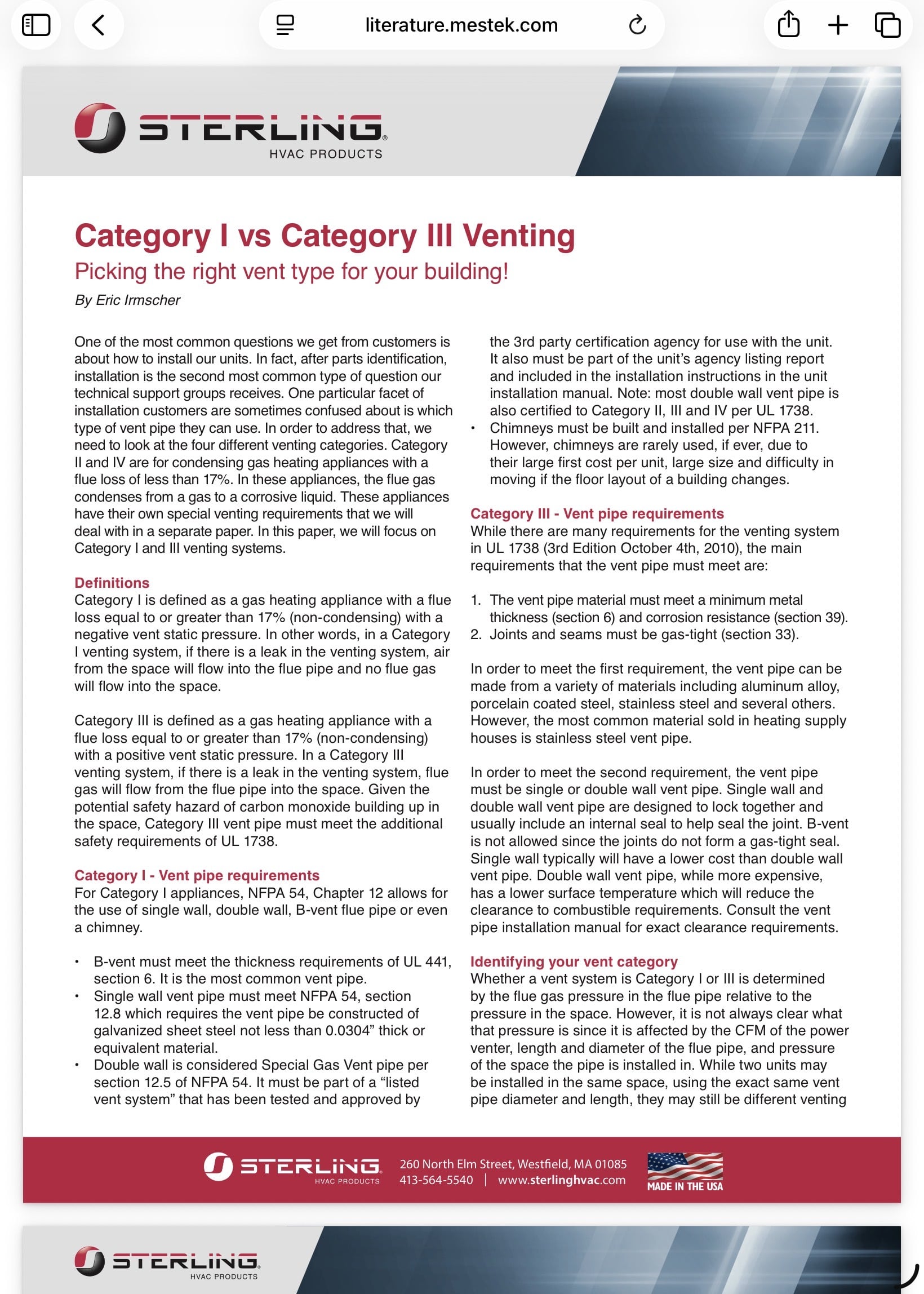

    I think you have a class 3 requirement if that is a fan assist boiler.
    So the common double wall B vent cannot be used. Stick with the list.
    Double walled is used when you have reduced clearance requirements

    Can you show us a photograph of the location for the expected termination of the vent pipe? Are you sure you need it to be a "Snorkel" configuration?
    The Category III vent is for exhaust temperatures that usually range above 140°F, so that is somewhat of a concern when it comes to actually touching the metal vent pipe while the appliance is operating. I might place a metal cage around the vent pipe, with a clearance of about 3 inches from the pipe, using a material that will not allow fingers to get too close to the hot vent pipe. Placing a chain link fence will do the same thing however you would need to be farther away since a small child can fit their arms thru the fence. I have seen expanded metal mesh that will do what you are suggesting.

    you can use double wall as long as it is listed for Cat. 3 This is one brand on the Weil list you posted.
    Which may be a nicer look than chain link fence.
    The double wall add some insulation, I don’t think I would run much distance of single wall outside.
    You can download venting manuals, most manufacturers use NFPA code guidelines.
