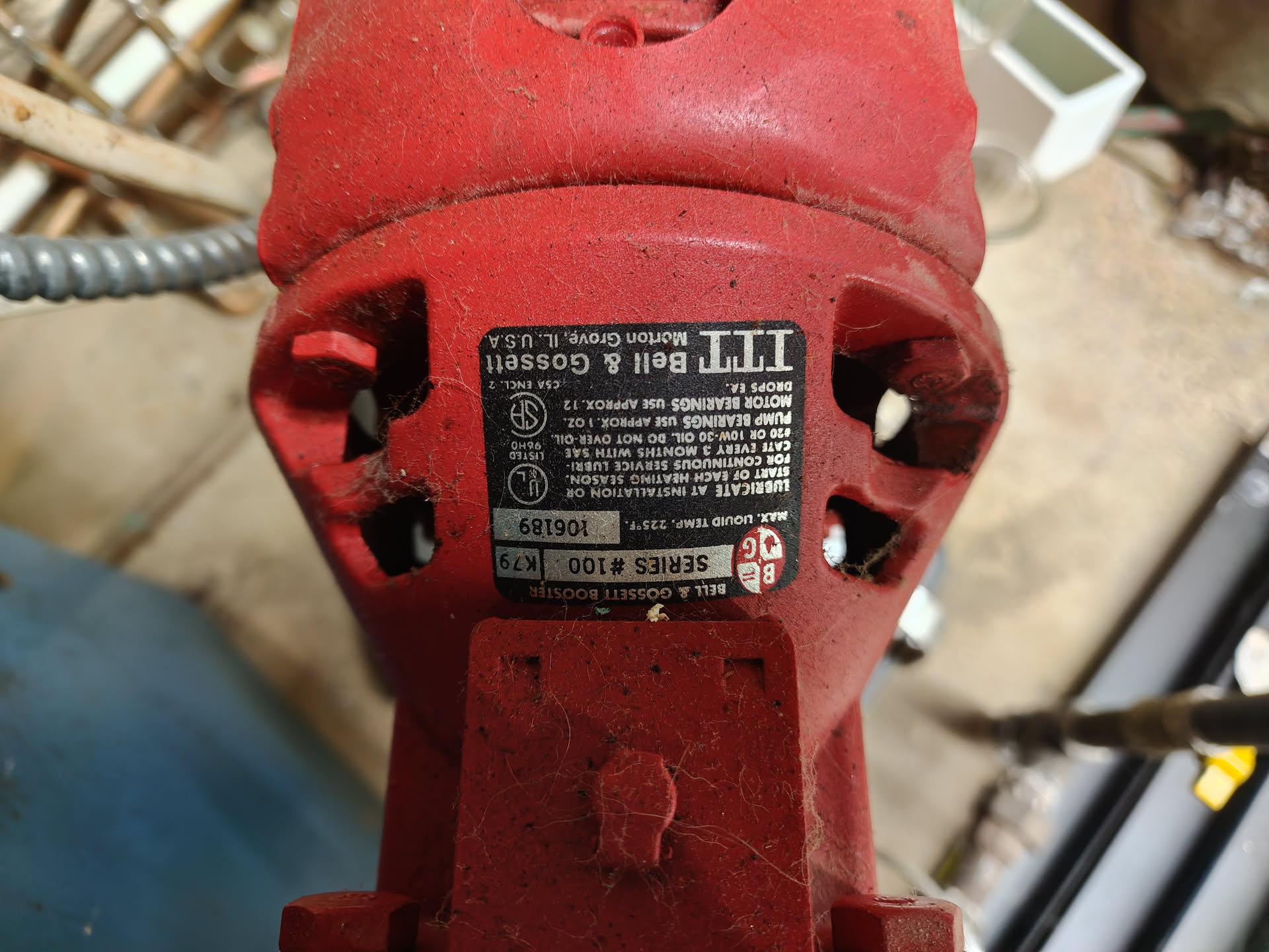

Our 1978 utica boiler is still going strong but this last spring the 1/12 B&G 100 series pump died on me, completely locked up.

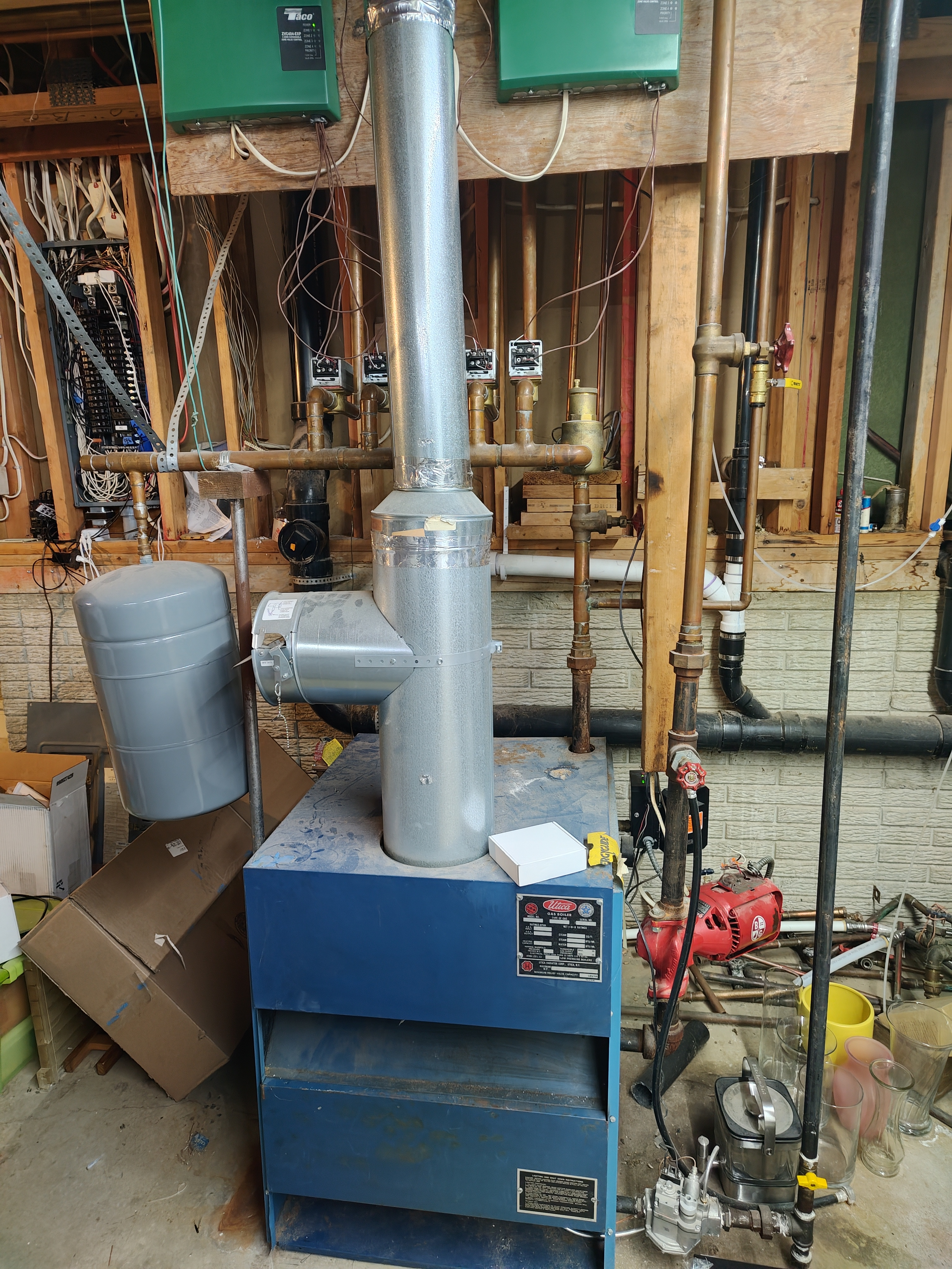

We've got 5 zones, here is the current setup:
I added in the Taco zone controllers and fuel smart hydrostat and the air scoop- all of which have been working great. My thought process is flipping the 100 series for something that can do constant pressure as I could audibly hear the pump straining when just a small zone was open (we have two 500 sq ft bedroom/bathrooms on their own zones).

    We really need to know how many btus the house needs to make a precise recommendation, but a Grundfos Alpha should do.

    That is entirely fair @Ironman I've calculated whole house load at 80k btu's as the house sits now, by zone:
    Main Floor: 30k
    Family Room: 22k
    Master: 10k
    Bedroom 2: 7k
    Bedroom 3: 7.5k

    The B&G 100 has a flat curve which the Alpha doesn't and is great for ZVs. However, you might need the head that the Alpha provides. The 100 is kinda antiquated and an energy hog. You're the best judge of what to do if the 100 is failing. I would replace it with an Alpha.

    You need to find out if the 100 motor is bad or the bearing assembly. Bearing assemblies need oil (the motor does as well). You might get it to free up until you decide what to do.
    You could replace either the bearing assembly or the motor which (with B&G high prices) probably cost as much as a complete new circ.

    Any of the ECM pumps that have delta P function would ba a good choice. The 15-58 Alpha has a zone valve setting. So it modulates flow based on zone valves opening and closing
    You will pick up some efficiency on the electrical side and the system will not over pump when 1 or 2 zones are calling.

    It's the bearing, I pulled the motor and it spins, the bearings are bad. Frustrating since I was hyper vigilant on the oiling of both, but that is what happens.
    Thanks, I think I am going to just put a 15-58 alpha in. For the cost vs parts for the B&G seems like an ok move for now, I appreciate the input!!

    The flue is drastically reduced. It looks like a big 1" gas valve thats been bushed down to 3/4". What's the BTU rating on that boiler? There's no counterbalance on the draft regulator so the damper is in the wrong position. All on a boiler that has its own draft regulator and source for diluting flue gasses. I've never seen that except on a power vent. But even that wouldn't be correct. Then there's that extrol. That's some support.
    New Hydrostat. New circulator. New cast iron radiators that would go with the theme, but the same 1978 obsolete micro zoned boiler with no rollout or spill switches. Possibly an incorrect retrofit gas valve, and definitely incorrect flue piping. And that electric panel cover has been sitting there for months. 👍
    Steamhead Posts: 19,007
    I noticed the smoke pipe too- does it go to a power venter?

    It probably does, but I don't see a spill switch. Its hard to see the wiring but I only see XX from the zone panels to TT in the Hydrostat, and B1,B2 looks like its going directly to the gas valve. What would prove the power vent?

    Thanks for the extra notes, It is powervented. It has the correct gas valve (it was converted from LPG to NG) - the guys that did it ran a full combustion analysis on it when it was done to make sure it was burning right. It has a rollout switch, which was added when the power venter went on.
    Sequence appears right, power venter for some amount of time, then burner, burner off, power venter runs x seconds after. But I'm not HVAC tech, just a parts swapper at best.
