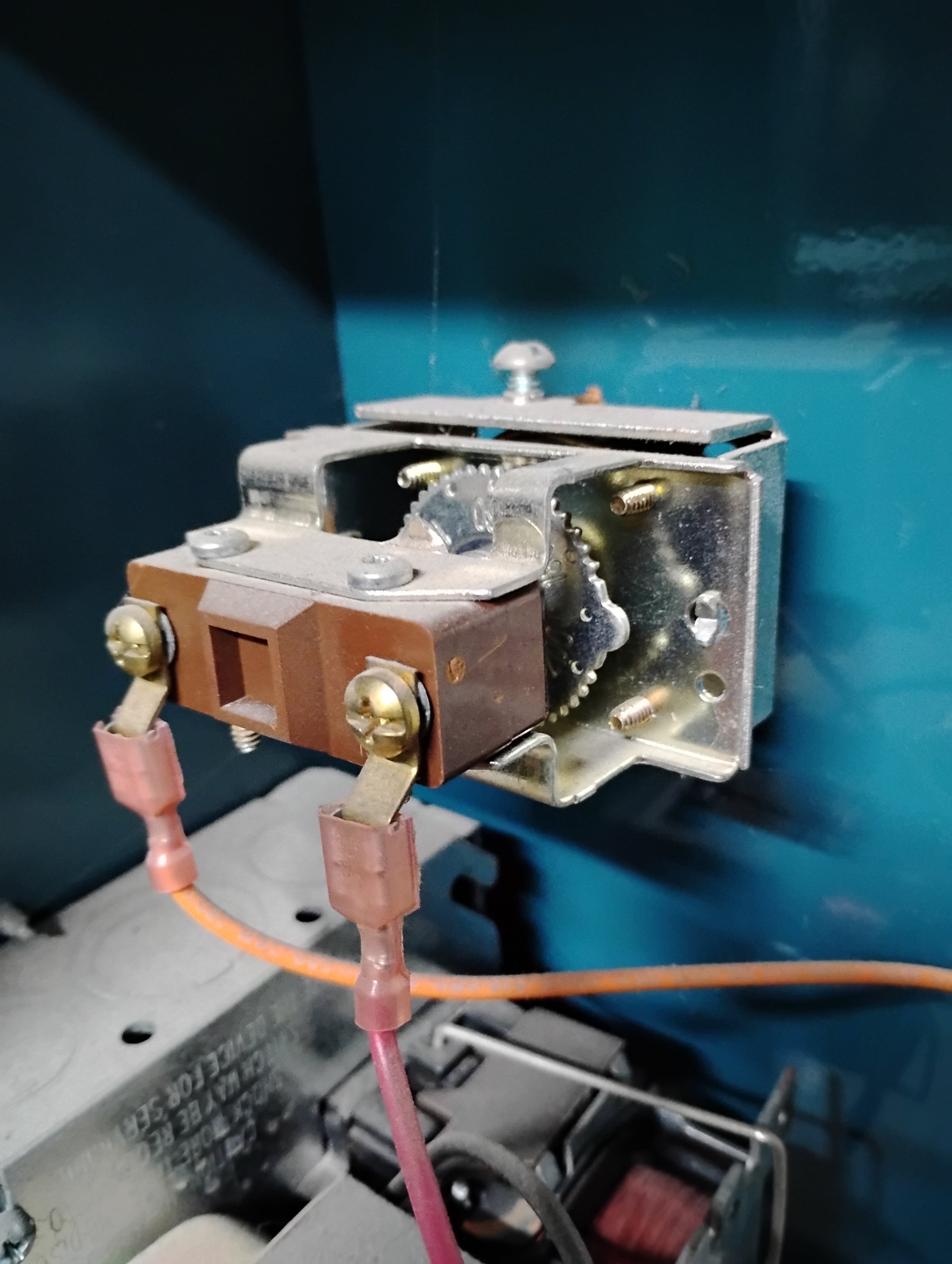

Trying to improve cycle efficiency of sister's Burnham 206 gas boiler. The boiler is properly sized for heat loss, but the house is over-zoned, resulting in short-cycling. I've done the following to reduce short-cycling:
  1. Installed new thermostats with adjustable differential/swing, and set differentials higher.
  2. Disconnected some thermostats at the zone controller and jumpered the disconnected zone terminals to be controlled by one thermostat centrally located in those zones.
  3. Turned the aquastat high limit down to 160. We will monitor during the winter and adjust if needed.
I've checked the supply water temp during boiler runs to verify the aquastat make/break temps, and it does break at 160 and make after SWT drops to 125. So the built-in differential is 35.
I would like to improve on that by effectively increasing the differential so that SWT has to drop lower, say to 100, before the boiler can fire again. So on a call for heat, the zone controller would energize the circs, but the boiler would not fire until the SWT has dropped to 100. This reduces average water temperature and increases boiler run time, both of which should improve cycle efficiency.
What controls are available to accomplish this?

    @jesmed1 you're looking at either a HydroStat or some sort of outdoor-reset control. What aquastat is on the boiler and where is it mounted? What zone controller does she have?

    @Steamhead The aquastat has no cover, no label, no markings. I assume it's whatever Burnham puts in their Series 2 boilers at the factory. It's located in the upper left corner on the front of the boiler, behind the cover. Zone controller is a Taco SR506.

    @jesmed1 with that setup I'd use a reset control such as a Tekmar 256. This control adjusts the boiler water temperature according to the outdoor temperature. If the boiler has its own circulator, I'd wire the 256's boiler contacts in series with the boiler's aquastat, so the circulator would continue to run even when the 256 shuts the burner down.
    The 256 has a minimum boiler temp setting which can be set so the boiler doesn't cool down enough to cause condensation.
    You didn't mention if her 206 has a stack damper. If not, I'd add one, so the boiler would not cool down so much between burner firings.

    @Steamhead Thanks, that sounds good. I've already installed a new vent damper to replace the one that came with the boiler but at some point had been removed.
    I understand the condensation concern and will try to mitigate that by programming the reset so the boiler always finishes above condensing temps. Because of low water volume (and mostly baseboard rads), the boiler heats up quickly, so regardless of starting water temp, it will finish at whatever the reset target temp is. So I would program reset target at 140 minimum and 160 maximum. The largest differential I could program into the 256 would be 42 F, so (for example), at the lowest point on the reset curve, the boiler would start at 98 F and finish at 140 F. At the highest point on the reset curve, the boiler would start at 118 F and finish at 160 F.
    But if that still isn't adequate protection against condensing, I could use the minimum temp setting as you say and set the minimum to 130.

    @Steamhead I installed the Tekmar 256 today and it's working well. I set it for a min SWT of 140 and max of 160. I left the differential on "auto." Under today's conditions (outdoor temp of 55) it targeted the "min" SWT of 140 with what appeared to be a differential of 20, centered on the 140 target. So the SWT cycled between 150 and 130. Then on a design day when the target is 160, it should cycle between 170 and 150.
    Previously almost every boiler firing cycle would end with a SWT of 180 with the aquastat hitting the high limit. So I think this is going to make a significant difference. Thanks for the tip.
