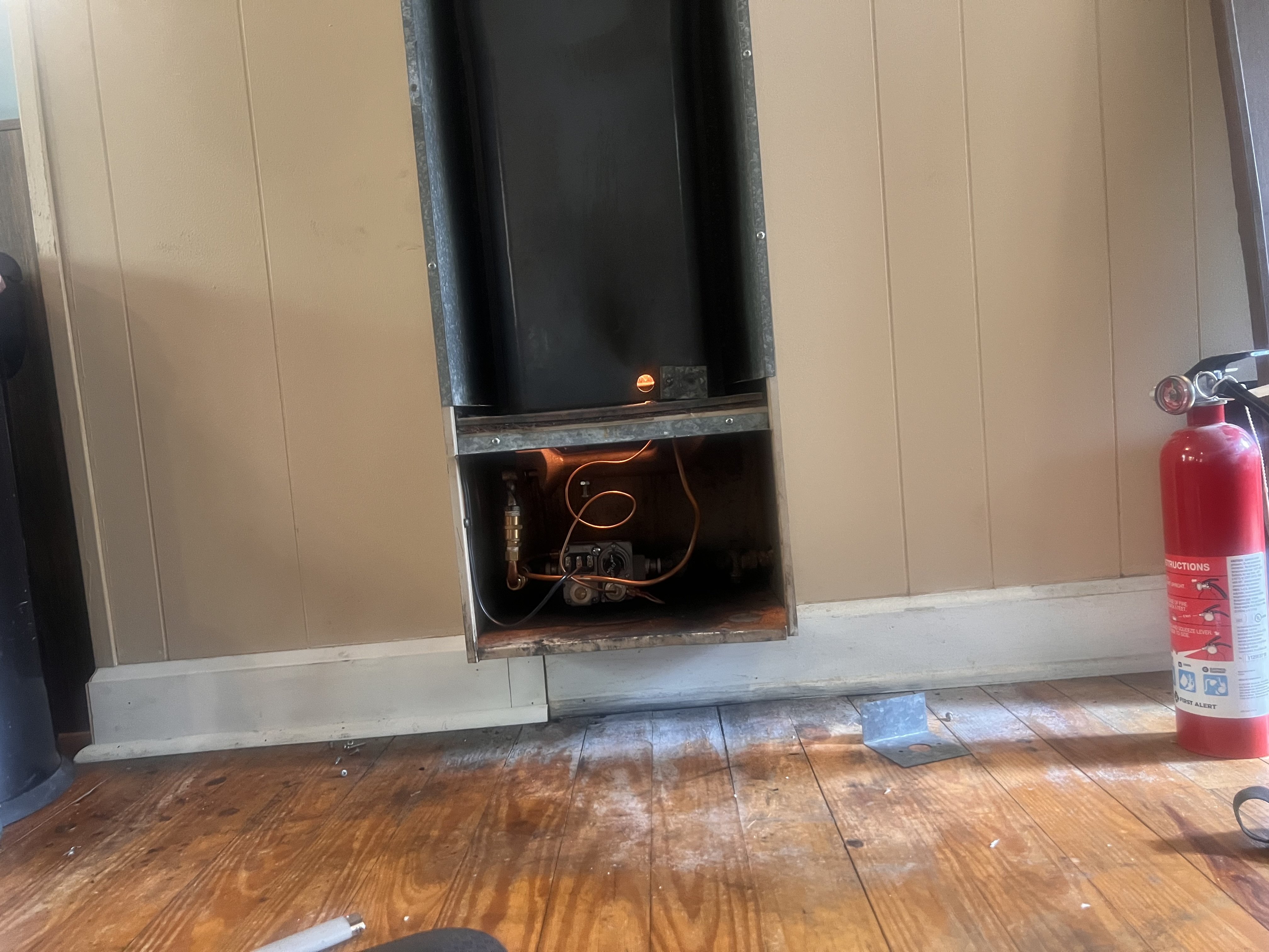

Thank you to everyone who gave their advice and support on my last post. I decided to make a new post to hopes of not confusing anyone. Although the topic is still to get my propane in wall heater to work.
We have installed a new gas valve and thermocouple. No leaks, no putty, no pilot light issues. When the pilot button is pressed and pilot is lit, it stays on. I believe the new gas valve was needed.

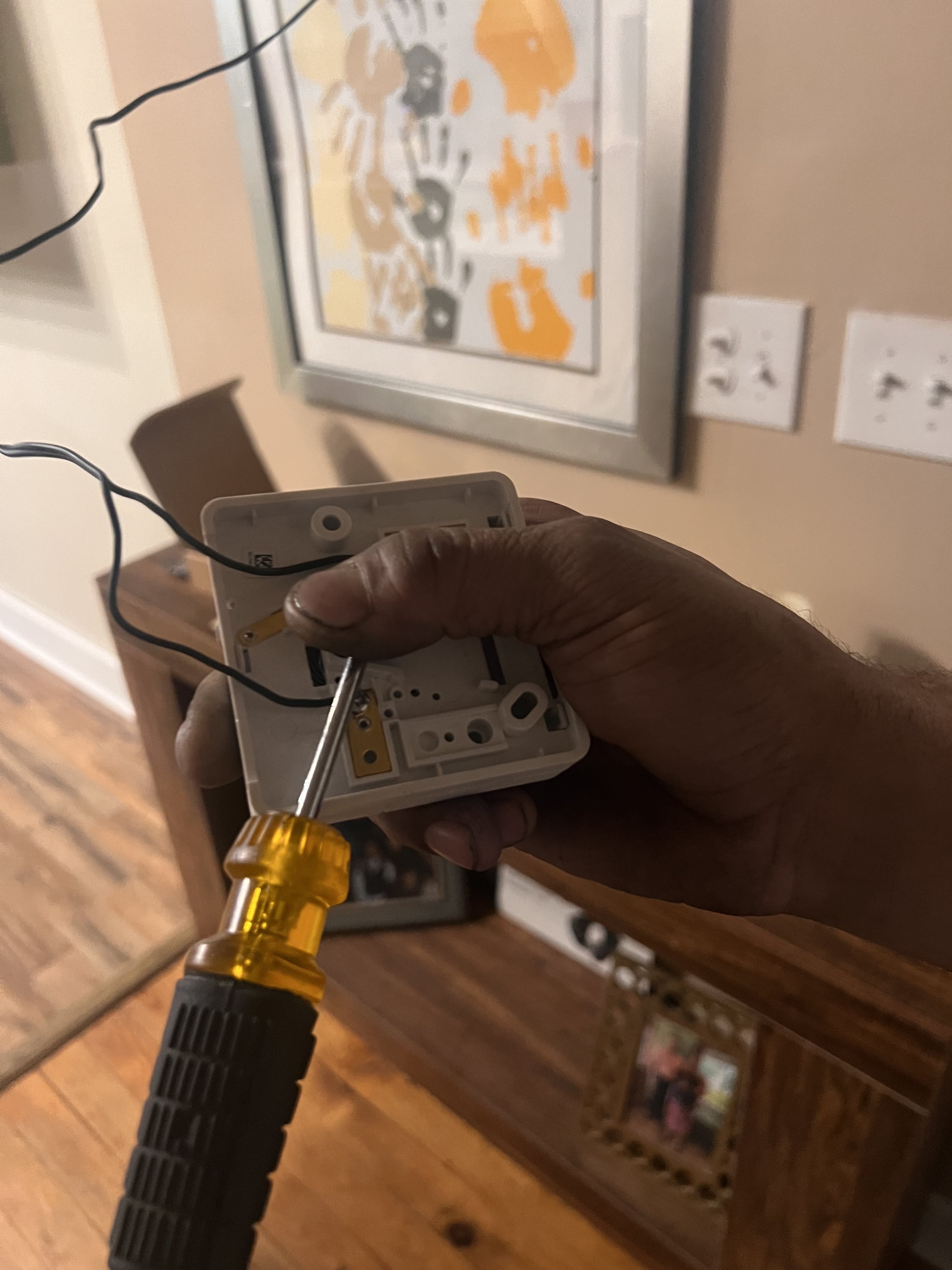

Now the burners will not turn on when the pilot is lit. The only the way the burners come on is if we do this “trick”. Hold a screwdriver to the back of the thermostat on its 2 positions ( shown in picture). Then I can hear and see the burners will kick on through the pilot light peep hole. While holding the screwdriver to the thermostat, the burners and fan seem to operate fine. What does that tell me? What am I missing or need to replace? Please advise. Thanks.

    That something is amiss with the thermostat. The thermostat is just a switch actuated by temperature — and it isn't turning on. Probablly time for a new thermostat…

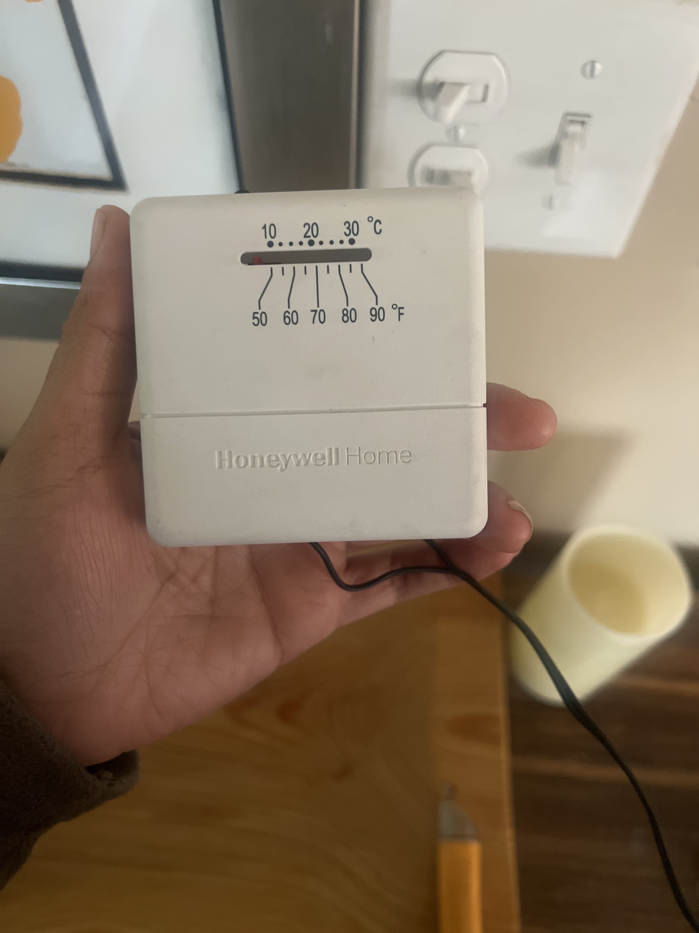

    the thermostat is new. It’s a Honeywell heat only.Maybe been hooked up for 2weeks. The old one was thrown out years ago.

    I agree there is something wrong with the thermostat.
    If this is a millivolt system you would need a millivolt thermostat

    If that picture is indicative of when you tried to get it to work I'd say it may be working correctly. That picture shows it set below 50° ( knob on top is all the way to the left) which means it wouldn't run. Try turning it up.

    If it is the CT30A I don’t believe it is millivolt compatible from what I found online.

    Maybe remove the plastic thing (shipping insert) if it has one.
    HVACNUT Posts: 7,838
    Get a cheap digital with electronic switching.
    I know the pic is far away and its a little hole, but I see orange and no blue.
    Its not a millivolt gas valve.
