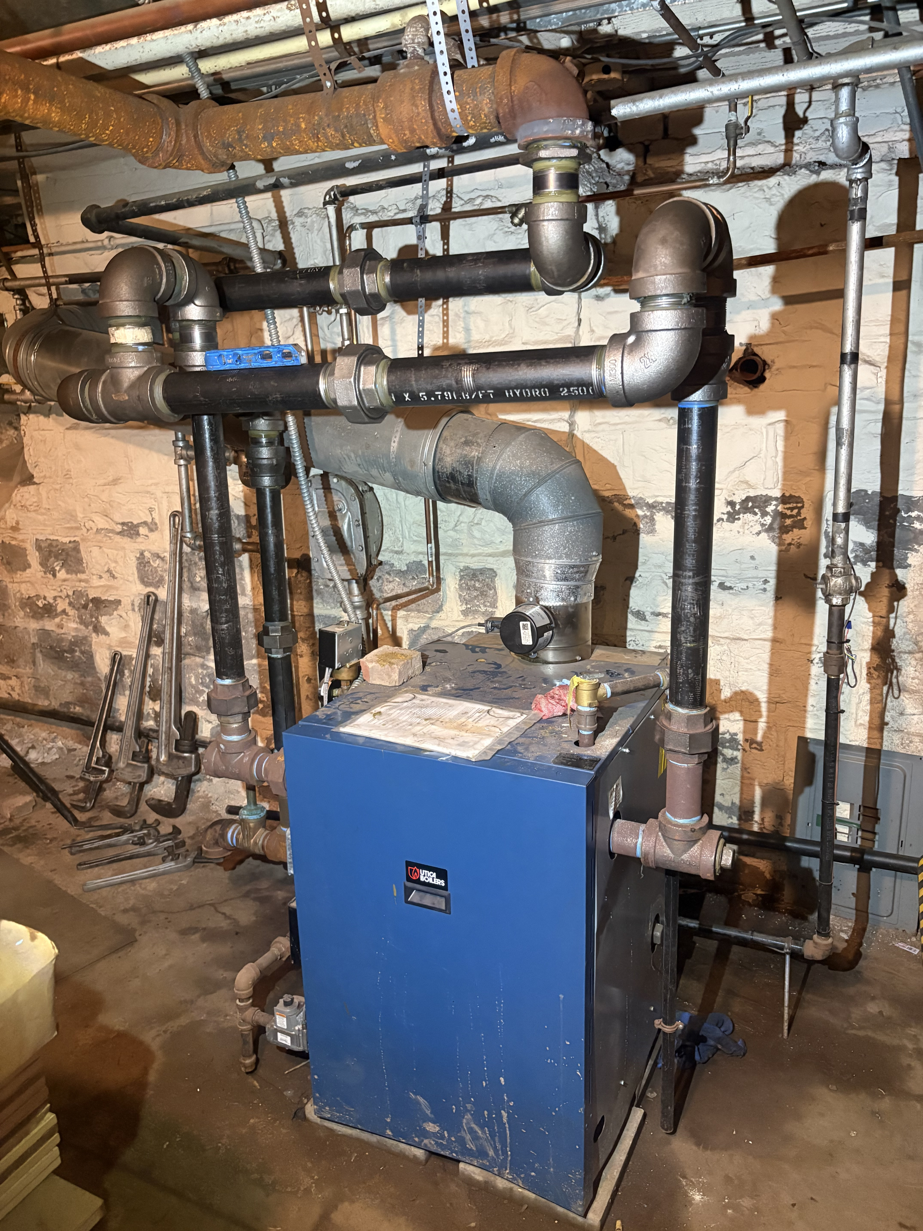

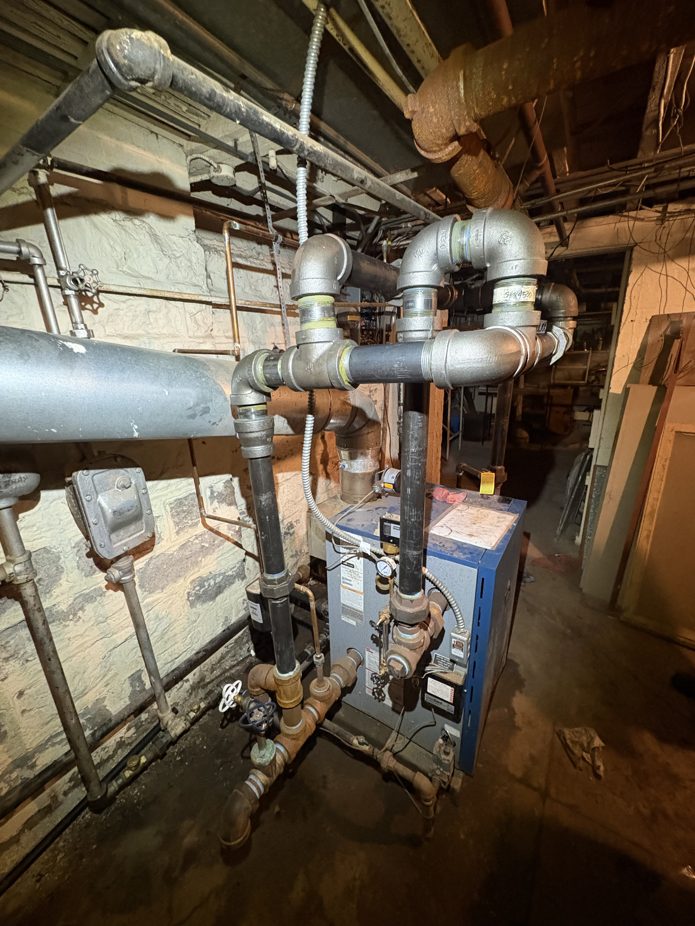

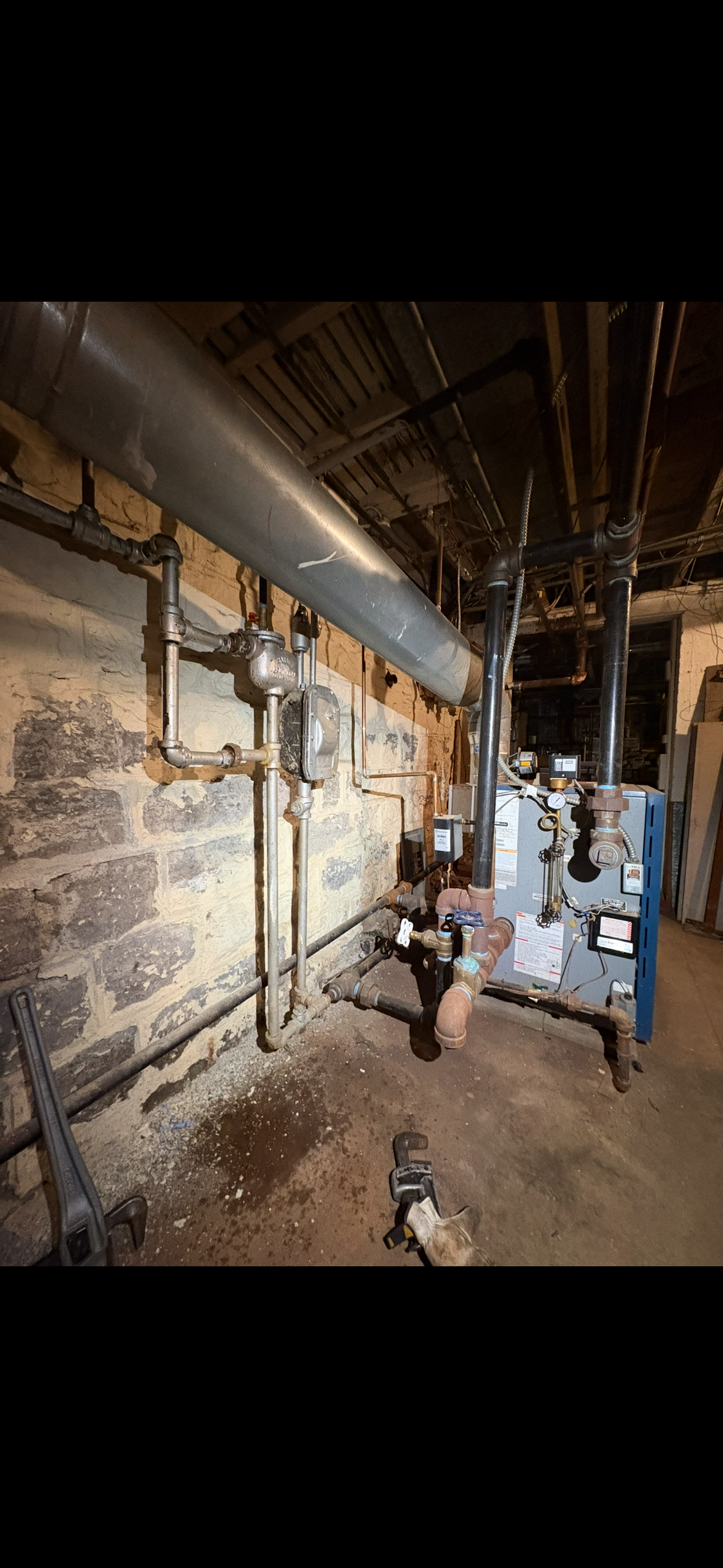

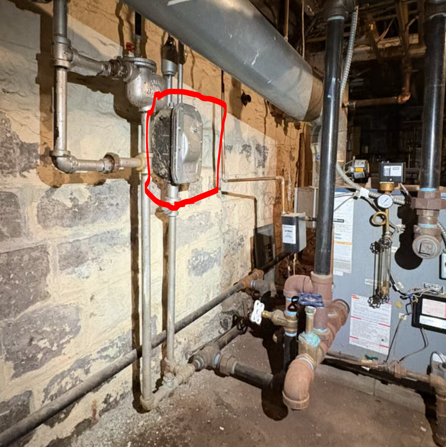

so I probably don’t have to say this but I will anyways, I have little experience with fixing steam heating systems. I was sent on a call to a boiler the company I put in a few years ago. Complaint was that it hasn’t worked right since we put it in. They have a pressure tell maintaining 2psi. The header is all knuckleheaded together among other things. I guess my main question does having the Webster vent trap and other contraption next to it mean it is meant to be a vacuum system and vacuum system only? Excuse me if any of my terminology is incorrect. I am very green when it comes to residential steam. I really want to want to be the guy that straightens this system out for these people. Any response is greatly appreciated. I also apologize for posting so many pictures, the flue is right in the way of the Webster components and I just wanted to you guys to be able to see all the piping in efforts to get the best answers as possible.
IMG_2171.jpeg IMG_2172.jpeg IMG_2176.jpeg IMG_2186.png IMG_2187.png IMG_2217.jpeg IMG_2218.jpeg IMG_2219.jpeg IMG_2220.jpeg IMG_2221.jpeg IMG_2222.jpeg IMG_2216.jpeg

    Well, yes. It does lokk as though it had been a Webster system — but it has also most likely been … um… modified?

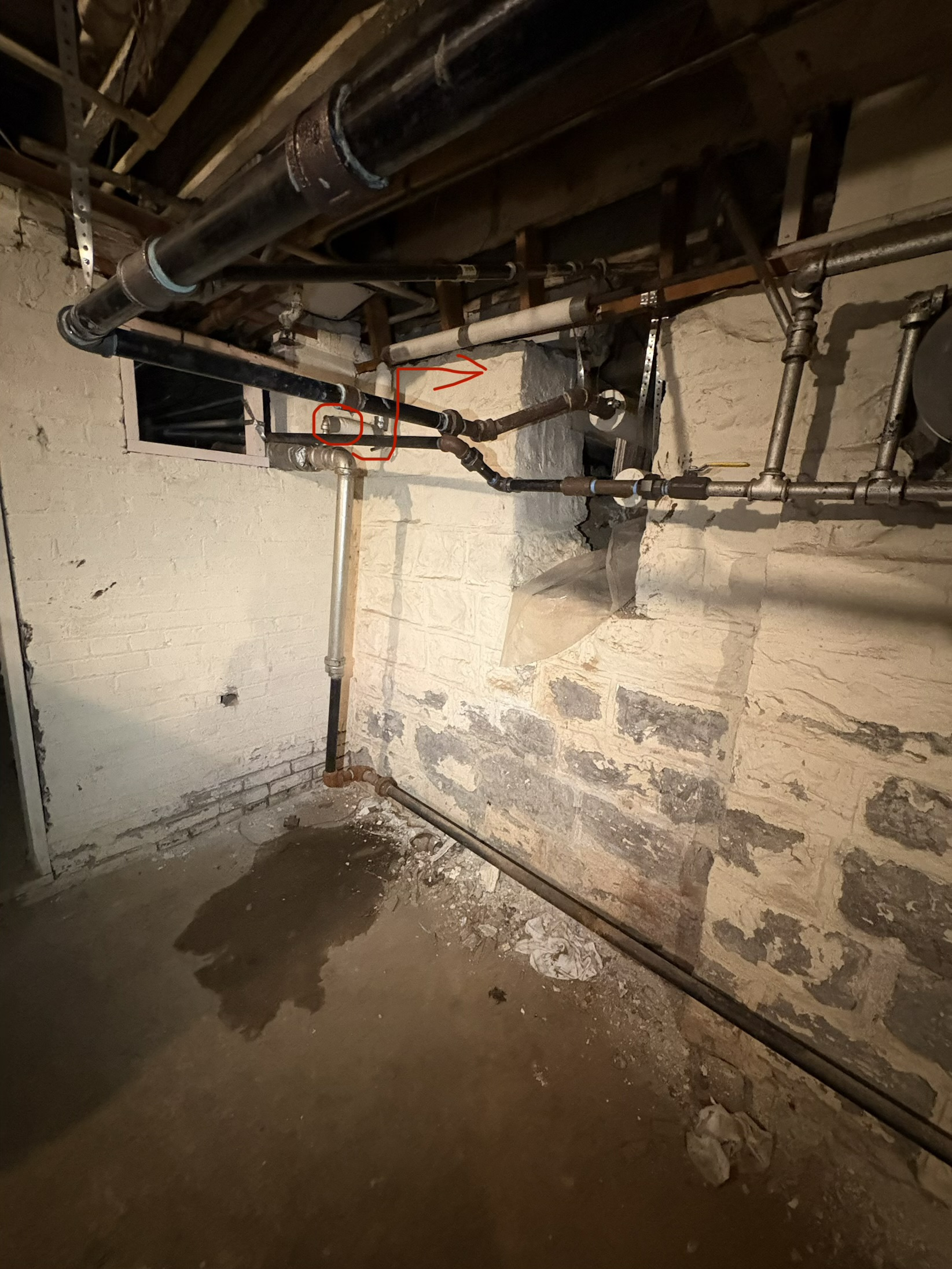

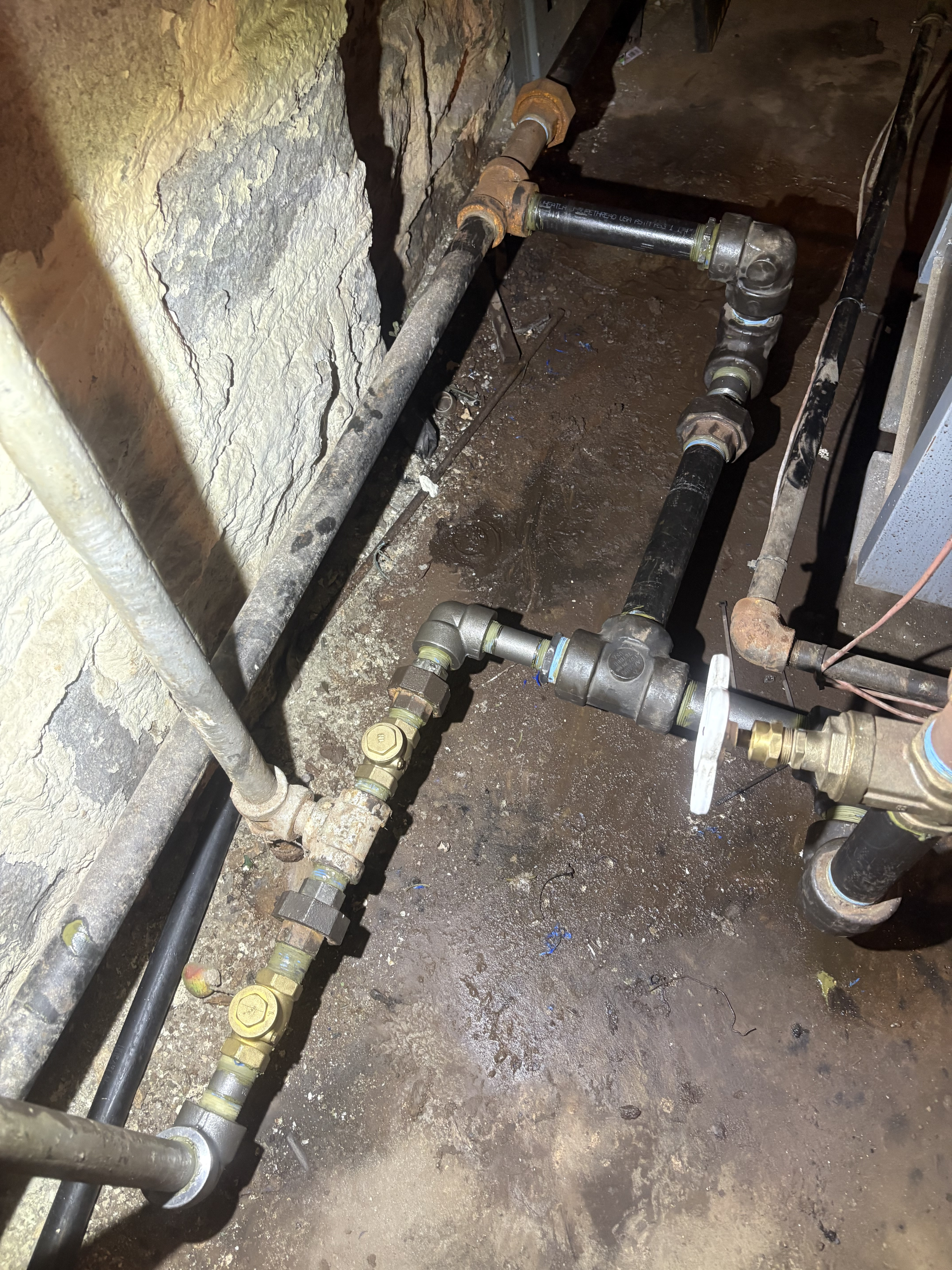

    Someone else will probably shriek, so I will first — the near boiler piping is not good. It may work — steam is remarkably forgiving — but it ain't right and should be redone the way the boiler manufacturer (and us) want. It will work a lot better.
    In the meantime, the Webster — and similar systems — could and did drop into a vacuum at times, but that isn't the most important characteristic. They are called vapour steam systems, and were meant to work on very small pressure differences between the steam main supply lines and the returns, and 2 psig is about 4 times the maximum which they will run reliably on. If you have an ordinary pressuretrol, though, that can't be doen, and so they should have a vapourstat instead, set to a cutout of 8 OUNCES per square inch, with a 4 OUNCE differential. That's an easy right off the bat fix.
    Then for your next project — actually two. Get a copy of The Lost Art of Steam Heating (Amazon or the store on this web site) and study it and learn how vapour steam systems in general are supposed to work. Then, taking that knowledge with you go through the entire system and familiarise yourself with all the piping and other devices, particularly the inlet valves on the radiators and any traps and vents — and then figure out what they were supposed to do, what they might be doing now — and what is missing or otherwise "modified". Take your time.

    it is a warren webster vapor system. 2 psi will cause havoc. it needs a vaporstat set at about 8oz/in^2 and correct near boiler piping and if possible to have boiler return trap and the vent plumbed in properly. those are those rectangular boxes behind the boiler. hopefully theymatched the boiler to the connected edr or undersozed it a bot or controlling the pressure will be tough.

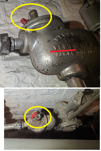

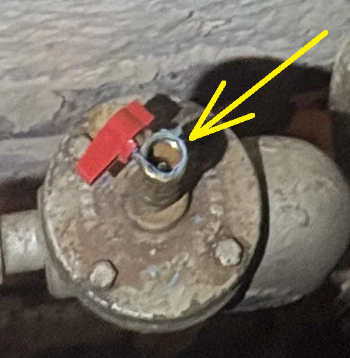

    @EdTheHeaterMan I say you are the control electrical an helpful image guy too.

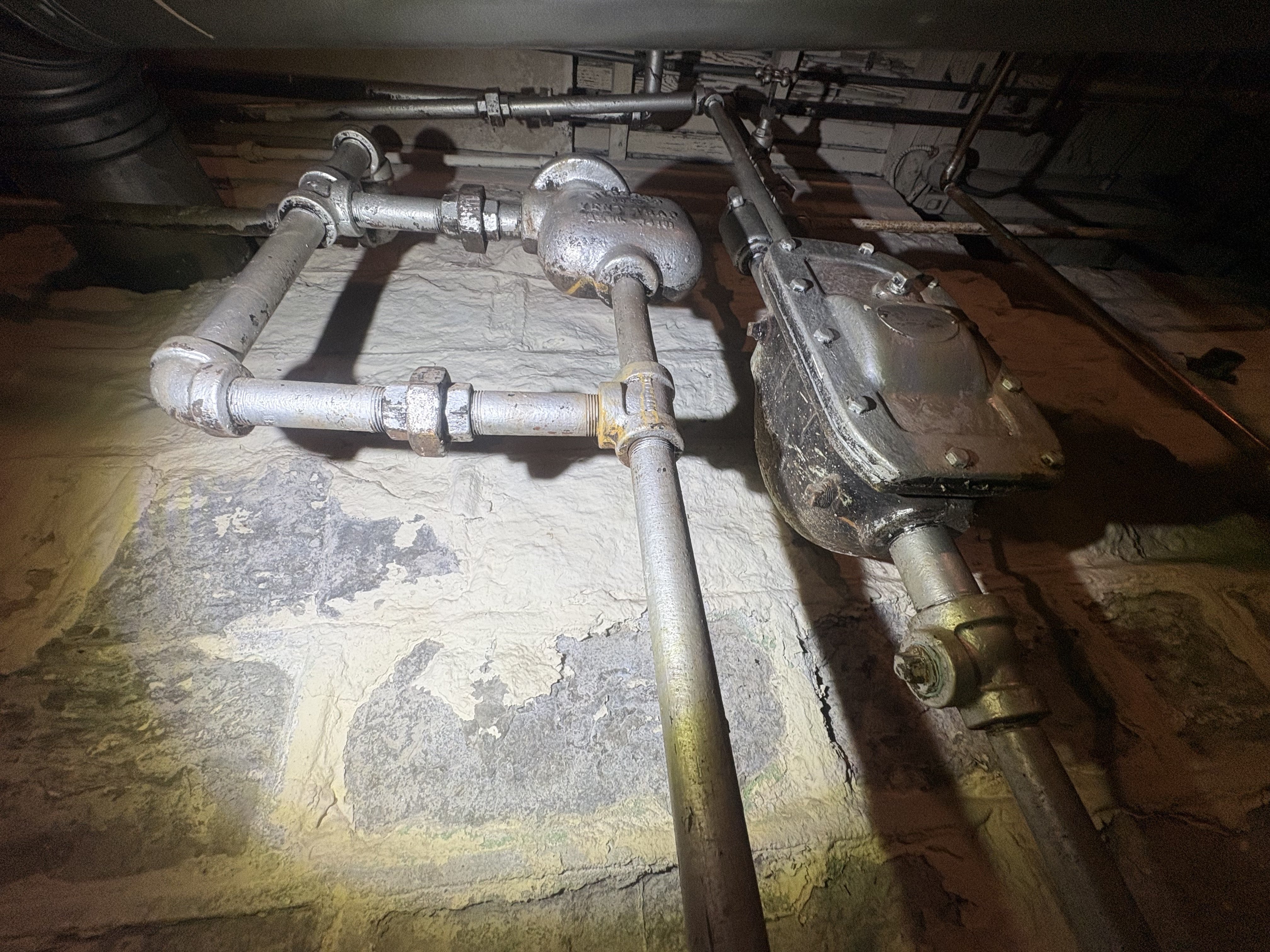

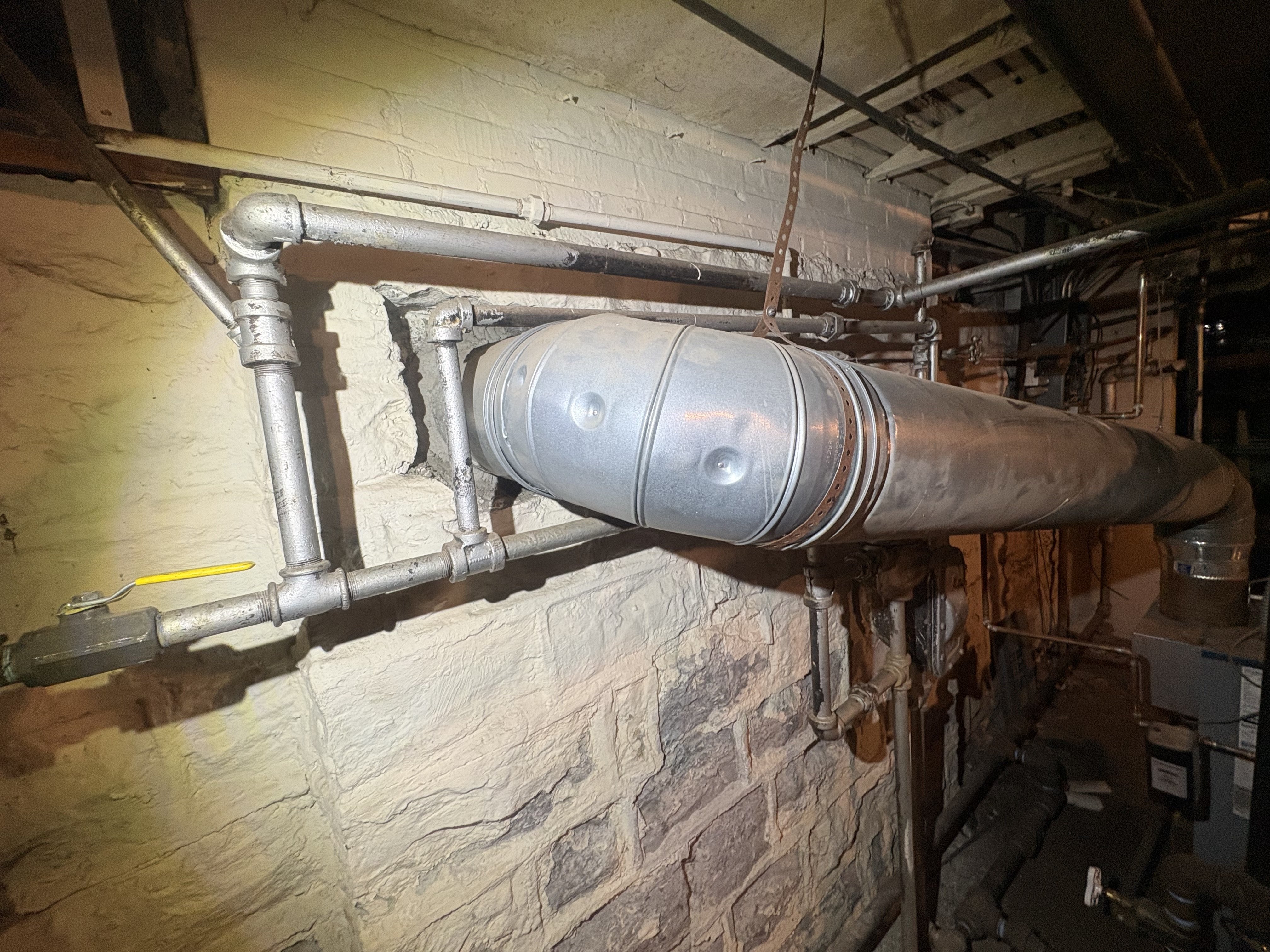

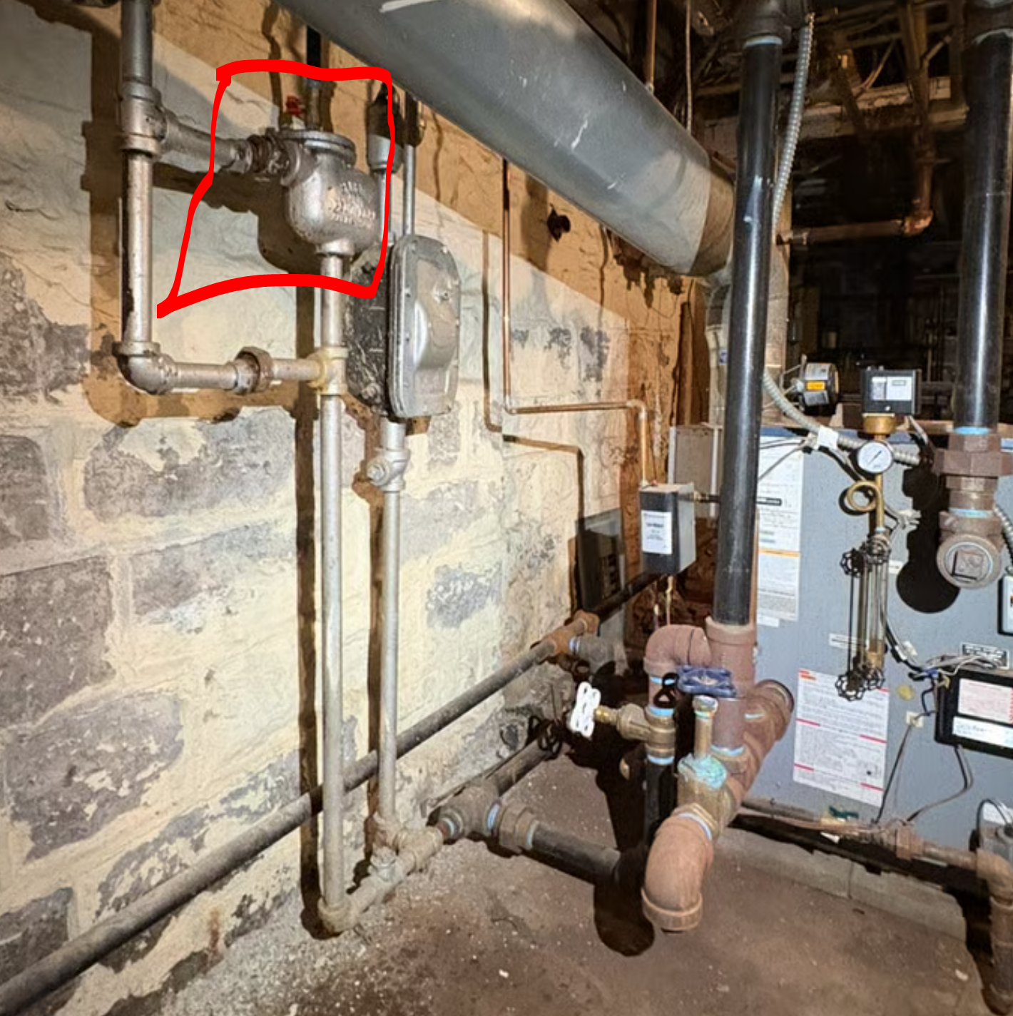

    @service_fitter502 Even if it was a Vacuum system how does the air get out ? My guess it it would be considered a Vapor system. Many systems can develop vacuum, they just don't retain it very well.
    If the air can't get out the steam is not going to move very far. This valve seems closed.

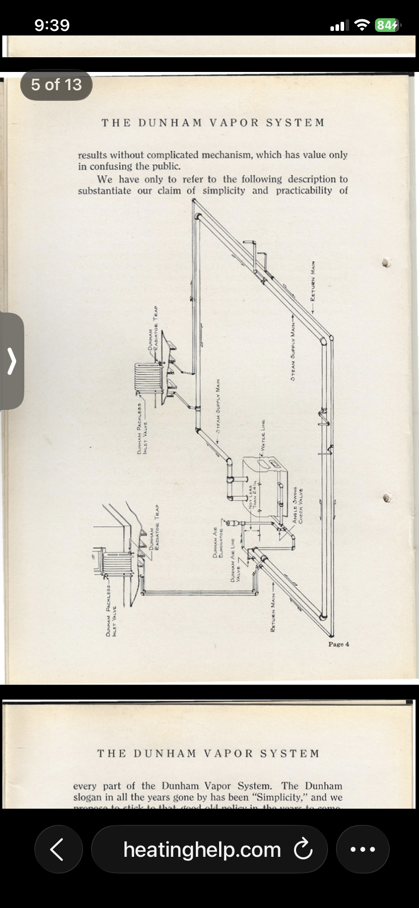

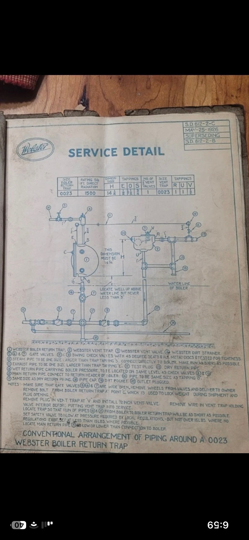

  • thank you Ed, I’m in Louisville ky, and Jamie I ordered the original and the companion yesterday. They should arrive on Friday. I’ve got my materials to make the header right on will call ready for pick up. I quick fools search of the model number and I was able to find the manual on it and it explicitly says how to do it.

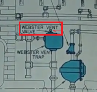

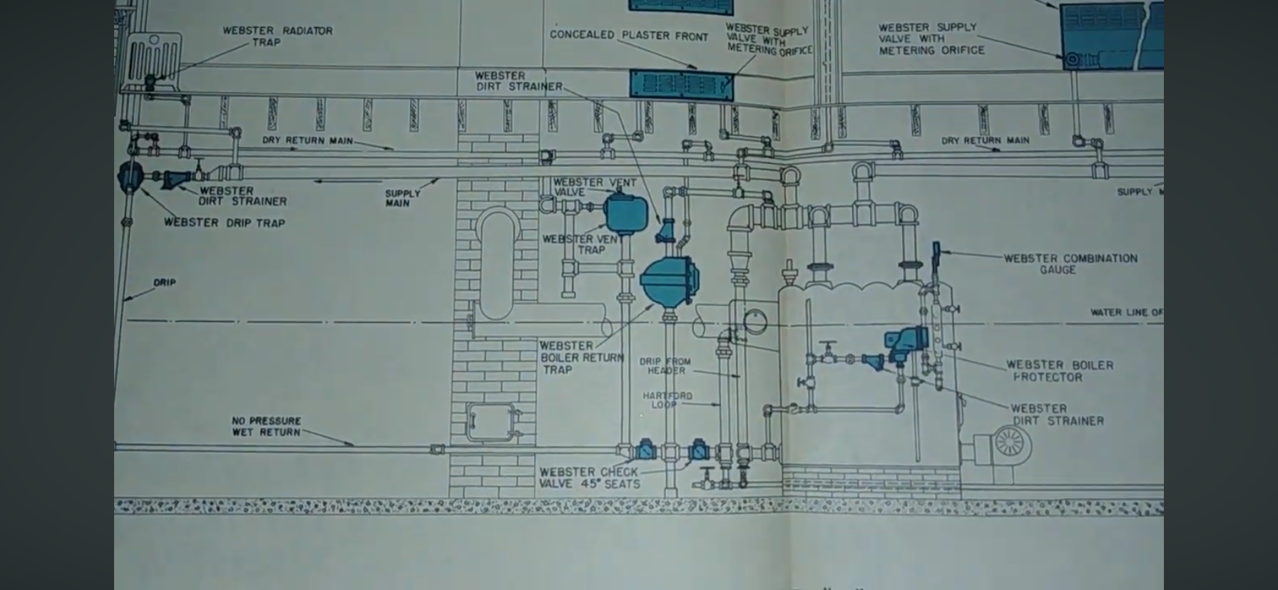

    I found some literature here on heatinghelp.com the Dunham vapor system from way back in the day. I noticed though that in the original piping schematic of that type of system, there was not an equalizer line.. why would that be the case? Also I know it might be difficult for you to say for sure with out seeing the system for yourself, is that the same type of system that would have a Webster air trap set up on it? Also do you know what that device to the right of it is by chance? I really appreciate you guys taking the time to reply to me.

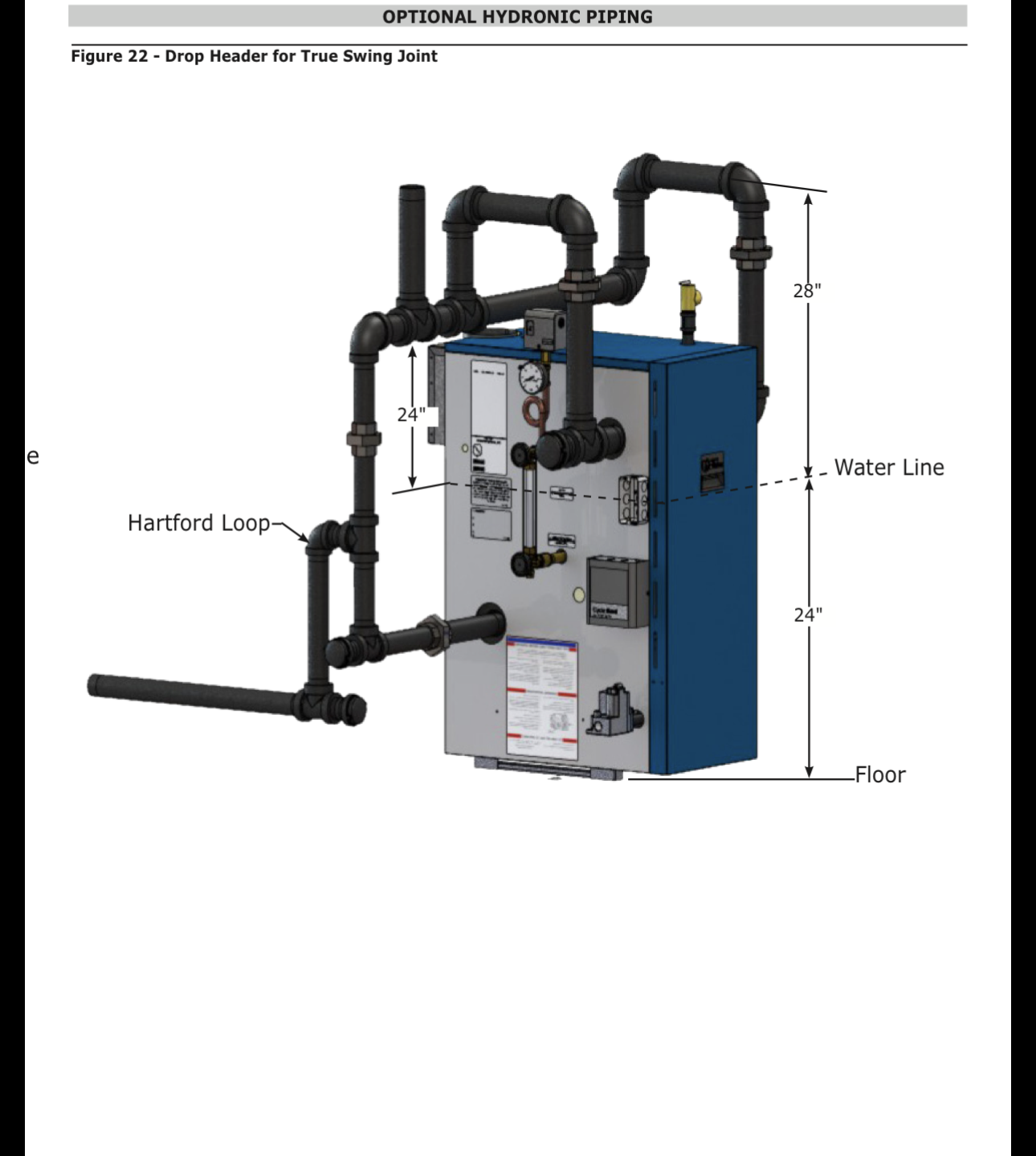

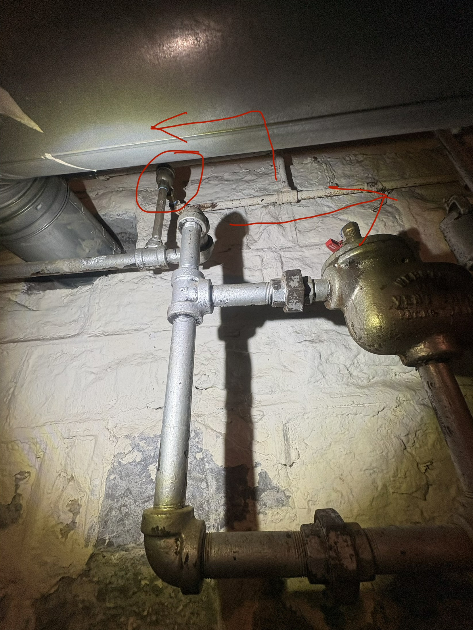

    heres how the header is going to end up when I’m done.

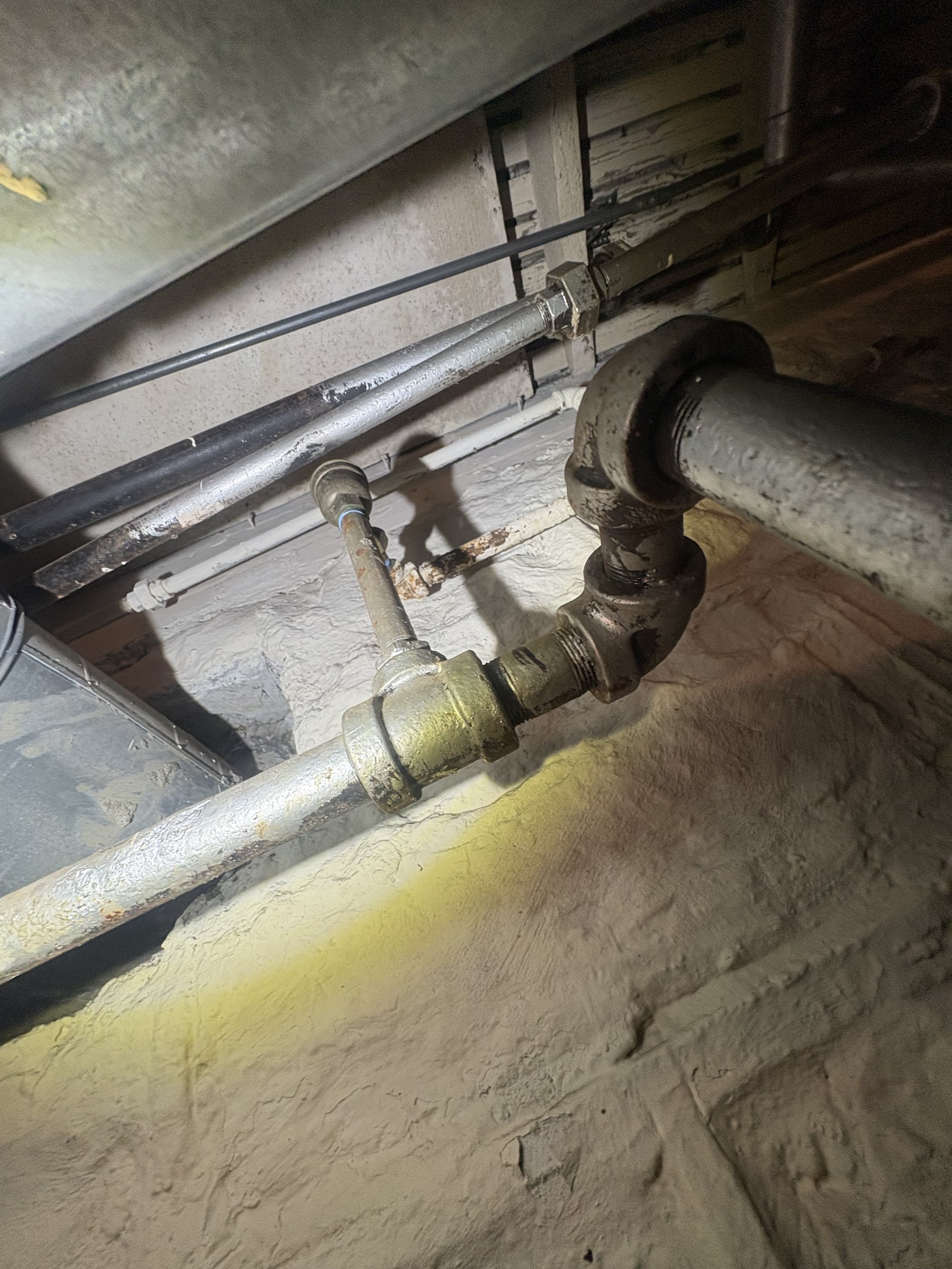

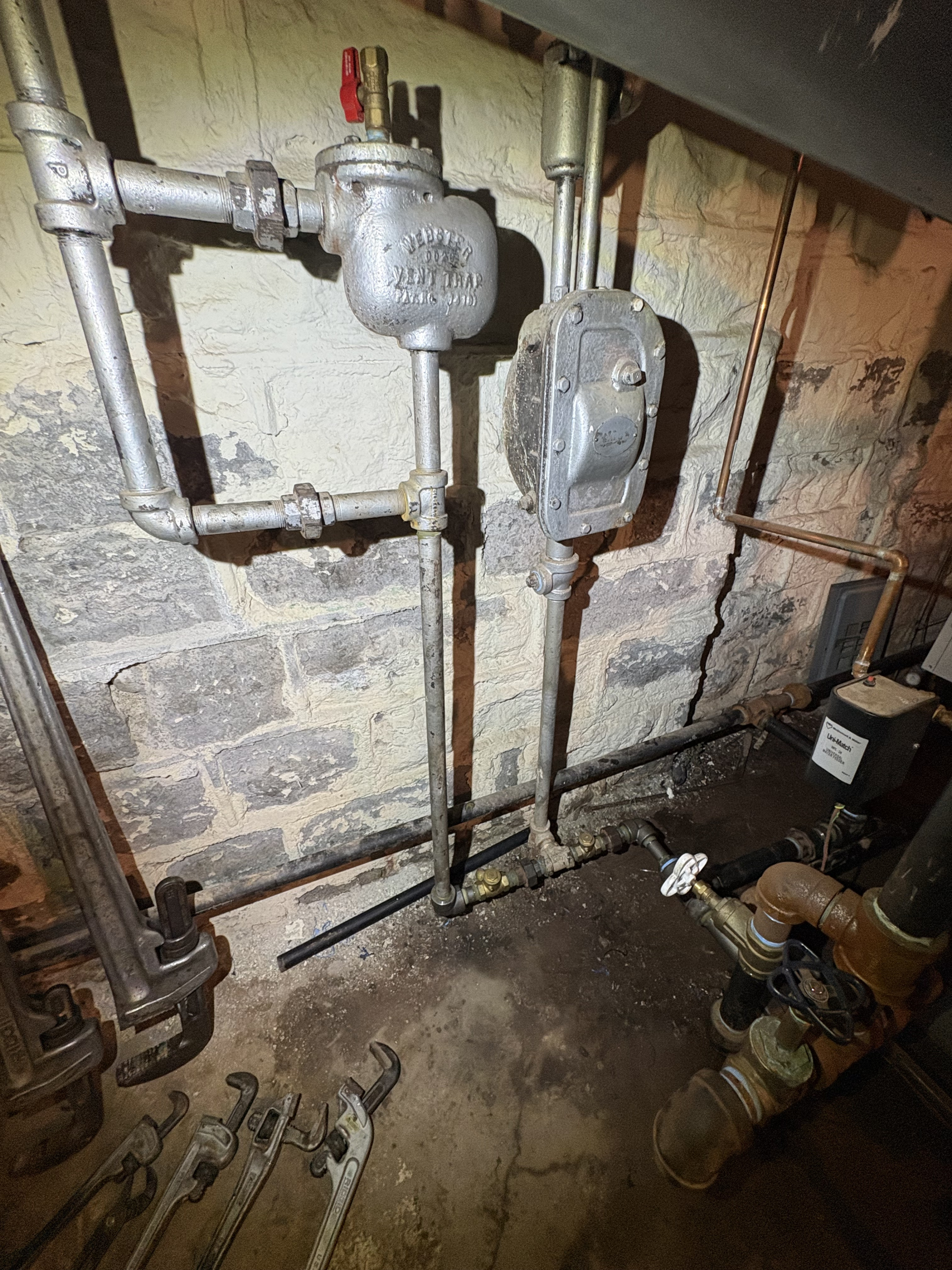

    i believe the other device is a boiler return trap. its job is to let some steam in to the return to equalize the supply and return to allow the condensate to return to the boiler if the differential between the supply and return gets too great. that is why it is important that the only vent be at the vent by the boiler, so that steam can go directly to that vent and close it instead of traveling throughout the returns causing various problems with venting of radiators and banging.
    mattmia2 Posts: 18,303
    dunham busch isn't the same as warren webster although pretty much all vapor systems work by controlling the amount of steam entering a radiator through a metering valve with a controlled, very low pressure.

  • @109A_5 that is how I found it lol. I didn’t think it looked right. So would that just vent to atmosphere? Given that I’m green and it being a threaded connection I was hesitant to leave it open then leaving in case it was supposed to tie into some where.

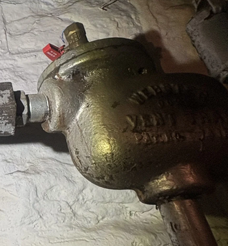

  • @mattmia2 good to know about that needing to be the only vent! Somebody at some point added a Hoffman at the end of the main before it slopes down into the return. So I’ll add that to my list as well. Is there any literature you could direct me to that is Warren Webster specific?
    109A_5 Posts: 4,699
    " Complaint was that it hasn’t worked right since we put it in. "
    That seems kind of vague to me. I'd try to get more details about this complaint. It may give you better troubleshooting direction.

    here are 2 warren webster catalogs, there are some diagrams although they aren't the full design guide:
    the catalog during wwii has some steel and iron substitutions of things that would normally be brass
    there is some mention of webster systems in tlaosh but it doesn't seem to quite be the systems i have seen people post here.

    the outlet of the vent should have a main vent on it.
    if you keep the pressure controlled with a vaporstat, the return trap and single vent are less important.

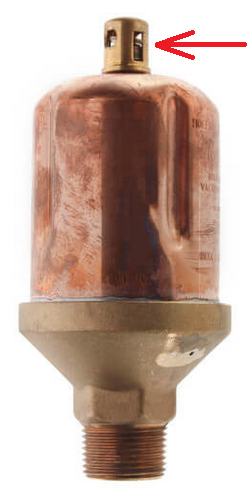

    Is the Hoffman vent a vacuum vent ?

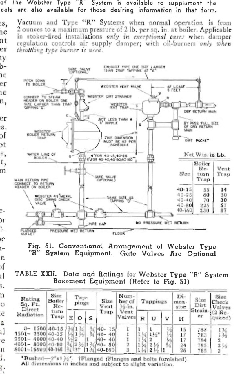

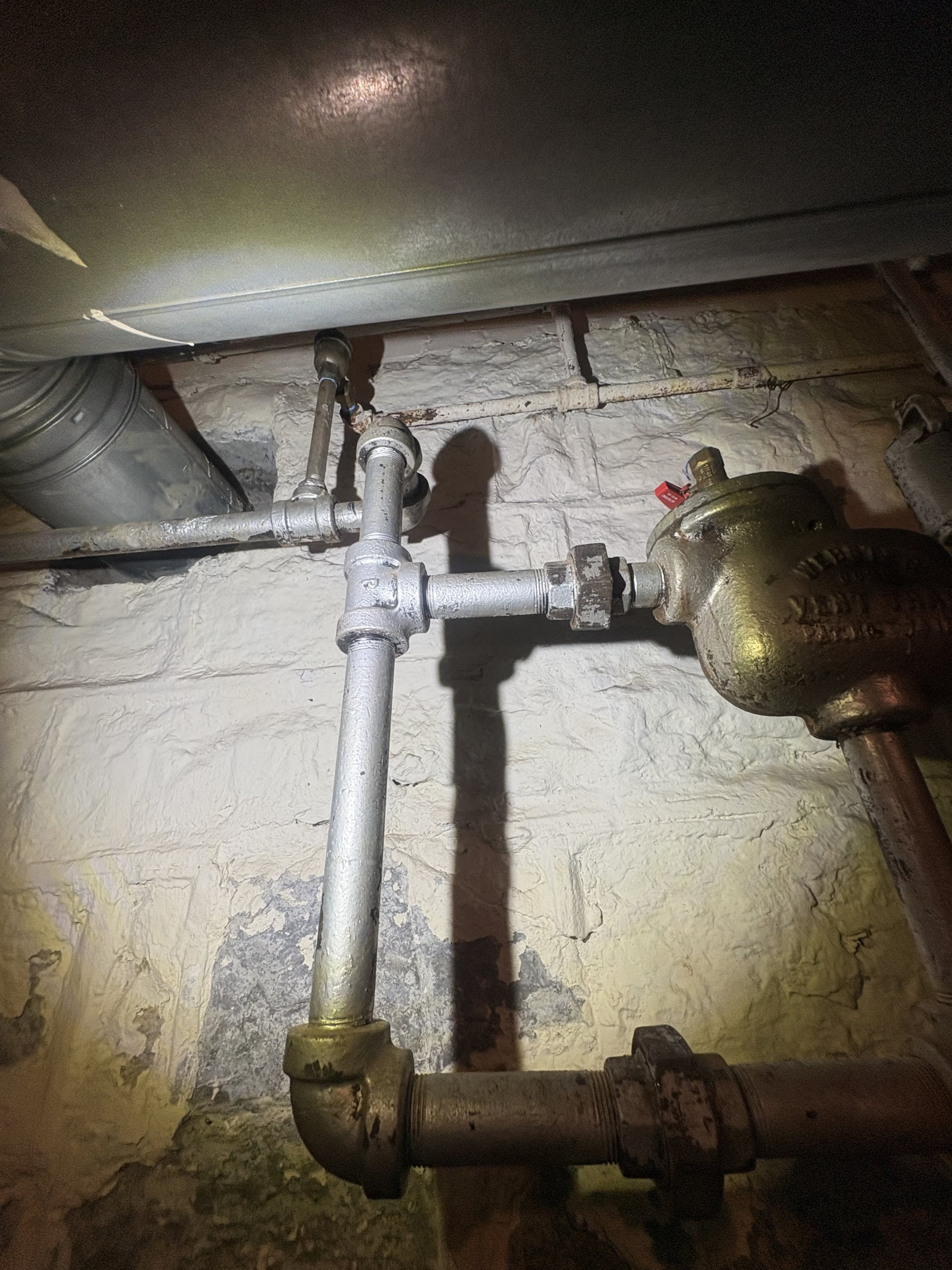

    it looks like it is a type r system. it could go in to vacuum with a check valve on the vent outlet but it wasn't like some other warren webster systems that used a mechanical or educator vacuum pump and smaller returns so it needs vacuum to vent properly.
    it looks like the parts are there at the boiler,

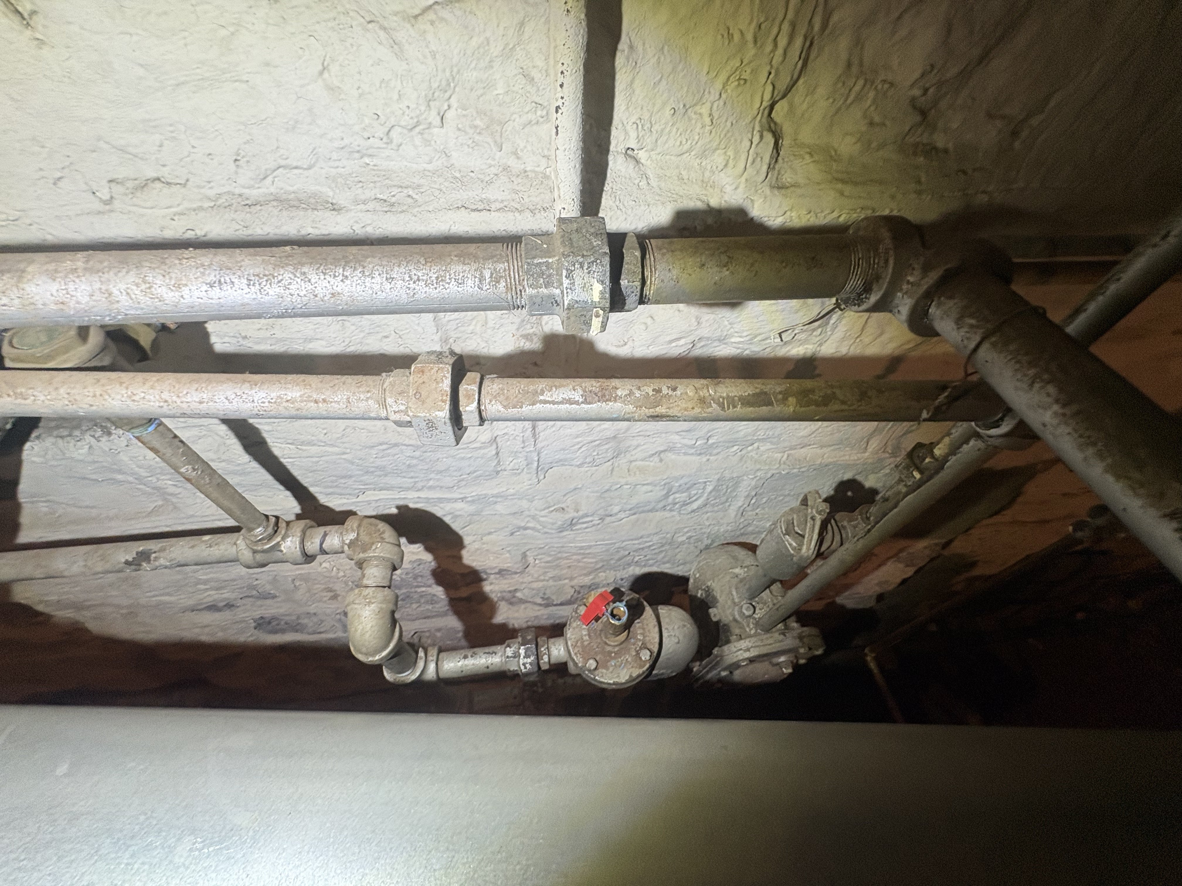

    the boiler return trap:
    and the vent:

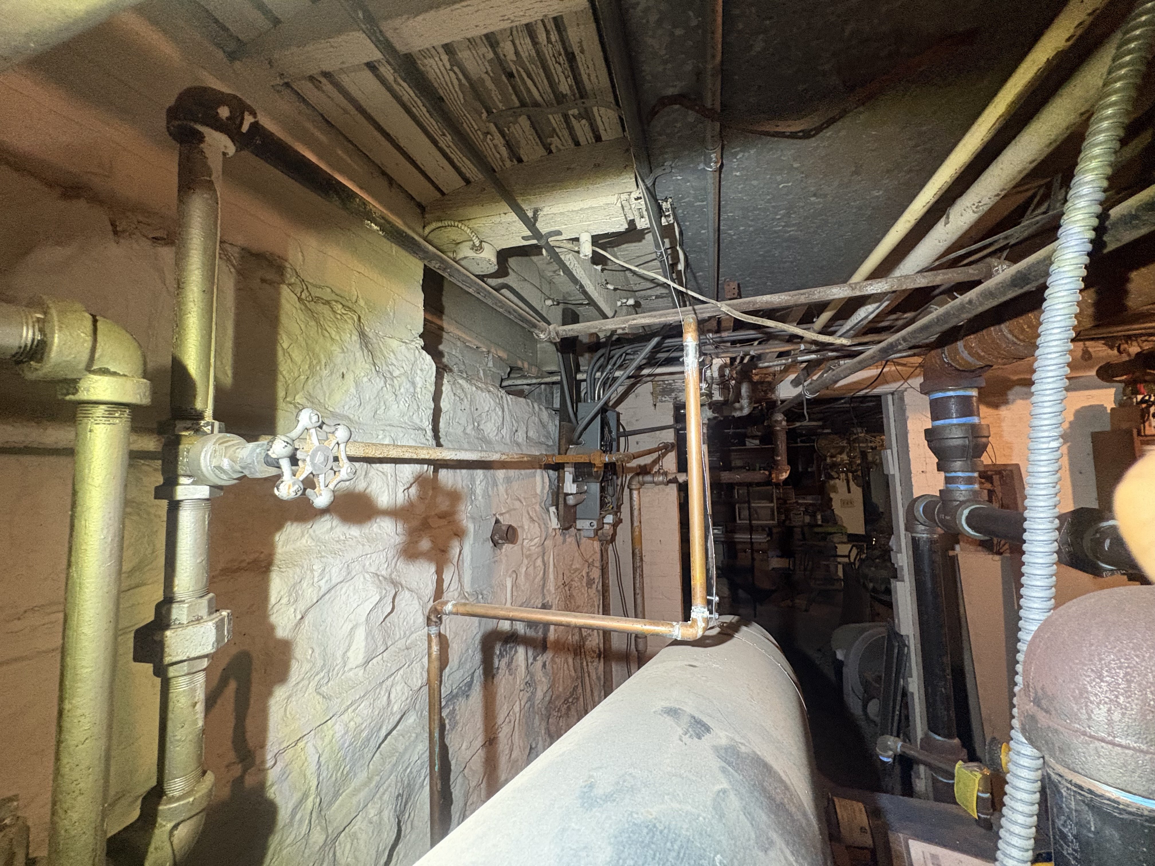

    can we see what is at the radiators?
    EBEBRATT-Ed Posts: 21,268

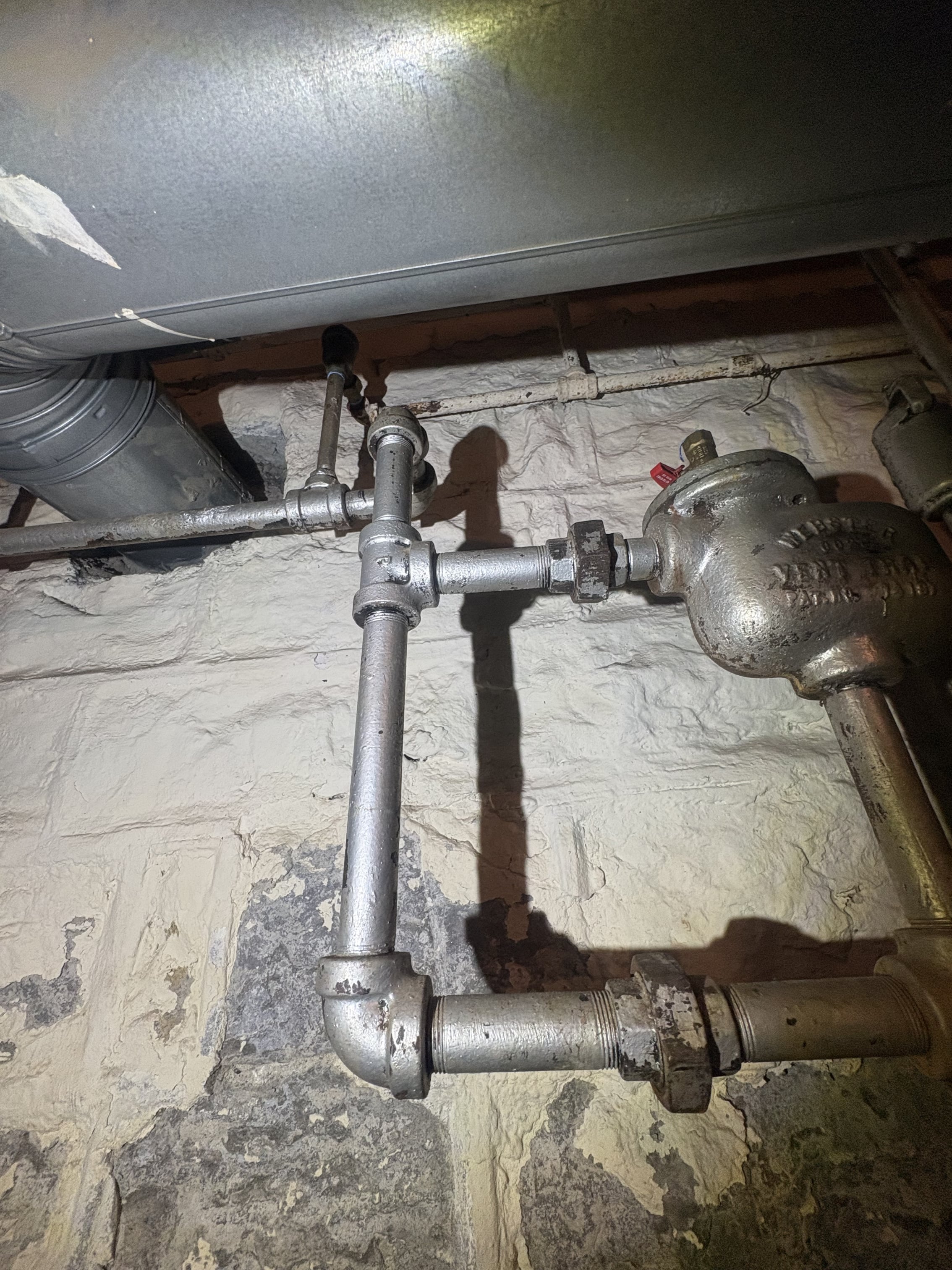

    Fix the header and make sure the Hartford loop is right. You need a vaporstat to keep the pressure low in addition to the pressure control you have and they should be on seperate tappings and brass pigtails. a 0-5 psi gauge would be nice.
    If you don't have tapping's you could put a tee below the safety valve or drill and tap the header.
    Post a few radiator pics and we will see what else needs doing. Louisville , KY your probably the only one doing steam. Make sure the mains are pitched.

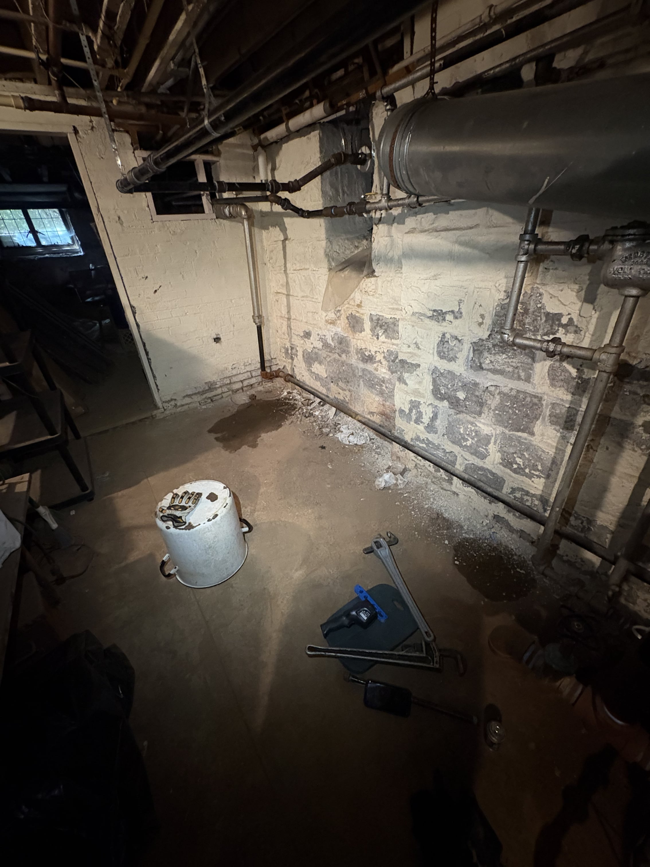

    look for cross over traps in the basement. The air all has to come out through the vent trap.

    @EBEBRATT-Ed makes a good point " The air all has to come out through the vent trap. " the existing Hoffman vent may help vent the steam main, but how does the air in the radiators get let out of the system so the radiators can fill with steam ?
    As @mattmia2 mentioned " the outlet of the vent should have a main vent on it. " This may make a huge improvement.

    76, 1/2" x 3/4" Straight Main Steam Vacuum Valve
    Brand: Hoffman
    https://www.supplyhouse.com/Hoffman-401432-76-1-2-x-3-4-Straight-Main-Steam-Vacuum-Valve-11742000-p
    Hoffman's opinion;
    If it was my system and I had to unwillingly abandon vacuum I would put a Barnes & Jones Big Mouth on top of that Webster vent trap for maximum venting. I would remove the valve or use a full port ball valve, probably won't see much steam.

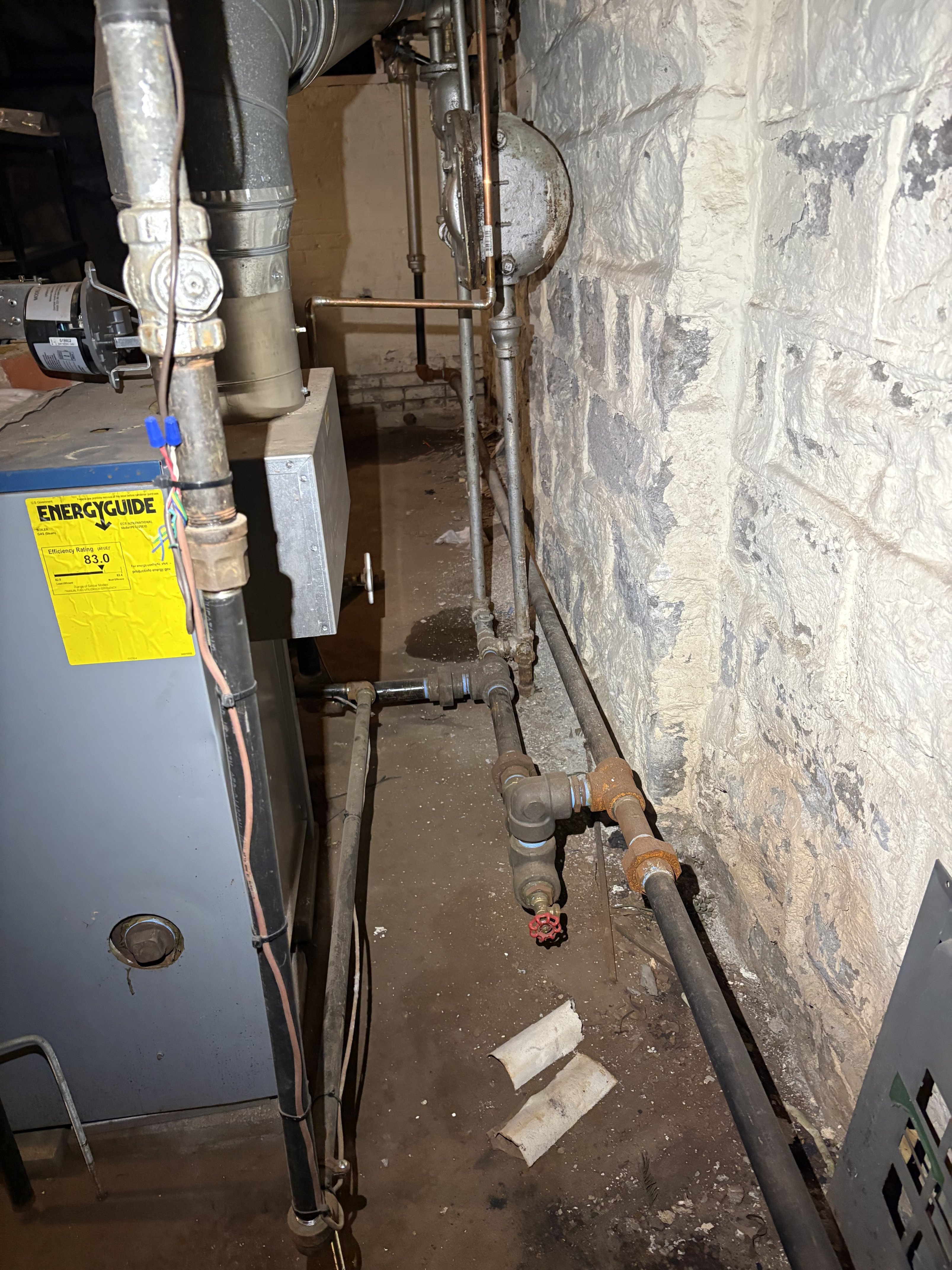

    Looks like something was there, it got removed, the valve was then closed, the vent and/or check valve was never replaced so the valve just remained closed trapping the air causing very poor system performance.
    If you think about it every radiator in the system has to vent through this point with a closed valve. How well can the system work ?
    The 2 PSI was probably needed to compress the air enough to get some steam into the radiators, not very efficient. just to give you a comparison, my house heats just fine at less than 0.072 PSI or 2 inches of Water Column.

    Sounds like your intent is to rebuild the near boiler piping. I'd wash off the production oil from at least the inside of the new piping. May save you a bunch of time Skimming the boiler later on.

    With oil or gas fired steam systems, holding a vacuum is not as important as it was with coal. There should be a main vent where you have that closed valve, but it needed be a Hoffman 76 — they are quite expensive. A Hoffman 75 may do, but I'd be inclined to use one or two (on an "antler") Gorton #2 vents there.
    The vent added at the end of the main is OK… sort of… if you use a vapourstat to control the pressure. I wasn't meant to be there… but crossover traps most surely are.
    I would suggest that you tackle the near boiler piping and install a vapourstat first, then using the knowledge you will get from the books go around and see what else got messed up..

    Steamhead Posts: 18,993
    That vent is so slow as to be almost unusable in a system like this.
    This naturally-induced vacuum technique worked great in the Coal Era, but not so well on oil or gas. The problem is that often you get vacuum before all the air is out, which can cause the remaining air to expand and block steam circulation. I tried it once, never again.
    The vent to use on that Vent Trap is the Gorton #2, which is at least four times faster than that Hoffman:
    https://www.supplyhouse.com/Gorton-G2-Gorton-No-2-Straight-Air-Eliminator-3524000-p
    And get rid of that red-handled valve.

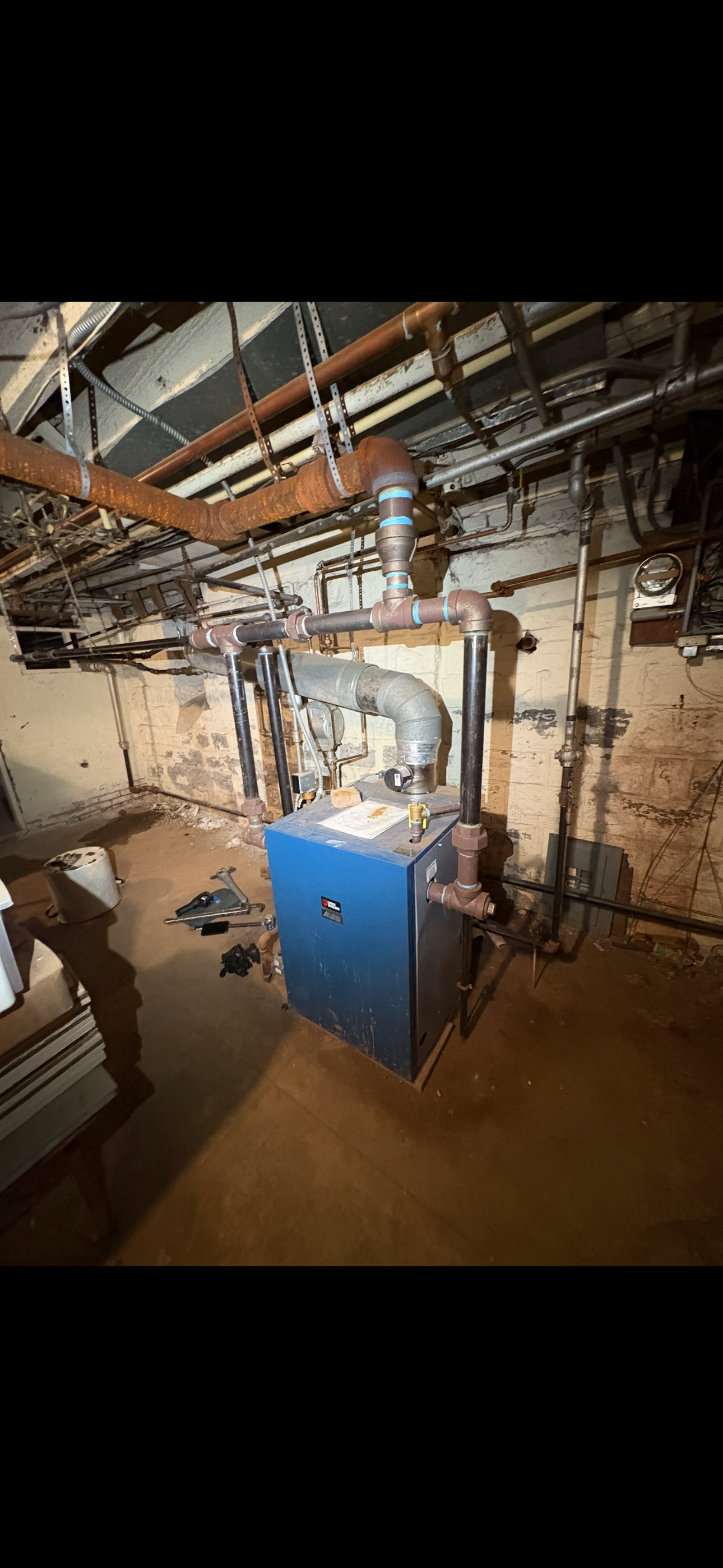

    What model boiler is that?

    most likely the 2 psi pressuretrol was causing steam to blow through various things and in to the returns and out that vent so instead of fixing the system, someone ut a valve in place of the vent or check valve or open tapping.
    109A_5 Posts: 4,699
    If the boiler is well matched to the radiation there would never be 2 PSI until the closed valve was put on top of the Vent Trap, now with radiation venting absent the load is significantly reduced causing pressure.
    And sure if some radiators have bad traps steam may have been getting to the Vent Trap.

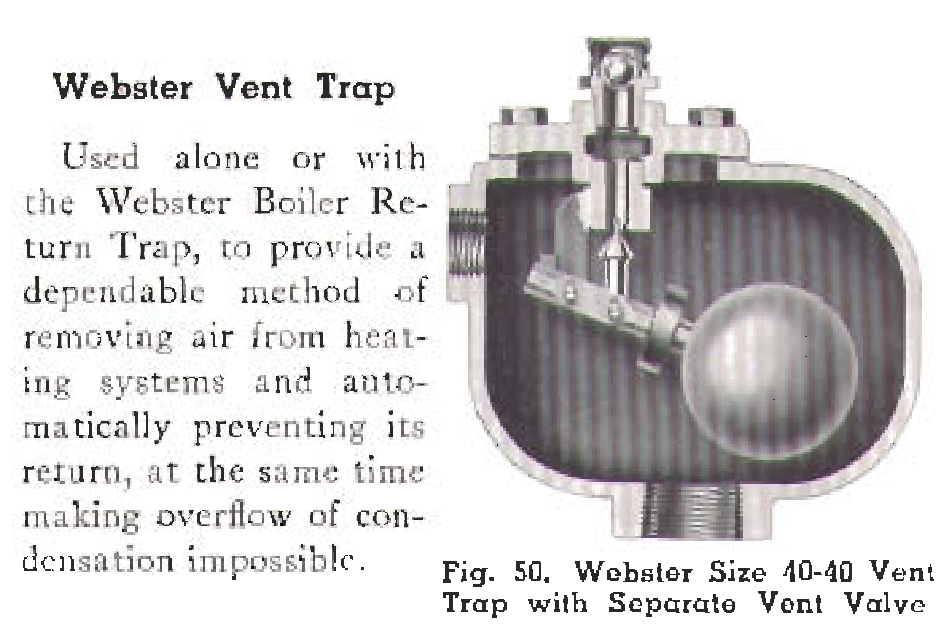

  • @Jamie Hall again I apologize for my incorrect use of terminology. I believe what I meant to title the post was “ vapor system” not vacuum. I now understand the advantages of it being a vacuum system when it was coal fired and that it’s not really needed any more. In my continued search for information on the Webster system and reading my LAOSH books that arrived tonight I stumbled across a couple different piping diagrams for the system and am starting to understand it a little bit more. But there a few things that still don’t make full sense and the lack of literature on the Webster system is making it even more difficult. I see on the diagram where it specifies “no pressure wet return.” But doesn’t show the rest of the system piping. Then I found a video on you tube that I was able to screenshot a different diagram from and it shows it coming from a “Webster drip trap.” In my particular case thee drip trap is apparently MIA. What exactly does this missing component do? And would there be any work around with out? It is located to the far left towards the top on the first picture.
    edited October 10
    The Drip Trap is there because the return from the end of the main where the trap is, runs through the Boiler Return Trap. With this "non-pressurized return" there is no leftover steam pressure downstream of the trap to help get the water back to the boiler (called the 'B' Dimension, because the returning water can stack up in the vertical drip line more without the leftover pressure), so the Return Trap takes care of that. This is the same situation as the returns from the radiators, which also have traps, and route their condensate through the dry return. In the diagram the water from the dry return comes down from the Vent Trap.
    Check your return line where it comes off the main. Follow it from that point to the boiler. If it bypasses the Return Trap, it's a "pressurized return" ('A' dimension) which does have leftover steam pressure in it, so a trap is not used.

    Terminology will l get you every time! That Webster drip trap is what we would usually regard as a crossover trap. Quickly what happens is that the trap allows air in the main to escape into the dry return, where it goes back to the vent at the boiler. But you don't want steam in the return, so when steam makes it to the end of the main, it closes. In the Webster system (but not in most other vapour systems) it also prevents steam pressure in the main from appearing in the drip and thus in the wet return. Not really needed — an ordinary crossover trap will do, so not to worry.— the workaround is to place a crossover trap at that location so the air can get into the dry return, and to keep the drip — which is just a fancy name for a pipe which drops to the wet return! — to allow the condensate in the main (note which way the main is pitched) to get to the wet return and hence back to the boiler. There are several ways this could be piped, depending on the piping arrangement near that location; if you could provide a photo of the end of the main and the dry return at that location I might be able to come up with an arrangement.
    Actually, @Jamie Hall , the drip trap in that diagram is a F&T (float and thermostatic) trap. You have to enlarge the image to see it. It's probably a #0026, which had an air line connection after the thermostatic element that was routed up to the dry return. So the returning water and air were split within the F&T trap rather than afterward, as we do with a more modern trap.

    Hopefully you can now see with that closed valve on top of the Vent Trap air can't leave the system, so steam can't get to the radiators properly. Correcting this issue may be the single most important thing you can do.
  • @109A_5 yes thank you I do see how that is supposed to be now!
