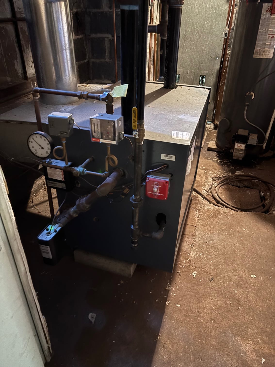

I help oversee the building maintenance at a non-profit school in Plainfield NJ. One of the buildings has a large 4,500 SF auditorium over a cafeteria that is heated by a steam boiler. Ultimately the upstairs and downstairs don't heat evenly, with the basement typically running 10 degrees warmer than the upstairs. This building is 100 years old and I'm sure changes have been made to the system over the years which changed it from the original design. While I am knowledgeable on smaller residential steam systems and how to tune them, this one is beyond my ability.
I am looking for a consultant who can take a look at the building and advise how we should go about improving or fixing the system. I'm aware of the Find a Contractor page but I wasn't sure if that was the best route to go just yet and also based on this being a larger complicated system than a residential one.

    Are any of the header pipes in the basement sagging?
    Any of the excellent names mentioned above for your steam heating consultation will help you with improving your steam heating system.
    You probably should wander around with an 8 foot bubble level before they come to check the radiators to see if they need to be shimmed at the far end to provide proper drainage of the condensate back to the boiler too.
    Do the same thing with the header pipes to check for a slope back to the boiler to allow the condensate to drain properly.
    You can purchase steel shims from Mcmaster Carr for this work.
