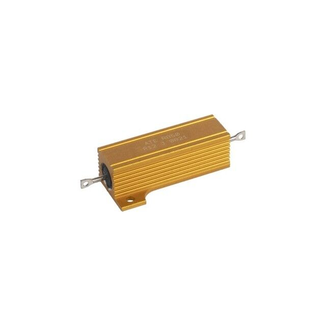

    As much as modifications makes folks heads explode. If the equipment is in good condition and the Hot Surface Igniter is the only issue. And if the OEM Hot Surface Igniter is becoming unobtainium or excessively costly. And you just have to make up about 0.5 Amps to make a more reasonable substitute work. I would simply add a power resistor to the circuit. The power resistor would be wired in parallel with the Hot Surface Igniter.
    Since you are only adding 0.5 Amps to the circuit (2.9 + 0.5 = 3.4) and the circuit needs 3.3-3.6A to open the Gas Valve I don't see any safety issue if the more reasonable substitute Hot Surface Igniter eventually fails. Since 0.5 Amps is not enough current to activate the Gas Valve.
    I would use a 240 Ohm 100 Watt resistor and the appropriate wiring. This type of resistor needs to be mounted to a heatsink. But since the duty cycle of a Hot Surface Igniter is pretty low, you may get away with minimal heatsinking. There are other resistor types that could be used. Even a 60 Watt incandescent lamp. However the resistor may last forever and lamps are getting harder to get.

    some oven controls operate the hsi igniter intermittently, others keep it energized as long as there is a call for heat.
    in fact, some googling shows that the oven control assumes the current from the hsi means there is a source of ignition and uses that to open the gas valve, it doesn't explicitly prove flame so modifying the igniter to produce more current seems like an unsafe idea. if the ignitor breaks, the resistor might be enough to keep the valve open because the hold current is usually a lot less than the pull in current.

    I was just going by the parameters offered. It is just an idea, not proof of concept.
    I would expect if a modification is done it should be thoroughly tested. If the Pull-in current versus Hold-in current is an issue there are other means to make it work. I try the simplest approach first.
