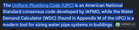

    hot_rod Posts: 28,699
    Try your load calc with the newest WDC
    https://iapmo.org/we-stand/water-demand-calculator
    I think your 7-8 gpm is high
    The sink is probably under 1 gpm, shower 1.5. With low water pressure those are high numbers. Faucets and fixture gpm is rated at 80 psi
    If you are running 30-50 gpm will be less

    @hot_rod - I do hope so. I'll definitely take a look and see what it says. Any idea if that tool lends itself to any particular credibility, that the inspector would allow it to override IRC on sizing?
    I believe the latest UPC and IPC have adopted the WDC. Since it was developed by IAMPO which controls the UPC codebook and updates.

    @hot_rod - that's excellent. I'll be getting to know it. I've got a MIXCAL 521616A on the indirect… am I reading the flow chart correctly that at, for example, @7GPM, I'm looking at 5psi loss?
