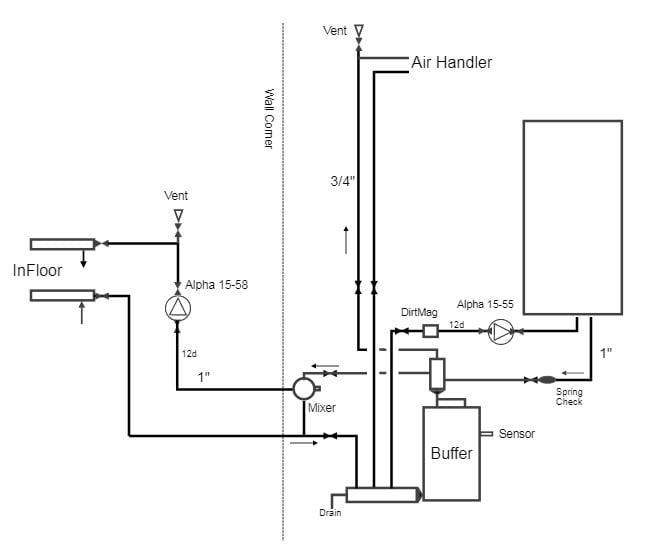

Two pipe buffer - Placement of Large Pipe ?

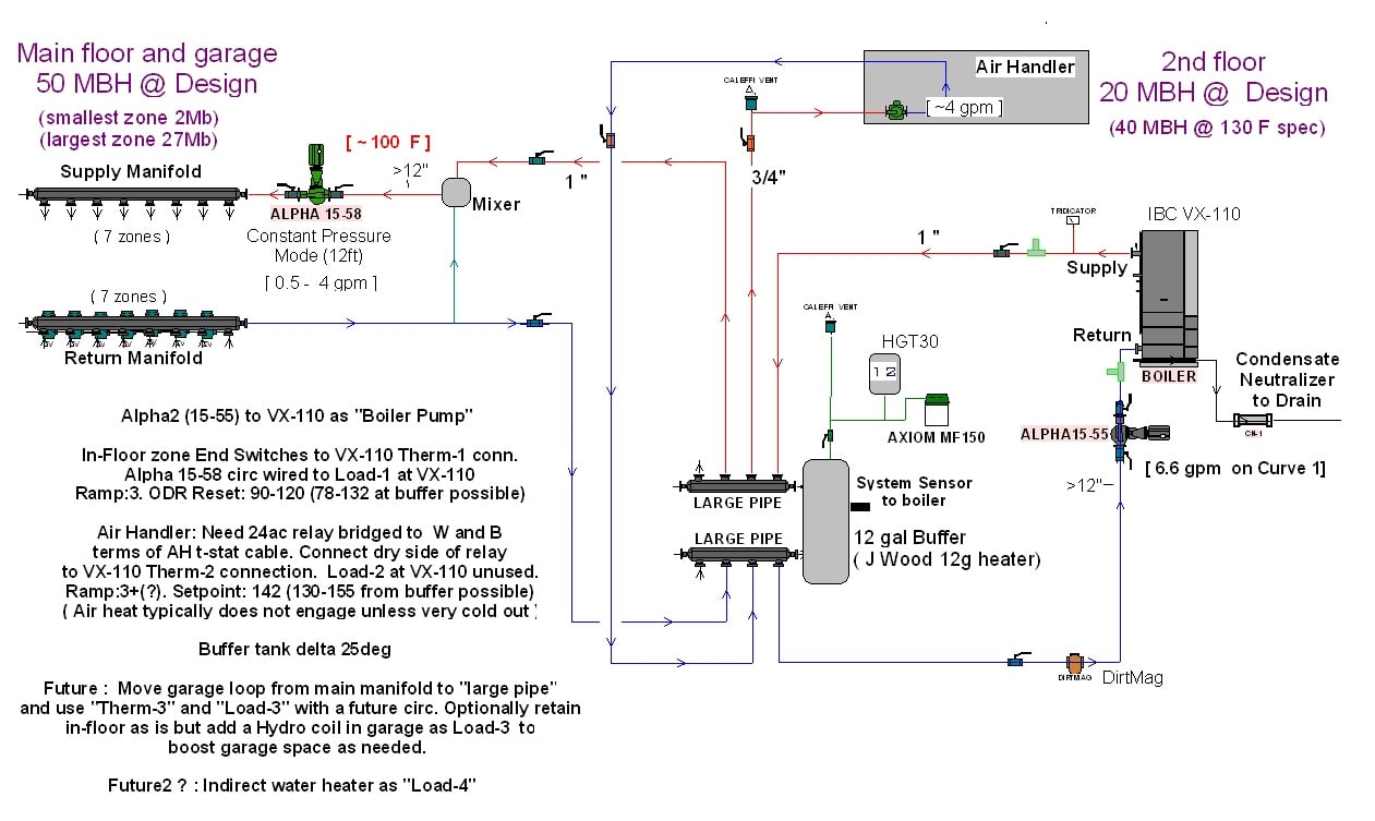

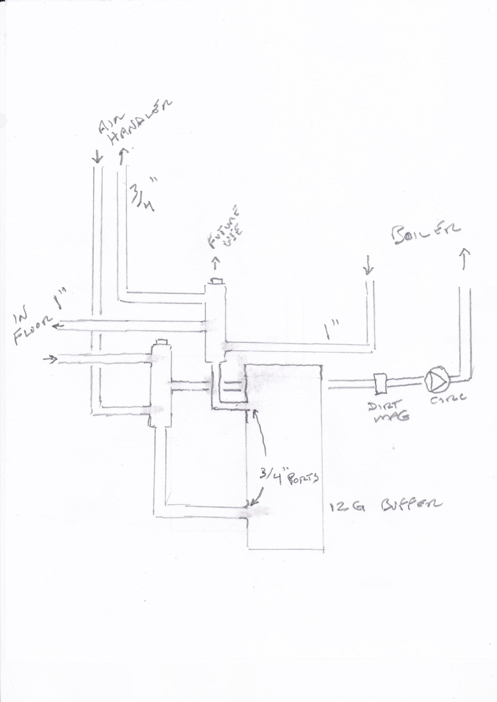

System schematics are one thing, placements and piping is another.
What are the drawbacks of placing the Large Pipes somewhere other than directly onto the buffer tank ports ?
I would prefer to mount my Large Pipes vertically and closer to the wall. This would reduce stress on the buffer tank ports as well as leave the piping a bit more open to future changes of buffer tank. Planning on using 1.5" tees for the Large Pipe.

    Well… in your sketch it appears that the "large pipes" are manifolds; they could — in principle — be placed anywhere. The idea is that they allow separating the flow from one pipe into many — or vice versa. In the more complete diagram (which I presume is the designed system) I see several problems with the overall arrangement, and I'm rather led to wonder if perhaps you have misunderstood the function of the "large pipes" in other systems, where they are not only manifolds, but hydraulic separators allowing the flow rates in the boiler loop to be decoupled from that in the heating loops although that will happen as the buffer tank is connected between the supplies and the returns.
    The expansion tank should be on the line from the return manifold to the boiler, as close to the pump on that return as is reasonable.

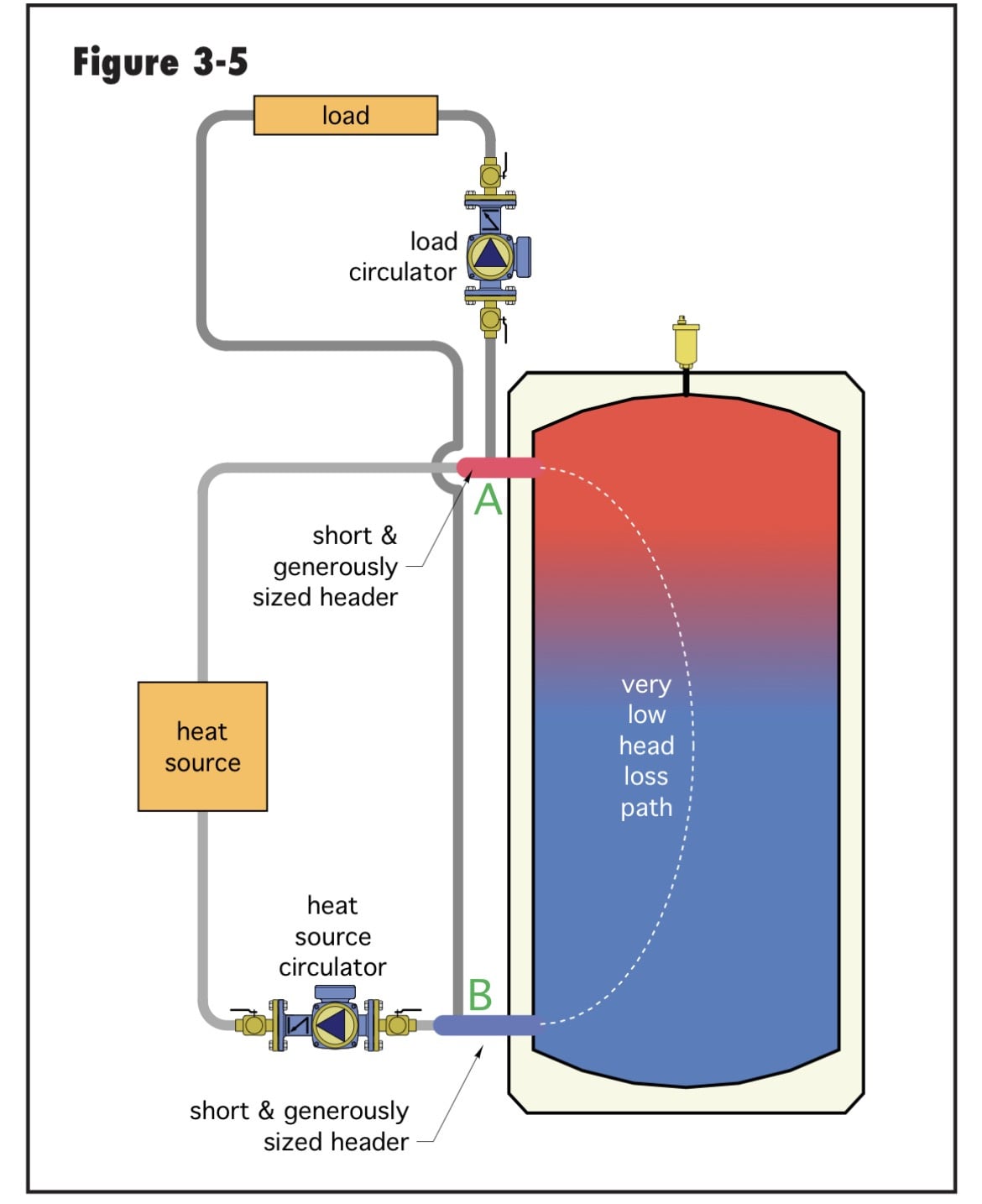

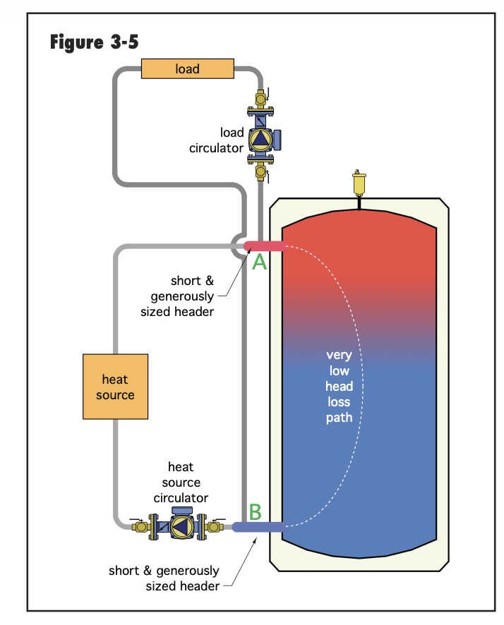

    Maybe a better definition of "generously sized header. The goal is very low flow velocity in that short large section of pipe. Ideally less than 2 fps. So that close to tank piping and the tank itself presents very little head loss.
    Screenshot 2026-10-04 at 12.42.50 PM.png Screenshot 2026-10-04 at 12.42.50 PM.png

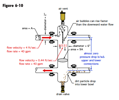

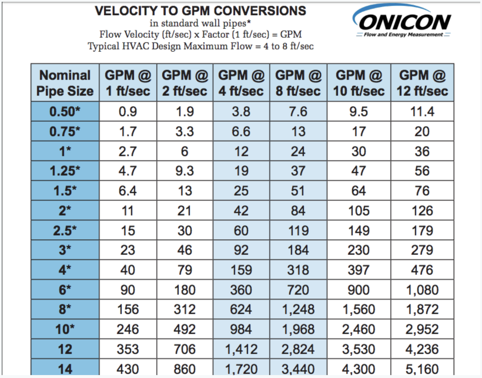

    So determine the total gpm at that point. Then look at the flow tables for pipe, or tube.
    Lets say you have a total of 8 gpm. You could flow up to 9.3 gpm in 1-1/4 pipe and stay in that 1- 2 fps window. No harm in going larger.
    Caleffi hydraulic seps are designed to keep the flow velocity in that chamber, "generously sized pipe" below 2 fps.
    This assures flows from various pumps and variously sized pumps do not interfere with flows.
  • @Jamie Hall I think I had originally thought to attach the expansion at the buffer as it is the point where all three circs are pumping away from. I can alter the plan to attach it and the Axiom fill box to the return line before the Dirtmag if that seems like a better location. The vent is probably best on top of the buffer, I think (reusing the top anode port).
    @hot_rod My boiler loop will flow 6-7 gpm and the load loop would be anywhere from 0.5 to 4 gpm. At 4 , the excess flow (unused boiler flow) would be 2-3 gpm. If only one zone was open at 0.5, the excess would be 5.5-6.5 gpm. Hopefully Im looking at this the right way ?
    So if I made the Generous Header with 1.5" tees and placed them on the back board across from the buffer ports, then stung out to the ports with <12" long 1" pipes, it might be close to workable ?

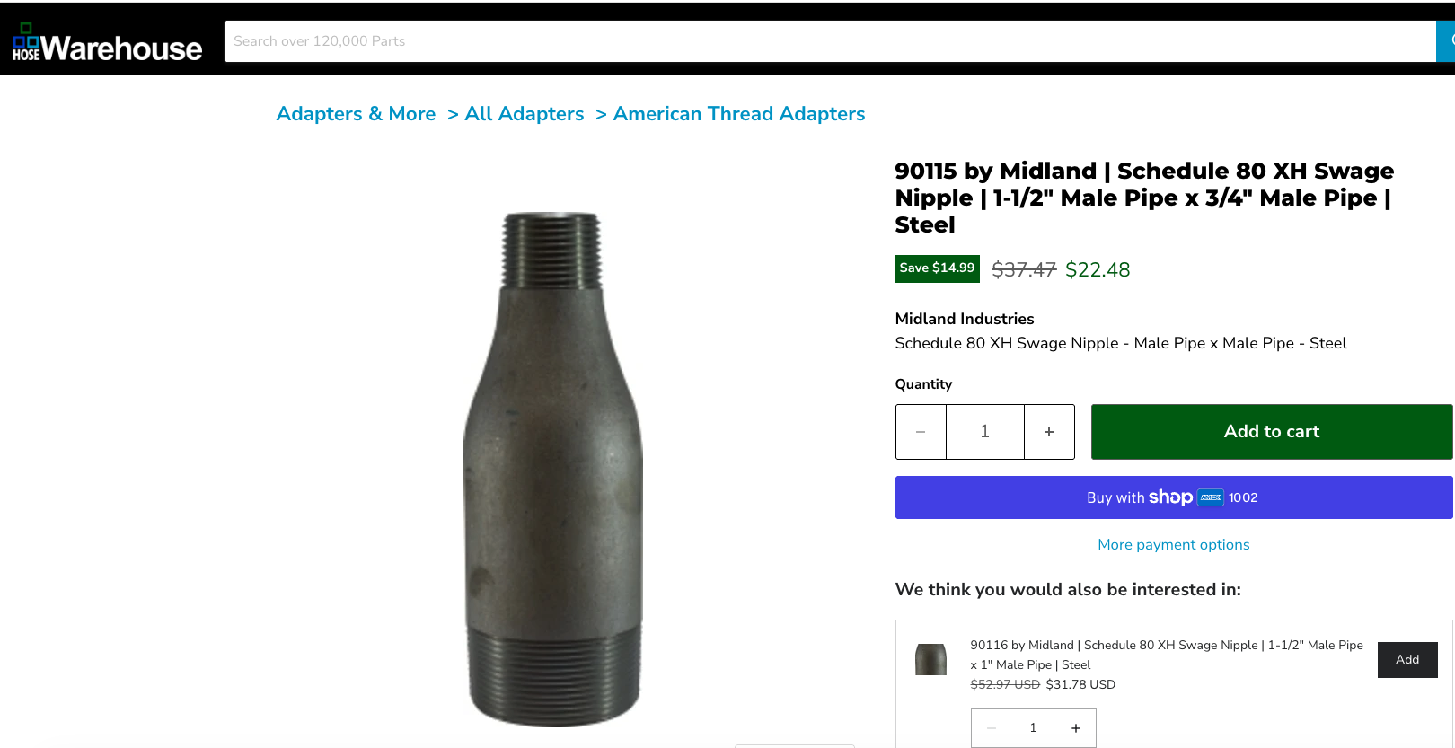

    Ideally a tank with a 1-1/4 or 1-1/2 ports.
    If not these swage nipples make a nice increaser. Screw the 1-1/2 tees right onto it, close nipples between them, it for a short, fat header.
    Connection for the HP, air handler, radiant, maybe a spare.
    Expansion tank could be on any of the 3 ports as the whole tank becomes the PONPC. On the upper header where the pumps locate works well.
    The tank can mount anywhere, just the connection needs to be at the manifold, pex to the tank location.

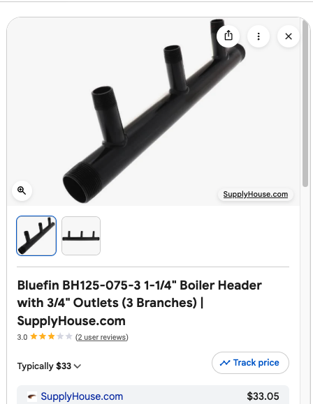

    I doubt you can build a header with tees and nipples for the price of a "speedy header"? They come in an assortment of sizes.

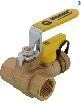

    Connect the header to the swage nipple on the return with this valve. It becomes a coupling and the purge/fill port for all zones

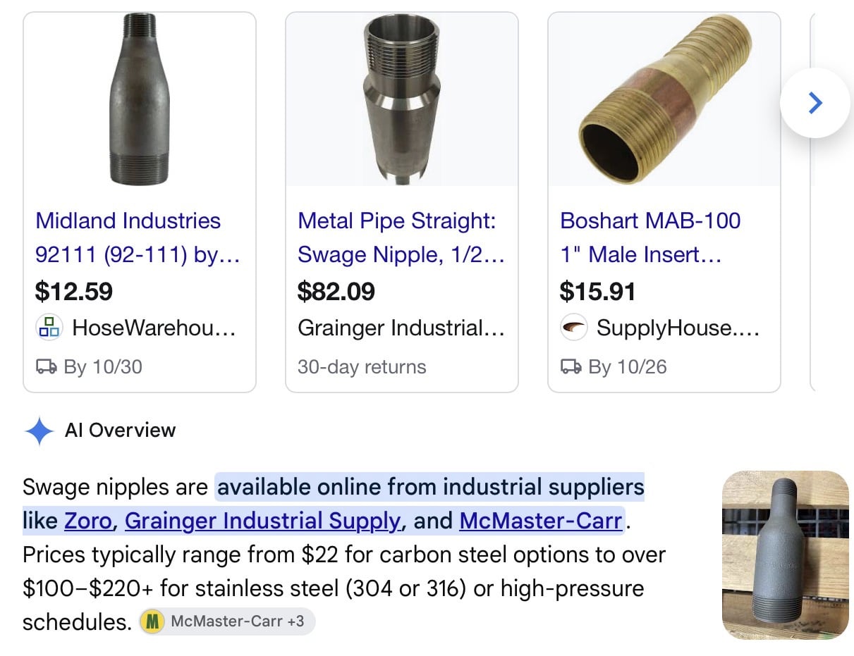

  • No luck on swage nipples around here. 1.5" tees and a coupler will have to do , but at least I'll hang it off the tank. I'll find a wall bracket to hold the weight of the Large pipes.
    Took the heater/buffer out of the box today. Lo and behold it has both top and side ports.

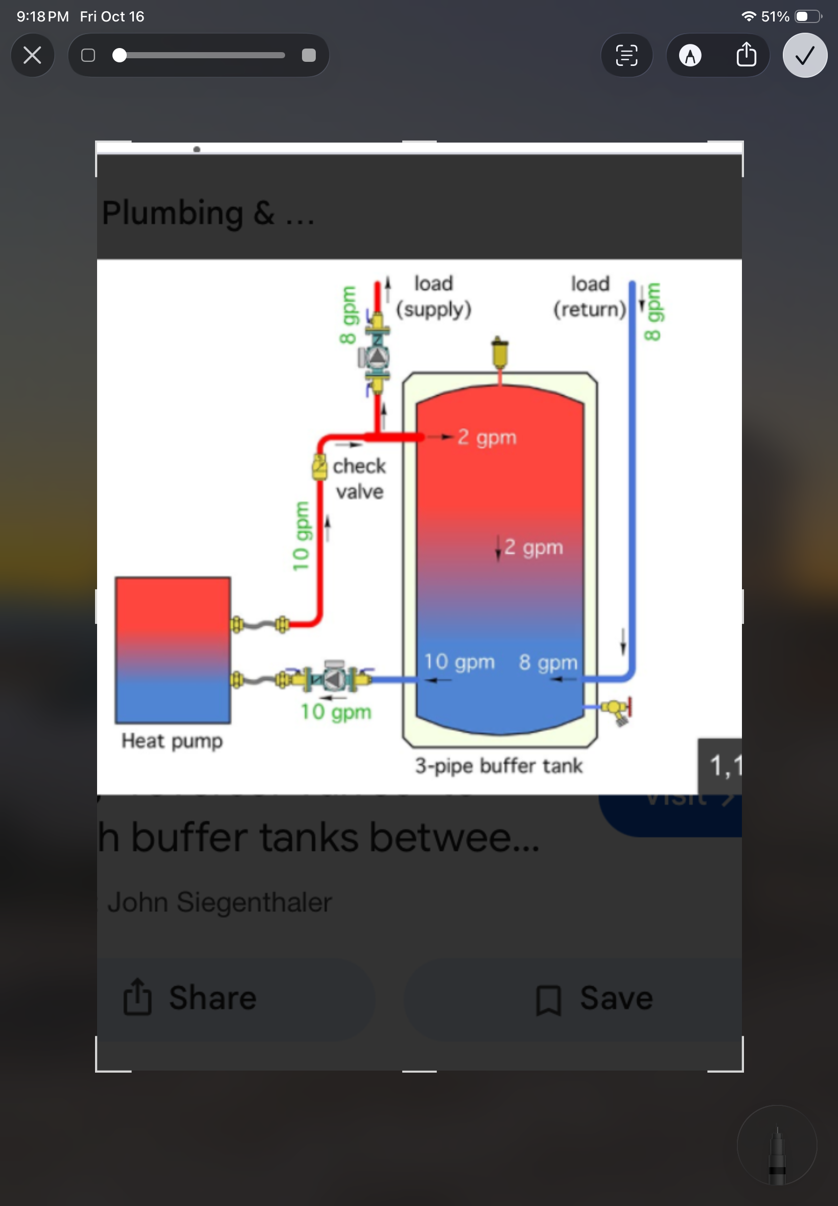

    I briefly thought of the "3 pipe" approach, but I think it might not work due to the 2ft long dip tube on that Cold top port.
    Also discovered that the T&P hole, where my buffer sensor is going, it at the same exterior level as the side Hot port. (the diagram showed it closer to halfway down the tank). On the upside, the side Hot port apparently has some bent tube internally to keep the pickup at the very top of the tank.
    So, the sensed setpoint is going to be physically higher in the tank. Is the solution to bump the setpoint T up a bit ?

    You just need 3 side connections for a 3 pipe arrangement. It doesn’t need to be on the top if the tank.

  • Ok, I'll stay with the 2-pipe method in the 2 side ports and forget about that extra top port.
    I might be able to tunnel a fiberglass rod down from the T&P skin opening, then work a sensor down in there. That will be my plan B - once it gets cold out, Im going to track data points with strap-on pipe sensors and the info from the boiler itself, while experimenting with different things. I could get a second sensor to push down there and compare the two temp readings concurrently (using an ohmmeter).
  • BTW, thx for posting that last graphic. I forgot to allow for a spring check on the supply line between boiler and buffer. The supply house I use should have them. I see some with a 0.5psi 'crack' rating which should be good.
    In Idronics 17 fig 4-1 , they show a buffer with a sensor close to the top/hot ports. I think they indicate that this makes the most of your heat as it doesnt restart the boiler until the outlet is about to run out of desired supply temp ? I plan on a 25deg delta, plus this boiler control can modulate on a target rise of degrees/hr, the mass of water / gpm / min modulation dependant of course. It measures the f/hr between input temp and buffer temp, I suspect.. although you can select both "water from" and "boiler from" sources in config. Gonna be learning about this machine for a while I bet.

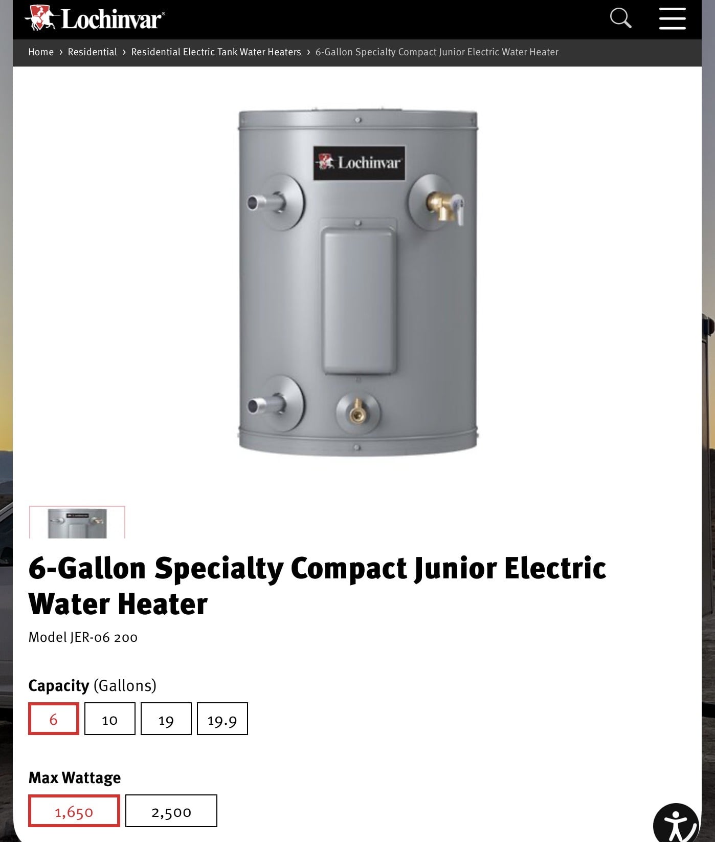

    here is the tank I have used, both 6 and 10;gallon.
    Other piping options are the drain and T&P port. Those will not have dip tubes.
    Anode rods are typically on top, that could be removed for a top 3/4 connection. Now you have a text book 3 pipe option😏

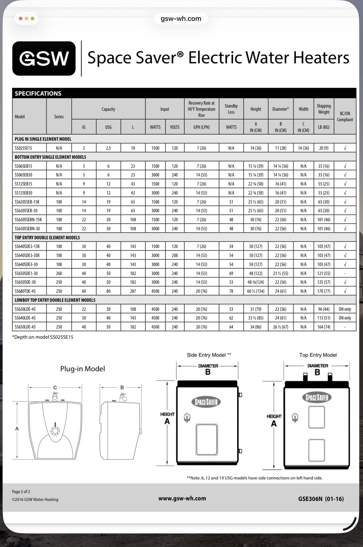

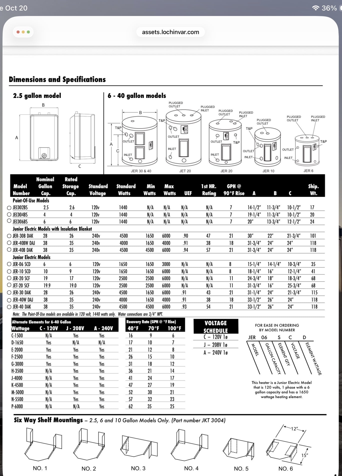

  • Its a GSW SS12SEB15.
    The element port is about 2" above the lower cold port.
    There is a drain maybe 2" below the cold port.

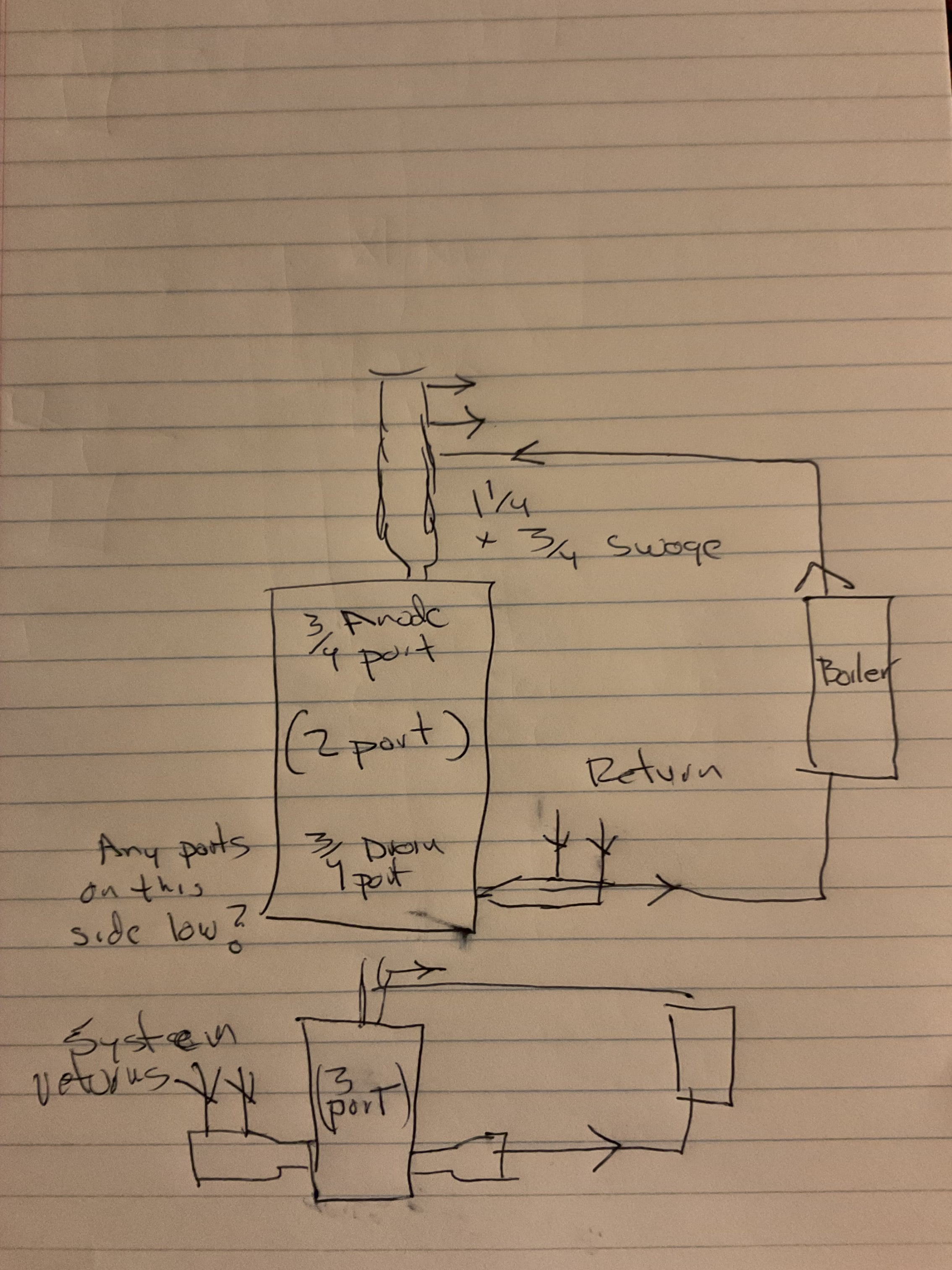

    Potentially a 3-port buffer if I utilize the lower side main port for my Load returns and the drain port as the return to the boiler. I could tee off a new drain port from that boiler return. I should pull the drain valve off to see if that's a 3/4" or 1/2" port.

    If you can exchange that tank, the dual element version would be a lot simpler. That gives you two 1" NPT ports at the right location, what I used for my DIY indirect tank.
    Otherwise I would connect to the drain and the T&P port. No dip tubes or thermosyphon valves to deal with.

    it looks like the model number that ends in 30,
    SS12EB30, is the 12 gallon dual element version. That would be a better option as @Kaos mentioned.
    Also I see a lot of options for 1x swage nipples online

    I measured things instead of eyeballing.
    Top of unit - 23"
    Upper main port - 16.75" with a curved "J" pipe that bends upward
    T&P - 16.75" (looks higher when looking down on it on the floor lol)
    Element - 7"
    Lower main port - 3.5" with a curved "J" pipe bent downward
    Drain - 3"
    So.. how about:
    Upper Main - out to loads
    T&P - to Boiler supply
    Element hole - Sensor well
    Lower Main - to Boiler return
    Drain - in from Loads (plus a drain point)
    I did kinda want to do a 2-pipe, but maybe a 4-pipe would help with my narrow buffer ports ?
  • Kaos
    Kaos Posts: 992
    4 port is worse in this case as you have push all your flow through the 3/4" ports and dip tubes on the tank.
    Stick with 2 port, this way only the difference between secondary and primary flow rate has to go through the tank. Generally, if a couple of zones are calling, this won't be much, so it port size won't matter much.
    I would still go with the T&P and drain port with an adapter to bring it up to size as quickly as possible. This avoids the extra restriction of those dip tubes.
    Also find a spot for an auto air vent on the top, maybe the anode port. It will make getting the air out of the system much easier.
    hot_rod Posts: 28,558
    if you have a good airpurger in the piping, use the anode port for one connection.
    If you have 2 ports at the bottom you can do a 3 pipe.
    Here is a 2 and 3.

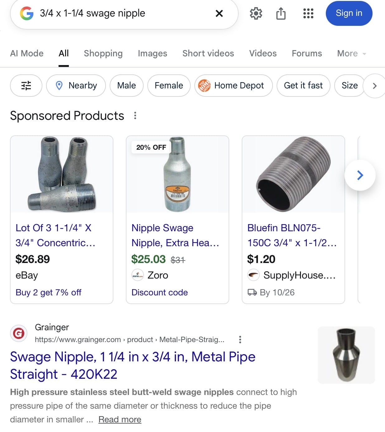

    Do you have access to e bay, Amazon, Grainger, Amazon? Find 3/4 x 1-1/5 swage nipple. It is a nice flow friendly transition fitting

    The T&P and Drain ports stick out at different angles. To use them as a 2-port, it would be super ugly. I would have to bring the pipes way out away from the wall, or the tank further away from wall, or have both ports sticking out the wrong side (gas line, neutralizer and drain on this side, plus my 60gal water heater is right there).
    Back to square one.. At most, I would have just over 5gpm flowing thru those pex lined 3/4" H/C ports. Would the restriction in the ports "J" tubes be enough to f-up the separation of pri/sec ?
    I was going to use 1.5" tees and nipples with a 1.5 x 3/4 coupler on the ports.
    When I struck out locally sourcing those swage nipples, and considering we're already hitting freezing mark here at night, I just switched to couplers plan. Had I ordered swage on amazon or such at the time, they'd probably be here by now. Regrets..

    the hydraulic separation is in the large pipe you are building, the tank is just a container.
    When you reduce you will get a velocity increase through the smaller opening. At the flows you are talking it will not be an issue. But I rather not go through a section of 1/2 which is what those dip tube I’d may be.

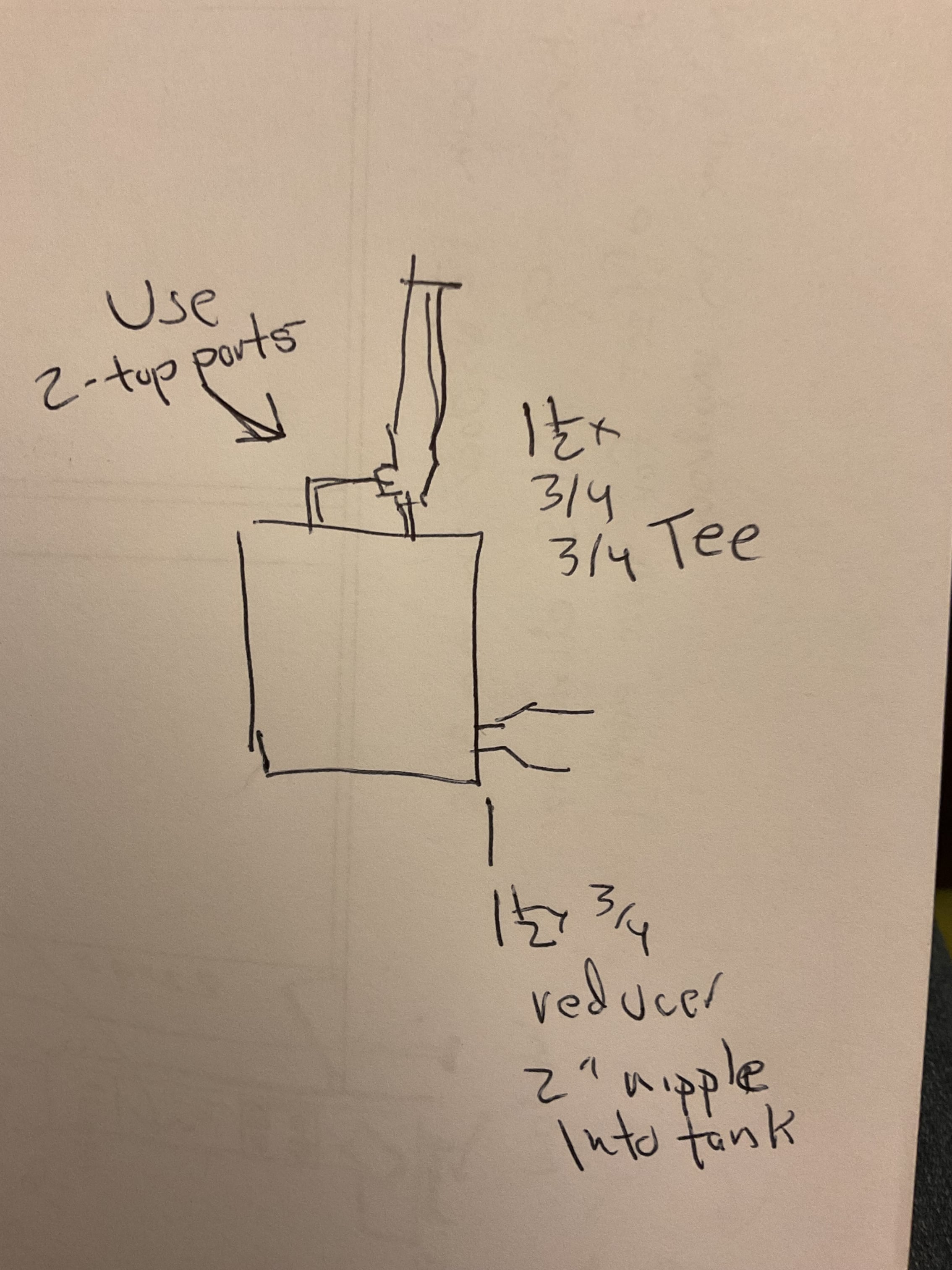

    on one install I connected the 2- 3/4 top ports together. This spreads the flow into the tank, lessens the velocity effect. 1-1/2 x 3/4 x 3/4 tee,
    use reducing couplings instead of bushings on the other port for a smoother flow.

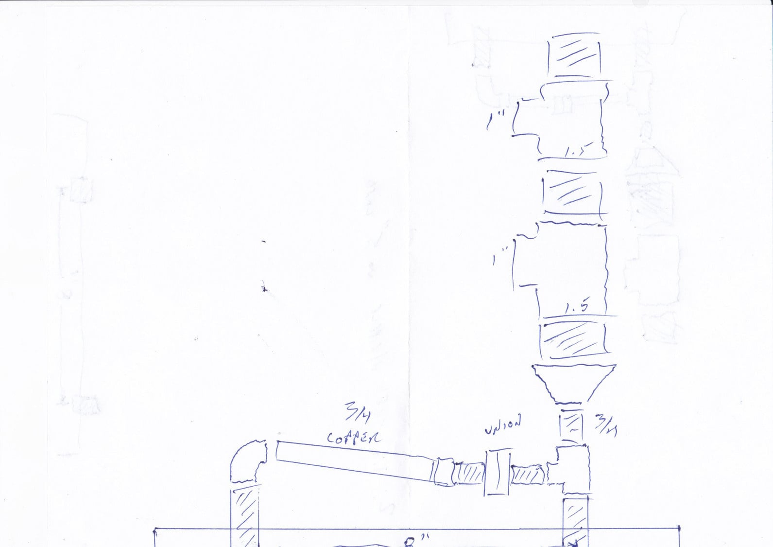

    I like the idea of the bridge pipe across the 2 top ports, but how would that get assembled ?
    Seems like a union might be involved ? My top ports are 8" apart.
    Something like this ?
    I messed up my sketch, but would the side port of a 3/4" tee be parallel with an elbow on the other port ?
    Also, I can mix and match materials black/copper/brass except for the bits that need to be soldered to the copper of course (they would have to be copper or brass) ?
    Edit : Or I suppose I could sweat that whole lower assembly. (no union)
    If you use the top connections you need to remove the nipples that are in the tank, they most likely have checks in them.
    Then sweat 3/4 copper to male adapters on some tube, screw it into the tank and build up from there. No need for unions if you work with sweat or press copper.
    Copper into the tank is fine on a hydronic system, no need for brass or dielectric unions.
    If you are using threaded nippled, yes you will need a union.

    I have a converted water heater for my buffer tank and hooking the top 3/4" ports together is where pex really shines. Use 3/4"mip x 1"pex adapters and use 1" oxygen barrier pex from there on. You can get the anode port hooked in to the "header" with little added extra work. I'll admit, you're not going to flow enough for a big boiler but my smallish mod-con with in-floor radiant works fine with no flow noise.

    I have the copper/brass/black parts now, but the pex thing has me wondering.
    Does all the flow into the buffer from a 'fat header' have to flow out the same point of the header ? Could you do one end plus say half way up the header , both going into the buffer ? (or out of the buffer depending on what phase of cycle is happening).
    Perhaps there would be too much turbulence when the boiler and load circs are both running.
    short, fat header. You want connections close to one another, the fat header close to the tank
    In a perfect world this might be a round ball. Little to no flow resistance between any connections
    You would need to be far off from the best practices for it not to work at all, however
    Check valves are your secondary protection against unwanted flow. I think most any circ you buy today has checks in it or in the box with it
    While they are in the worse possible location, the turbulent discharge of the pump, they maybe do more good than harm
