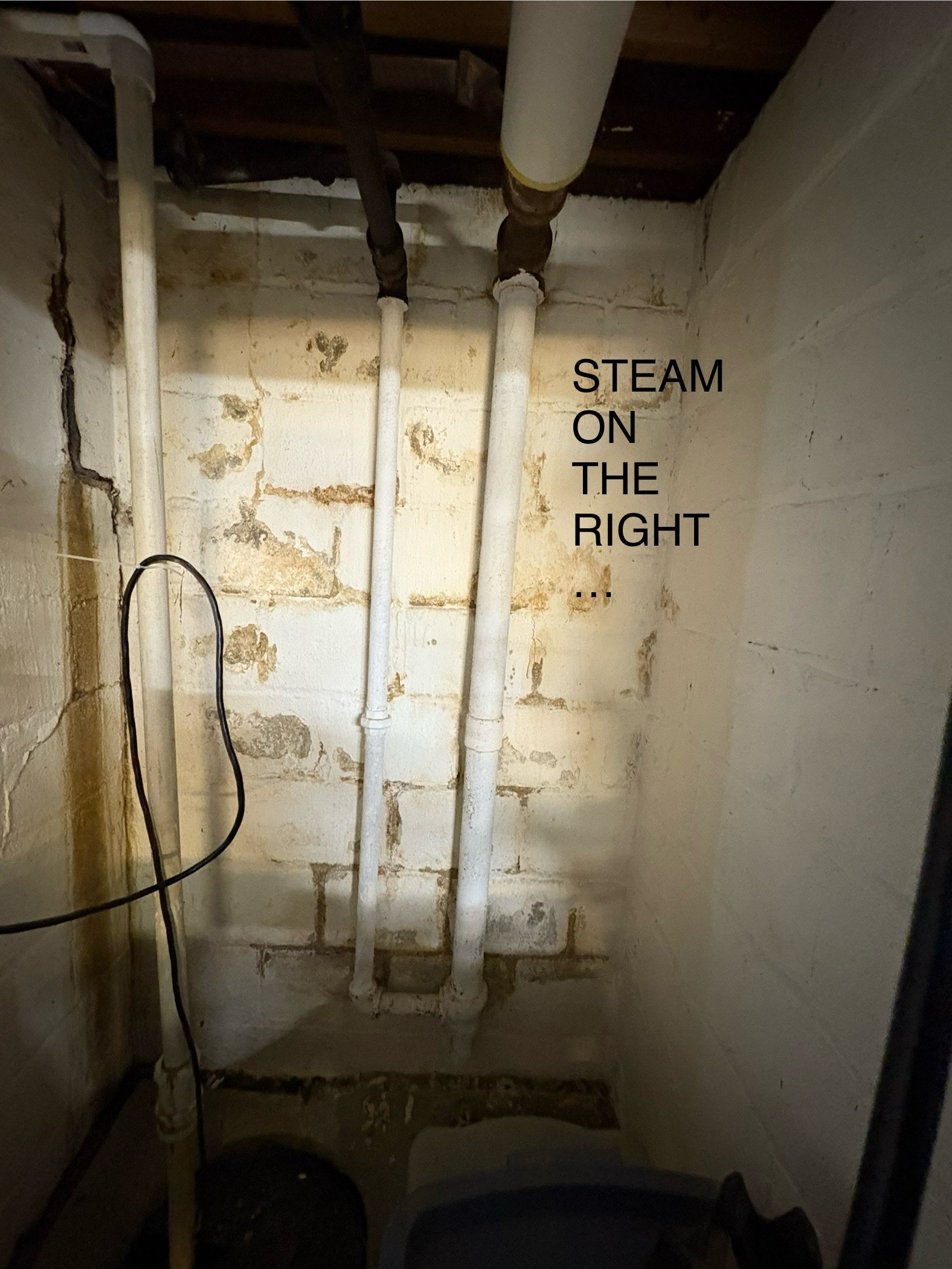

How hard is it to tap that 90 at the end of the steam main in that pic with a vent…what size vent?
@simon_skove length and diameter of the main decides the size of the vent. look around for a tapping first. You can tap the elbow 1/4" I wouldn't go larger than that to drill and tap.
Other options are:
1. to take the elbow off and put a tee in its place. There is a union in the drop pipe to help with this.
2. Or tap the tee that feeds the last radiator on the main
3. Take the radiator valve off the last rad fed from the main and put a tee where the valve is with a vent on it
Drilling and tapping the tee that feeds the last rad is probably the easiest if you can get a large enough vent on it.

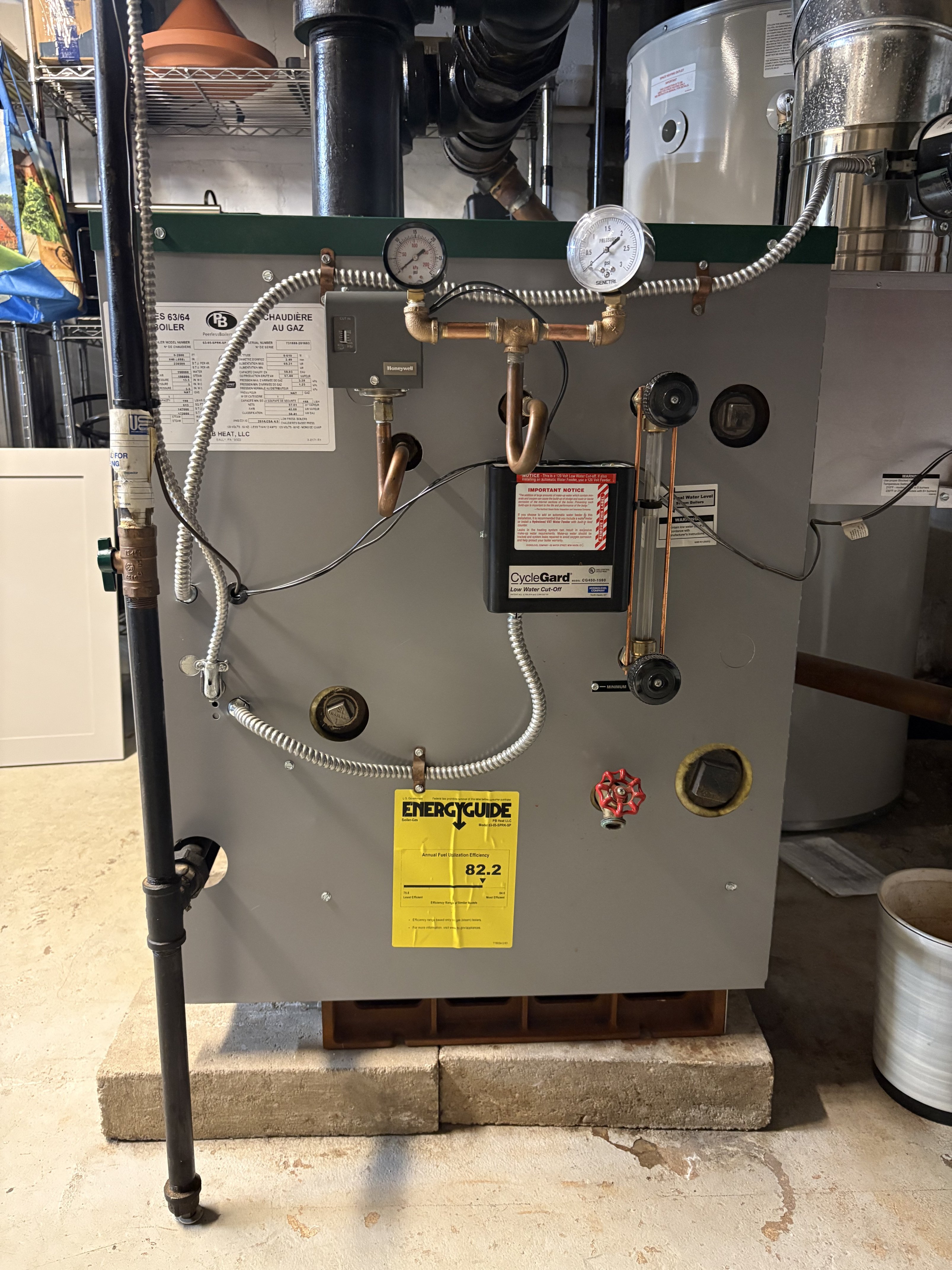

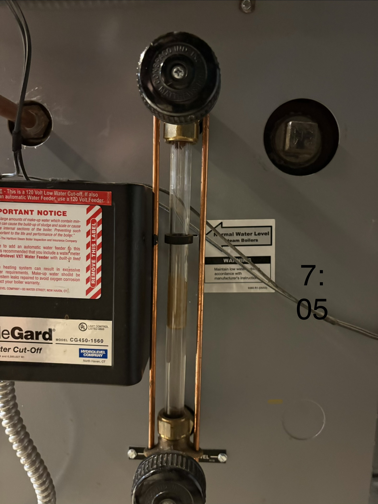

ok….no new vents on the steam mains yet….life got in the way. However, freshly skimmed and new pig tail protected gauges (0-3 and 0-30) put the t-stat up 5 degrees so as to not have it satisfied too quickly. After making steam for 25 minutes, did a walk around and had good heat all the way across all but one radiator on the second floor (pretty sure I have a valve issue here) including great results all the way on the third floor for the how three. My question is, the 0-3 gauge never moved. Not at all. In theory should the two huge vents back at the boiler on dry returns eventually close to create some pressure and have the pressuretrol cut off the boiler due to pressure even though the t-stat is not yet satisfied? Water in site glass went down. See photo, it started the cycle at the black band.
third floor has three radiators
That the gauge never moved isn't necessarily a problem. Might check and make sure the pigtail is clear, but if the boiler is well matched to the radiation you will have to wait until all the radiators which can heat at all are hot all the way across. Then the gauge may start to rise. Patience…
If all your traps are working properly those vents on the returns will never ever close. You have to have them in case of a bad trap or something, but otherwise… they will just sit there looking decorative.
the pressure rising means the boiler is making more steam than the system can consume. ideally that won't happen.
vapor system gents with those long deep pipes connecting the steam main to the dry condensate. No traps on the individual radiators.
Still if there are orifices in the radiator returns the steam may never get to the vents in normal circumstances. If your house heats just fine with only a pressure of only a few inches of water column, all the better, don't wish for excessive pressure.

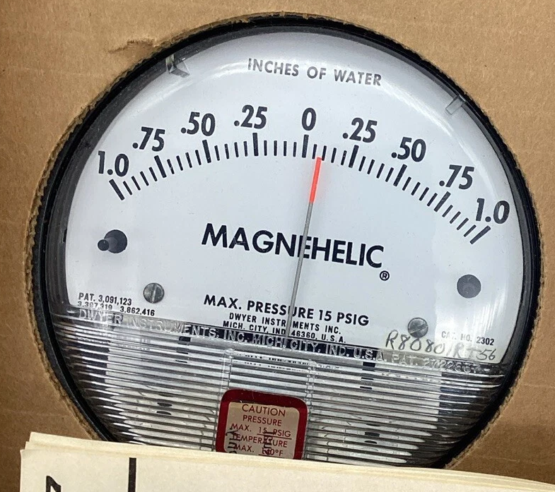

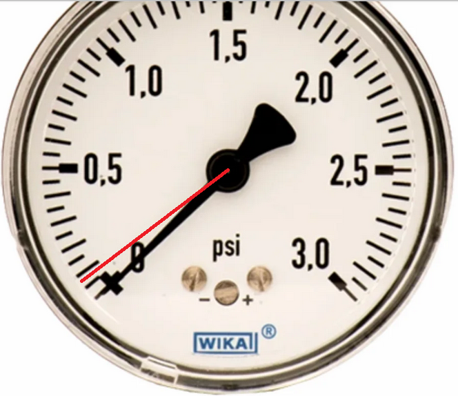

You have to discover what is normal for your system. My system never goes over 2 Inches of water column so with a 0-3 PSI gauge it would never go past the red line I added to the gauge image.
I use a gauge similar to this below to see anything meaningful on my boiler, I have multiple gauges with different scales. Note the scale is in 'Inches of Water' not PSI.
So 1 PSIG = 27.68 inches of water column or 1 inch of water column = 0.036 PSIG.
