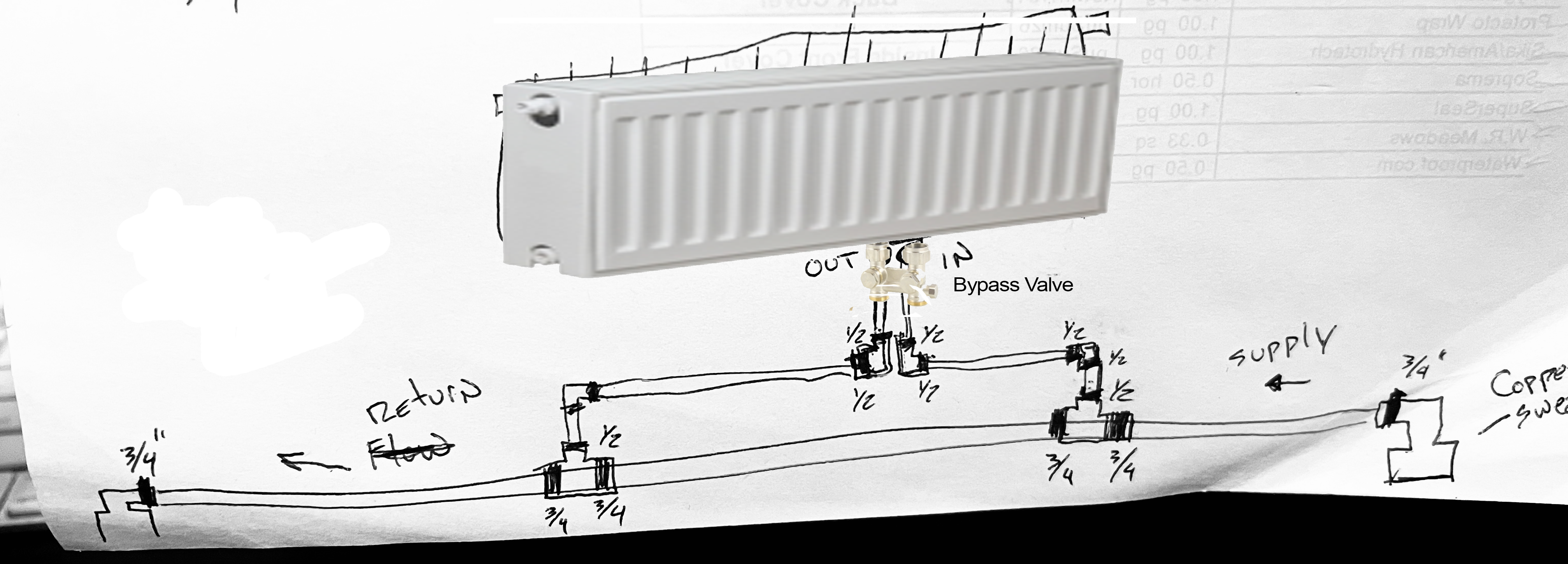

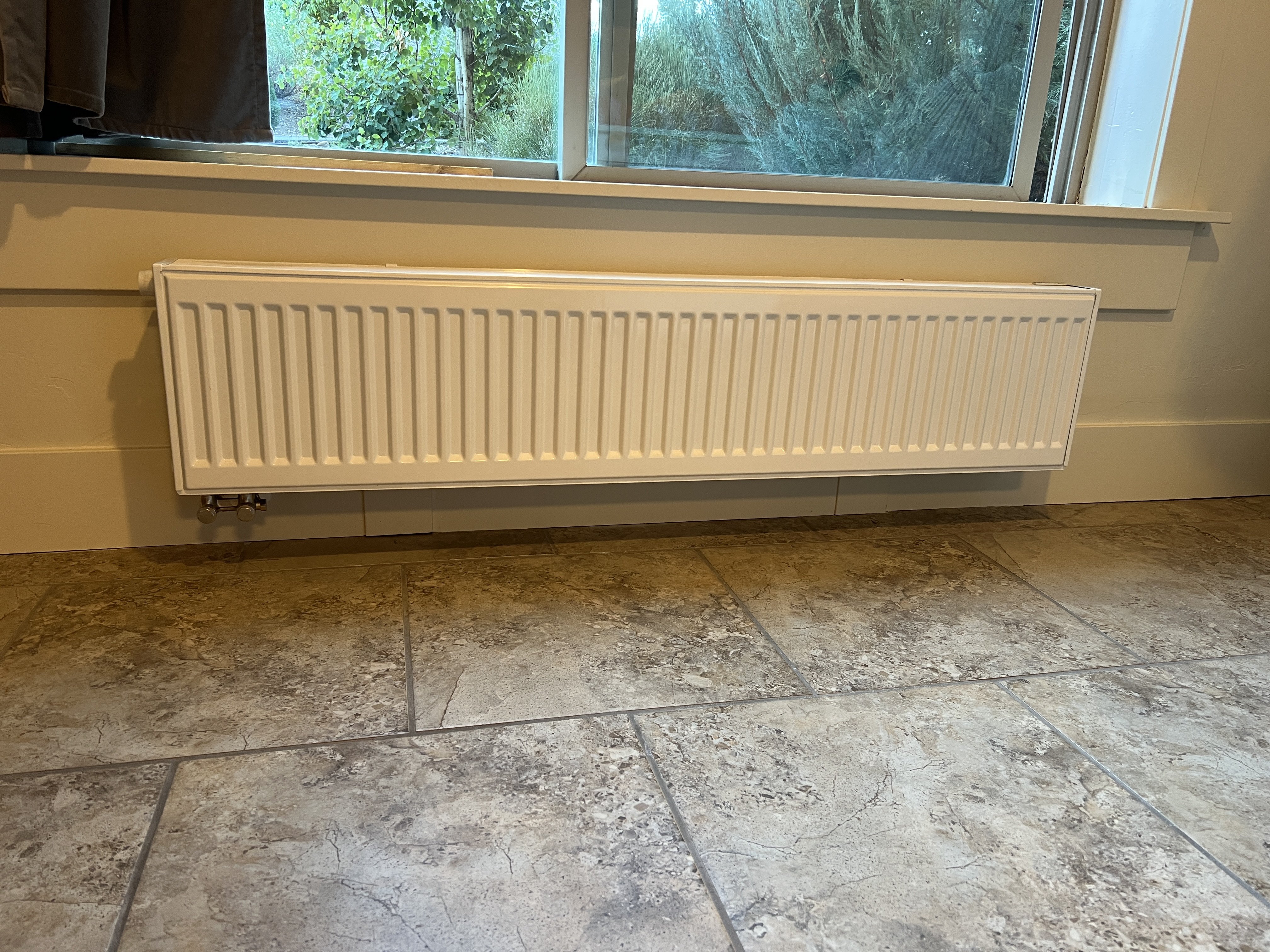

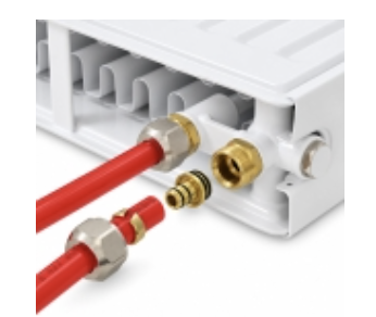

Last fall I converted 3 old metal finned baseboard heaters in my basement to the (pex universe.com) beacon-morris type panel radiators that have a the two 3/4" inlet and outlet on the bottom. (spaced 2" apart)
My main circulating line is 3/4" copper, so I just branched off of it using 2 standard 3/4 x 3/4 x 1/2" tees (not monoflow) spacing them roughly the same width of the radiators and then sending the 1/2" lines out of the wall 2" apart to go into the Isolator/By-pass H-valve on the bottom of the rad.
They seemed to work fine and heat up nicely after I fiddled with the flow screw in the bypass valve (If I remember right I think i may have nearly had to shut it off completely, like barely a 1/2 turn open) …
So did I just get lucky and created enough pressure drop by spacing the standard tees or do I still need to use monoflows on the tee returning back into the main 3/4" line? (I thought the bypass took the place of the monoflow??!!) I see the diagrams for a standard single run line system but I'd like to replace several of the finned baseboards. and it seems to make perfect sense to branch off of the main 3/4" to run through each rad and let the bulk of the hot water keep flowing on the the other rads down the line…

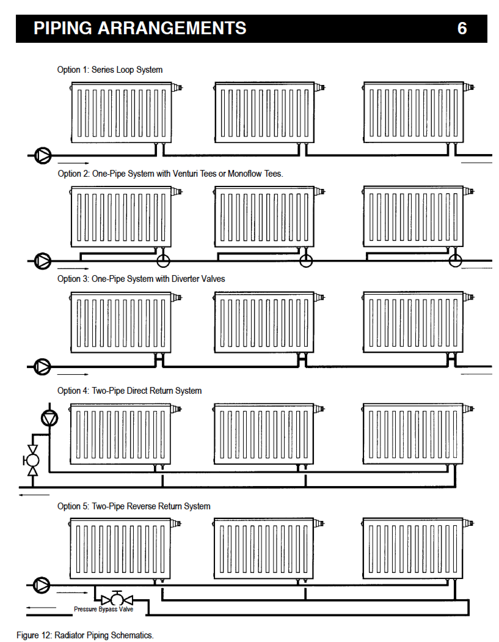

    mattmia2 Posts: 18,428
    edited October 2
    the monoflo tees divide the flow between the main and the emitter. 2 plain tees with a valve to throttle the flow in the main will do the same thing.
    a boiler replacement may have changed the circulator or zone valves or other things so that the monoflo loop no longer has enough flow. if there is not enough flow in a monoflo loop the water will mostly only follow the main and won't divide to the branches to the emitters.
    typically it takes more flow to make the monoflo work properly than it takes just to move the heat load of the zone so people not familiar with monoflo usually don't give it enough flow

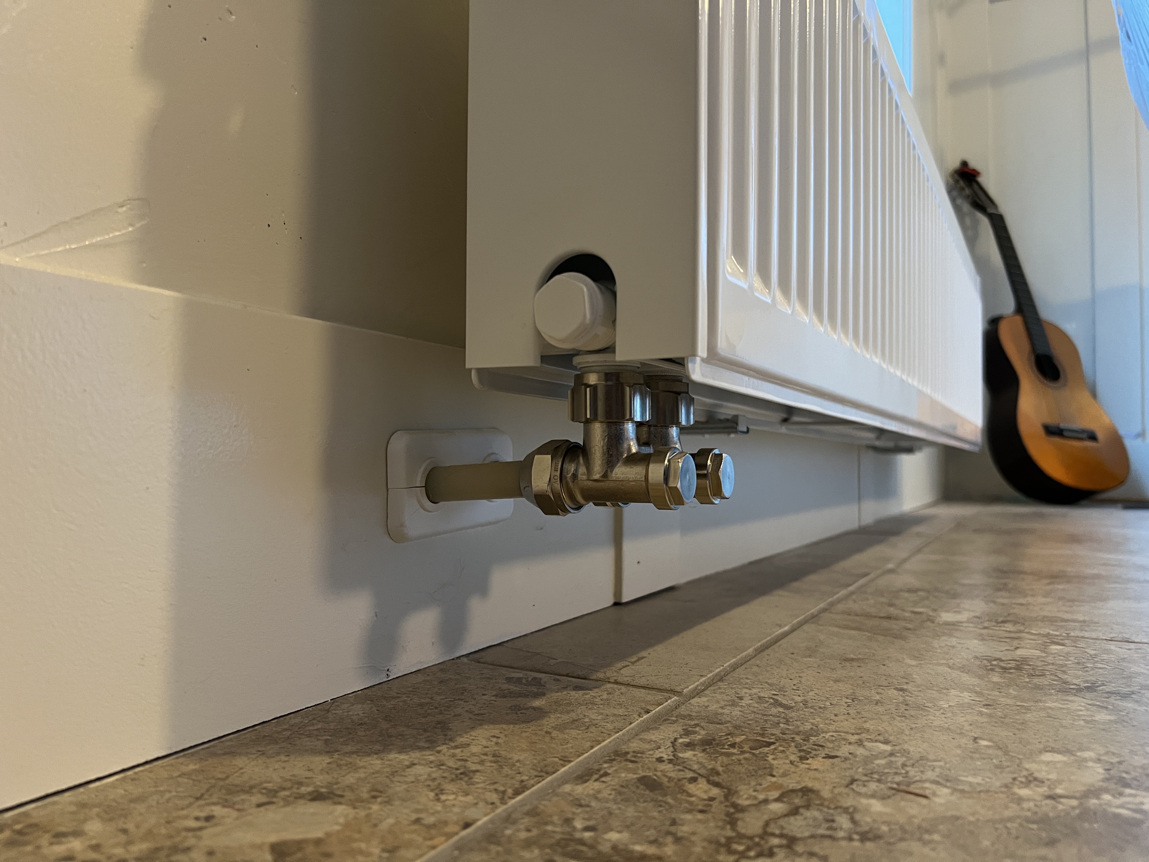

    I am trying to understand some things you are saying: "Last fall I converted 3 old metal finned baseboard heaters in my basement to the (pex universe.com) beacon-morris type panel radiators that have a 2" inlet and outlet on the bottom."
    Do the radiators have a 2" opening? The specifications for that radiator do not support this statement. It appears that the bottom openings are on the side of the panel radiators and they look like 3/4".
    There is also a bottom connection that is designed for that bypass valve arrangement you indicated. Those openings are not even close to 2".
    Can you betteer explain what exactly is 2" in your system or radiator

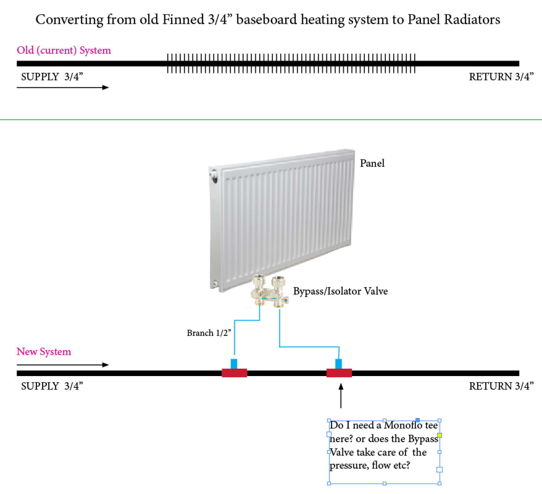

    Next, you explain that you have a one-pipe system. That usually indicates that there is one main pipe for the system, or for each zone, that starts at the boiler supply and ends at the boiler return. Each radiator, baseboard, convector, or other heat emitter has a standard tee from the main pipe to the supply side of the heat emitter, and the return side of the emitter is connected back to that same pipe using a MonoFlo® tee or another brand of diverter tee.
    Then you describe that you are connecting your new panel radiators without a diverter tee and show a drawing of a piping design that is limited in scope. It shows only the PEX connections to something that looks like a supply and return, which could be a larger-diameter pipe, but it does not show how that piping is connected to the boiler. That makes it a little difficult to understand the complete system.
    A picture taken from farther back would be helpful. It is a little like a DIY auto-repair post that shows only a close-up of one part and does not show enough of the surrounding system to tell the whole story.

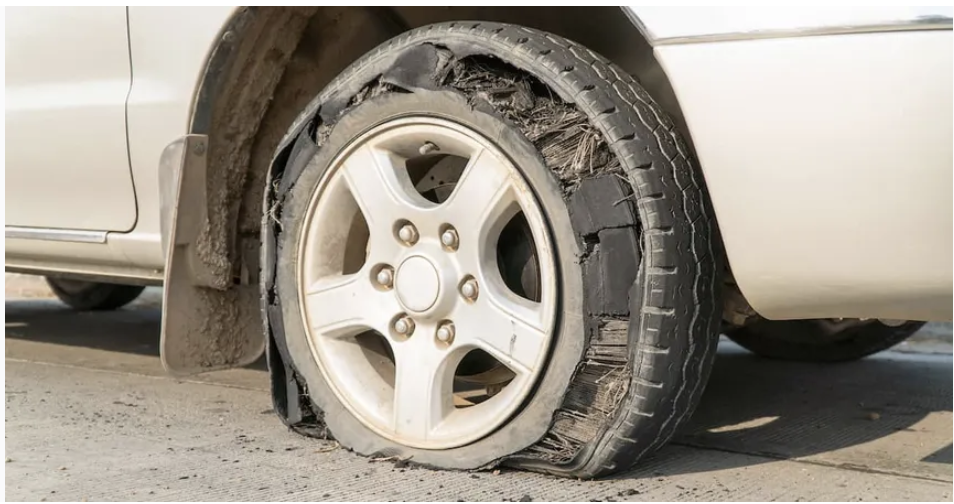

    This reminds me of the post about the DIY auto repair where the person wanted to know why his tire was not getting full of air. "I have been putting air in this valve for over 30 minutes and my tire just won't fill up with air. can someone tell me what I'm doing wrong? "
    Several different posts about what the pressure is the compressor set? Are you using a Bicycle hand pump? Is the compressor plugged in? and a lot of other helpful comments.

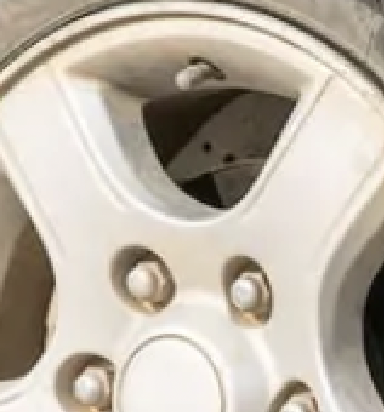

    Then someone asked the DIY to take the picture of the car from farther back.
    This tells a different story.

    Haha… I like the tire comment! Yea I'm not a HVAC guy by any means so I need to do better on my terminology. I'll try to answer your questions the best I can. By 2" What I meant is the the connection point on the radiator is the two 3/4" inlet/outlets on the bottom like your picture that are 2" apart. What I was trying to point out is that most radiator installs I see (albeit older ones) seem to typically have the inlet on one side of the rad and out on the other. (not using the bypass valve)

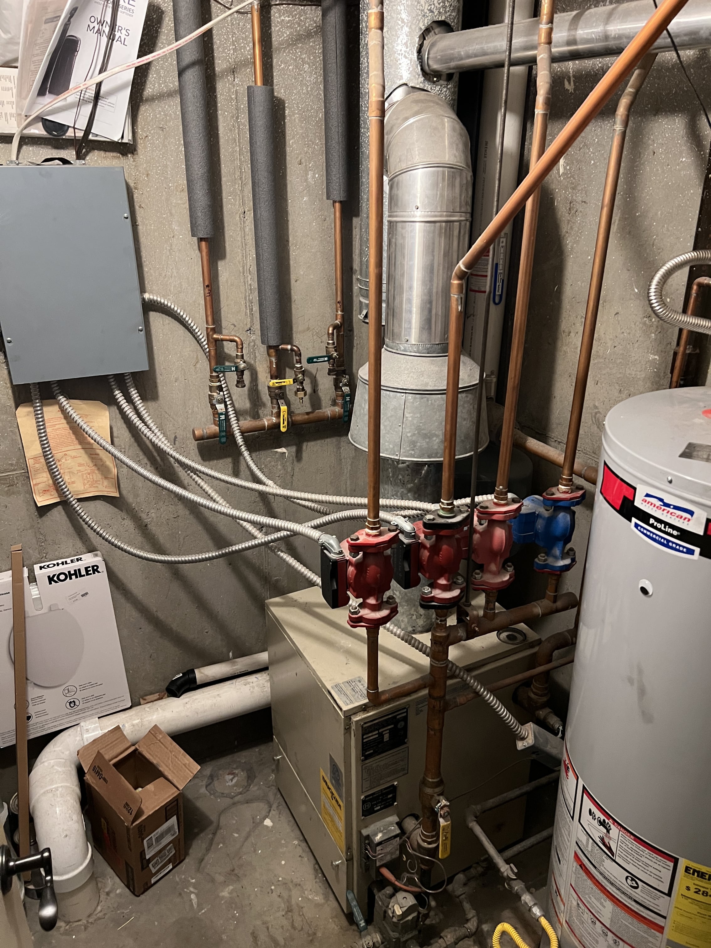

    What i'm trying to accomplish: My entire home is heated with a boiler that circulates through all the old finned 3/4" copper baseboard heaters. I'm pretty sure none of them branch and it's all just a straight loop back to the boiler. So what I'm trying to do is replace some of the old baseboard heaters with the modern panel style radiators but cant seem to figure out the best way to ensure that each rad gets enough flow and heat. So far the only two options I can come up with are 1. The way I just did 3 of them by simply using regular tees and spaced about the width of the rads and into the bypass valve attached to the heater…(seemed to work) OR should I be doing it the same way (teeing off the 3/4' line to 1/2" and straight into the bottom of the rad (NO BYPASS VALVE) and use one monoflow on the return line? Now keep in mind that i'm not needing to do BTU calculations and size everything properly. Just trying to get a little more heat outta the system and get rid of the lousy metal baseboard heaters. Hope that helps? I'll include a couple of photos of one I already installed and my boiler set up.

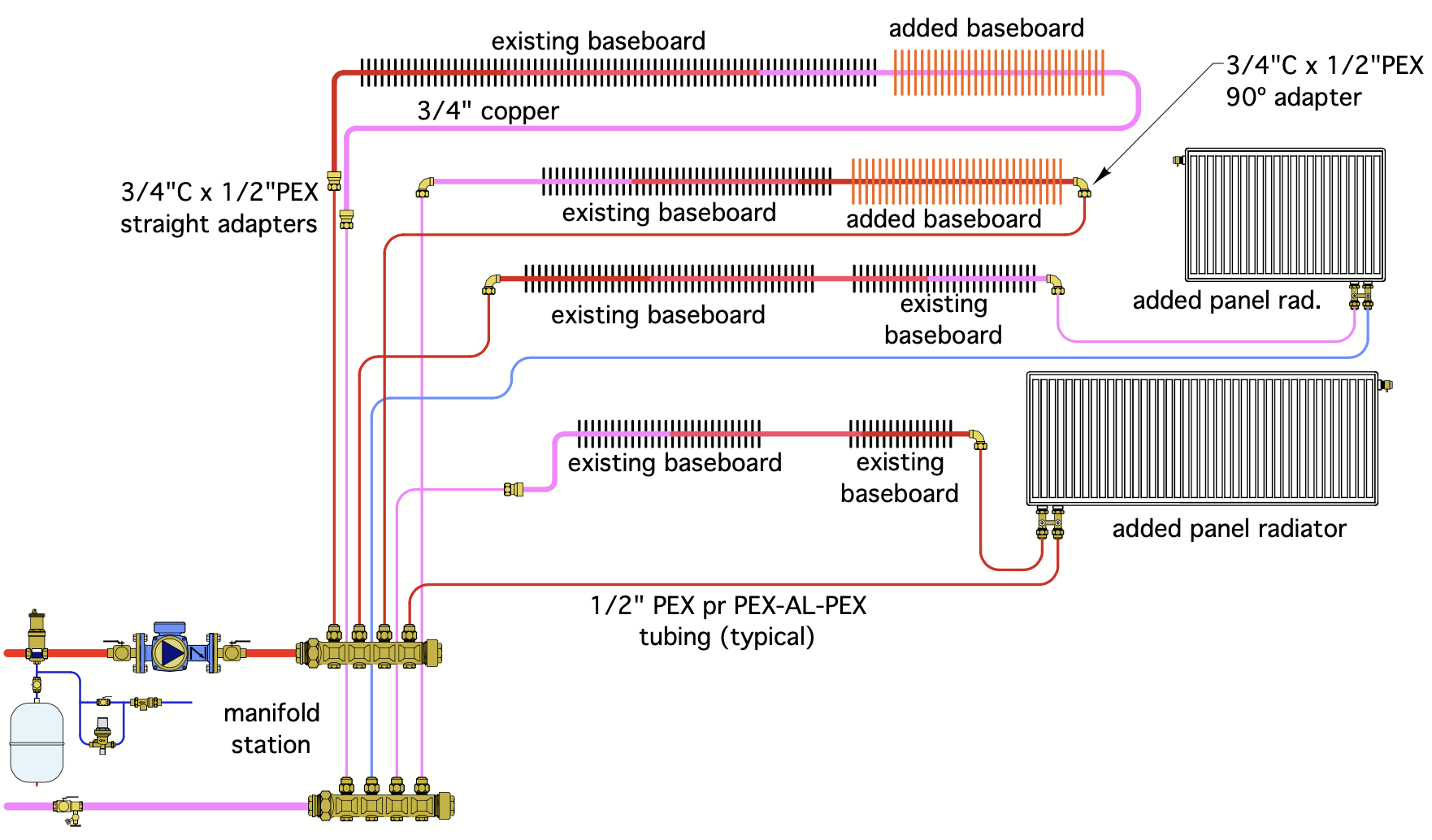

    hot_rod Posts: 28,766
    If the H valve has an adjustable bypass pipe them like shown here. A diverter tee pipes a bit differently..
    What is the output of the radiator at 180? The 3/4 copper may not feed a series of those radiators. Figure 4 gpm at 20∆ is 40,000 btu/hr.
    Ideally you wouild want to kow how many btu rach room needs, size the radiator to that load. You don't want to put more radiator capacity in then what the tube can supply.

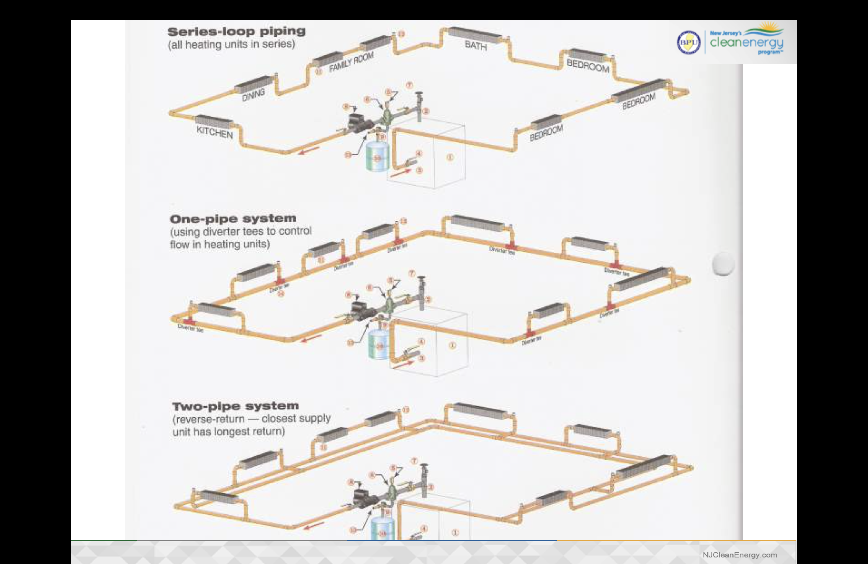

    See the photo below: Basically What I did was Option 2 (one pipe system) but without the monoflo tee and used a bypass valve (like option 3) as the monoflo. (for looks and convenience) Would this work? My thinking was because I'm doing 5-8 radiators on a zone It would be nice the send more hot water on to the the next rads in line. dumb? impossible?

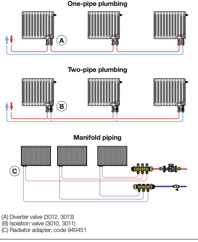

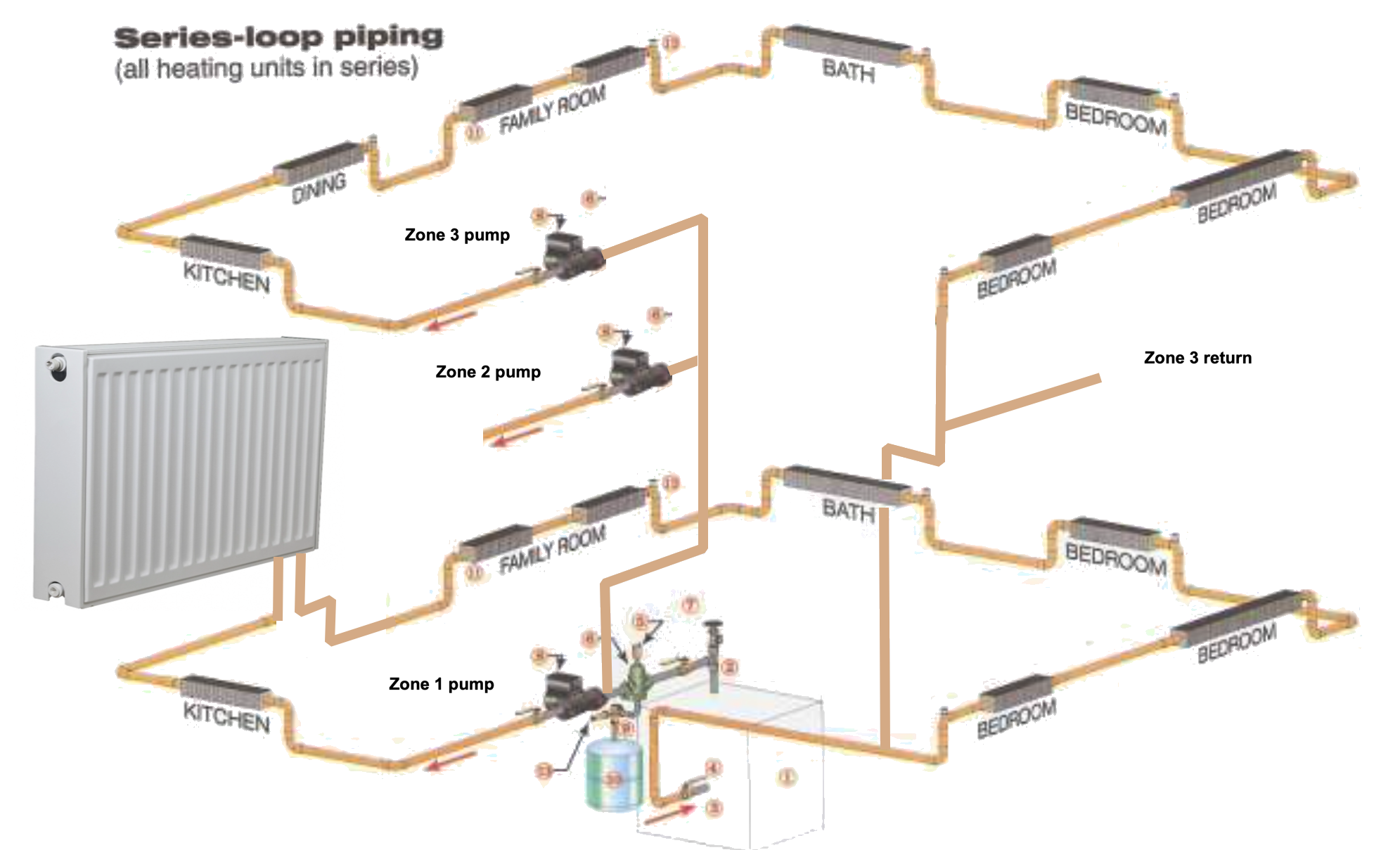

    That makes more sense. now you have several zones of what we call a series loop. There re typically 4 standard piping methods.
    Two pipe old gravity heating systems were connected as a parallel piping system pre 1950
    Newer two pipe gravity and some circulator systems used a parallel reverse return design late 1940 thru 1960
    MonoFlo or one pipe using convectors and diverter tees was popular in the 1950
    In the 1960s (and a long ago as the 1940s once circulators were becoming popular) the series loop became very popular as the most economical hydronic heating system to install. here are three of the 4 different systems
    Now that we have established the system you have lets look at what you are going to do with it.
    This will work however if you reduce the pipe from 3/4" to 1/2" yu will restrict the entire loop to what a 1/2" pipe capacity can carry which is a lot less BTUs

    Consider a homerun system. I think your 3/4" one pipe approach may be a can of worms.
