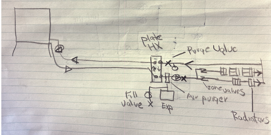

    is this a job you are going to pipe yourself? Here is an example that includes a backup boiler. One pump and two zone valves is a way to get 2 zones. The red line to the right of the pic is where two zone valves would pipe in.

    Don’t let any of the outdoor wood boiler people convince you that you can connect the house system directly to the ODWB. You need to separate the house from the ODWB using a heat exchanger as hot rod has shown.
    You will have several long term issues if you try to short cut this, not the least of which will be oxygenated water which will rot the radiators.
    Think about it: if houses could run unpressurized systems, then why has this industry been requiring it for well over 100 years?

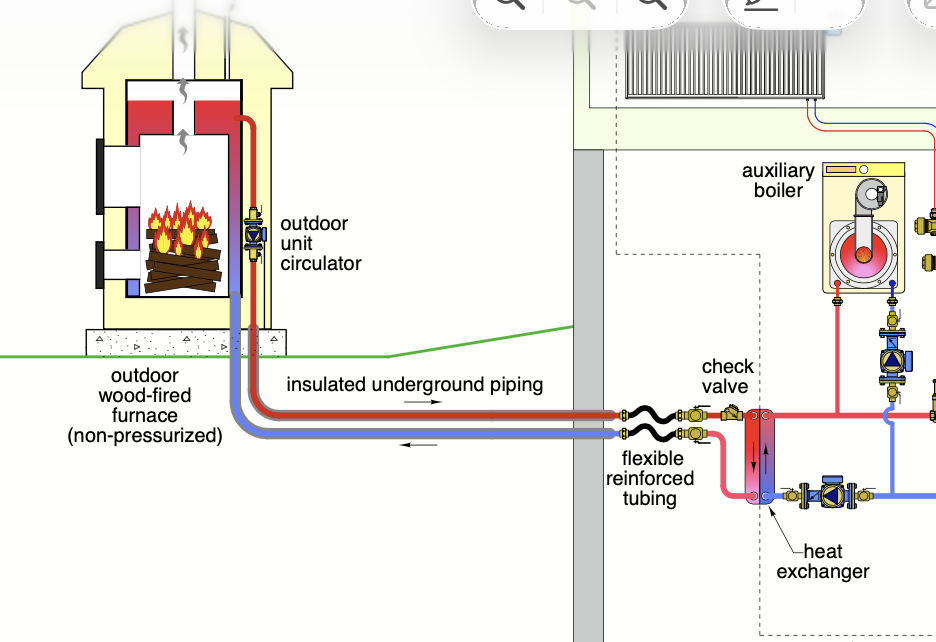

    Here is what your piping might look like. Find the plate heat exchangers at most wood boiler suppliers.

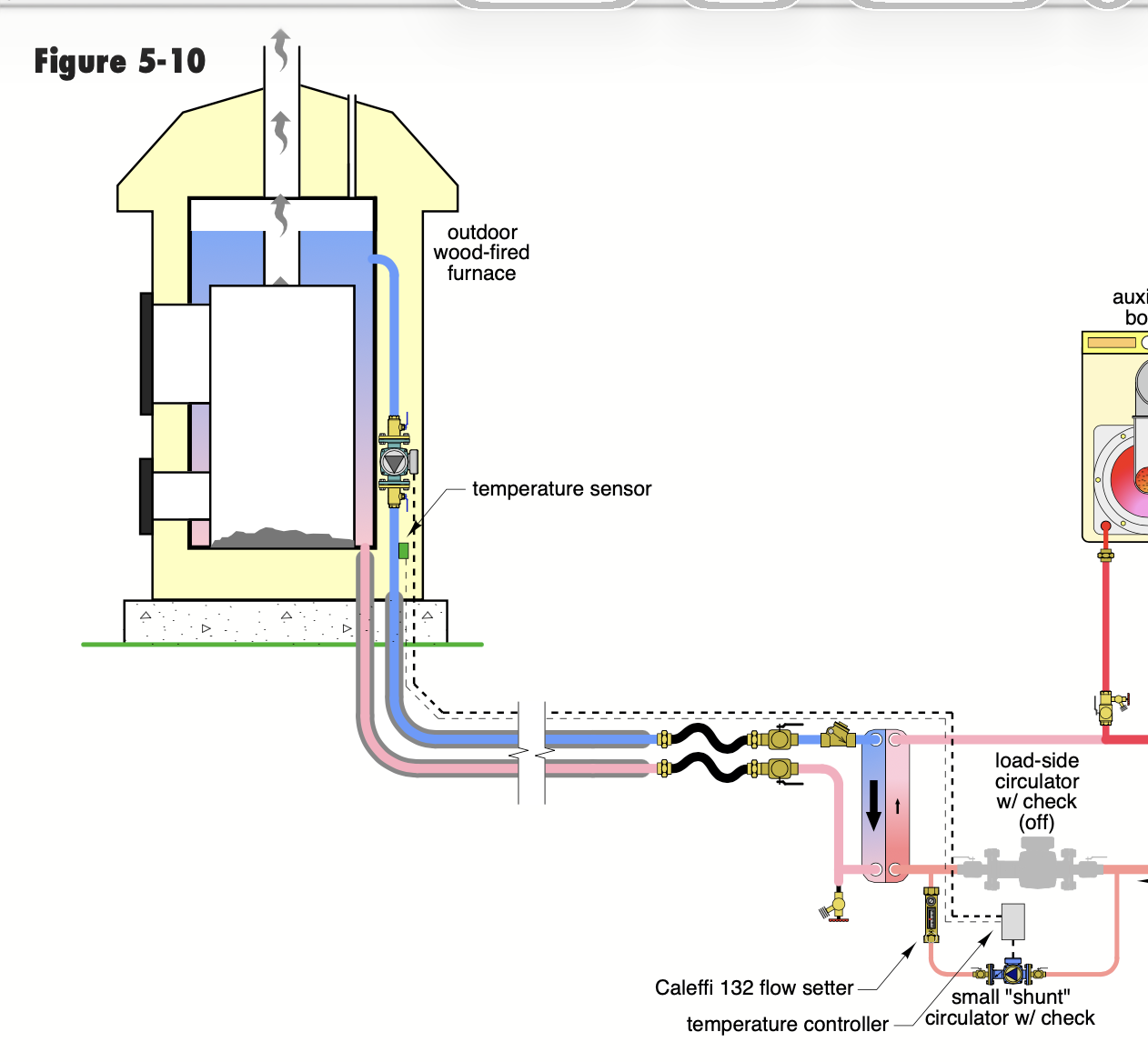

    If you do tie in a back up boiler,here is a piping that adds a shunt pump that sends a small amout of heat backto the OWF to prevent it from freezing if it is left un-fired.
    Screenshot 2026-09-29 at 12.07.47 PM.png Screenshot 2026-09-29 at 12.10.04 PM.png

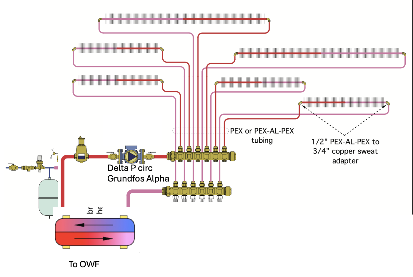

    Hot Rod, your diagram looks to be what I have in mind. Will I need a pressure tank and manifolds or can I just tee off of my main lines into to radiators and tee back into my return line to the plate heat exchanger?
    hot_rod Posts: 28,699
    Depending on the radiator size you could run 3 in series with 3/4" pex tube. or.
    A home run piping uses1/2 pex loop to each radiator back to a manifold.
    Home run gives you the ability to zone or adjust every radiator, 1/2" pex is easy to retrofit into homes.
    This is an example with fin tube baseboard

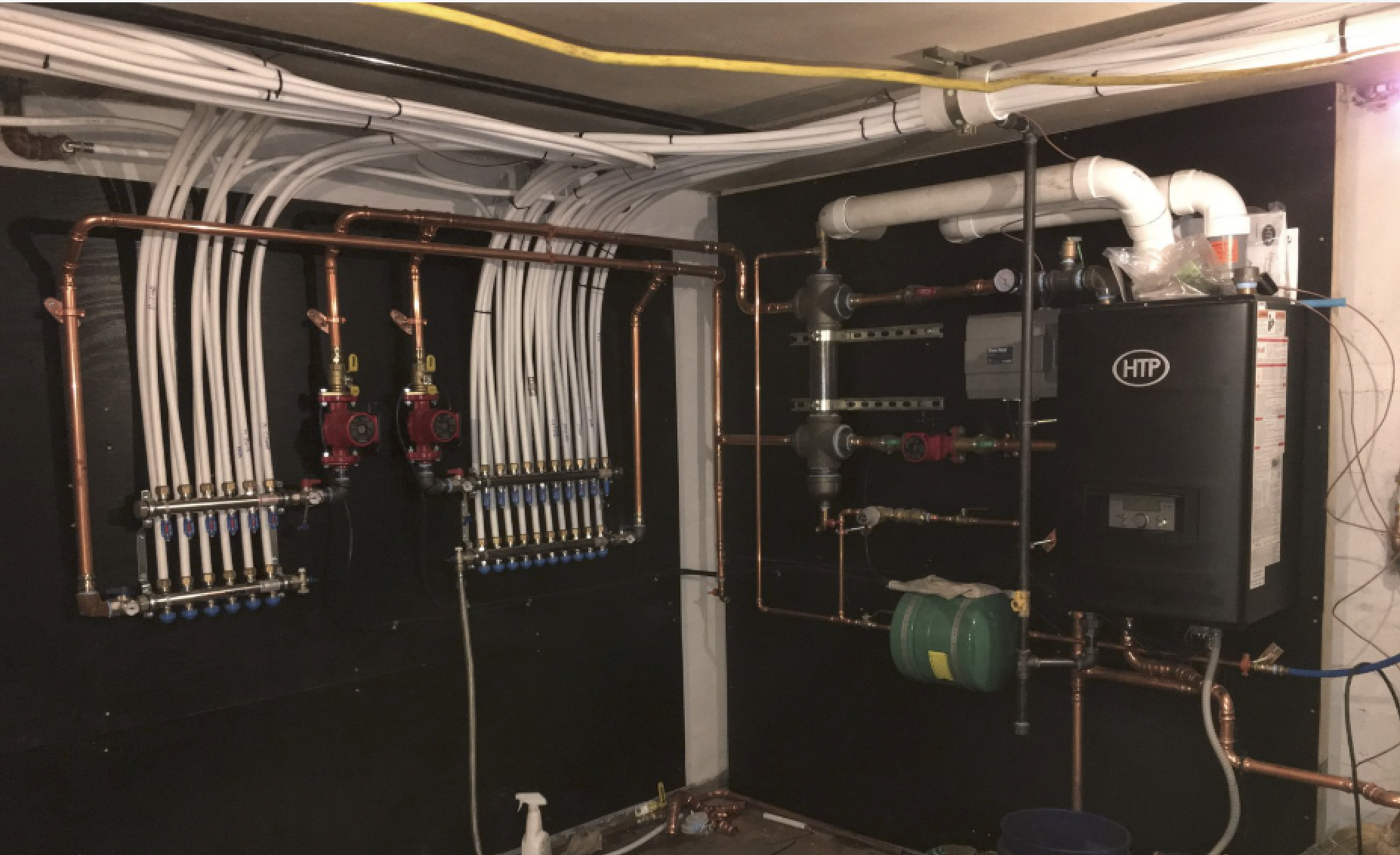

    Here is a homerun system @Ironman did with the tubing neatly organized in PVC pipe.

    A series loop will work if you have fin tube baseboards, but you’ll wanna use parallel piping with standing cast iron rads.
    The homerun/manifold will work well with either.
