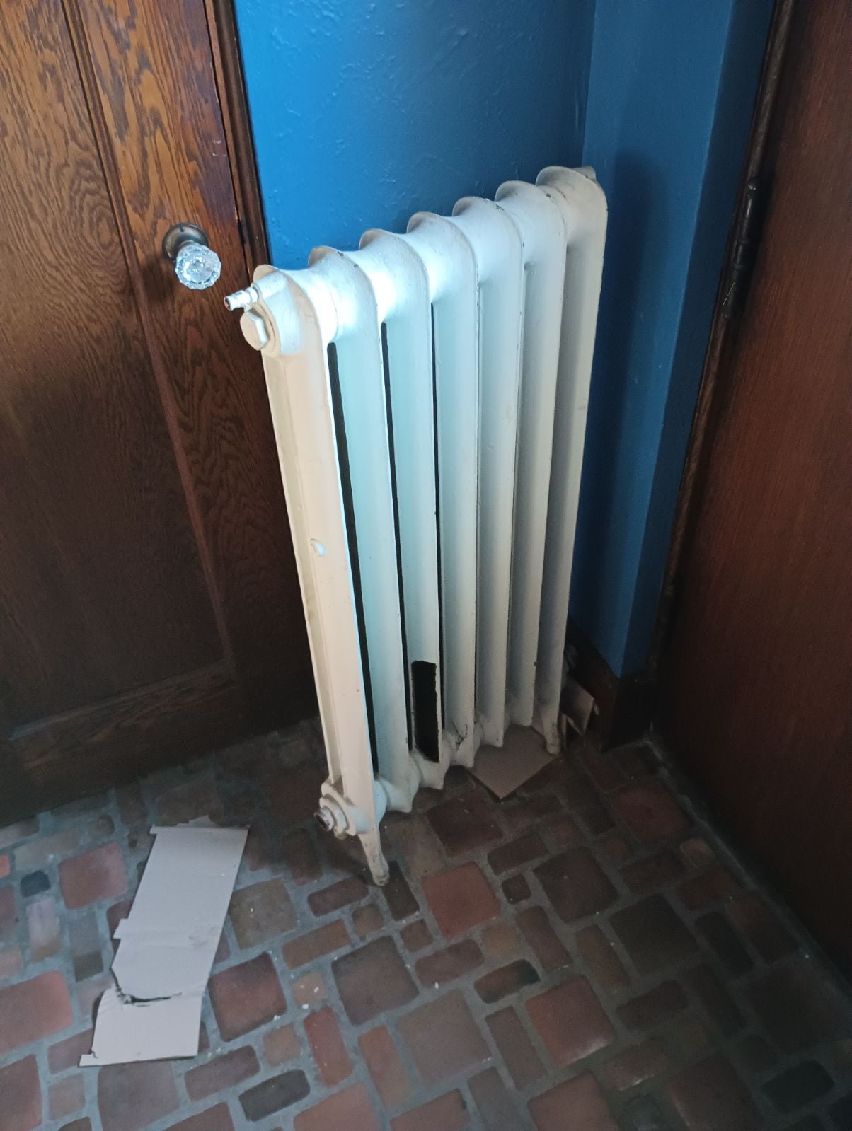

I am looking for a replacement radiator.
I live in the Milwaukee area so can pick up. Otherwise I'll purchase one as long as it can be shipped.
Thanks
    What's the matter with that one?
  • It appears he missing a chunk out of the 3rd section.

    You might also concider a panel radiator from one of many manufacturers in many sizes.
    right then. Missed that.
    Steamhead Posts: 19,007
    @degtosa , how tall is that radiator? This will help us match its output. Also, what pipe size is used to connect it?

    The original radiator was 36 x 24. It's skinnier than a typical radiator since it was in a foyer, 16 sqft.
    I'm not concerned about heat equivalent. Just some heat.
    Pipe size is 1.25.

    If you can't find a replacement, you might also consider having the radiator disassembled, removing the damaged section and re-assembling it, making it a 6-section radiator.
    edited October 8
    us boiler. unless you need it to match exactly, us boiler makes stuff that will be functionally equivalent. castrads can make something that is more or less that style at a higher cost.
    https://s3-us-west-2.amazonaws.com/catsy.782/Baseboard+and+Radiators+Product+Data+Sheet.pdf

    If you want a vintage radiator try Wagner Salvage in Philadelphia. ( website link attached). Being so narrow makes a replacement hard to find. I bought one like that from them last spring. It was 10 sections and 40” tall. They had a couple more that were shorter. If you want an older style give them a call. They’re good to deal with, have good inventory, and are good with shipping options.
    https://www.usedcastironradiators.com/
    if you are just trying to take the chill off a foyer since it is hot water, you could get a tall, skinny runtal or 1 or 2 tube deep panel radiator. it won't hold heat like the cast iron so it won't exactly balance with the rest of the system but it will give you some heat in that corner.
