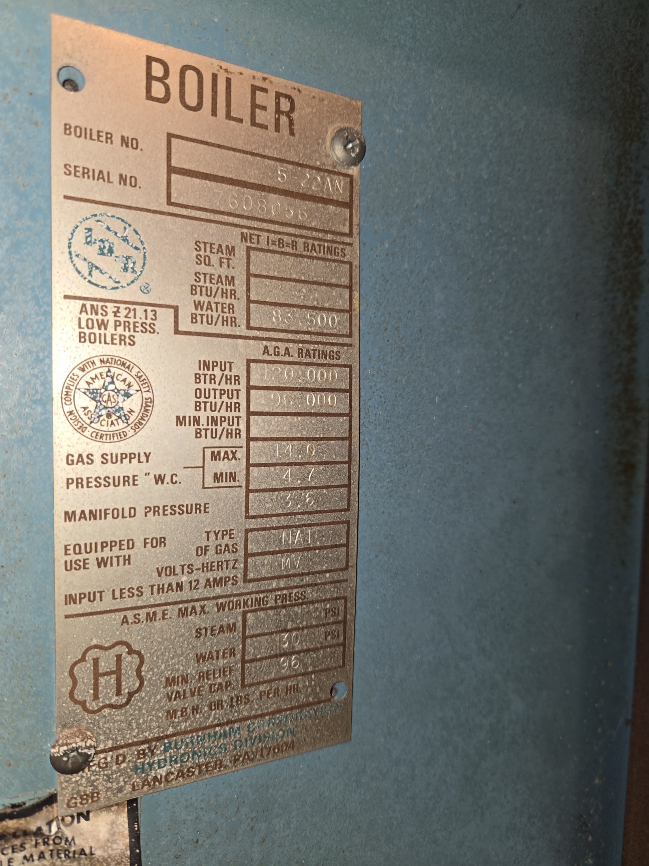

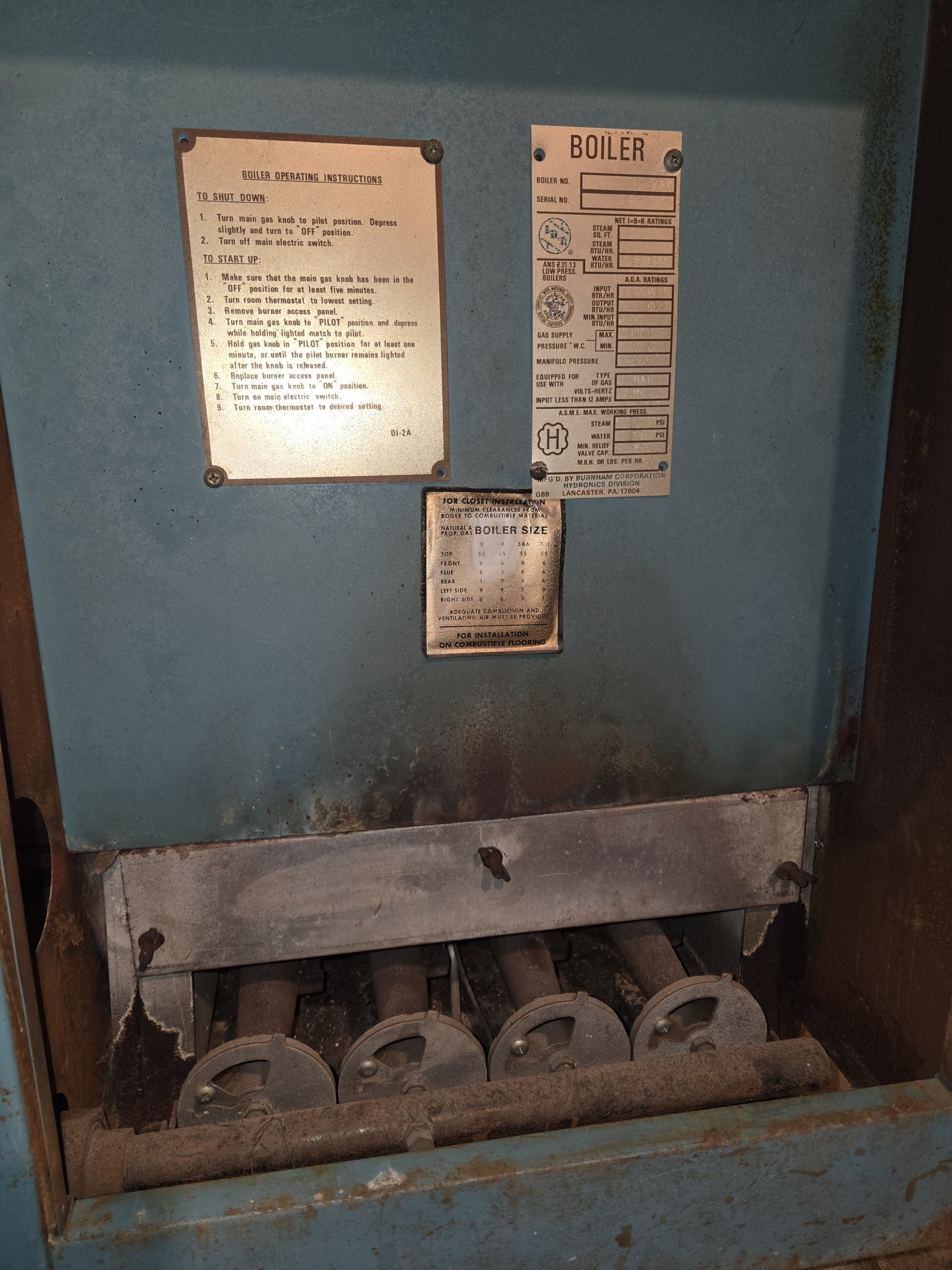

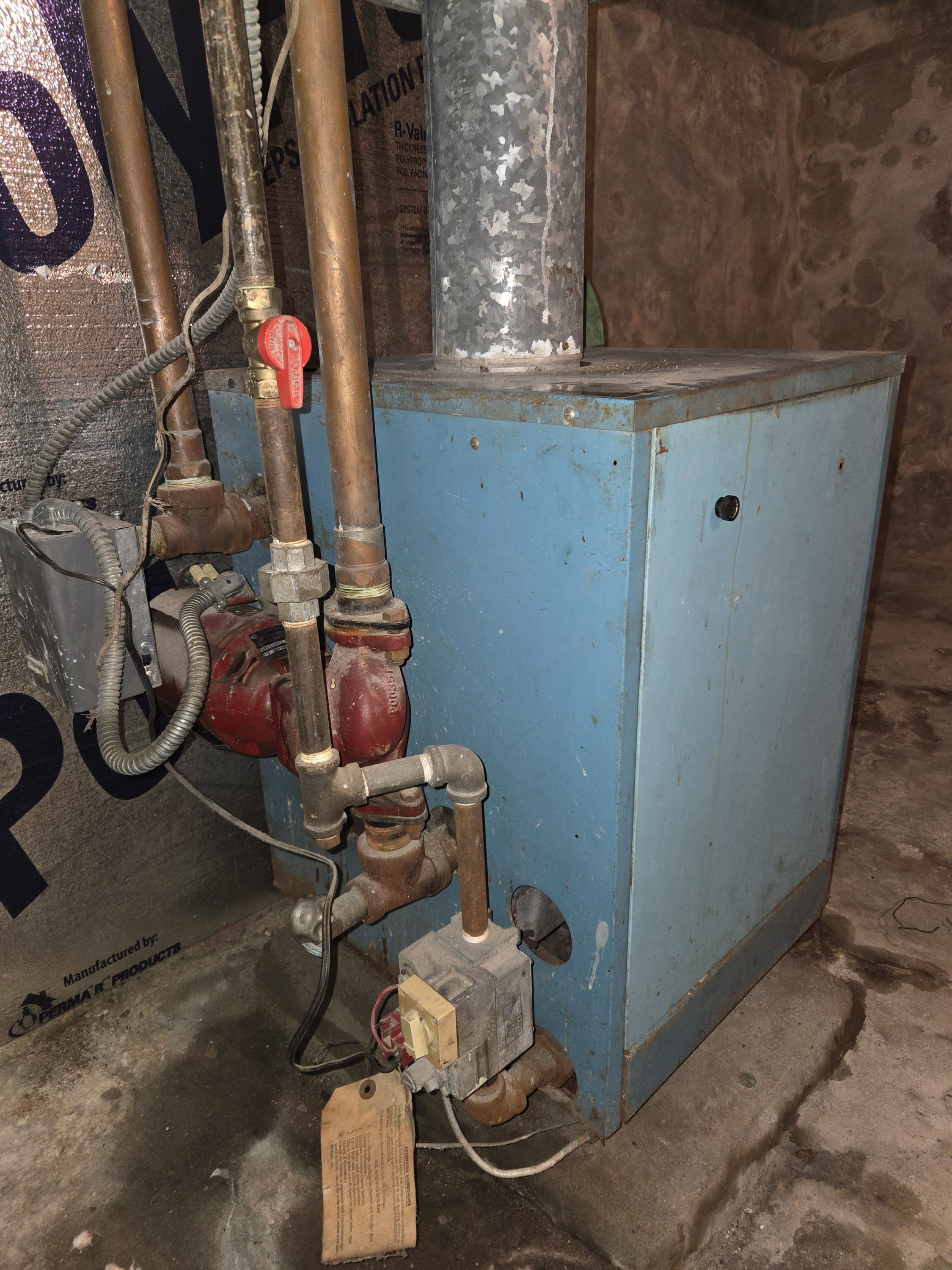

1976 Burnham 5-22AN: what temp to avoid condensing?
I recently bought a rowhome needing a lot of updating.
After cleaning and restarting this old boiler, I noticed that the high limit was set to 205. Maybe someone thought this was needed, maybe with the leaky windows it is on the coldest winter nights, but for the shoulder seasons I'd like to drop the high limit down to 155 or 165.
The baseray cast iron baseboards should be fine with the 150 degree water, and the B&G pump could likely run practically continuous duty for another 50 years as long as I keep up on the lubrication.
But I don't want the boiler to start condensing. What is a safe high limit to lower it to?
And, if I switched to a Hydrostat 3200 with condensation protection, would it work with the way this hydro well is mounted?
Thanks in advance!

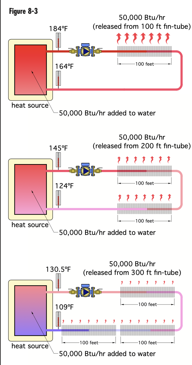

    So the distribution, piping and radiators are in charge of the boilers operating condition.
    Common rule is return reaches 130 within 10 minutes of run time. Ideally it runs at least 20 minutes once fired.
    Now with a fixed output boiler those time vary based on the load of the home. Mild weather expect more on/ off cycles.
    On a design, coldest day in a perfect world the boiler would run non stop, the output matching the radiation and the load of the home.
    Also, some boilers have both an operating temperature and a high limit control. 205 sounds like a limit control setting, , operating may be more around 180? Usually a 20° differential between operating and high limit.
    An outdoor reset control can save some energy costs and improve comfort.
    If you want to spend some time number crunching, do a heat load calculation, then measure the CI baseboard to see how they match up, lastly see how the boiler matches those numbers.
    Oversized boilers run inefficiently and could lead to excessive short cycles.
    This graphic shows how the radiators control the boilers operating condition. As you increase the radiation size the boiler supply and return drops. A 50,000 boiler at a 5 gpm flow rate in all 3 examples.
