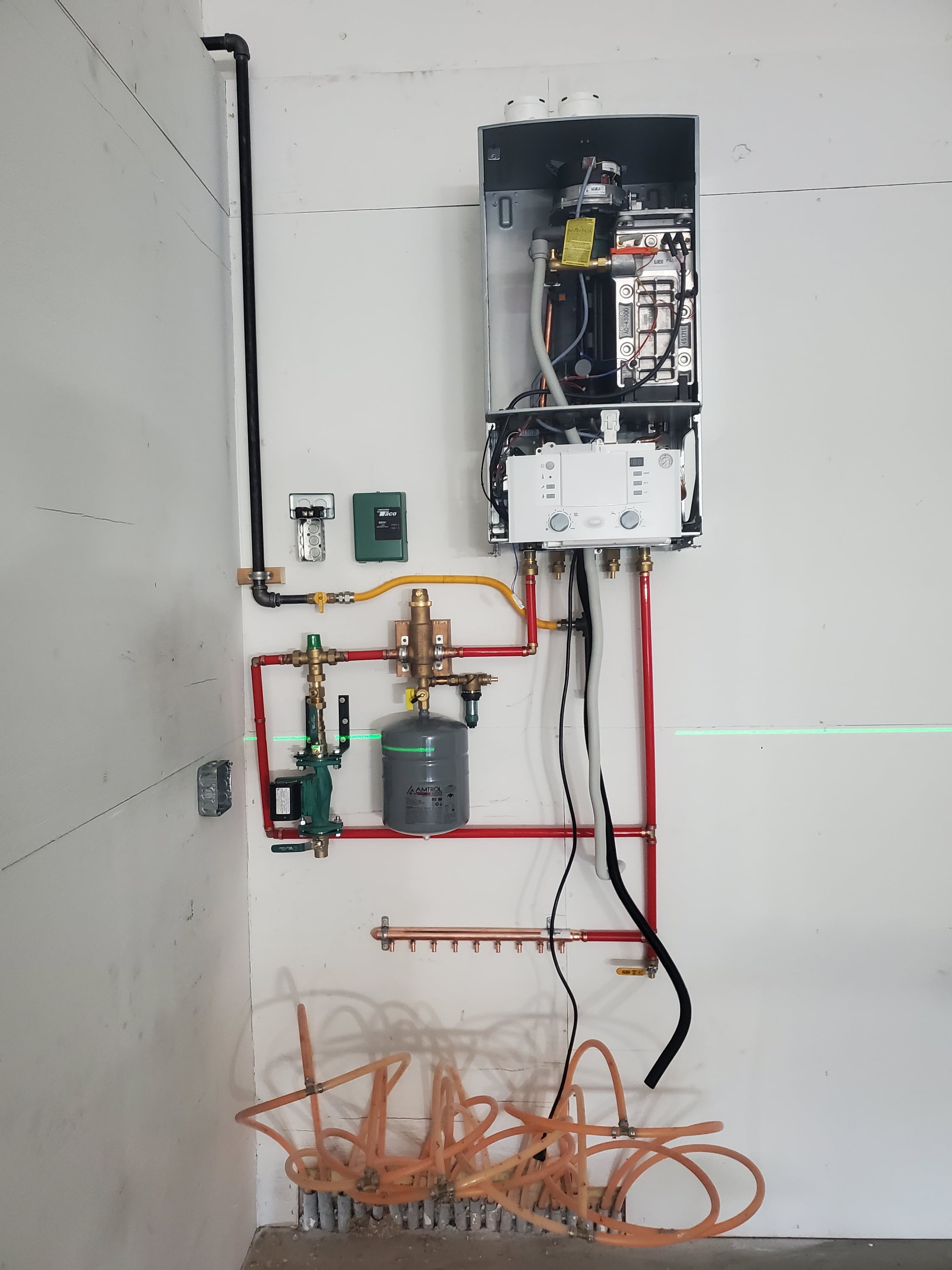

What's wrong with this install.
  • I saw this at a customer's place , Bosch 151 combi .

    For starters, The floor loops aren’t connected.

    Neither is the vent piping or the wiring.

    Looks like a combi boiler. With that type of heat exchanger design the installation manual probably shows primary secondary piping is required or at least suggested.
    I'm not sure why you would have a mixing valve, as it is a low temperature friendly boiler.
    The installation manual would shed some light on what is proper piping.

  • I have nothing to with the install, just saw it at a job. As @hot_rod said there is no ps piping and there is is a mixing valve which is completely unnecessary. They have the manual for it, apparently they don't know how to read.

    It probably will work as shown. The boiler will need to run 15 degress warmer that the radiant required nsupply temperature for the mix valve to operate properly.
    9 loops is a bit much for a typical 3 Cv mix valve, and not knowing the pressure drop across the boiler? But with enough pump power??
    mattmia2 Posts: 18,231
    alternatively you can set up odr and it will just rum off the setpoint of the boiler, assuming the radiant only needs around 3gpm.

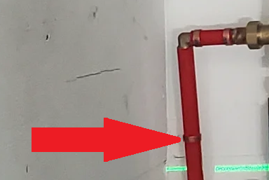

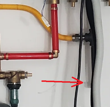

    Is it natural gas- or propane-fired? Needs a dirt leg on the gas line. And there is a bushing installed on the elbow. That's a no-no.
    109A_5 Posts: 4,616
    There is a dirt leg on the gas line, look at the shadow on the wall.
