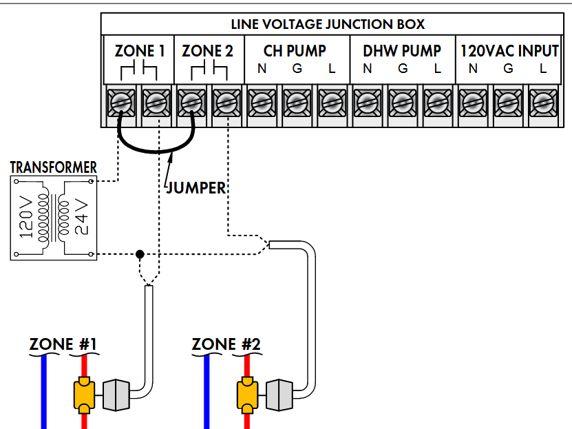

NTI TRX150 Wiring Help Needed

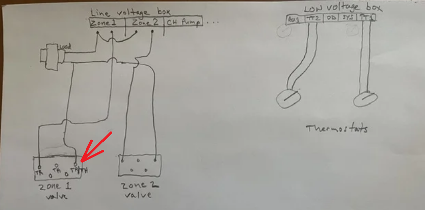

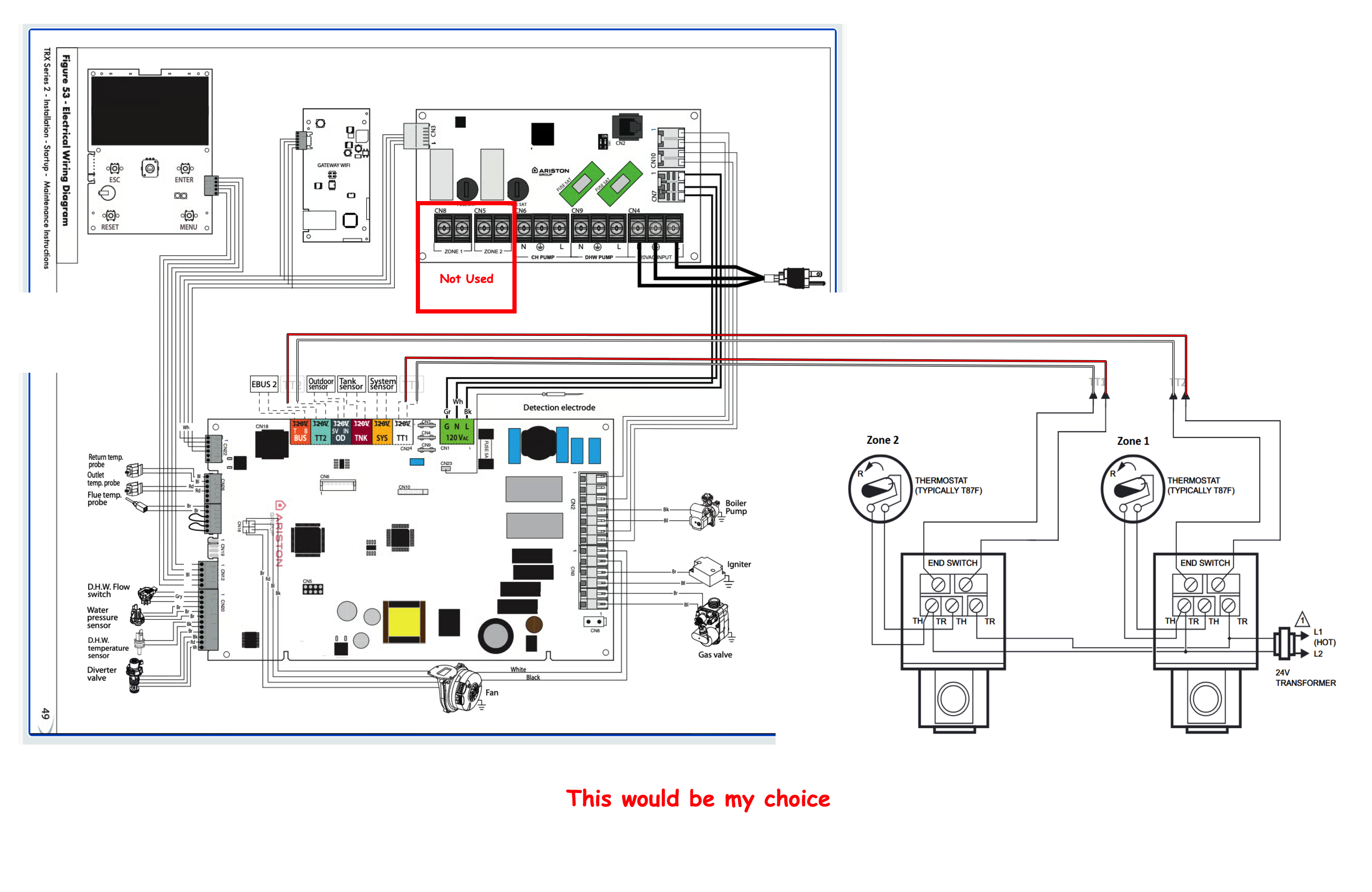

I Just installed an NTI TRX150 that has a 2 zone controller built in. It is set up with one circulation pump which goes to a manifold with 2 Honeywell V8043F zone valves with the 5 screw terminals (no leads). It is wired as shown in the NTI instruction manual (I think). One lead from the 24 V transformer (load contact) is connected to zone 1 contact 1 in the Line Voltage Junction Block on the boiler and the other lead goes to TH/TR on the zone valve; then wire goes from zone 1 contact 2 from boiler to the TR contact on the zone valve. Only 2 wires are connected to the Honeywell zone valve. The thermostat wires are connected to Zone 1 TT1 on the boiler's Low Voltage Wiring Block. It seems to work but when the thermostat is not calling for heat I am measuring 13 volts from the 2 leads being used on the zone valve; I am measuring 27 volts on the zone valve when there is a call for heat.
For those in the community with experience on NTI TRX's - do I have it wired correctly and are these voltage measurements ok? Thanks in advance for the help.

    How about posting some pics and a diagram of how you wired it?
    You cannot connect a 24v thermostat directly to the boiler.
    Bob Boan
    hot_rod Posts: 28,766

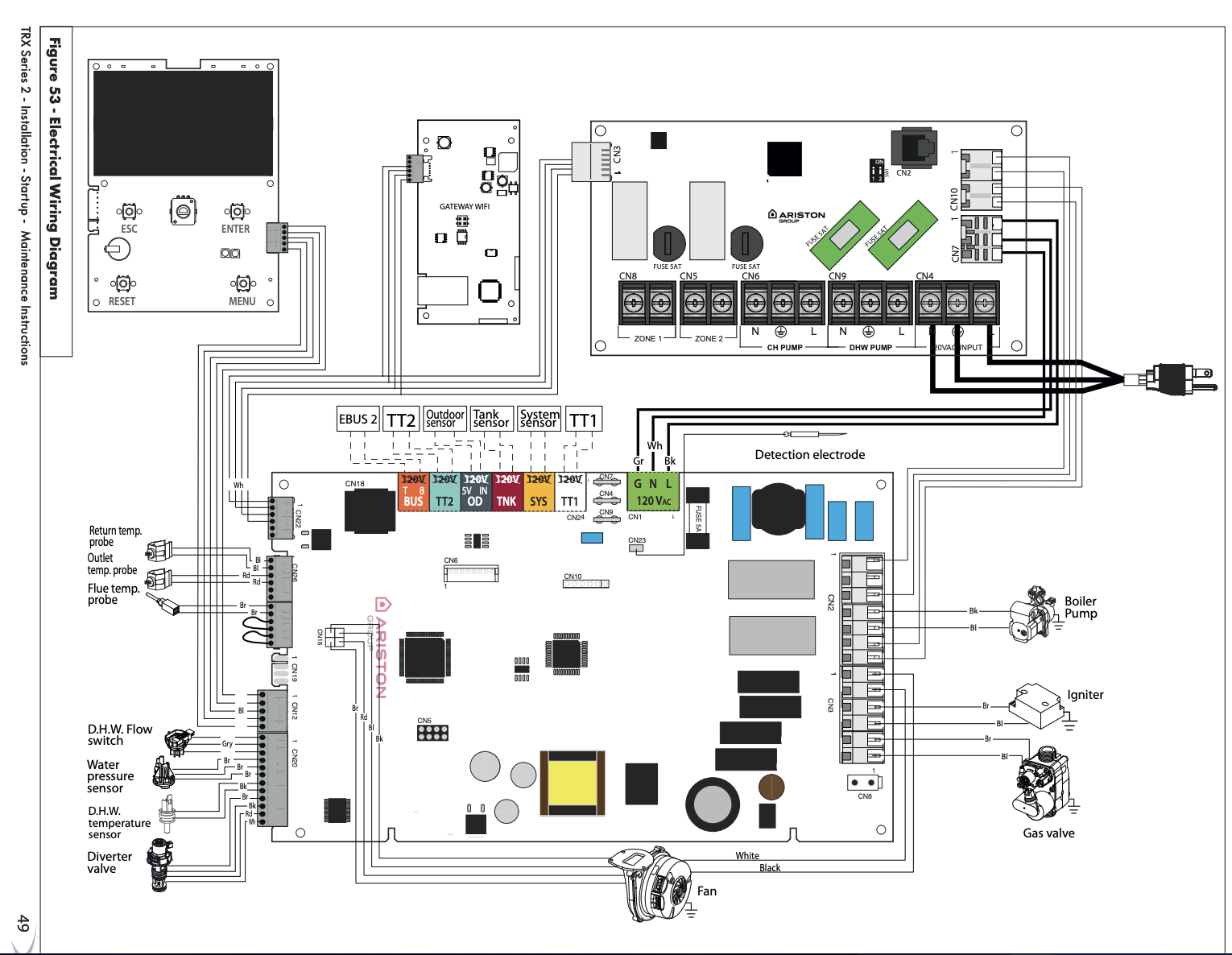

    If this is the wiring in your TRX manual? You can hook two thermostats directly to the boiler, TT1 and TT2 and that enables two outputs up top Zone 1 Zone 2. Those look to be dry contacts so you need to supply 24V. If you are running zone valves.
    If you are using 24V zone valves a separate relay box would be your best option.
    Thermostats wire to the relay box, the relay box powers zone valves, the relay box connects to TT1 to call the boiler and pump on
    But it depends on your piping, how many pumps, is it primary secondary piping?

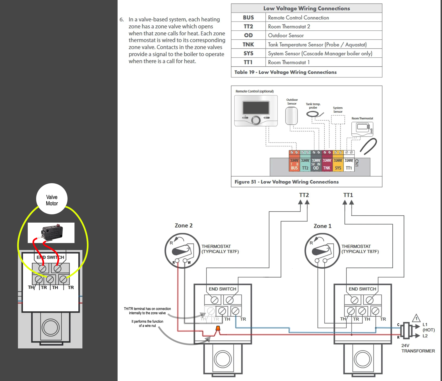

    Looking at the Manuals, NTI TRX150 and Honeywell V8043F zone valves, this is what I get out of your situation.

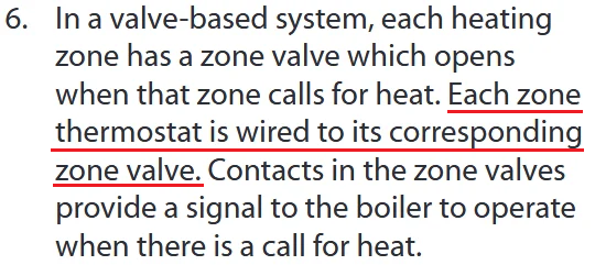

    The NTI TRX150 manual (IMO) is super confusing, it shows an illustration of one thing then in text (#6 below) it explains how it should be, which is different from the illustration.
    The way it should be; The added external 24 VAC transformer powers the two thermostat circuits, which includes the zone valve's motor. When a thermostat calls for heat it energizes the zone valve's motor for that zone, this opens the zone valve's valve. Once the zone valve is fully opens it closes its End Switch which activates TT1 and/or TT2 of the boiler's low voltage control, activating the boiler.
    BTW the End Switch circuit has no electrical connection to the thermostat / zone valve motor circuit, they are isolated from each other.

    To explain " I am measuring 13 volts " I suspect you have the motors of the two Zone Valves effectively wired in series (which is wrong). So when both sets of contacts of the Line Voltage Junction Block are open the voltage divides by 2, for 13 VAC across each zone valve motor. If that is so the bad thing is if both zones are active at the same time it may short out the transformer, causing the transformer to fail.
    The thing is you want to confirm the zone valve has actually opened so the water can flow before firing the boiler and energizing the circulator. The confirmation is the Zone valve's End Switch closing. The Zone valve's End Switch closing controls the boiler. (See the wiring diagram in my previous post)
    So:
    When wired as shown below you should never see 13 volts, just 27 Volts (24 VAC nominal) or 0 (Zero) Volts across a zone valve's motor, just On or Off, not half On (13 volts). And not 0 (Zero) Volts because closing both sets of contacts shorted out the transformer. In any functional or idle state the transformer should always have 24 VAC nominal at its output terminals or wires.
    Anyways, in this wiring illustration (which is electrically correct for what it is intended to do) it provides no confirmation that the zone valve has opened, I would not do it this way, even if wired as shown here:

    Well I tried to draw this circuit you described.
    "One lead from the 24 V transformer (load contact) is connected to zone 1 contact 1 in the Line Voltage Junction Block on the boiler and the other lead goes to TH/TR on the zone valve; "
    " then wire goes from zone 1 contact 2 from boiler to the TR contact on the zone valve. Only 2 wires
    are connected to the Honeywell zone valve. "
    This description does not seem to produce a valid circuit. Since TH terminal (one of the motor terminals) is not connected to anything.
    For example " other lead goes to TH/TR on the zone valve " The TH/TR terminal typically goes nowhere inside the zone valve assembly, it is just provided as a convenient connection point for two other external devices.
    The terminals on the zone valve that goes to the motor inside are TR and TH.
    Also you did not describe how the Zone 2 is wired.
  • Thanks for the replies, I am digesting the info Hot Rod and 109A-5 provided. All of the diagrams you posted above are exactly what I have in the manual.
    The plumbing is primary/secondary and there are 2 pumps. The primary pump is inside the boiler and then there is a second pump that pushes water through the zones. The secondary pump is wired directly to the boiler along with each thermostat (simple Honeywells with a mercury switch that don't require power) and the pump works as it should.
    I have the zone valves and transformer wired as shown in the diagram posted by 109A_5 but I know this is wrong because it doesn't work and doesn't really make no sense based on the Honeywell diagram.
    I have never wired a boiler before and feel like a ****. Can someone draw me a sketch on how this should be wired. I don't believe a relay should be required. I called NTI Tech support but they were no help on the wiring.

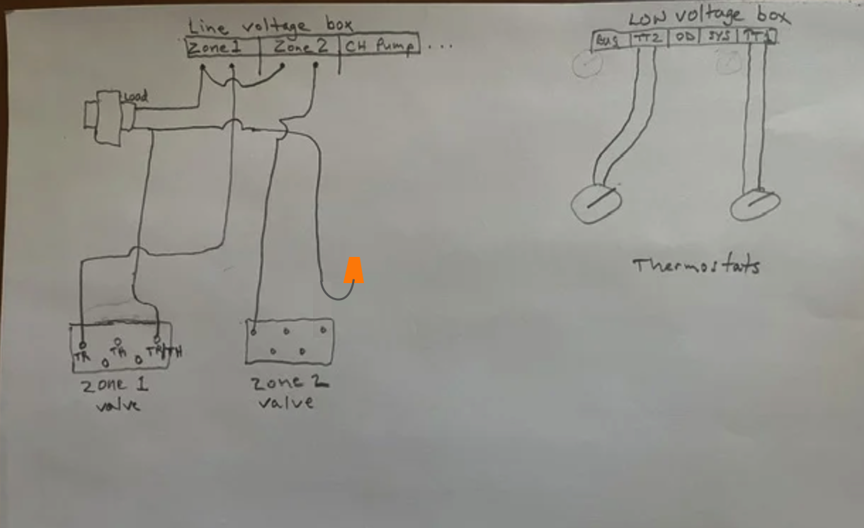

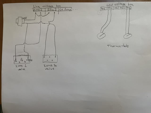

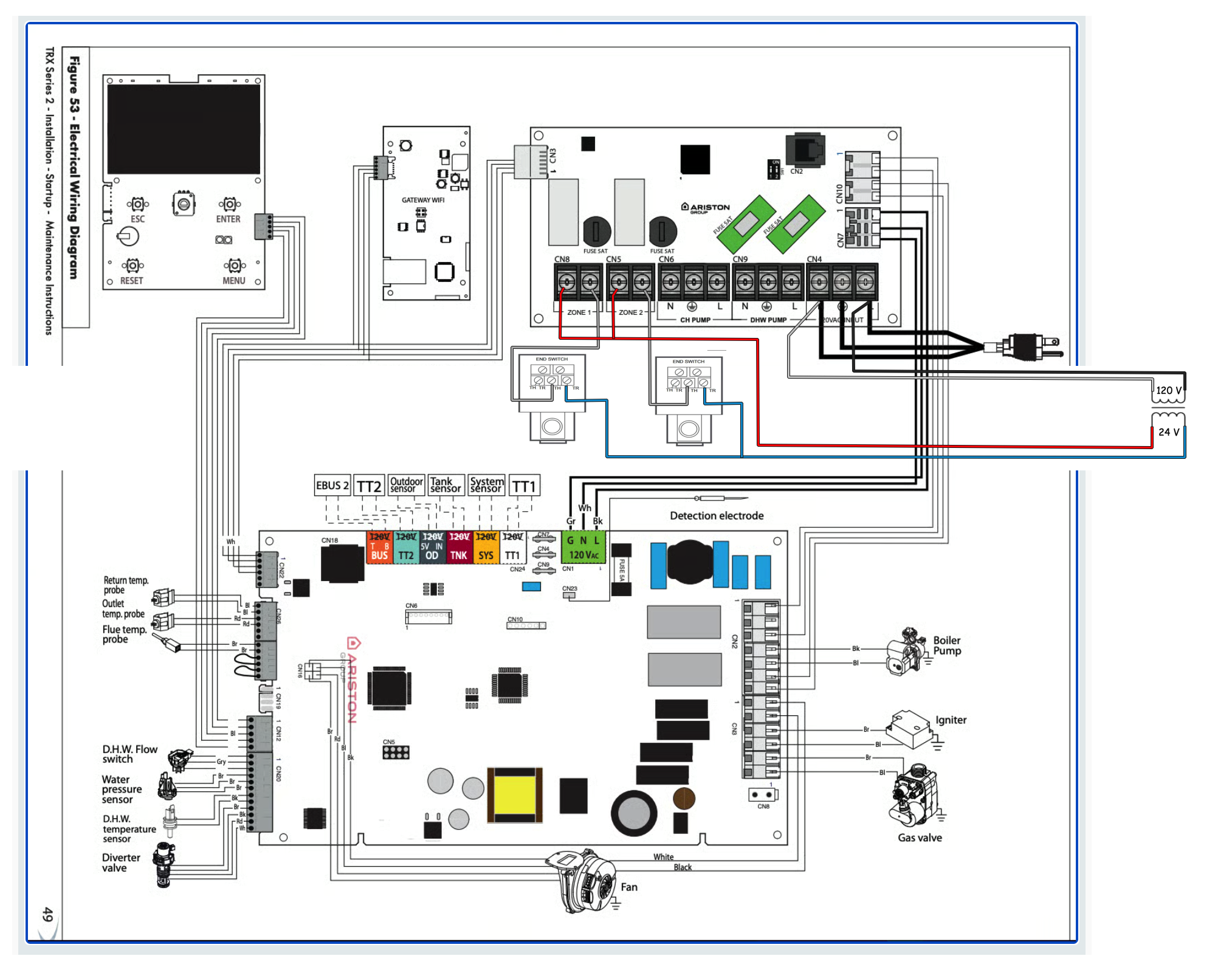

    Here is how it is currently wired, your help is greatly appreciated!
    109A_5 Posts: 4,778
    edited September 25

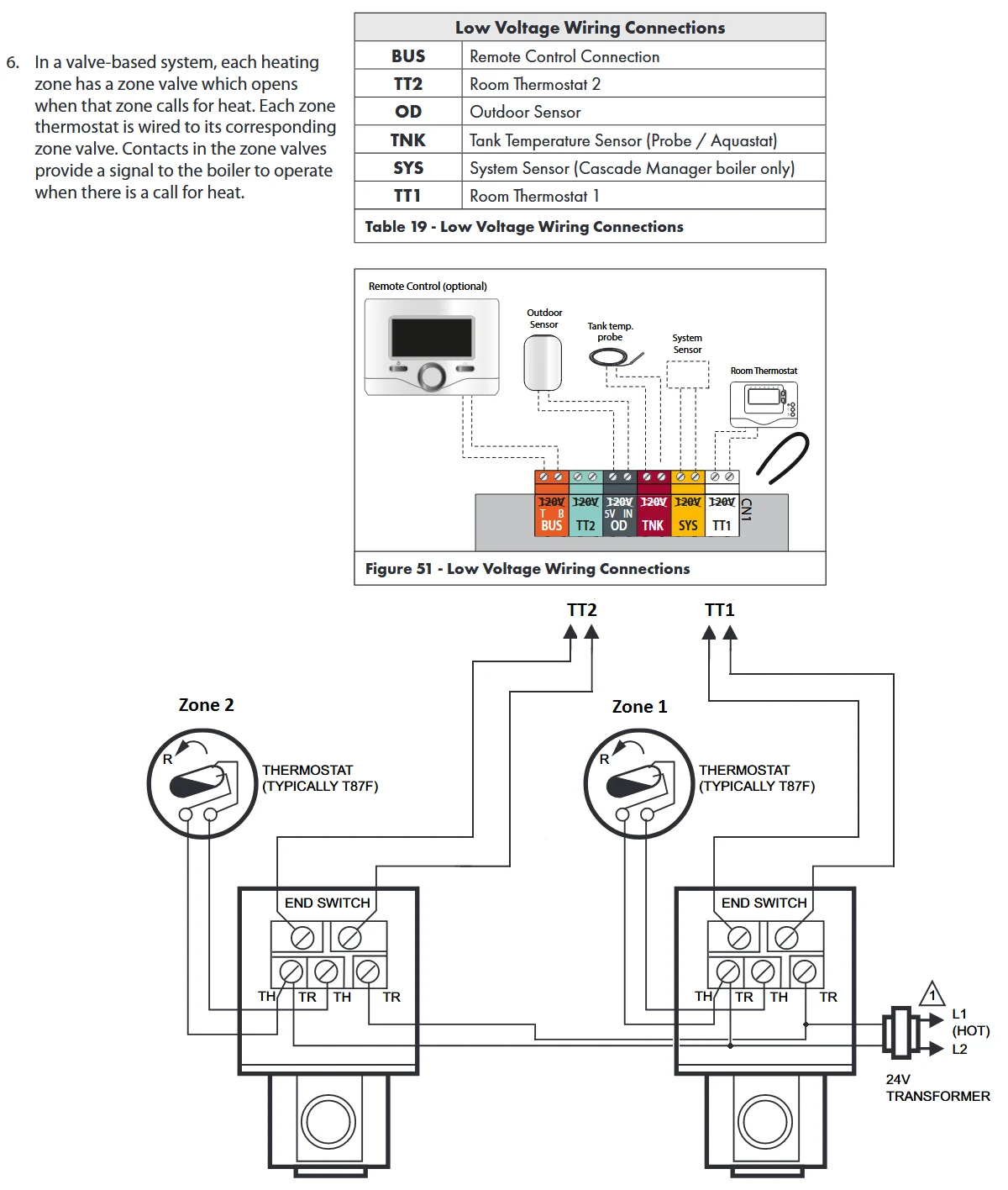

    First, if you wired it like your drawing I find it hard to believe you are getting 13 VDC anywhere, ever. Unless it is just some odd ghost voltage your meter is seeing.
    Second, as far as I can tell the TR/TH terminal (Red Arrow) is just a convenience connection point, often used to connect the transformer to a thermostat wire instead of using a wire nut, it does nothing inside the zone valve. So effectively you have only one wire going to the zone valve, look at the zone valve manual. Which it why the pigtail wired version of the zone valve only has 4 wires.

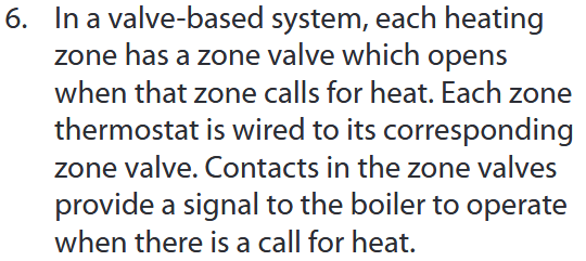

    There is proper sequence of operation when using zone valves. It is #6 text below, it is in the boiler manual multiple times, however the paragraph number changes. The thermostat call for heat, zone valve activates, when the zone valve opens all the way it activates the boiler. Your present wiring does not support that operational sequence. The wiring diagram below supports that sequence of activity.
    Your thermostats are wired to the boiler, they should be wired to the zone valve(s).
    " Can someone draw me a sketch on how this should be wired. " this wiring diagram directly above is not clear to you ? This is the second time I posted it.
    Hint: you need to abandon the connections to the line voltage terminals and only use the low voltage terminals.

    I believe the boiler's line voltage contacts are actually for (or better suited for) when the zoning is done with circulators and not with zone valves.
    " Manual shows a dry connection to the transformer per the diagram you posted above. " I do not know what exactly you are referring to.
    All this wiring shown below (line voltage contacts stuff) would be abandoned, it is not applicable for what you are trying to do. As per the text in the paragraph from the manual about zone valve use. The transformer would get repurposed to power the thermostat circuit and the zone valve motors.

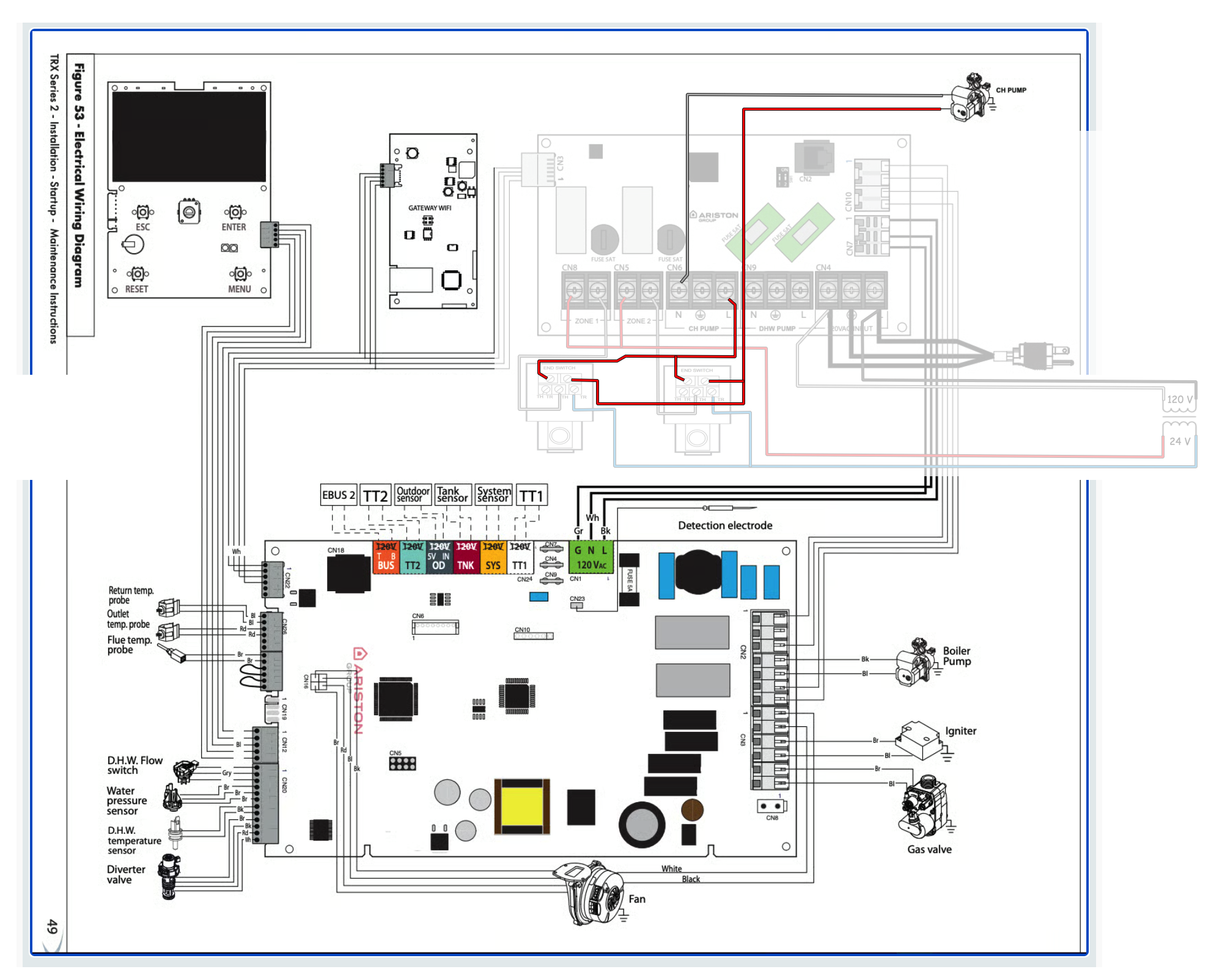

    @109A_5 does a great job of explaining the wiring. But sometimes a picture is better. in the diagram from #6 in the I/O manual I have made the circuit a little simpler.
    The illustration to the right of the #6 diagram shows what the other side of each terminal is connected to inside the box.
    TH is connected to a yellow wire that goes to the motor. TR is connected to the other yellow wire going to the motor. When 24 volts is applied across the TH and TR terminals, the motor will open the valve. connecting only one wire to the TH/TR screw will accomplish nothing
    On the other side of the end-switch terminal screws are two red wires connected to a switch. That switch closes, much like a thermostat closes on a call for heat, connecting the two terminals together—just like closing a switch to turn on a light bulb.
    In this case, you would run two wires from the end switch and connect them to either 1TT or 2TT on the boiler.
    What you show this drawing as the wiring you have:
    Untitled Image
    This is troublesome to me because you have a line voltage zone output connected to a low voltage transformer. and the arrow that @109A_5 added to your diagram is basically connecting only one wire to a wire nut, like this:
    Because TH/TR terminal has nothing connected to the other side of the screw terminal inside the box

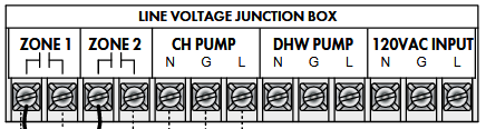

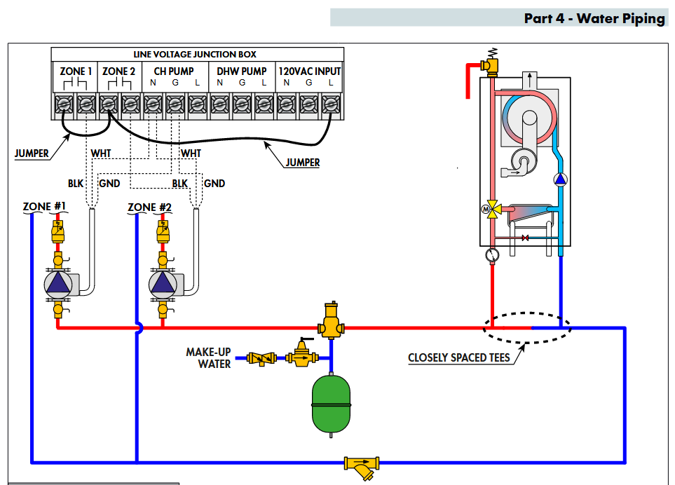

    The confusion could be that terminal strip labeled Line Voltage Junction Box
    I believe the Zone 1 & 2 are dry contacts
    Usually UL requires a separation between line voltage and 24V. That cardboard strip you see in some relay boxes.

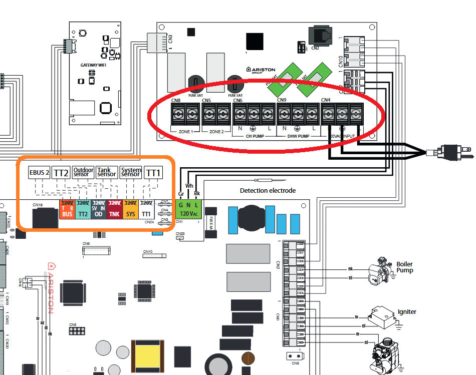

    @hot_rod I think you will find the Line Voltage Junction Box and the Low Voltage Wiring Connections are separated. " I believe the Zone 1 & 2 are dry contacts " I believe you are correct.

    Just as an informational example, not applicable in @billyboy01situation. The Zone 1 and Zone 2 contacts are used to control circulators.
