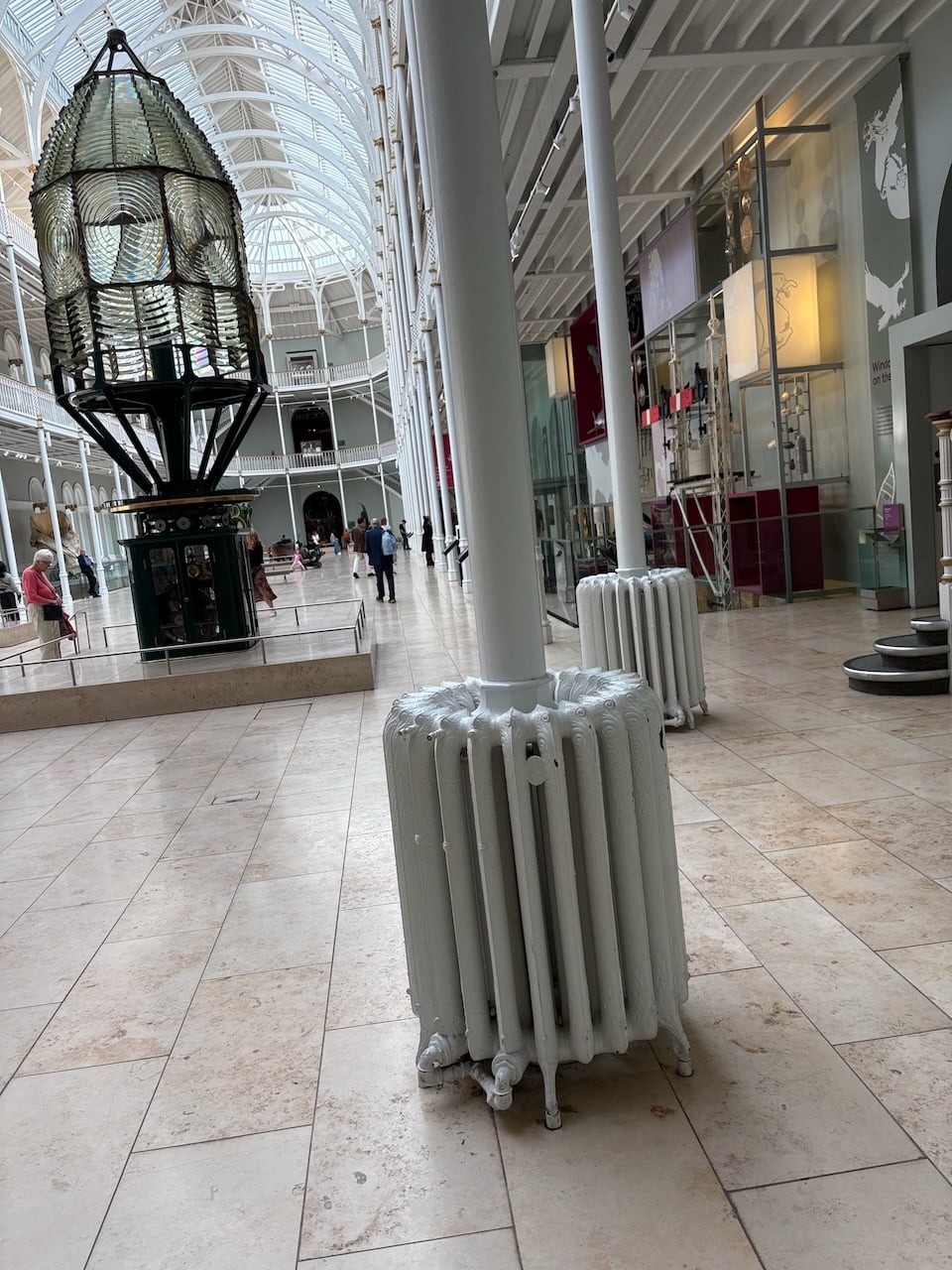

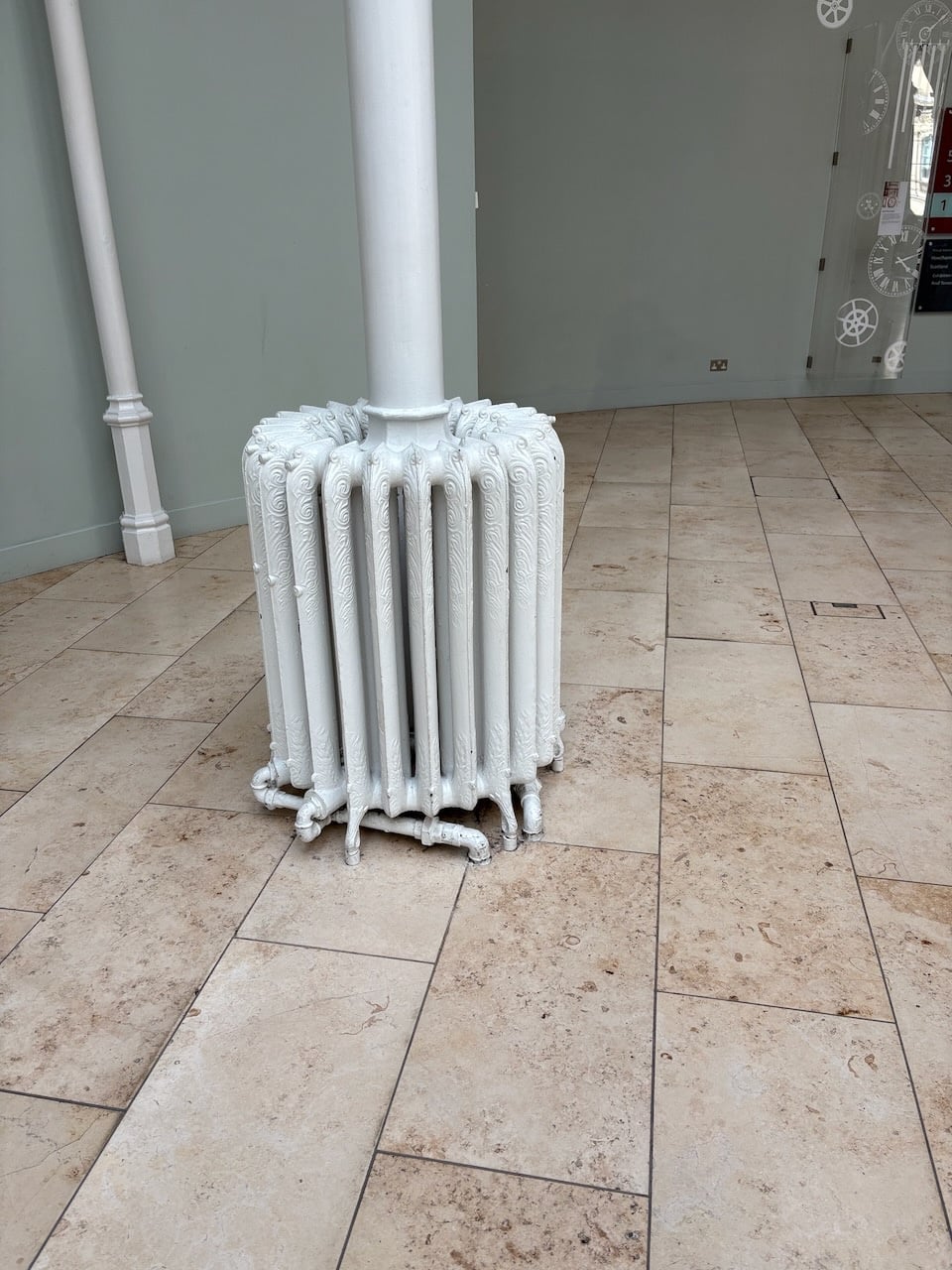

I thought this might be of interest to radiant heat fans on the forum. I was recently in Edinburgh at the Nation Museum and, in addition to many interesting exhibits, found these radiators fascinating. They are found throughout the older building of the museum and appear to be hot water rads. They were heating up.

    Sure are pretty. Interestingly, there seems to be two different castings, one with a bung for a bleeder, and one without. Even more interesting are the bleeders installed in some of the bungs, but not others. And yet more interesting is the order of the castings with the bungs!

    They do work! That's a wonderful museum, by the way — if you are ever in Edinburgh, do visit. It's worth the time.

  • Thanks for sharing, @dgn! They are beautiful.
    We spotted some of these in Washington, DC. Here's a video:
    And @Nick_Castrads shared more photos of these types of radiators in the National Museum of Scotland in the link below. They are circular American Radiator Company Perfection radiators.
