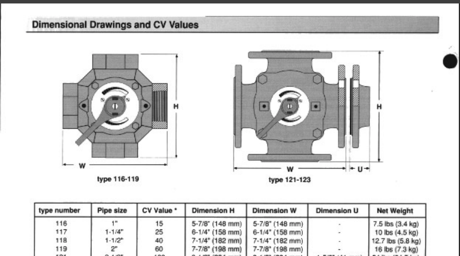

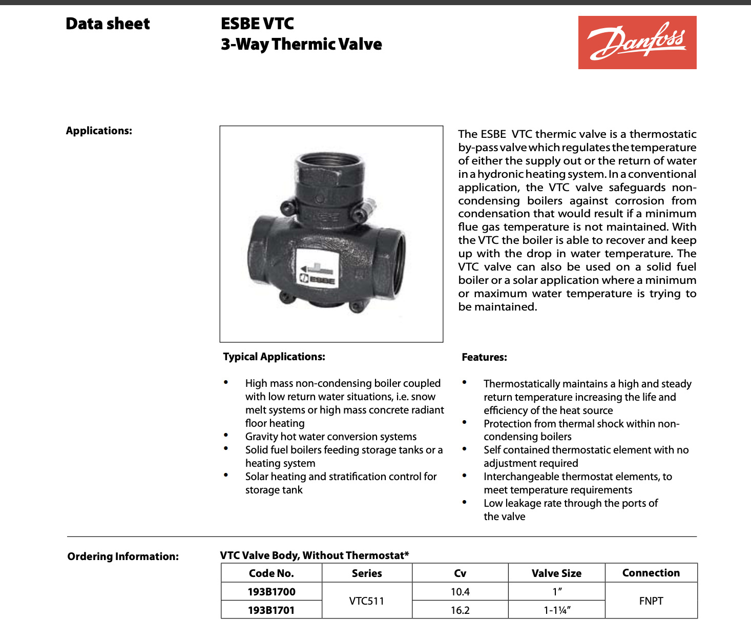

    If you need that full boiler output you are looking at moving around 48 gpm. That would take a sizable thermostatic mix valve, $$. Fixed temperature thermostatic mix valves from Caleffi or Danfoss specific to boiler protection go up to 1-1/4" 16 Cv. Too small for your application.

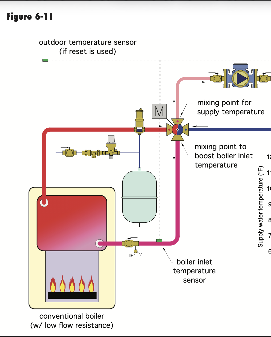

    One option is a 4 way motorized mix valve. A 2" tekmar valve has a 60 Cv, which means with a 60 gpm flow you have a 1 psi drop across the valve. I think the 1-1/2 is cutting it too close.
    The advantage to this valve is it protects the boiler but also allows you to modulate the temperature to the heat emitters based on an outdoor reset function.
    A 4 way valve give you two mixing points, one protects the boiler return, the other blends the supply based on outdoor temperature.
    A link to tekmar Info below on control settings and piping.
    Screenshot 2026-09-24 at 8.12.09 PM.png Screenshot 2026-09-24 at 8.18.39 PM.png

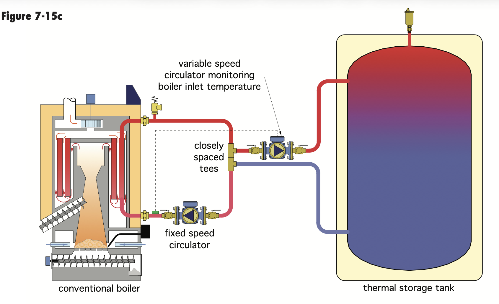

    A variable speed pump method looks like this, but it would take an additional pump able to move 45- 48 gpm, the 4 way may be less $$.
    In your case you would need a boiler circulator, the variable speed "crossover" circulator, and the pump(s) for distribution.
    This schematic shows a buffer tank as a load, so just two circulators. You still need a system pump or pumps
