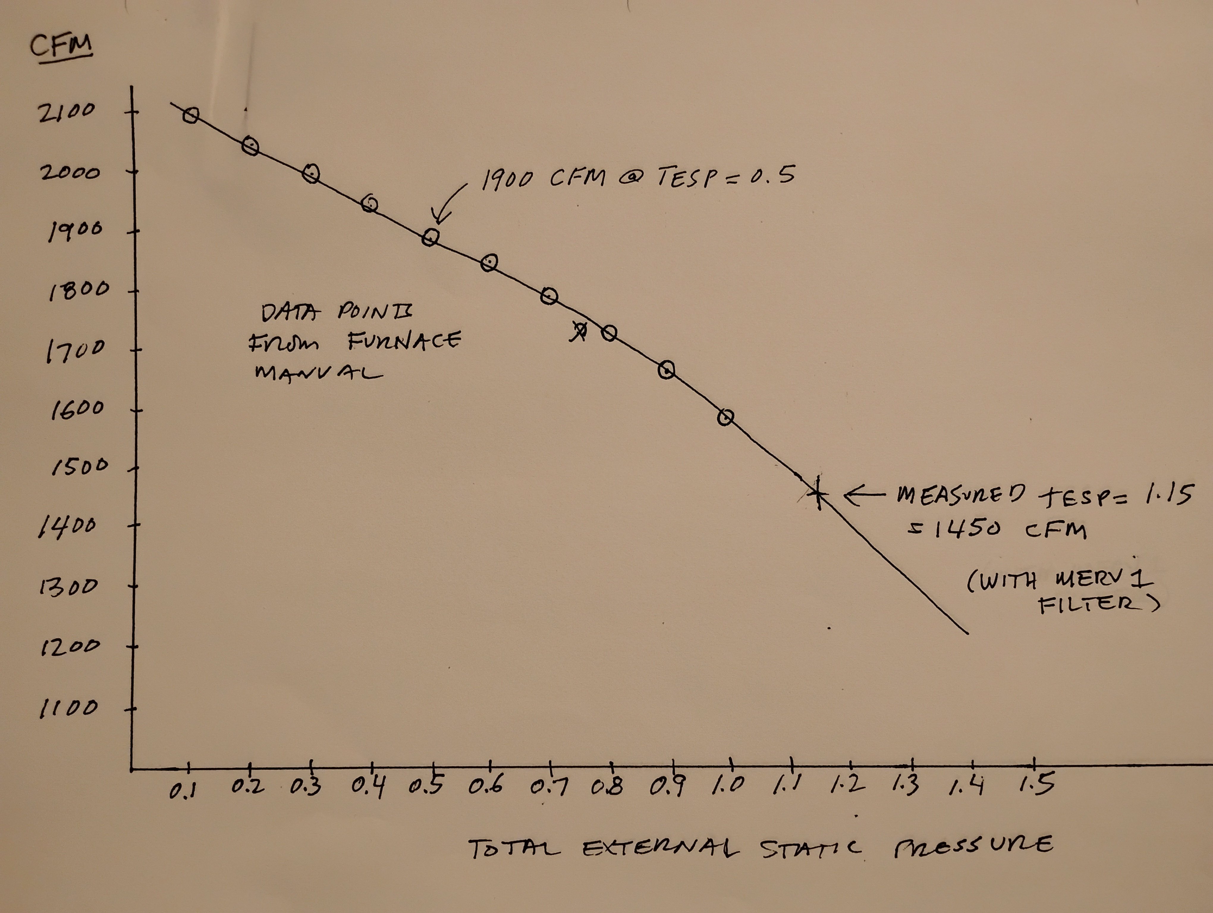

    An AC evap coil can add anywhere from 0.1 to 0.4 IWC or more to your TESP, depending on how clean or dirty the coil is. So at a minimum you're probably already at 0.9 IWC when you add in the coil, and possibly over 1.0.
    You can plot the data points from the chart of CFM vs TESP on graph paper, then extrapolate the curve beyond the 0.9 max they give you. It won't be exact, but if you approximate the curve you can get a good idea of CFM at your measured TESP.
    At some point the CFM's can get low enough that the furnace will start shutting down on high limit, which is not good for the heat exchanger if it happens repeatedly. We had that problem with our church's furnace, which turned out to have unacceptably high TESP because the installer screwed up the return plenum sizing. We had no recourse because there wasn't enough space in the furnace room for a proper-sized return plenum, so we were forced to lock the furnace in low-fire mode to keep it from overheating. So now our new furnace limps along at 40% rated capacity. But at least the ECM won't burn out.
    So if your max spec TESP is 0.7 and it's actually 0.9 or higher because the installer messed up on duct sizing, I would put the pressure on them to fix it. They'll say you can't prove the higher TESP caused the ECM to fail, then you say they can't prove it didn't.

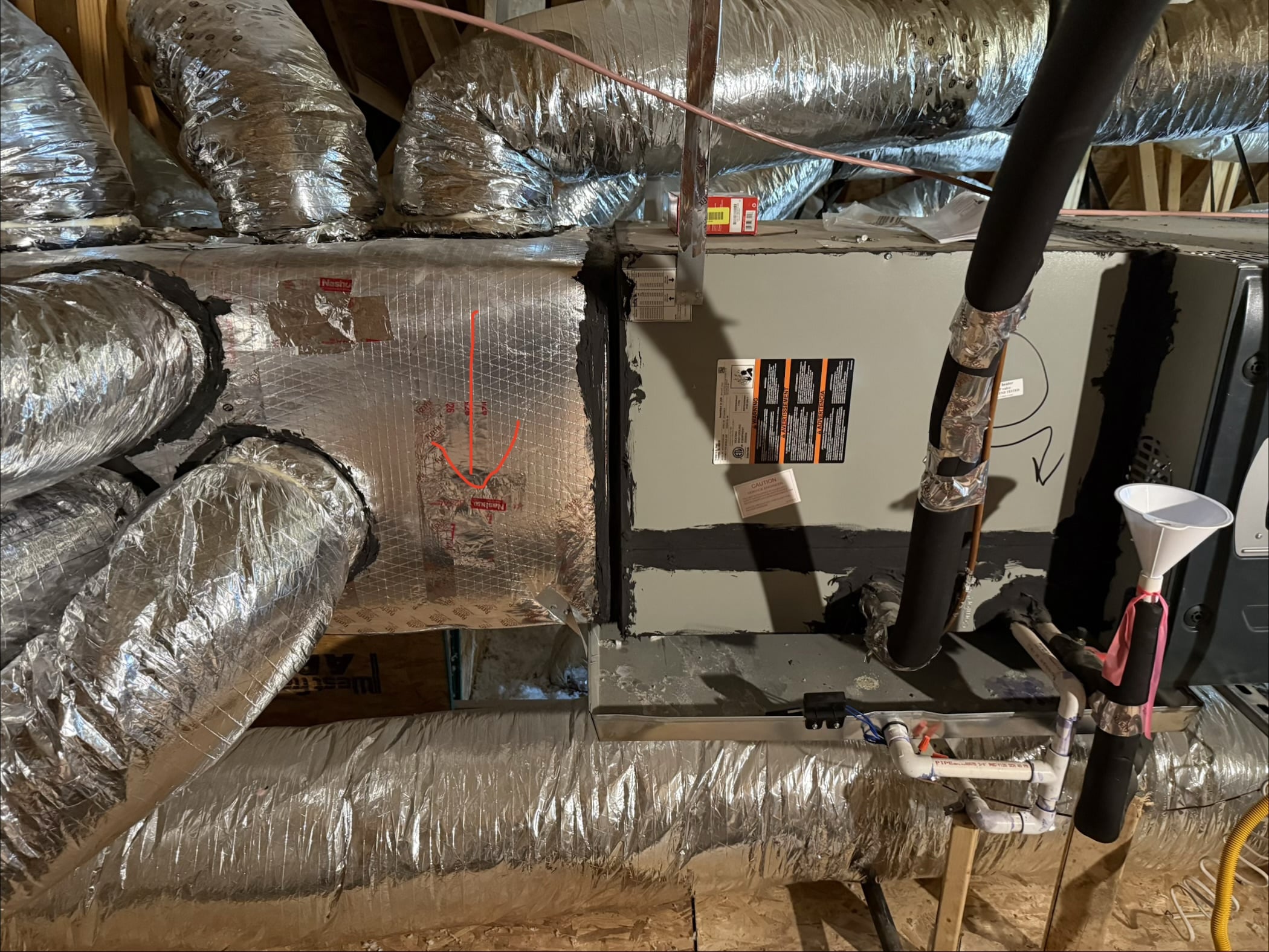

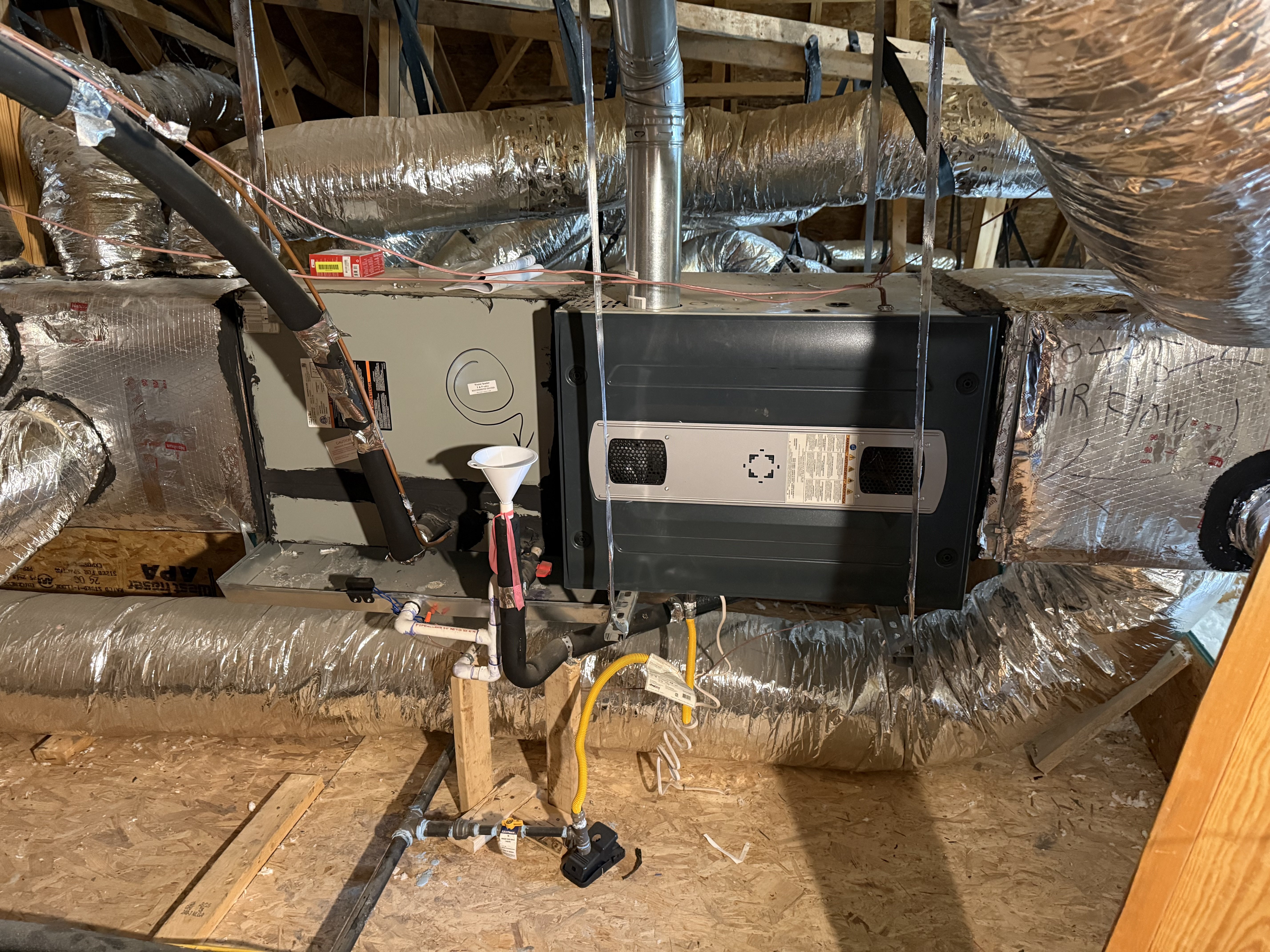

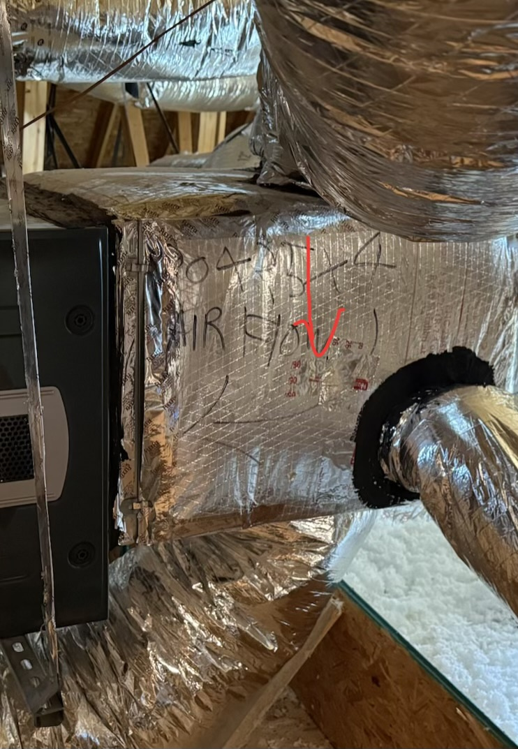

    @GW GW Here are the wider photos with the previous test locations marked.
    • Photo 1: full-system view for orientation.
    • Photo 2: red arrow marks the previous +0.45 in. w.c. supply-pressure test point. This point is downstream of the evaporator coil.
    • Photo 3: red arrow marks the previous -0.35 in. w.c. return-pressure test point.
    The airflow direction is from the return side on the right → furnace → evaporator coil → supply ductwork on the left.
    Based on these locations, am I correct that the +0.45 supply reading was not taken at the proper point for comparing furnace TESP to the furnace nameplate maximum?

    there’s no way with all that flex your TESP is only .8 !

    "Based on these locations, am I correct that the +0.45 supply reading was not taken at the proper point for comparing furnace TESP to the furnace nameplate maximum?"
    You are correct. They measured static for the supply downstream of the evap coil, which is incorrect and will give too low a reading. The correct place to measure static for the furnace supply is between the evap coil and the furnace. That is going to add anywhere from 0.1 to 0.4 to your TESP.

    Hmmm, return reading before or after the air filter?

  • GW
    GW Posts: 5,259
    wrong spots——that's the duct system he measured.
    Is there an air filter on the furnace or is that somewhere else?

    pecmsg Posts: 7,634
    I see a 1” Slot on the cabinet
  • GW
    GW Posts: 5,259
    doesn't mean there a filter there
    If there IS- wrong spot to test static

    @GW made a good point about the return static measurement point. There can't be any flow obstacles between the probe and the blower motor (eg filter, coil, etc), either on the return or the supply side, or the measurements will be wrong. So find out where the filter is and make sure they take the return static in a location where the filter is not between the probe and the blower motor. In addition to taking the supply static before the coil…
    As to your question about CFM's, the actual CFM's don't matter so much as long as you're getting adequate cooling and heating in every room, and as long as the furnace isn't overheating in winter or the coils icing in summer. I extrapolated my CFM curve more out of interest than necessity, and my conclusion was that at a measured TESP of 1.15 IWC we were probably getting around 1450 CFM's, which is 24% lower than the 1900 CFM's we would have gotten at a max allowed TESP of 0.5 IWC.
    That was a big enough discrepancy to cause our furnace to overheat repeatedly. But if you aren't getting overheating fault codes, then your CFM hit may not be as bad as ours was. Still, any TESP over your max allowable of 0.7 is a potential concern because of possible ECM overloading. And if/when the TESP problem gets fixed, your CFM's will automatically increase accordingly. So if you're comfortable now with the existing CFM's, you'll be comfortable after the TESP (hopefully) goes down.
    As to your question in the original post about "whether this is a genuine restriction issue that should be corrected or simply a higher-than-ideal but common operating condition," that's kind of a false choice. Anything above the max TESP rating of the furnace is technically a violation that should be corrected, but many HVAC companies rely on homeowner ignorance and don't care that the system they installed has a TESP of 0.8 when the furnace has a max spec of 0.5. As long as they don't get complaints, they don't care, and most of the time they get away with it.
    So anything higher than 0.7 for your furnace is a "genuine restriction issue" due to undersized ductwork, sharp turns, bad geometry, clogged coils, dirty filters, etc, that "should" be corrected. And the ECM doesn't care where the "correction" happens. It could be a lower-MERV filter, or cleaning the evap coils, changing some duct runs, adding a return, etc.
    You paid for a system to work as spec'd by the furnace mfr, which was a TESP of 0.7 max. Instead you got a system probably closer to 0.9-1.0 or more, so maybe 30%-40% higher, which probably fried one ECM and will probably fry more. Make them fix it.
    FWIW, here's my chart. You can see the curve bends down a little as TESP increases, so it's not linear, and as a result I had to eyeball the extrapolation. But it's not a huge non-linearity, so I think it's probably accurate to within 100 CFM or so.
