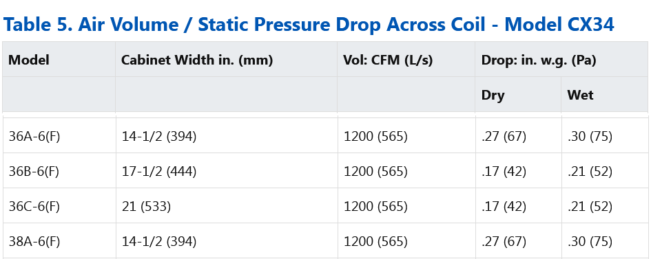

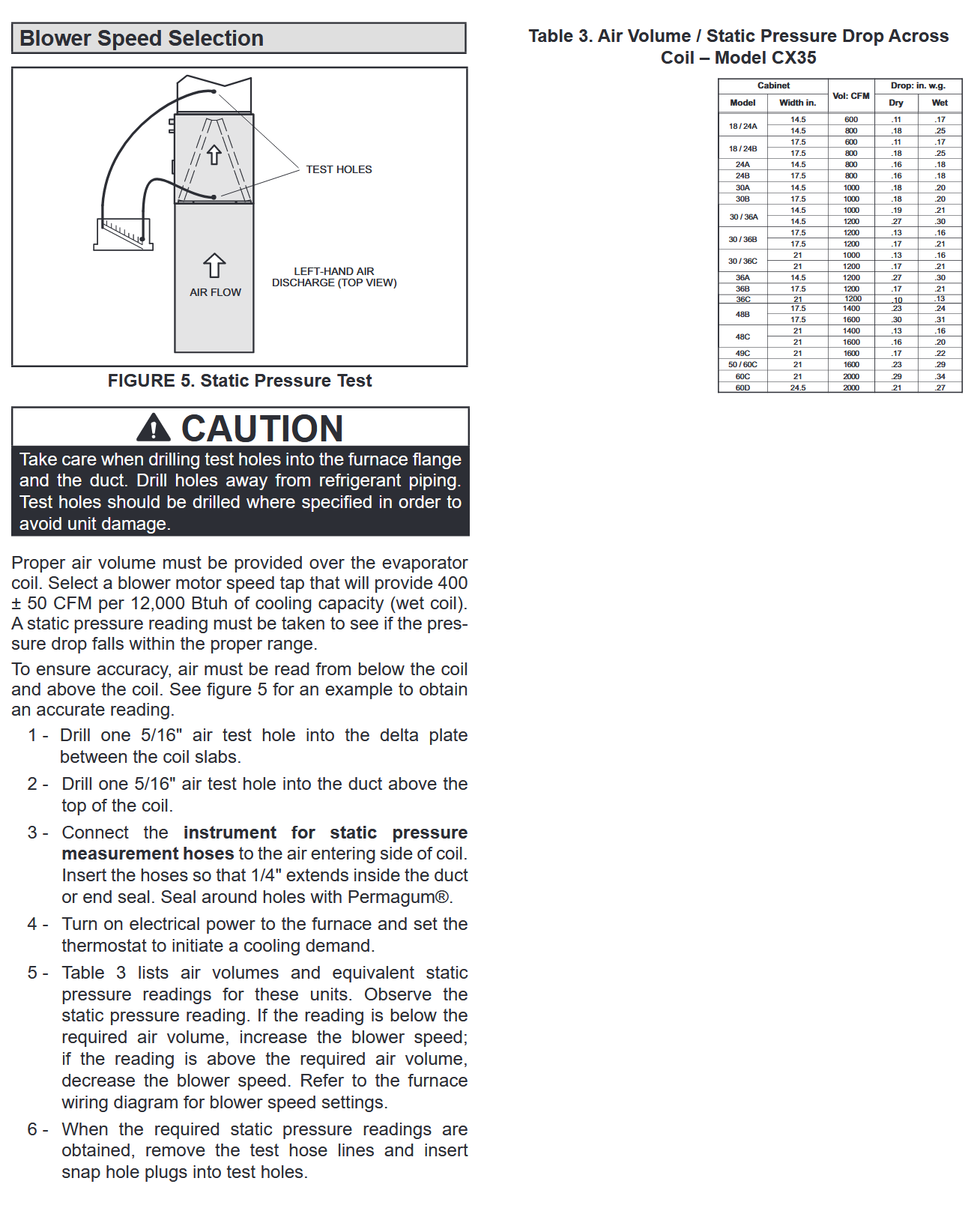

    The CX35 page had the test setup illustration. CX34-36C-6F spec. is below.
    https://www.lennox.com/dA/59d64ade9d/507167-03.pdf
    https://manuals.plus/m/94af1d579fdf7ff3cf00755778189d98d355dcd2e8581387b978a9fc0dc88a64

    Total External Static Pressure Testing - T.E.S.P. – Johnstone Supply Support
    Without it your only guessing.

    thanks for the responses. The unit is running at 100 low / 275 high 12 degree SC / 19 degree superheat at the compressor. The Coil delta t is 28 degrees, and the delta p across the coil is .12
    The esp for the system is .43 all the airflow settings are done through the Lennox wall thermostat. The display on the furnace says it’s moving 1400 cfm, but I have not found a way to verify that through documentation by Lennox. The customer has the same model furnace that serves another part of their home. That display in cooling says it moving 1050, and by sound the fan just sounds like it is moving more air

    That's a calculated # not an actual reading. A little dust on the coil, a little dust on the blower wheel and the CFM's drop dramatically.
    You need to measure the actual TESP to know what the actual CFM's are.

    thanks for the responses. ESP is TESP, and the TXV is from Lennox that is non adjustable
    I spoke with Lennox today and there is no chart available for the furnace to compare the ESP reading on a chart to determine that actual cfm the furnace fan is moving. This to me seemed strange.
    the good part is there is long section of straight duct with no registers that can be traversed to determine the actual cfm. For some reason the motor is just not ramping up, even though it is getting the proper signal. Lennox also recommended that if the motor is changed, the furnace circuit board also be changed. This to me also seemed strange and expensive.
