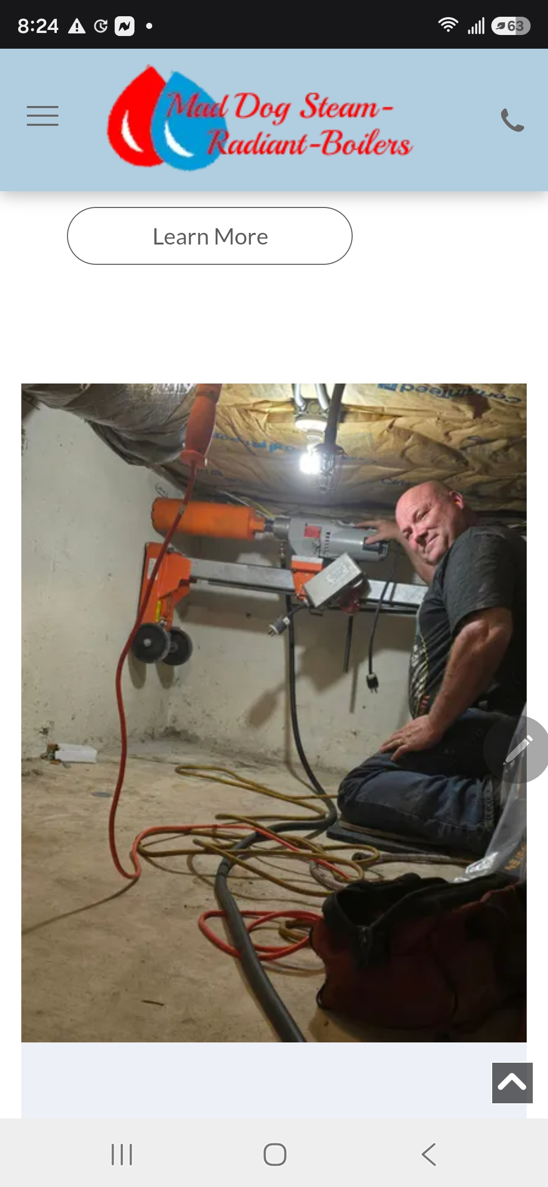

    Cores will go through any reinforced concrete, brick, block, rubble, it leaves a neat hole and does much less damage to the building and the body. Much faster too. Mad Dog
