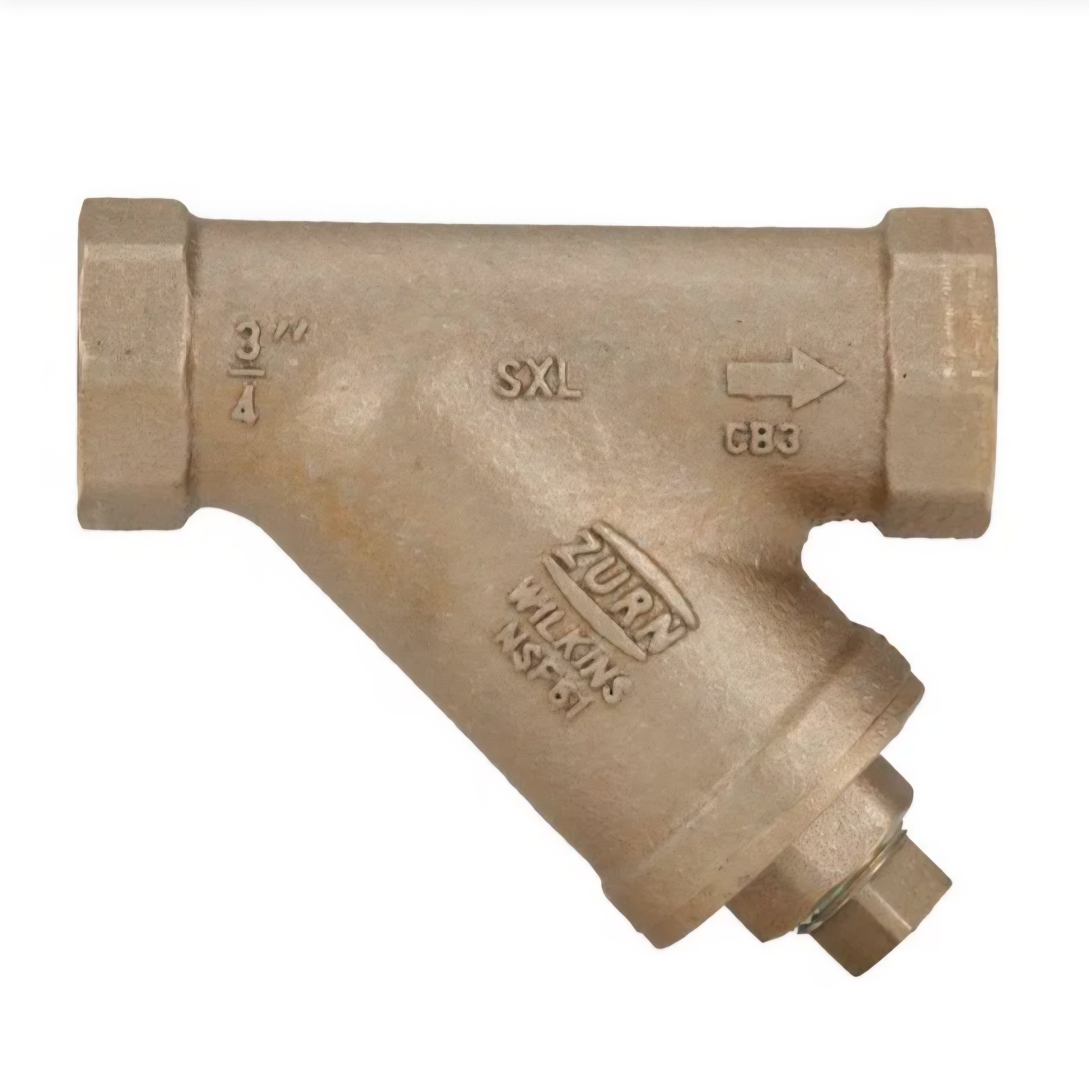

    There should be two aquastats. One on the indirect, and one below the water line in the boiler. If the indirect is set to 120°, then the boiler aquastat should be set to 180° with a 20° differential. 160° minimum if you want good recovery. No wye strainer on the indirect loop?
  • Bob_57-2
    Bob_57-2 Posts: 37
    boiler aquastat is set to 160. Not sure I have a wye strainer. Is that what's combined with the ball valve? (see pic)
    HVACNUT Posts: 7,784
    A wye strainer will help save the circulator.

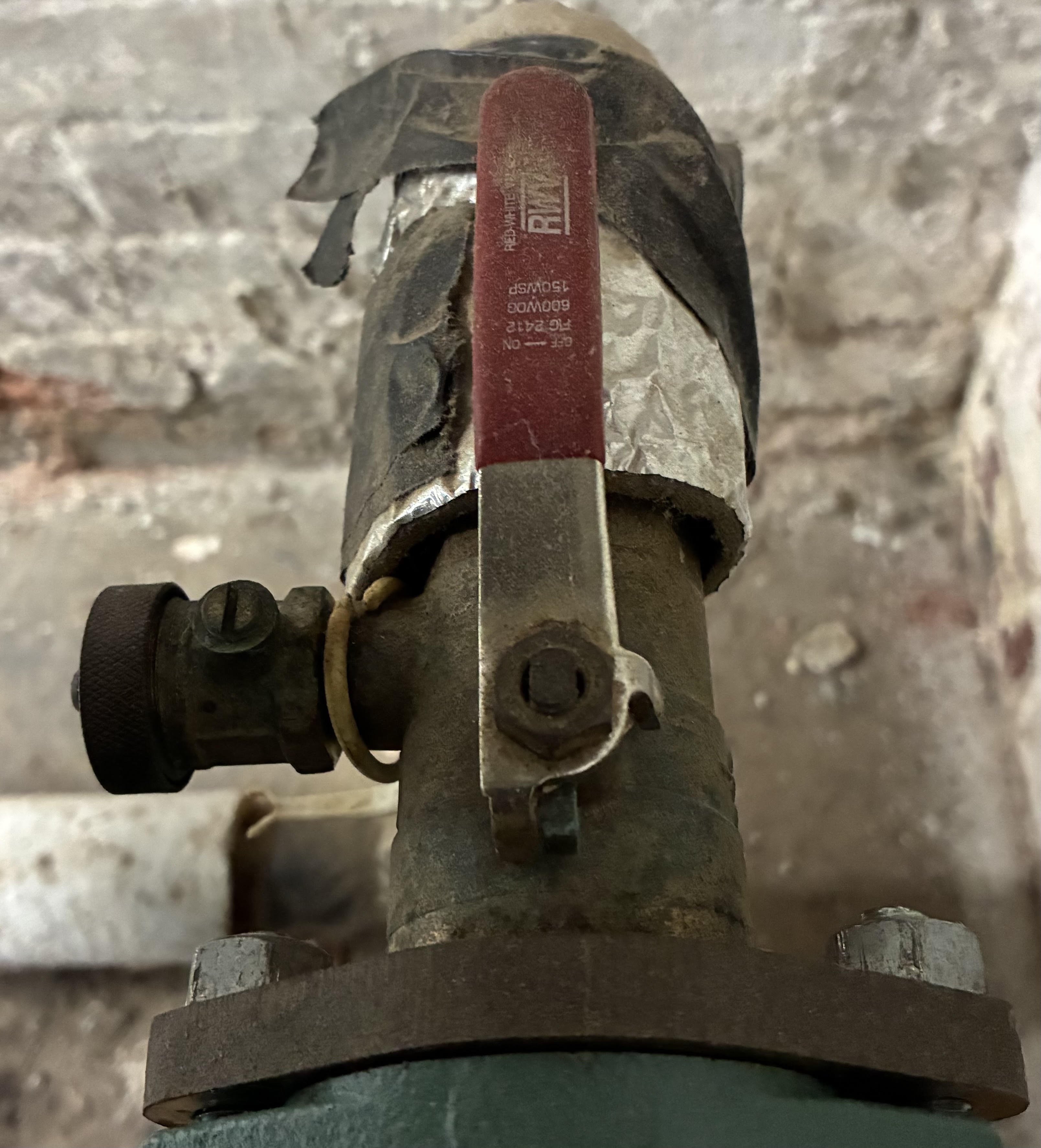

  • JUGHNE
    JUGHNE Posts: 11,653
    The picture with your ball valve shows what looks to be a purge valve connection to purge air out of that circuit.
    The screwdriver slot runs a ball valve inside the small connection.
    They usually do not move very well after a few years unless they are exercised every year or so.

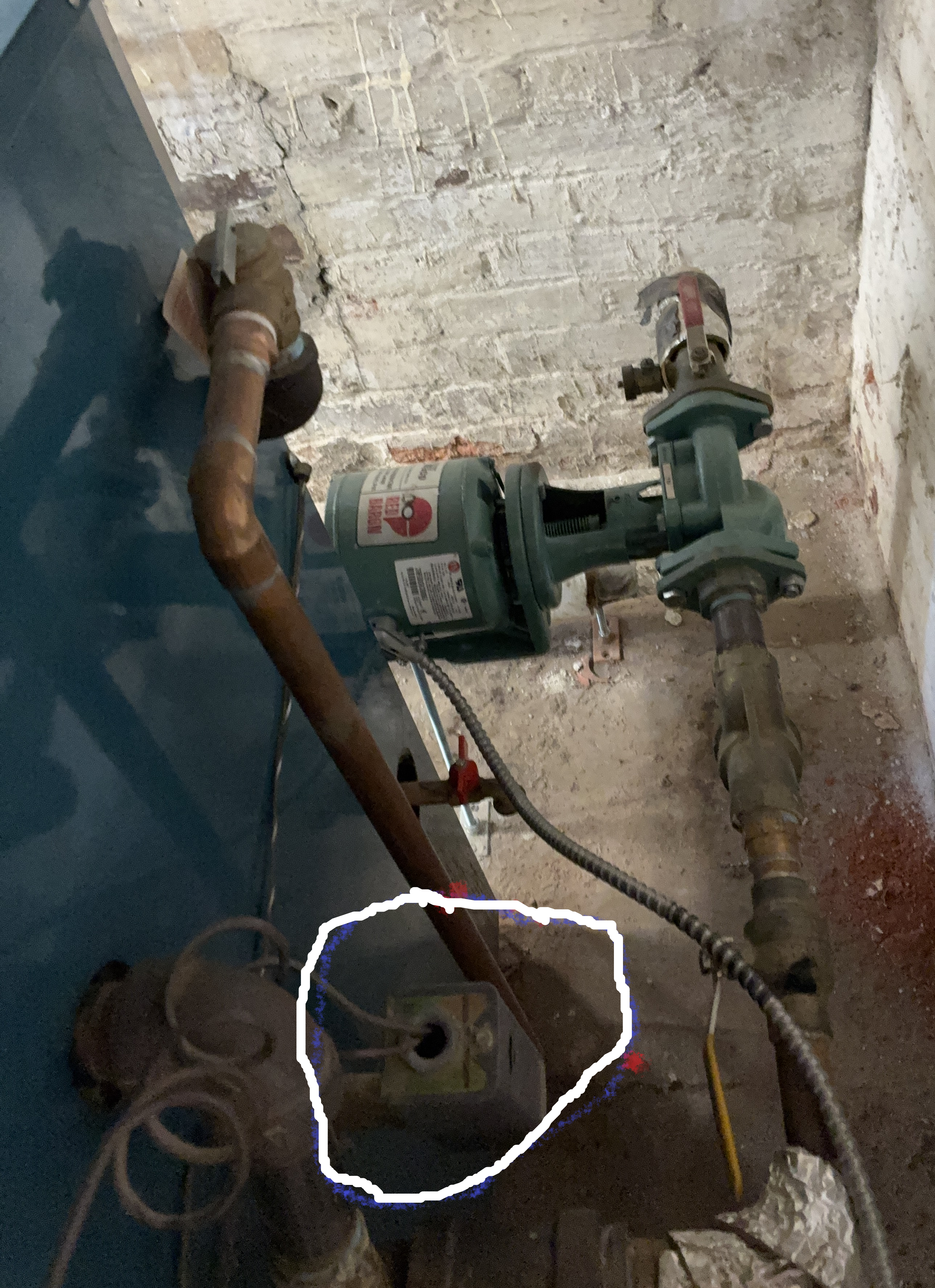

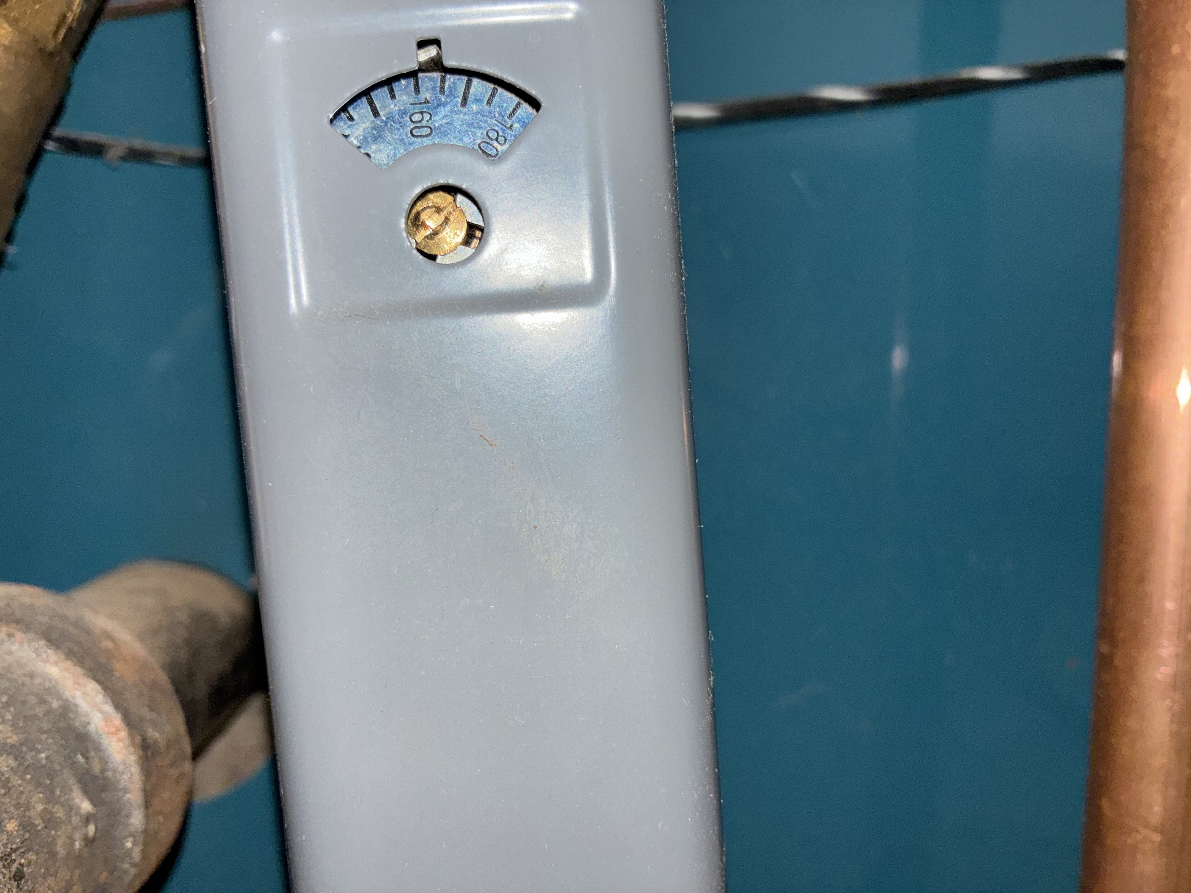

    Picture of the aquastat.
    HVACNUT
  • Bob_57-2
    Bob_57-2 Posts: 37

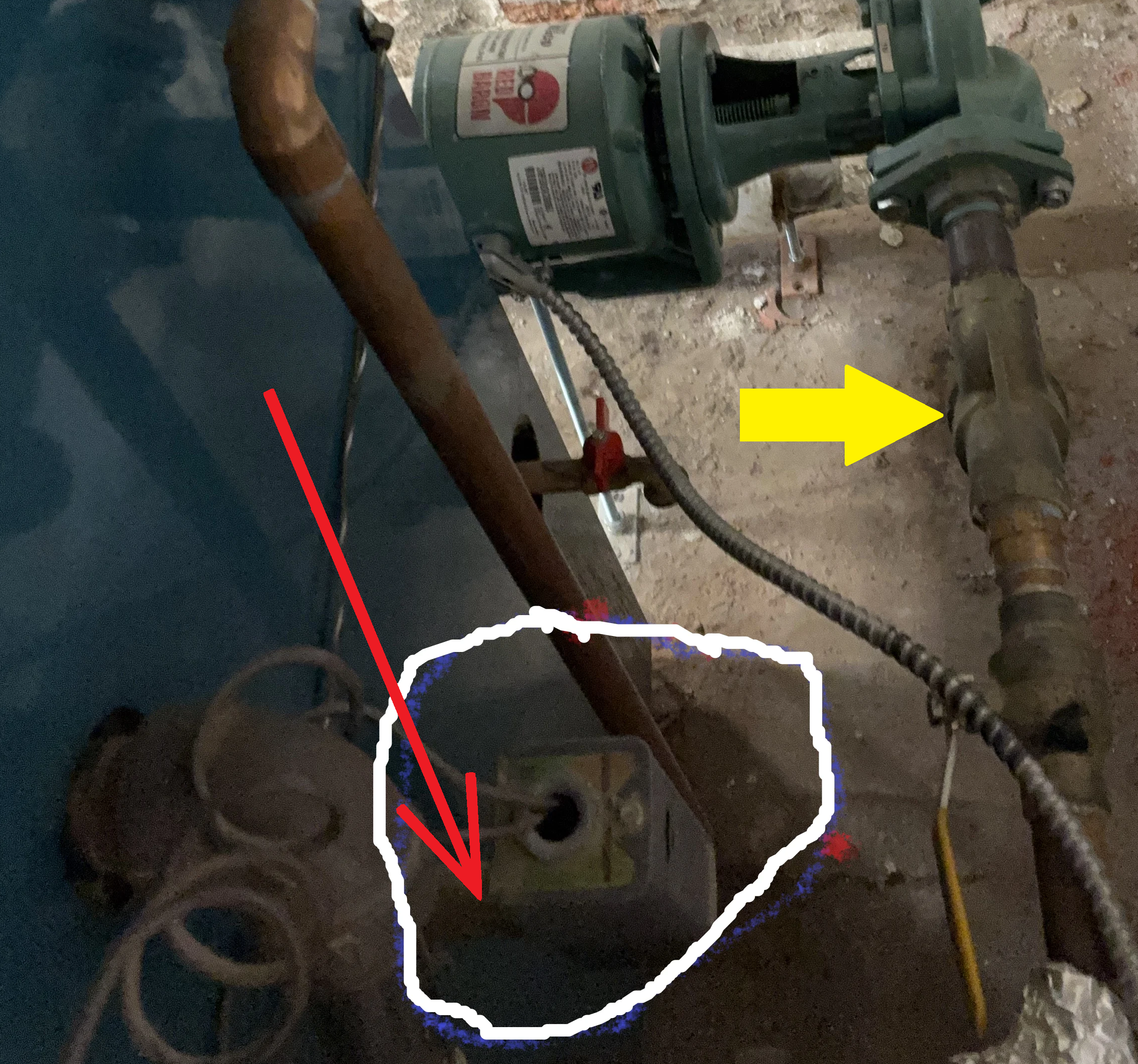

    thanks. Here are some pics of the aquastat: view of where it's mounted on the side of the boiler with the circulator and a front view of the Honeywell 4006
    109A_5 Posts: 4,759

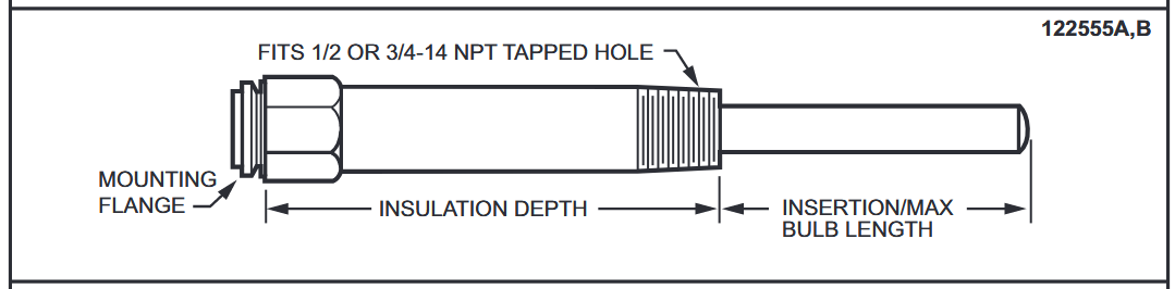

    Looks like you have a Wye strainer (Yellow arrow). Has the strainer been cleaned ?
    Could the temperature sensing part of the aquastat on the boiler (Red arrow) be above the boiler's present water line ? So the aquastat can't properly sense the boiler's actual water temperature.

    The reason I don't think the temperature sensing part is above the water line is because this problem just began sometime over the past 12 months. The therm usage has gone way up sometime since last fall (hard to tell in the heating season) but the aquastat has been there for 15 years.
    Thanks for pointing out the Wye strainer. I'll have to check with the plumber to see what's done. It's not on their boiler checklist for the annual maintenance.

    A restricted strainer can reduce the efficiency of the recovery process. So longer recovery time. And if the boiler's aquastat is not working correctly the boiler's water temperature is not limited like it should be in the summer. Using more fuel, and more heat going up the flue.
    You mentioned " at least on one occasion I heard air coming from a radiator vent. " To me if you are moving air you are making steam. Your system should be no where near making steam in the summer time. Other than some odd cold weather.
    So to me the question is why is the Boiler's water temperature rising way above the set point of the aquastat ?
    1. The aquastat is defective. Not shutting the boiler's burner off at the 160 degree set point.
    2. The aquastat can't properly detect the boiler's water temperature. With summer operation the boiler's water usage is minimal not like the dynamic usage during the heating season. You have not shown the rest of the boiler so who knows what is going on on the other side. The boiler's water could be excessively low, but I would think (hope) that would have noticed by someone by now.
    3. Wiring error or an electrical defect with the switching relay. But why would that just start for the summer. And the system basically behaves normally, so I don't think that is very likely.
    So possibly a restricted strainer causing longer recovery time. Since I would guess the Boiler's BTU rating is greater than the system can transfer the heat into the indirect tank, so the boiler's water temperature will continue to rise if not limited by the boiler's aquastat. The boiler's water temperature would rise faster with a restricted strainer. So the longer the recovery time the greater the boiler's water temperature will rise, and eventually making steam on longer recoveries.
    Or the strainer is fine and the boiler's water level is fine and the boiler's aquastat is simply bad, not limiting the boiler's water temperature to 160 degrees in the summertime.

    2. The boiler water is not low. The sight glass has been at the halfway mark for years. I have an autofiller. Last winter (very cold here in New England), it added one gallon to my system to maintain that level.
    3. There was a wiring error 15 years ago when the system was installed. But it was corrected and it's only this past year where the gas usage has gone up about 50% in the summer.
    My water bill data is heavily influenced by summer temps and my use of my irrigation system. So I rely on my gas usage data and the fact that our time away from home this summer was comparable, if not greater than, last year. No out of town guests and it's just my wife and me in the house. Use of the gas range has been typical.
    A defective aquastat seems the most likely culprit.

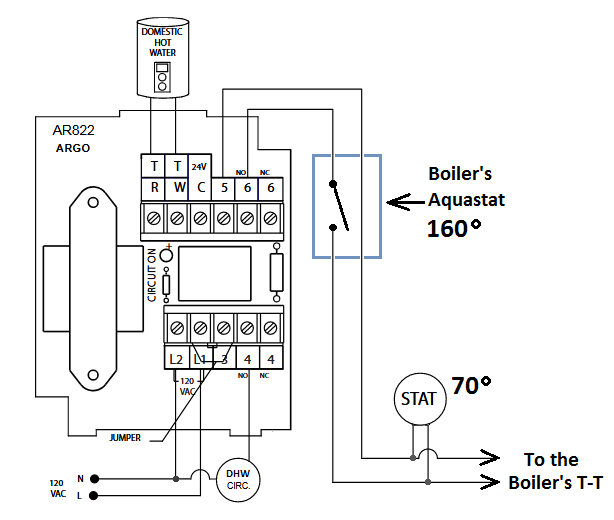

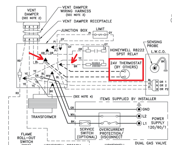

    Inspect the wires to the boiler's aquastat, if they are erroneously touching that would prevent the boiler's aquastat from shutting off the burner when the water temp reaches 160 degrees.
    Do you have a multi-meter ?
    You could test the boiler's aquastat. Using the space heat thermostat to control the boiler, as the water warms up but before steam is generated the aquastat's switch should open consistently with each time the boiler is warmed up.
    If the aquastat's switch has continuity when the boiler is producing steam the aquastat is defective.
  • Bob_57-2
    Bob_57-2 Posts: 37
    I have a multimeter. Are these wires 120V or low voltage?

    if my theory is incorrect, and you are flowing 100%, my next theory would be the wye strainer is gooped.
    and your 140 setting may not be working well. Try turning it down to 120 or even 100. The aquastat may be losing its gas. You will have to experiment- once the boiler is heated up it will take hours for it to cool down and try again.

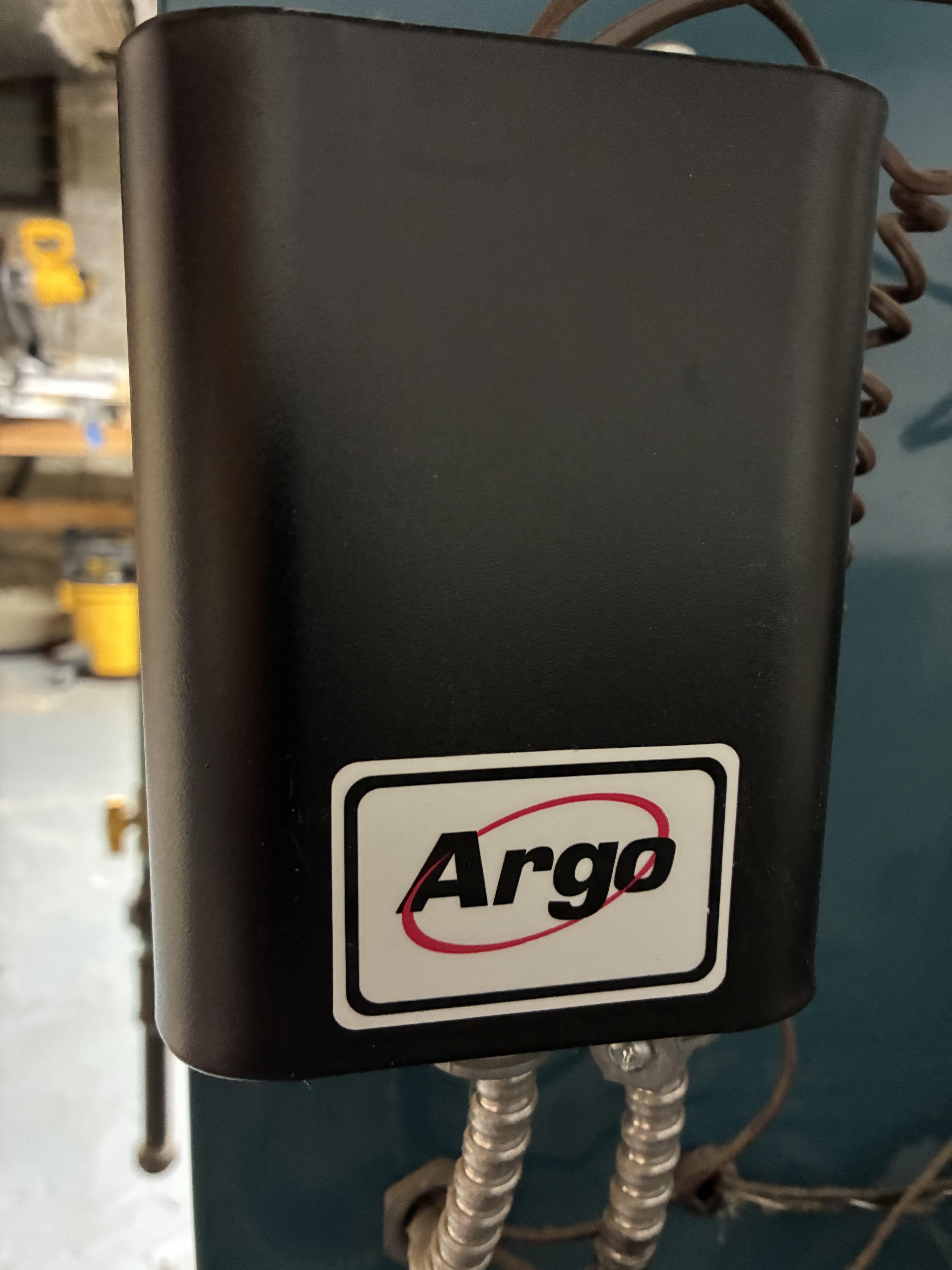

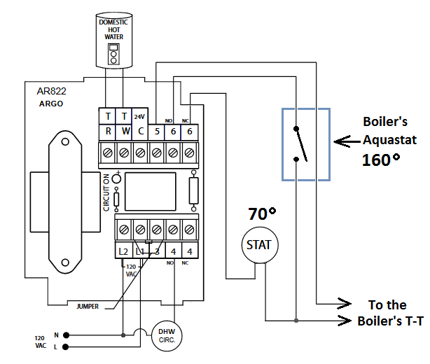

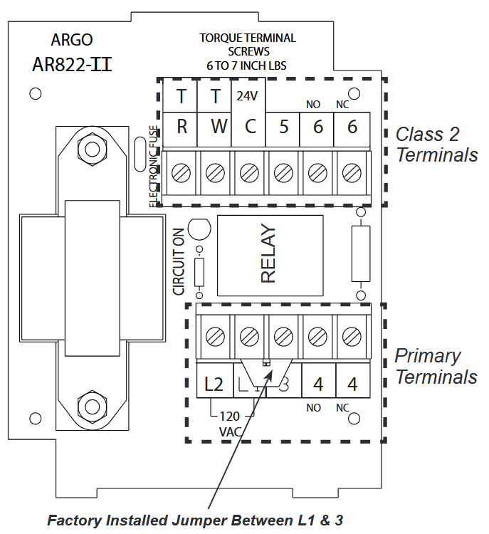

  • Bob_57-2
    Bob_57-2 Posts: 37

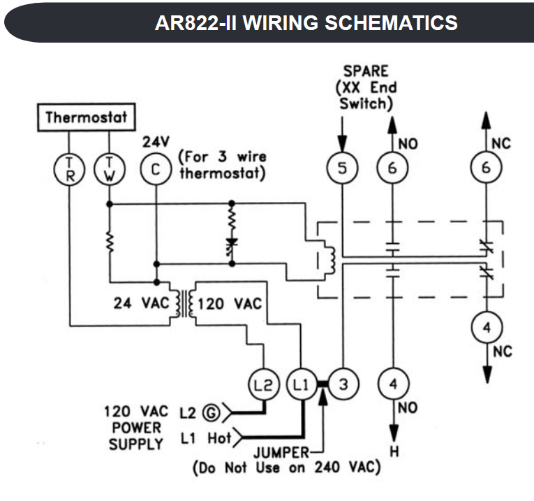

    What role is the Argo relay playing in this setup? One of the wires from the Honeywell aquastat goes to the boiler, the other to the Argo.

  • GW
    GW Posts: 5,259
    Bob that’s the relay control- it takes the low voltage signal from the tank’s aquastat and enable the circulator to operate and the boiler to fire up. I would suspect that is working normally
    The boiler aquastat should be wired in parallel with the heating thermostat. The aquastat for the indirect should go to the Argo relay along with the circulator wiring. Two seperate animals. The Argo relay has a 120 volt power source with a 24 volt transformer. All the Argo does is turn on or off the circulator based on water heater tank temperature. It has no way of controlling boiler temperature. The aquastat in the boiler does that. It should always keep the boiler water at 160° less the differential.

    The boiler's aquastat looks like it its 24 VAC wiring. There are many ways to verify the boiler's aquastat's functionality. You could generate a long DHW (Domestic Hot Water) call for heat eventually the circulator should remain running and the boiler would shut down. You could disable the power to the circulator to speed up the process, disconnect the Argo relay's terminal 4 120 VAC to the circulator. Be safe shut the power off to the boiler when making any wiring changes.
    With that Argo switching relay I would suspect the system is wired like this.
    The space heat thermostat goes to the Boiler's T-T terminals, which looks like it may be a Brown and a Blue wire (see below).
    The "Spare XX" relay contacts of the Argo relay (two wires) with one side going through the Boiler's aquastat (in series), is also connected to the boiler's T-T wires.
    So a space heat call for heat fires the boiler as long as there is a space heat call for heat making steam. This does not use the Argo relay.
    When there is a DHW call for heat, the Indirect's aquastat closes which is connected to the Argo switching relay's "Thermostat" terminals TR and TW in the drawing below. This does a few things, it energizes the Argo relay, which in turn powers the circulator motor for the entire DHW call for heat, and also closes the "Spare XX" relay contacts firing the boiler. In the summer the boiler's water temperature is limited by the boiler's aquastat which is wired in series with the "Spare XX" relay contacts. So if either the "Spare XX" relay contacts open (DHW call terminated) or the boiler's aquastat contacts open (aquastat's set temp reached) the boiler's burner will shut off.
    The space heat Thermostat could be wired through the 24 VAC side of the Argo relay (terminal 6, NC) to provide a DHW priority to help minimize circulator cavitation. That would let the Boiler's water cool down to the boiler's aquastat's setting during a DHW call in the winter. All depends on how savvy the person was that wired up the system.
