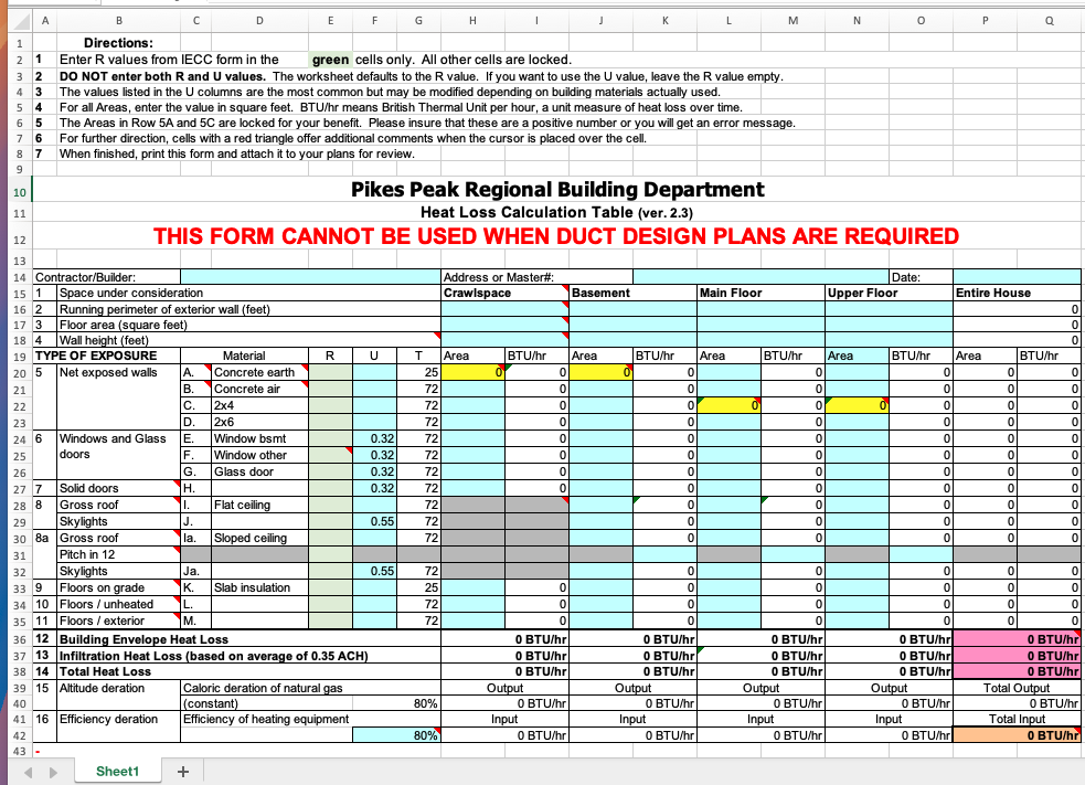

    look for the heat Load calculator here in Excel format
    https://www.pprbd.org/Download/ResidentialHandout

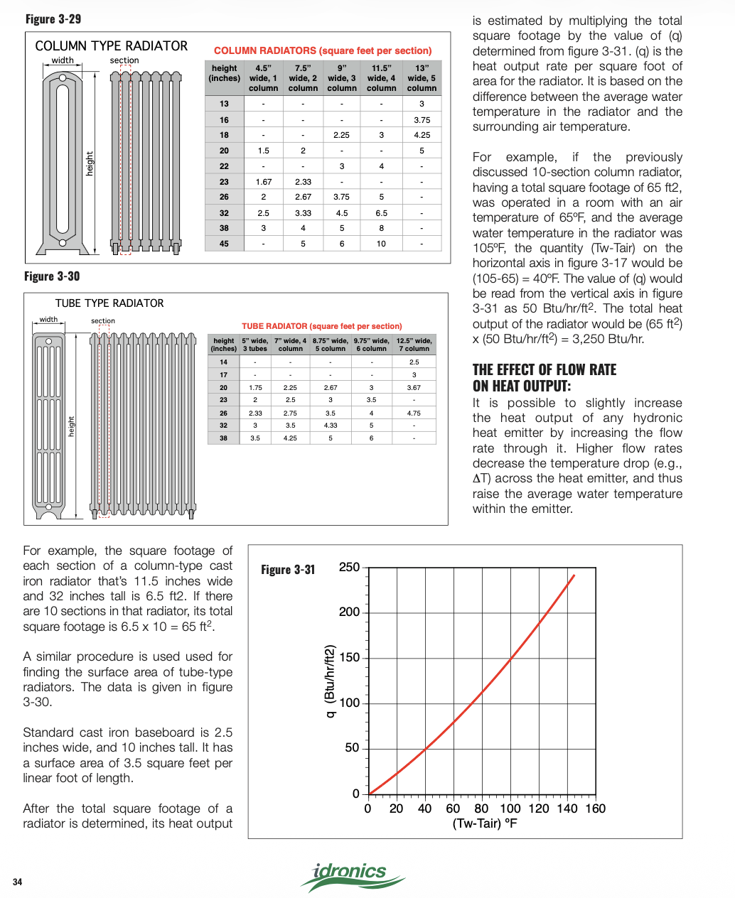

    If you know the heat requirement of a space and you know the EDR of the space, it's direct: the heat output of the radiation, for each square foot of EDR, is very closely related to the temperature of the water feeding the radiation; as a first approximation, the heat output in BTUh per square foot is equal to 1.4 times the water temperature -70. Thus, if you are running your hot water at 180 F, the heat output will be 1.4 times (180-70) or about 150 BTUh per square foot of EDR.
    Or going the other way, if you need say 10,000 BTUh in a certain space, and you have an EDR of 47, you will need to run the water at 180.

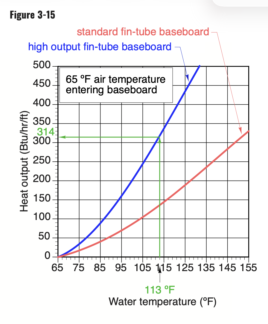

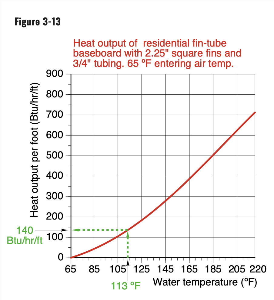

    hot_rod Posts: 28,562
    Here are some derate graphs for fin tube and ci radiators
    Screenshot 2026-09-05 at 8.12.59 AM.png Screenshot 2026-09-05 at 8.13.17 AM.png Screenshot 2026-09-05 at 8.13.46 AM.png

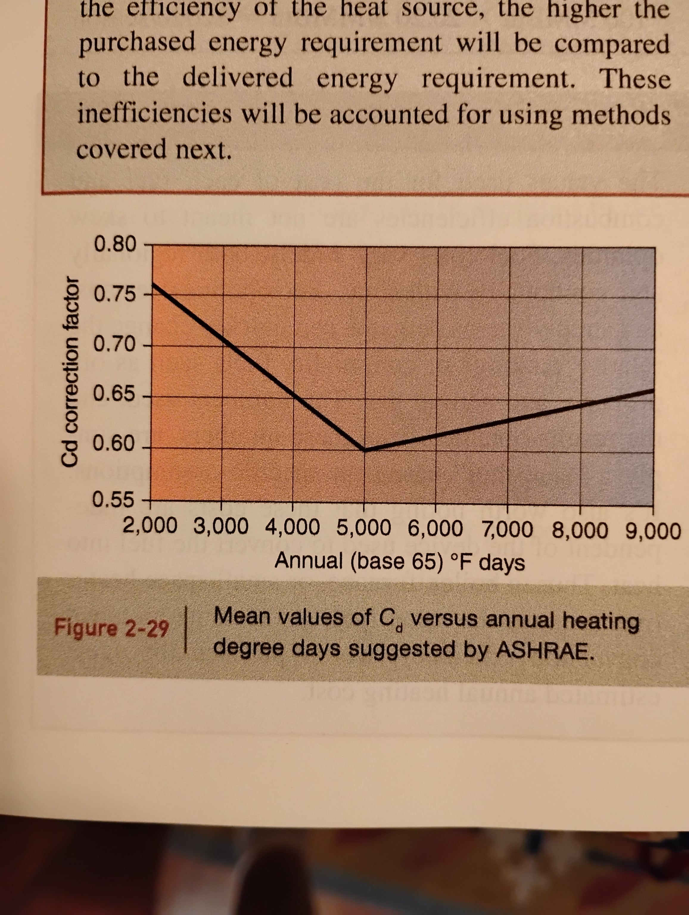

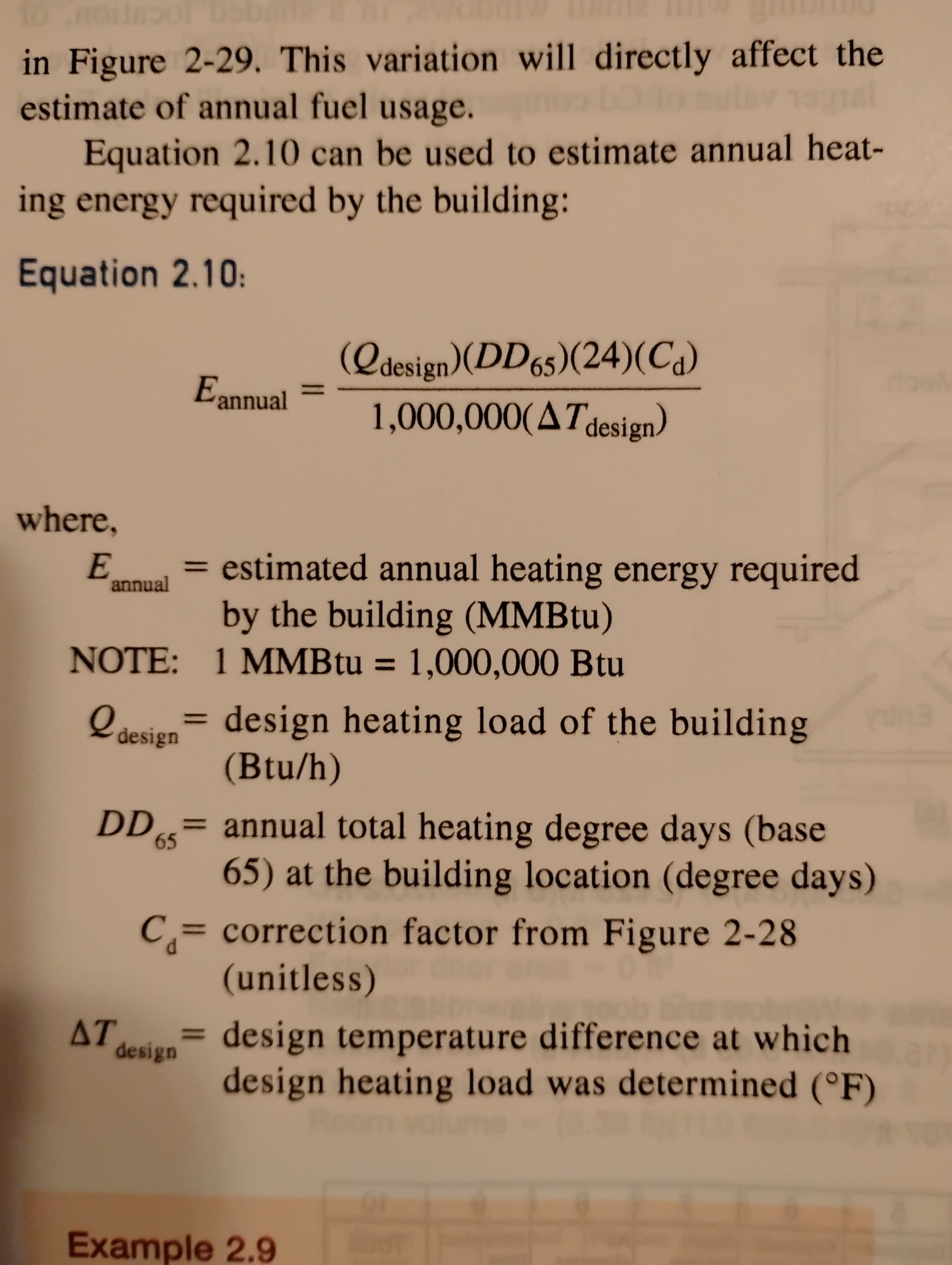

    @Bawstin You're on the right track with your heat loss calculation based on annual energy consumption, but there's a correction factor you have to apply because the annual energy consumption is not linear with HDD's. The correction factor is the "Cd" in the equation below (from Siegenthaler's Modern Hydronic Heating & Cooling, pg 44). Cd is a unitless correction factor that can be pulled from the graph below based on the number of HDD's in your location. For your 4109 HDD's, the graph gives a Cd of about 0.65. So you need to divide all the heat loss numbers you derived using the same equation but without the correction factor by 0.65. That puts you around 50,000 BTU/hr, which for 1600 sq ft = 31 BTU/hr/sq ft. Which is believable for a leaky 100-year-old house in your zone.
    It's also possible your old boiler was running at lower cycle efficiency than you think, meaning that (for example) if your real overall efficiency was, say 65%, then your actual heat loss was closer to 40,000 BTU/hr. I'm guessing it was in fact running closer to 65% because of low water volume in those baseboard loops probably causing short-cycling. So figure 40,000-50,000 BTU/hr, or 25-30-ish BTU/hr/sq ft, which sounds reasonable.

    Ok, do I have this correct:
    If I use 70% efficiency, from my post above.
    E Annual is what I am solving towards.
    Q design = 29461 (using 70% efficiency - from my post above)
    DD 65 = 4109 (not sure if I understand the "65" part of this, and the "65" is involved - needs to be the same? - in the correction factor)
    Cd = 0.65
    and
    T design = 55 (70 outdoor degree - 15 indoor degree = 55, for my location)

    @Bawstin Not quite. You got the right answer but by a backwards path.
    Start with a known total annual energy consumption (543 gal) and then "derate" that by your assumed boiler efficiency, because you know that, say 30% of that total consumption was wasted up the flue, and only, say 70% of it went into your house.
    So your total annual energy lost through the building envelope, E(annual), was:
    543 x 139,000 x 0.70 = 52,833,900 (at that assumed efficiency, which you can vary as appropriate)
    Then you want to solve for design day heat loss Q based on the above E(annual) and your other parameters:
    Q = (52,833,900)(55)/(4190)(24)(0.65) where the 0.65 is your Cd correction factor (which confusingly has nothing to do with the 65 in HDD65, it's just a coincidence.)
    So Q=44,457 BTU/hr as your design day heat loss at a delta T of 55 F.
    And you can redo the math assuming different boiler efficiencies. The worse your boiler efficiency was, the less energy actually went into the house as useful heat, and therefore your calculated Q design day heat loss goes down. But 70% assumed efficiency is probably close enough.
    Then how do you use that calculated Q of 44,457 BTU/hr? First, remember that it's not exact. @hot_rod came up with a WAG worst case of 48,000 BTU/hr just based on square footage and probable heat loss per sq ft in a house of your vintage. Your calculated Q is quite close to that, and therefore probably reasonable.
    Then ASHRAE recommends sizing heating equipment to 1.4 of the design heating load, which gives you around 62,000 BTU/hr. So I wouldn't go higher than that. But obviously if you get a mod-con, oversizing doesn't matter so much because it can modulate down to 10%-15% of output.
