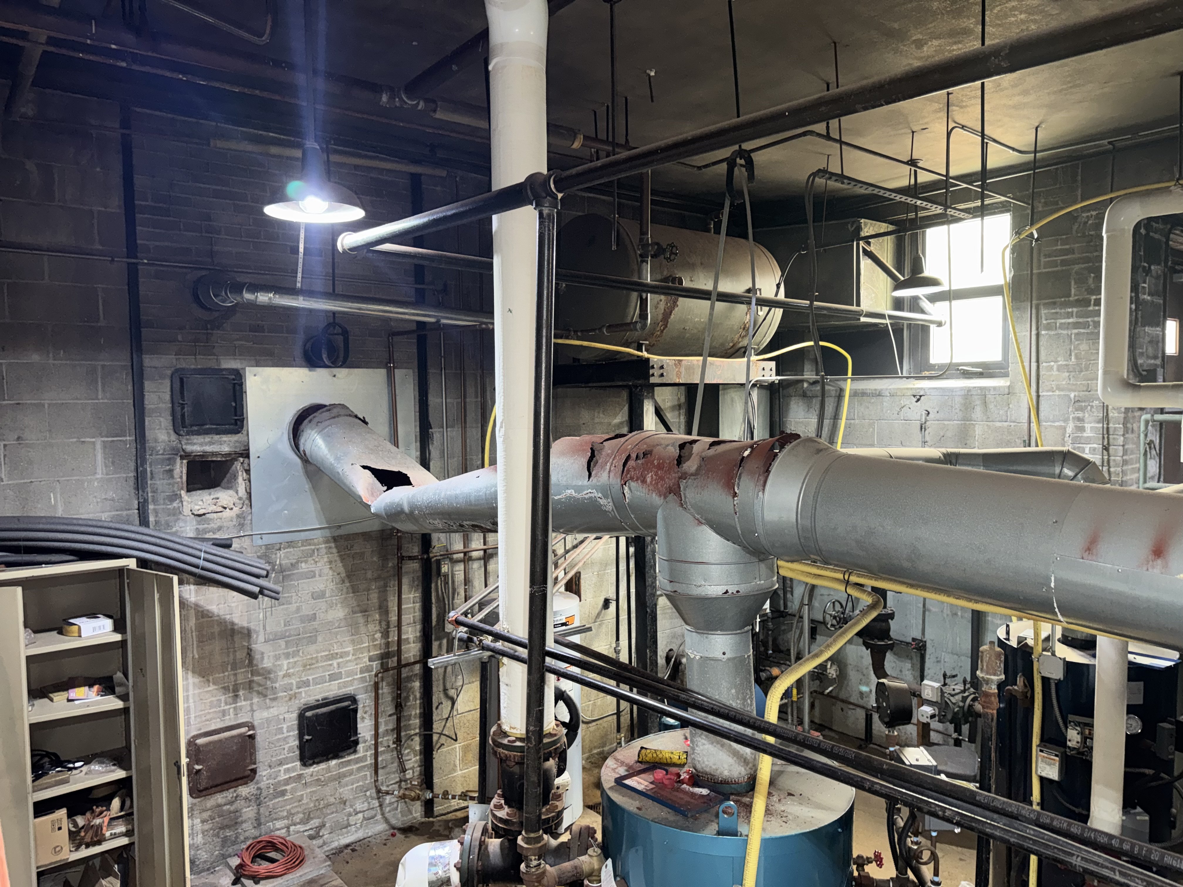

What caused this on a boiler flue?

This had to be one of the scariest boiler rooms I ever saw. The customer was incredibly lucky.

    Nothing like a little acid condensation in the combustion gases…

    hot_rod Posts: 28,699
    poor draft, too long of a horizontal run?

    Big Ed_4 Posts: 3,585
    Looks like hot water heater has been leaking or under fired…

    @RayWohlfarth lol, maybe a little too scientific. I imagine the carbon monoxide detector must have been going off?
    I've never seen a leak that bad and left that long. I've seen similar stuff happen when the chimney gets partially clogged and then condensation sits and builds up and tears the bottoms open.

    Steamhead Posts: 19,007
    I'd say condensation too. On a run that long I would have used double-wall pipe.

    leonz Posts: 1,994
    OUCH, that is downright nasty Ray!!
    I wonder if that water heater has a water leak in the scheme of things?
    EBEBRATT-Ed Posts: 21,328
    Looks reasonably ok until it gets to the WH so I think that is the issue.
    I am going to say too long of a horizontal in relation to the draft available. Equipment too far from the chimney.
    Moving the equipment or maybe a separate flue for the water heater

    Had a job checking a side wall venting Lochinvar mini-fin boiler and had to crawl in a space on the other side of the wall where the blower vent was. When I got there the installer had used standard gauge single wall venting. The venting had more holes in it than Swiss cheese. Barely got out of there the CO was so high. I ask the renter whose bedroom wall was on the other side of that crawl space if he had any headaches. He said that he woke up every morning with a headache. Concentration & Duration, gasp.
    The big problem was the boiler was next to the washer and dryer. Excessive acidic condensate did the job. I replaced the venting sys with stainless steel venting and brought in fan assisted outside combustion air that turned on when the boiler fired.
    Sometimes simple mistakes can be a killer. Be careful out there.
    PS. Also installed CO detectors.

    Bob Harper Posts: 1,189
    Blocked/ inadequate chimney; long, possibly oversized vent connector without slope; inadequate makeup air; took boiler(s) offline leaving venting grossly oversized; lack of professional maintenance, especially combustion analysis and most importantly, INSPECTION!
    Honorable mentions may include corrosive ambient chemical warfare, boiler leaking into combustion chamber, and grossly under firing.
    So Ray, what was the body count? Seriously, I've seen disintegrating vent connectors worse than this in homes with everyone still alive. They were surprised when I connected their recent mysterious 'allergies', mood swings, irritability, kid's grades dropping, and general malaise to this. Sadly, this kind of disaster is often right out in the open, yet seemingly intelligent adults walk right past it for years without a thought. Now, if a service tech had been in there during the first signs of trouble, he's got something to worry about depending upon how long ago that was.

    RayWohlfarth Posts: 2,091
    This was the worst Ive ever seen They are two vertical fire tube steam boilers. The boiler tubes were leaking and the combustion chamber filled with water and it poured out of the burner mounting plate. Its a mess
    They don't have CO detectors and Im not sure of any health issues.
    This is what happens when you lose a lot of water from a steam system and don't fix the leaks.

    I see no draft hood on the water heater!
  • Volatile organic compounds from hair salons or dry cleaners mixed with a flame will eat galvanized for breakfast!!
    What draft hood?
