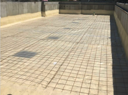

    Spray foam and mesh

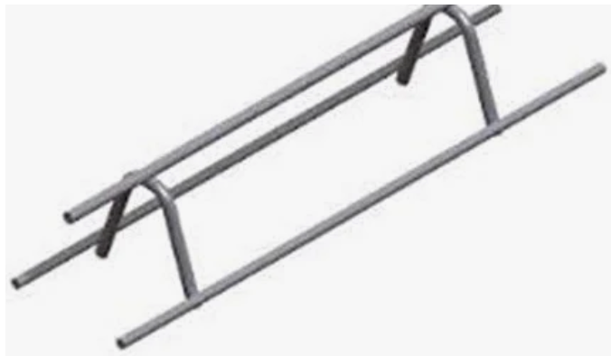

    Here are some options. These are continuous strip bar chairs, 5' lengths. These work well for rebar, but even with heavy gauge 6X6 mesh, it will still sag even with these every 2'. And they are $$

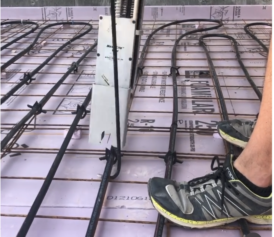

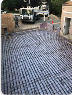

    On my own slab poured recently I used small blocks of 1" foam under the 6X6 #6 mesh. The mesh comes in sheets 8x16 or 8X20' panels. Tube 6" on center makes a big difference in response and very low supply temperature needed. Ideal for heat pump slabs.

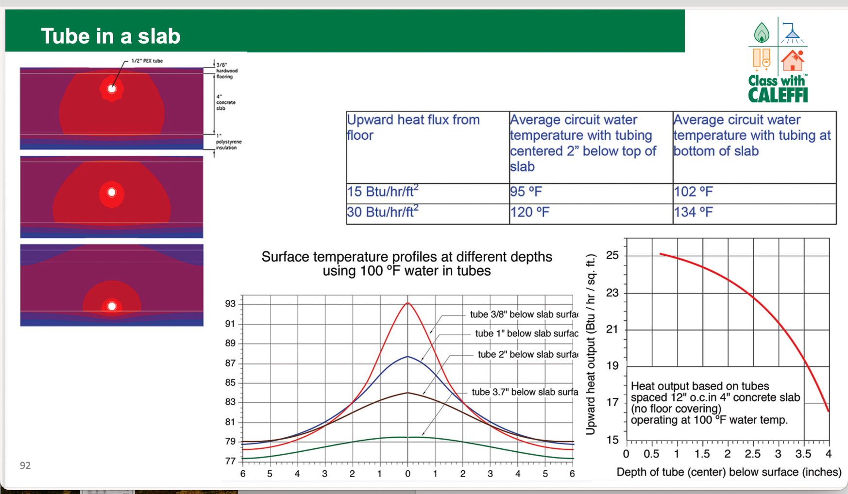

    Do your best to keep the tube into the slab, at the bottom of the pour you will not get the concrete under the tube very well. Response and required SWT takes a hit with tube at the bottom of pours. See the output graph below.
