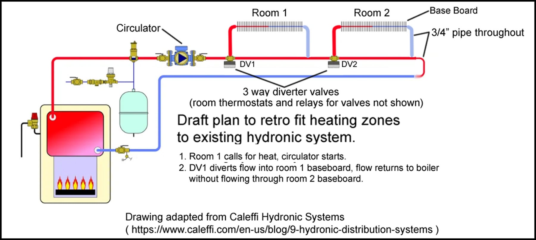

Retrofit single-zone hydronic baseboard to 3 bedroom zones with 3 way diverter valves.
Hi everyone,
I am looking for some advice on zoning the upper floor of my 1980 raised ranch. Currently, the entire upper level (containing three bedrooms) is on a single, oil-fired hydronic baseboard loop. My goal is to give each bedroom its own independent heating zone. I am considering installing 3-way diverter valves on the baseboard for each bedroom along with additional piping.; This would be paired with dedicated thermostats, relays, and the necessary controls. I have attached a diagram of my proposed layout
My questions for the community:
  • Is this a viable approach? Better way?
  • Are there better or more efficient alternatives for zoning a setup like this?
I appreciate any and all constructive feedback. Thanks in advance! You guys re great!
  • Yes, It is a viable approach . I would try to fit the Diverter Valve and the new bypass pipe (to the next baseboard unit in the next bedroom) within the existing baseboard end caps. The bypass pipe can run below the finned element in each baseboard unit. Providing power to the diverter valves is another issue I'm not sure how to address but it's low voltage so it's easier than 120 VAC and its code requirements. The only other approach I can think of now would be to have each baseboard supplied directly by a home run from the boiler with a 2 way zone valve and a common return pipe. Don't know if you have easy access to run PEX tubing in place of copper ( a cost savings). You would need to build a small manifold at the boiler with 3 zone valves and 3 returns. All wiring would be located at the boiler and you could use smart thermostats like Ecobbe with a wireless remote temp sensor in each bedroom. This eliminates the need to run thermostat wires in each bedroom. Can you do this type of work yourself or do you need a heating guy? There are two costs: 1) for the piping and valves and 2) the electrical for the valves. Doing either one yourself is a big cost savings. My experience is that it's cheaper to just get a good plumber to do the work as you designed it rather than a Heating Contractor with his overhead costs. PEX is easy to work with and much cheaper than copper. I assume you need to have big differences in bedroom temperatures to justify the cost of this work. Do you have un-occupied bedrooms that can have a low temperature? A rough ball park cost would be about $1000 in material ( valves, transformers, thermostats, pipe and fittings) and maybe $2000 in labor( based on your location). There is one negative factor in that you may have a lot of boiler short cycling because of the small size of each zone. In the ideal world, you would install buffer tank to reduce the short cycling. Also, how is your insulation in your 1980's home. If you are looking to save on heating costs with this zone design, would the money be better spent on improved insulation and windows. Just a thought. Good Luck.

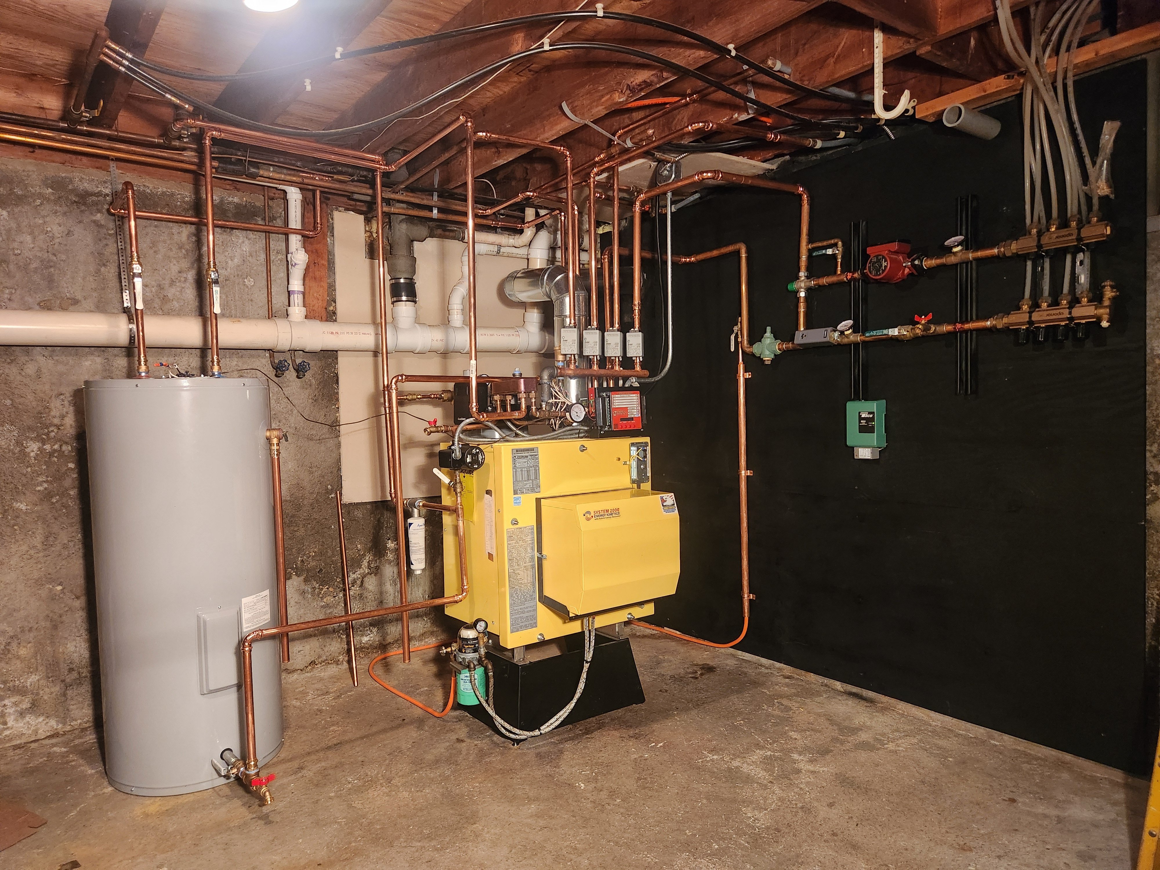

    I still have 4 zones, but I don't worry about micro zoning anymore because I just installed this.
    Almost done. I just have control wiring and some touch up left.
    You either need a buffer tank or a modulating boiler because of the microzoning.

    I don't see an advantage to the 3 way valves? A 2 way at each baseboard does the same?
    Any way you could balance the system instead of micro zoning? Those single room zones will not be friendly to the boiler cycles. You may trade one issue for a worse issue if the boiler short cycles and runs cold returns?
    I would think all the 3 way valves would add up to a large Cv and be restrictive. I agree with 2 way valves but with 3 bedrooms on 1 floor do you really need this?

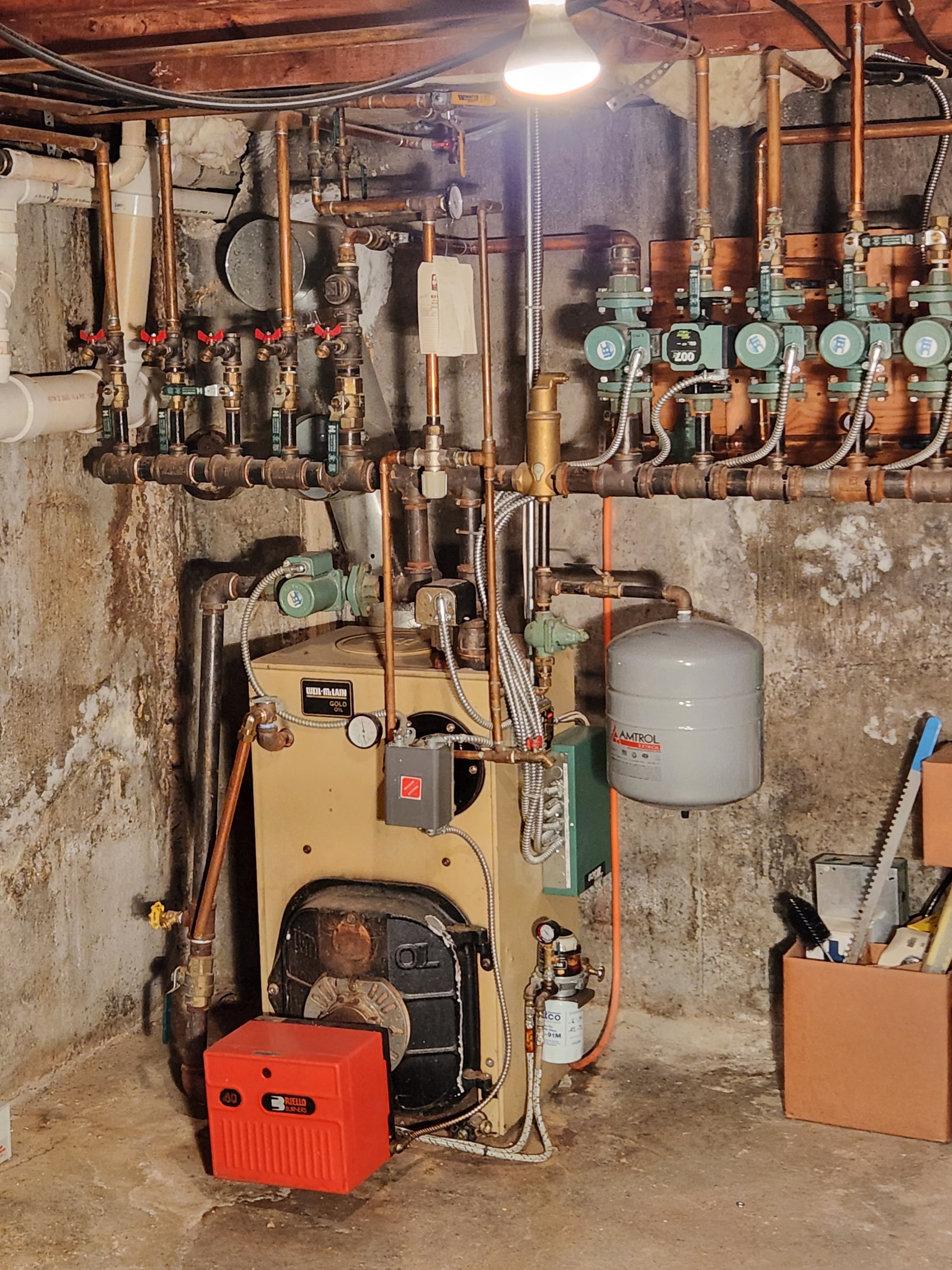

    • Boiler: 1992 Burnham oil-fired boiler with a Beckett burner. Two zones with individual circulators (upper/lower floors). Hot water is supplied by an Amtrol Boilermate.
    • Current Fuel Use: ~500 gallons of heating oil per year.

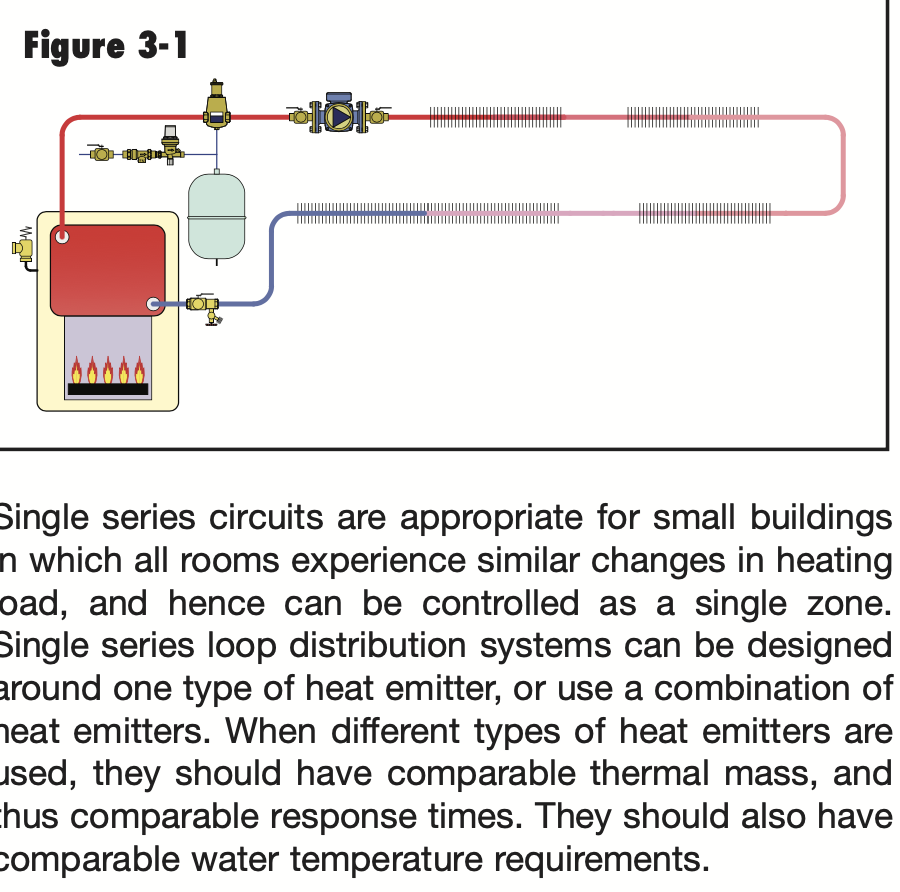

    It depends on how it is pipes, as far as zoning options.

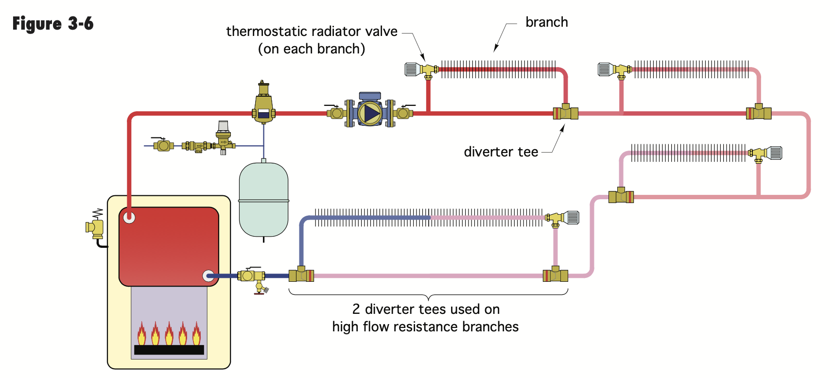

    Most common in small homes is a series loop. Figure 3-1
    With fin tube, you can regulate heat output in various rooms by adjusting the damper opening. Or put aluminum foil over some of the fins to limit output. A cheap way to djust room by room without zoning.
    Screenshot 2026-08-26 at 11.47.00 AM.png Screenshot 2026-08-26 at 11.47.40 AM.png
    A monoFlo or diverter system is another method found in older homes Figure 3-6. If you have this system TRV thermostatic radiator valves can be added for individual room zoning.
    With a series you cansplit off a zone by addingdiverter tees. Then a thermostatic valve.
    Nice about TRVs is they do not require wiring.
    Most zone valves are the dimension to fit inside standard fin tube enclosures if you want to zone with a 2 way.

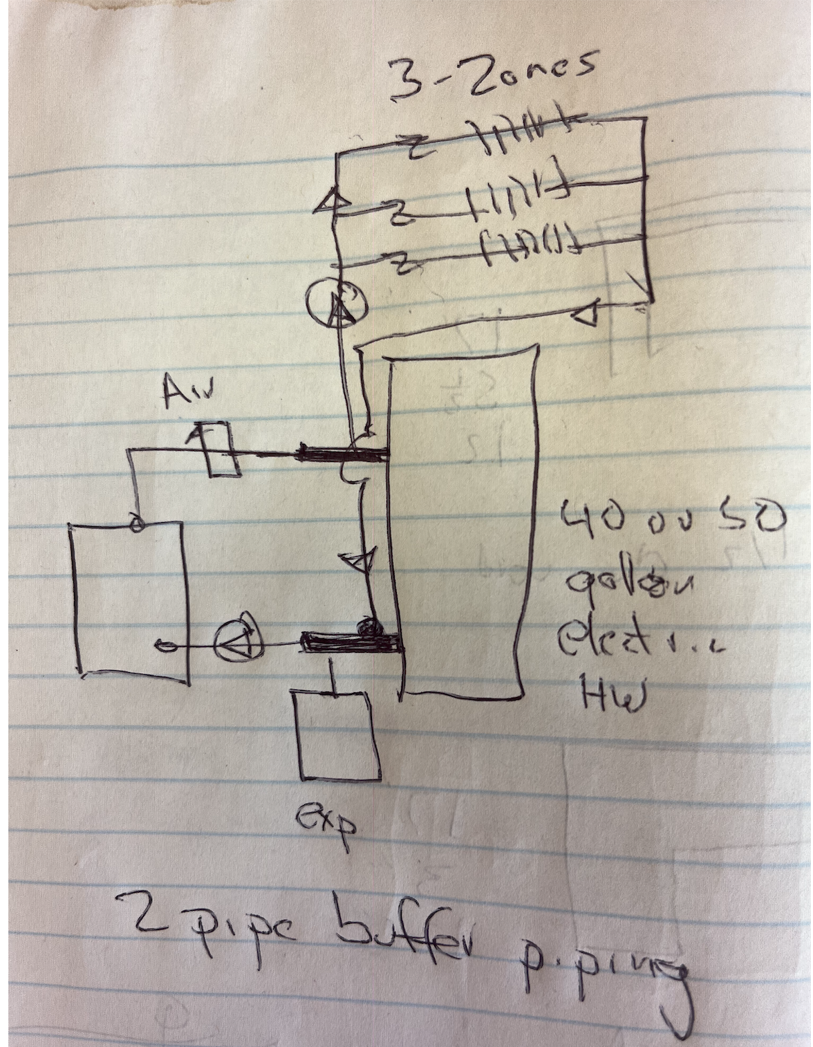

    Here is one method I have used to add a common 40or 50 gallon electric HW tank as a buffer.
    Replace the two elements with 1" pipe nipples connect boiler and zones in at the tank nipples. A setpoint control monitors the tank temperature and calls on the boiler. About as simple as it gets.
    Util we know exactly what piping you have for the fin tube, tough to answer your question about options. Rarely do you need a 3 way ZV.

    An electric water heater that isn't connected to power probably is the most cost effective way to get a buffer tank unless you need more tapings. A plain steel or glass lined steel tank will last a very long time in the closed side of the system because there is no fresh water with fresh oxygen entering the system to corrode the tank.

    You guys are really going to laugh at this question….On the system with TVR's on the baseboards, what turns the circulator on and off - where is the call for heat?
    Also, do you have a recommendations for 3 way diverter valve and wireless wall thermostats and relay.

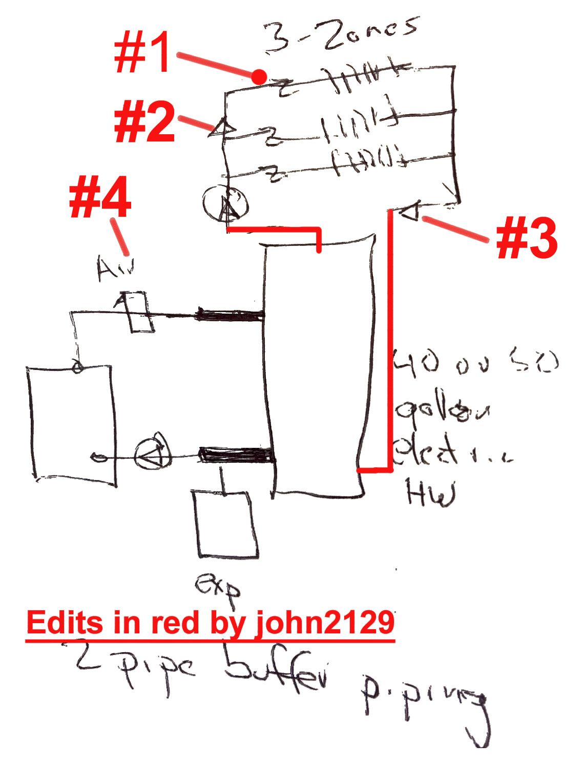

    Hot Rod – thanks for taking the time to do the sketch. See my edited version – have I got it right?
    #1 – is this a standard zone valve?
    #2 - what is this?
    #3 - what is this?
    #4- Is this an Auto Vent?
    Thanks

    hot_rod Posts: 28,704
    pretty much all the new systems use ECM circulators with any type of zone valve or trv
    The pump senses that a valve has opened and starts flowing automatically
    So if you use zone valves, the thermostat turns open the valve the pump revs up
    Same with trv.
    Since the buffer is hot, there is no need to call the boiler on from a thermostat
    Any 24v zone valve
    1 is a zone valve
    2&3 are arrows showing flow direction
    4 is an air purger
