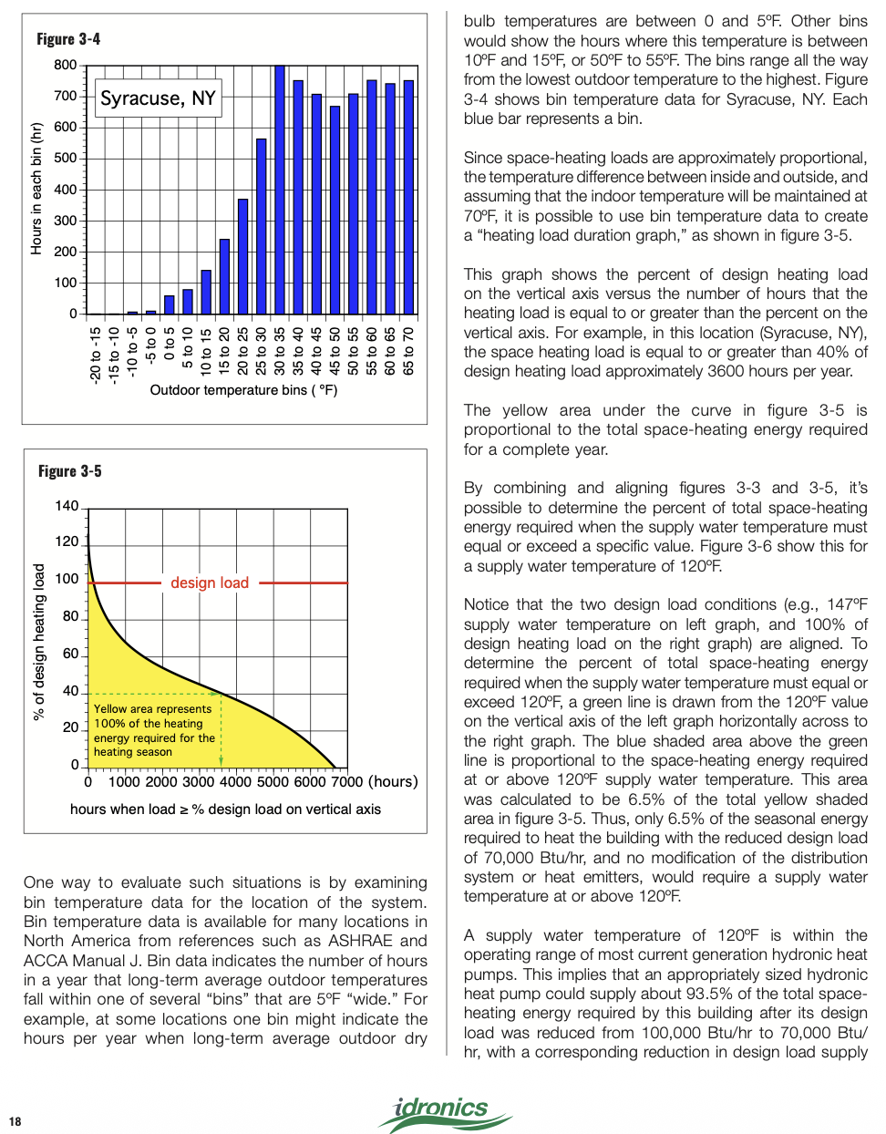

    Then collect more data. Weather BIN data tells when and how often you could run reduced SWT. Add an ODR to control this.

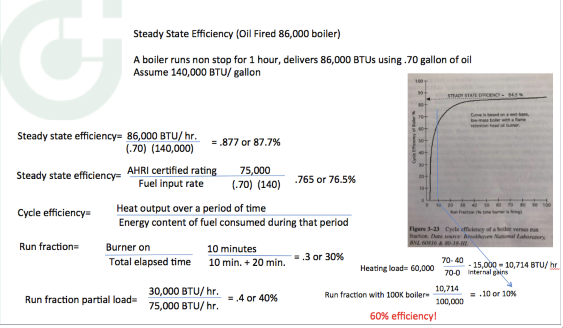

    Watch the boiler operate for a few hours. Record burner off and burner on time to get a run fraction. See example for an oil boiler.
    To get cycle efficiency, clock the meter with only the boiler firing. Your utility may have the fuel content info? to get Cycle Efficiency
    Below a 30% RF, efficiency drops like a rock.
    So assume you have a 3 minute run, maybe 20 minute off??
    3 ÷ (3 + 20) = .13 or a 13% RF.
    The buzz kill is the partial load operating condition
    Partial load RF 10,000 load, 116,000 boiler 10,000 ÷ 116,000= .08 or 8%!!

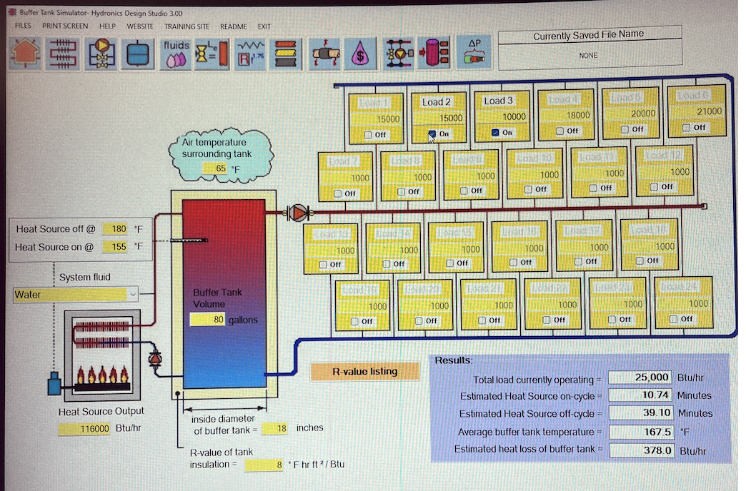

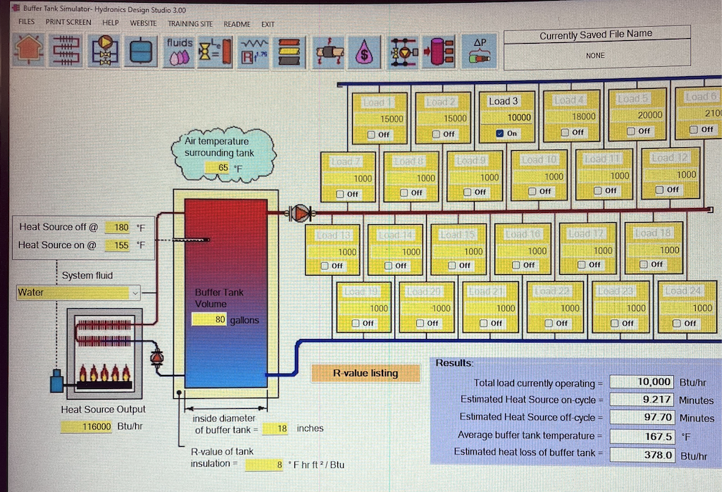

    With a 116,000 boiler output and a 10,000 load, with an 80 gallon buffer you get this:
    Takes the 3 minute burner on to 9 minutes or so. 9 minute run, 97 off
    connect two zones 25,000 total the get

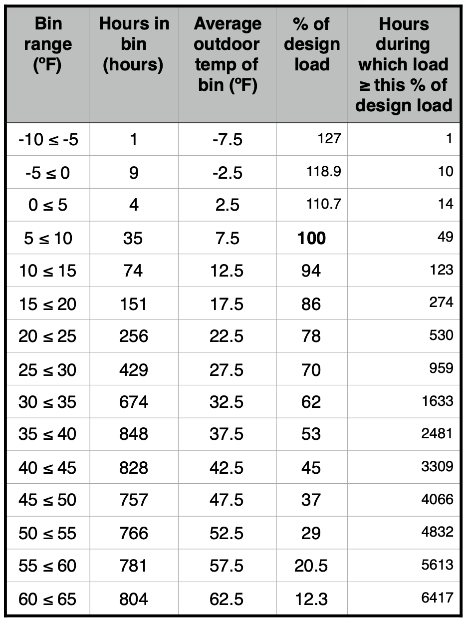

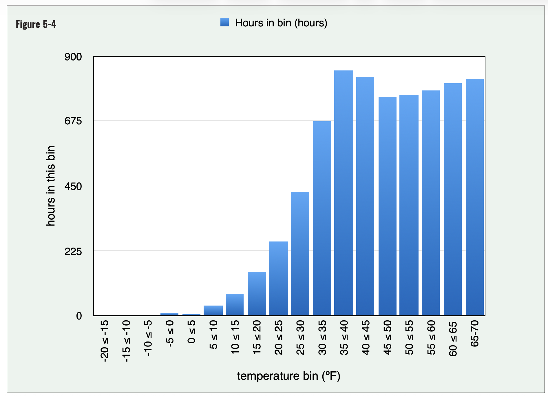

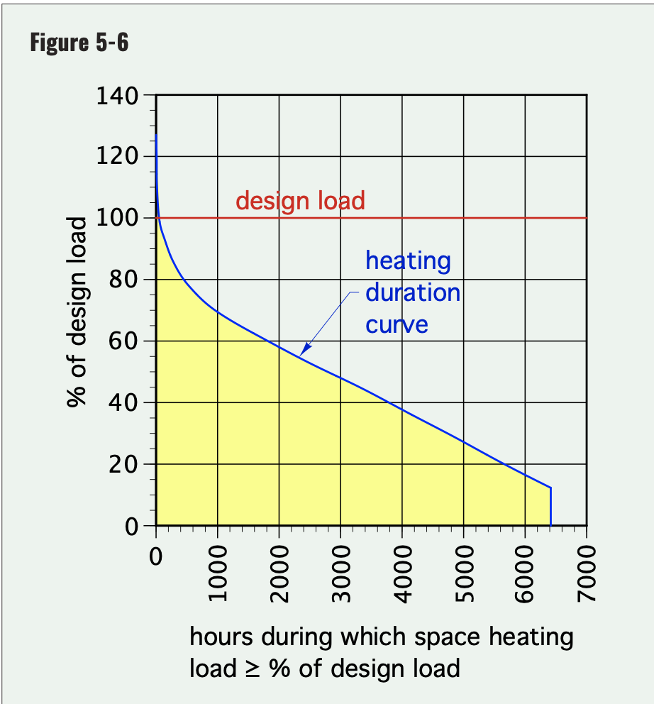

    Boston Bin data, is this close to her location?
    Screenshot 2026-08-23 at 9.14.53 AM.png Screenshot 2026-08-23 at 9.15.05 AM.png Screenshot 2026-08-23 at 9.15.15 AM.png

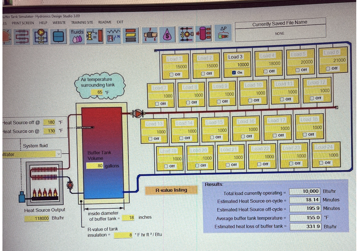

    Some updated data.
    Boiler output at 118,000?
    Spread delta to 130- 180
    So the pros and cons
    The wide delta helps the on time quite a bit. With one 10,000 load you get a nice 18 minute boiler on, 195 minutes off.
    However running the boiler to 180 you lose efficiency, compared to a 150° boiler.
    With a CI boiler of course the low temperature is what you need to work around.
    Now with an ODR you lose the leverage of that wide ∆ giving you the nice run times. But maybe most of the year it runs 160 or 150. So the efficiency is up. Runing 162 instead of 180 is an 18° reduction.

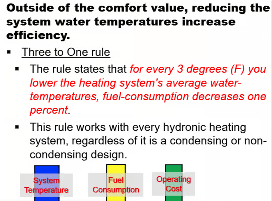

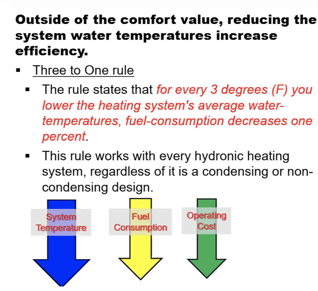

    According to Viessmann training.

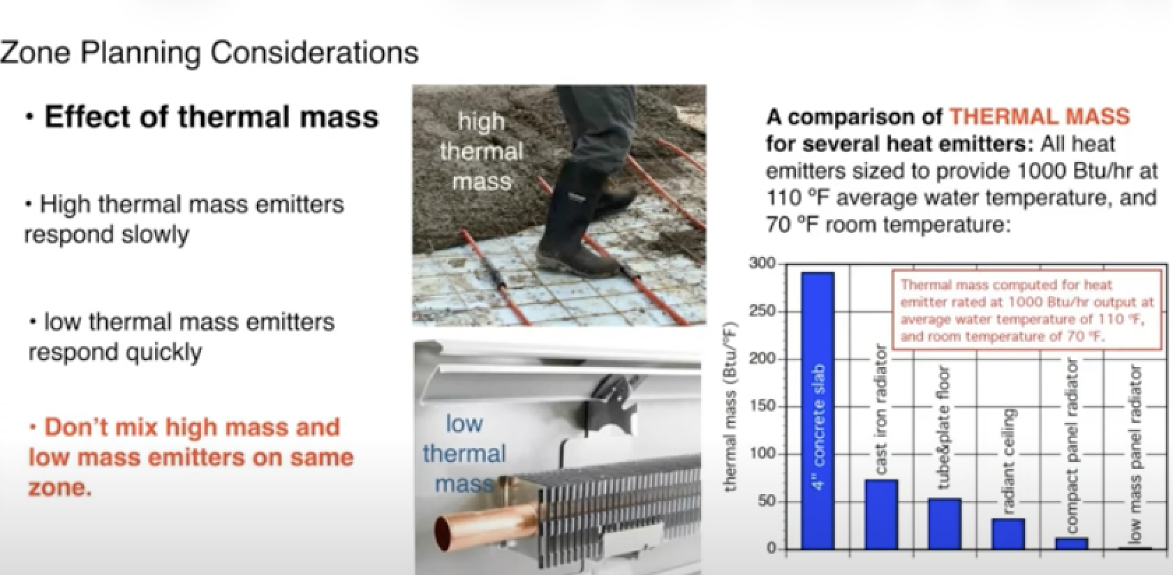

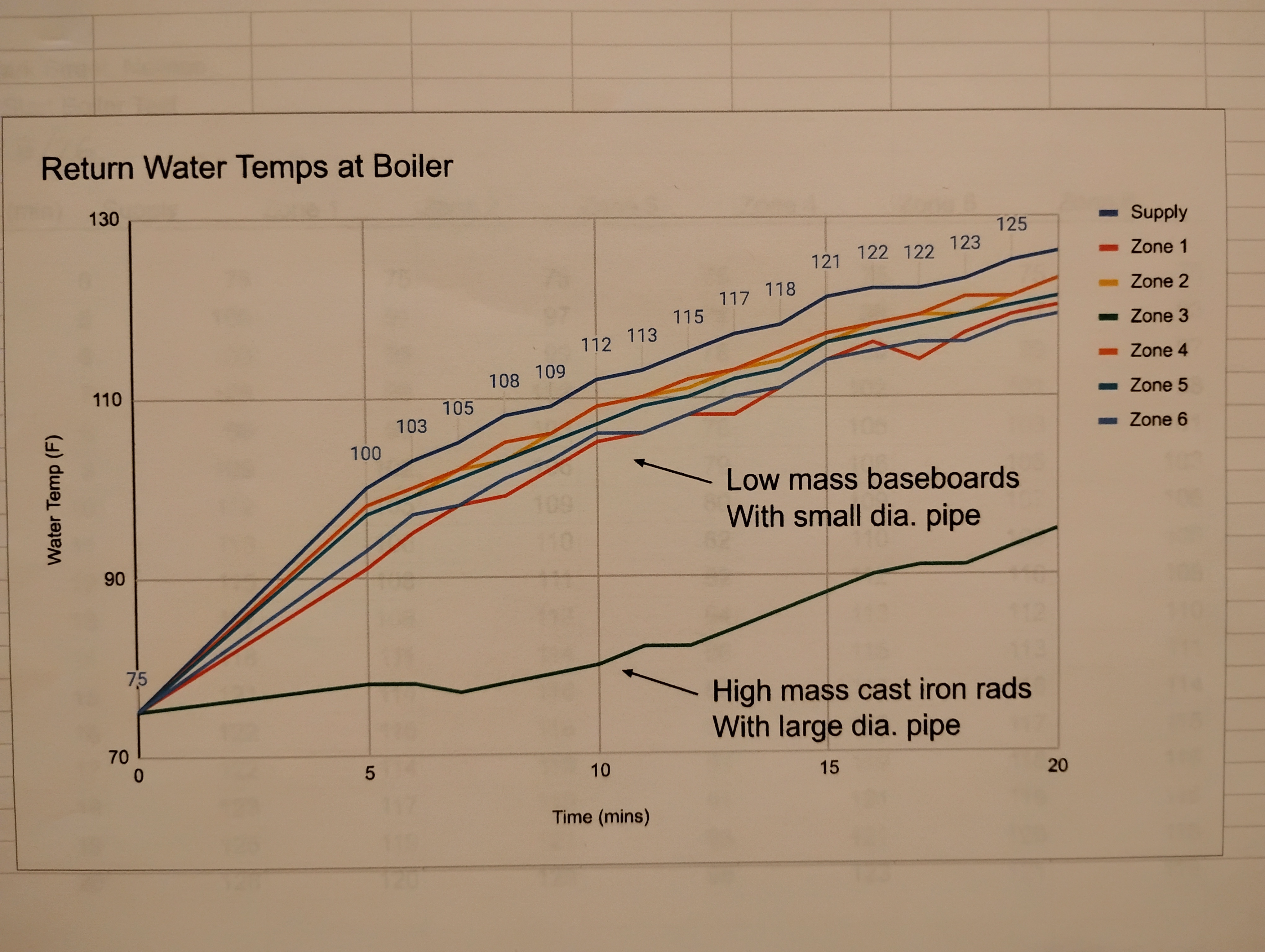

    What is the radiator or fin tube output at lower SWT. How low can you go and still maintain comfort.
    Unfortunately the CI radiators and fin tube are not a good blend. Very different heating characteristics. So there needs to be some compromise.

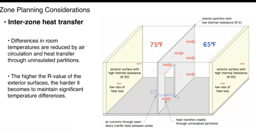

    I think sometimes people have an unrealistic expectation of setting unused room temperature back a lot to save energy. Again the building enevelop comes into that equation along with insulation between rooms, if any. If your exterior wall is poorly insulated that can help. But of course the poorly insulated exterior wall is costing more energy regardless. 3-5° room to room difference may be reasonable

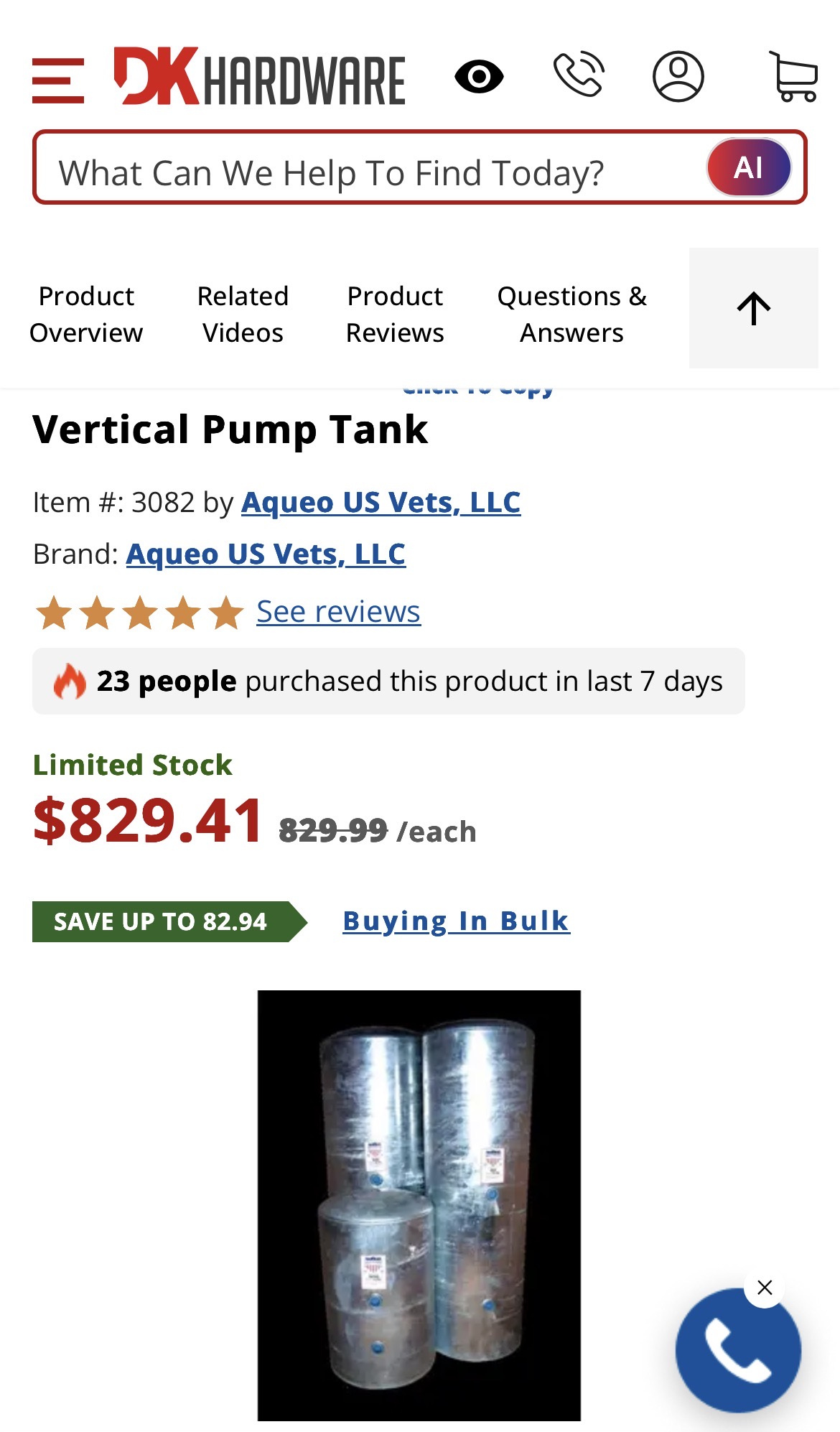

    hot_rod Posts: 28,699
    an 80 gallon electric runs around $1000,00
    Could you foam insulate and jacket a galvanized for the price difference?

    Another double check, how much radiation is currently installed? Does it maintain temperature in the coldest condition? That give you an approximation of boiler size.
    No need to have more boiler that what the attached emitters can move to the space.
    If cold return is chronic, that is one indication of more emitter than boiler power.
    The heat emitters ALWAYS drive the boilers operating condition. Good or bad.
    jesmed1
    EBEBRATT-Ed Posts: 21,328
    @jesmed1 also mentioned having both CI radiators and copper fin tube.
    I am hoping they are not mixed on the same zone that could be an issue.

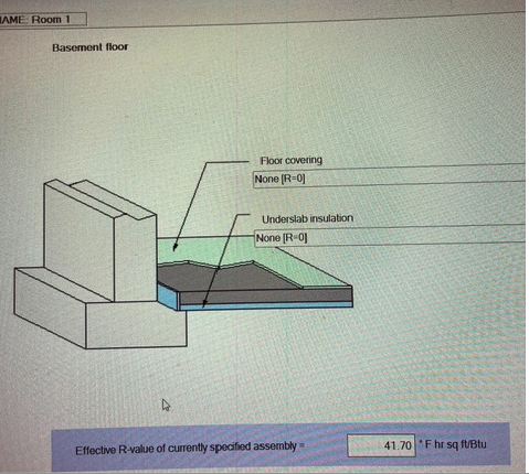

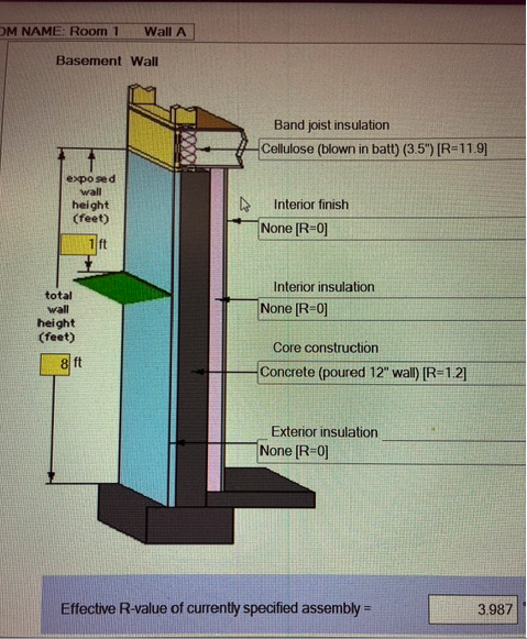

    @DCContrarian @Kaos Thank you for your input on heat loss. I spent today measuring and checking wall thickness, construction, insulation, etc, then running heat loss calcs. I found that most of the solid masonry walls on the first floor had been furred out inside with either 2x4 or 2x6 stud walls with batt insulation. So those walls weren't the problem. And because the roof is steeply pitched and begins at the first floor ceiling, the second floor consists mostly of wood-framed dormers with 2x6 stud walls and batt insulation. So those walls aren't the problem either. And because the first floor living room ceiling is vaulted, the second floor is a lot smaller than the first floor. So less square footage, and much of what would normally be second-floor ceiling area is counted with the first floor living room, because of its vaulted ceiling.
    The problem was in the basement. Most of it is uninsulated solid concrete walls, 12-16 inches thick. I assumed R-1 for those. And because those are semi-submerged, I used a lower delta T (40 instead of 60). But the real problem was the concrete slab floor. Don't know its thickness or insulation. I assumed the worst, 4 inch slab, no insulation, R=0.3. I used a delta T of 20 for the floor slabs, assuming earth temp of 50.
    Because there's 1000 sq ft of basement floor slab (half of it in heated family room, half in unheated boiler room), the heat loss through that slab is 70,000 BTU/hr, under those assumptions. That's enough for an entire house. If I incude the basement walls, the entire basement is 107,000 BTU/sq ft. That's enough for a bigger house.
    I didn't bother with air infiltration, because the numbers are so bad anyway.
    The breakdown:
    First floor, with vaulted LR ceiling: 47,000 BTU/hr
    Second floor: 9,000 BTU/hr
    Finished basement (heated): 49,000 BTU/hr
    Unfinished basement (unheated boiler room): 58,000 BTU/hr
    Total: 163,000 BTU/hr
    What's interesting is that the first and second floors come in right around 20 BTU/hr/sq ft, as I had guessed, and I didn't fudge the numbers to make that happen. But the basement comes in at 90+ BTU/hr/sq ft, because of the assumed 4-inch uninsulated floor slab at R=0.3, and the uninsulated 12-inch uninsulated perimeter walls at R=1. If I take the average, it comes out to 43 BTU/hr/sq ft.
    So the killer is the uninsulated bare concrete basement. But here's where the limitations of reality set in. The boiler itself is rated at 164,000 BTU/hr input, 84% efficiency. So at best it's putting out 137,000 BTU/hr. And because the boiler pipes aren't insulated, and there's a long metal flue pipe running from the boiler over to the chimney, the boiler room is the warmest room in the house. (That's why I counted it in the heat loss, even though it has no rads). So if the house stayed at setpoint on the coldest days last winter, it did so at no more than 137,000 BTU/hr. I'll have to ask my sister tomorrow about that. She may say some days the boiler couldn't keep up. But I also think the boiler wasn't running as efficiently as 84%, so I think the practical max output was less than 137,000 BTU/hr.
    So what do you all think about the basement slab loss? 70,000 BTU/hr for around 1,000 sq ft of slab 4+ feet below ground level? Sounds crazy high, but I guess numbers don't lie.
    @hot_rod had a good point about radiation being the limiting factor, and I'm sure that's true. I'll do a radiation survey tomorrow, and I'll bet there's not enough radiation capacity for the boiler at max water temp.

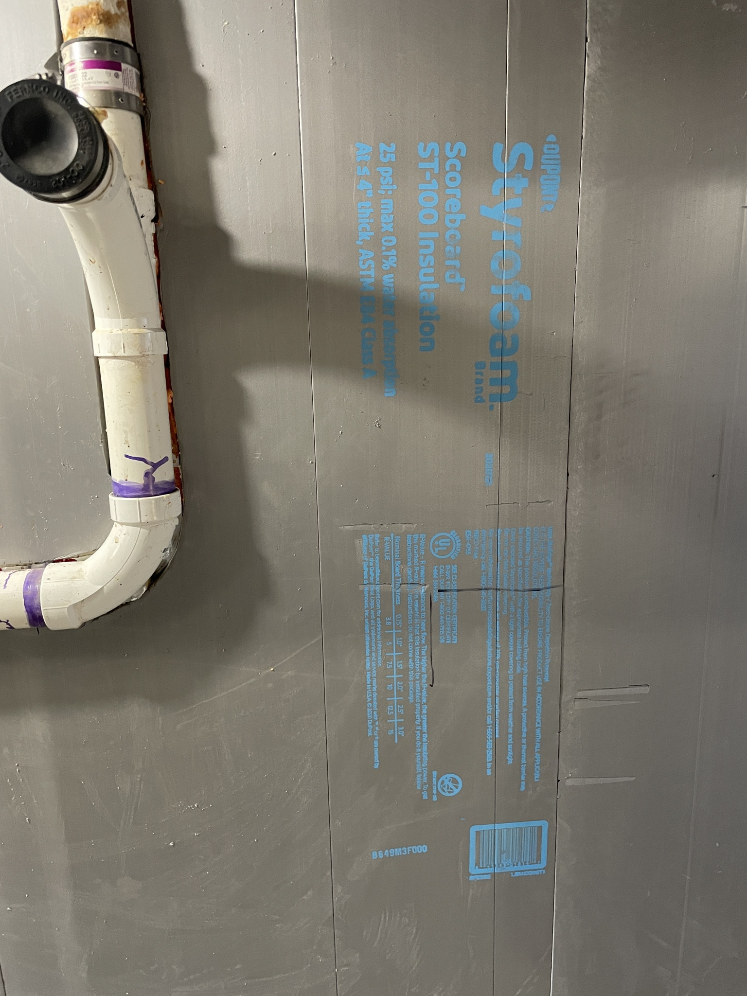

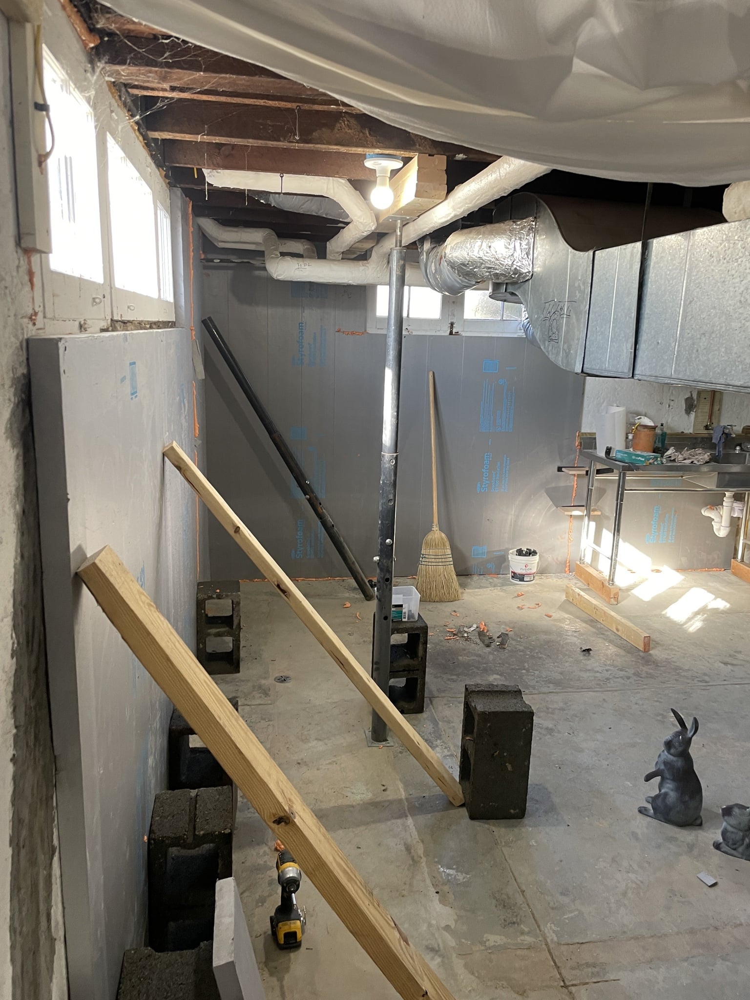

    Recommend applying 2” exposure rated Dupont XPS to basement walls. Goes up fast and immediate payback.
    jesmed1

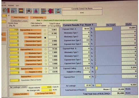

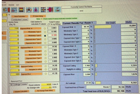

    I figured 1120 sq ft of basement wall. No doors or windows? Insulated rim joist? Uninsulated slab
    0° outdoor, 70° indoor. Heated space above?
    Load around 30,000 is more realistic.
    Screenshot 2026-08-25 at 6.56.31 PM.png Screenshot 2026-08-25 at 6.49.18 PM.png Screenshot 2026-08-25 at 6.54.57 PM.png Screenshot 2026-08-25 at 6.49.32 PM.png
    65
  • PC7060
    PC7060 Posts: 1,980
    65?

    Did you include windows and doors? In my back-of-the-envelope calculation they were lost more heat than the roof.
    70K for the basement slab seems high to me, but I don't doubt that the basement is a heat sink. My mental image of a basement in a 1920's house in Massachusetts is something that is basically open to the elements. And it wouldn't surprise me at all if when they finished part of it they did only minimal insulation and no air sealing.
    My guess is that infiltration is a significant contributor to heat loss. I would expect a basement like that to have a bulkhead that barely closes, a bunch of windows that whistle when the wind blows, and maybe an abandoned coal chute that was indifferently sealed. Even if it doesn't have any of that stuff I'd expect the rim joists to be super leaky, even in the finished part of the basement.
    "the boiler room is the warmest room in the house. (That's why I counted it in the heat loss, even though it has no rads)." Heat doesn't only go where you send it, you have to include everything inside the building envelope in the heat loss calculation.

    OK, an update. I used some online calculators inputting the actual # therms used for heating, and the location, for which the online calculators select the appropriate number of HDD's to calculate the approximate heat load for the house. I've done this before with our condo building, and the results are pretty accurate, so I have confidence in the method.
    Doing this for my sister's house gives a predicted heat loss of about 110,000 BTU/hr, vs the more extreme 163,000 BTU/hr I got from my guesstimating on floor slab R value, etc. Assuming the 110,000 BTU/hr is correct based on actual fuel usage, that gives an average heat loss of 33 BTU/hr/sq ft, quite close to @DCContrarian and @Kaos predictions.
    So I think I probably was too conservative with the slab loss of 70,000, as several of you have observed above. Cutting the slab loss estimate roughly in half (by raising R value from 0.3 to 0.7) and raising the 12" thick concrete R value from 1 to 1.5 brings my calculations down pretty close to the 110,000 BTU/hr from the actual fuel consumption. So that seems reasonable.
  • jesmed1
    jesmed1 Posts: 1,631
    edited August 26
    Yes, I got about 12,000 BTU/hr from windows and doors.
    Re leaks, this is not your typical basement. It's 12-16" thick solid concrete walls all the way up to a plaster ceiling with no rim joist visible, and no bulkhead doors, so it's quite airtight relatively speaking. The basement is built like a bomb shelter.
    Notice that I already over-predicted the heat loss at 163,000 BTU/hr (mainly by being too conservative on the basement floor and wall R-values) vs. the calculated 110,000 BTU/hr based on actual fuel consumption, without even adding a factor for air leakage, Yes, I understand air leaks are definitely happening, but that means even less conductive/radiative heat loss is happening than I calculated using conservative R-values. In other words, my assumed R values were too low. So either the actual air leakage is lower, or the actual R values are higher. Either way, the 110,000 BTU/hr calculated based on actual fuel consumption should be the "real" number, and it's quite close to your BOTE of 122,000 BTU/hr, so thank you for setting me straight.
    Now that you've convinced me the heat loss really is close to 35 BTU/hr/sq ft, I guess the boiler isn't the culprit here, but we can still check to make sure all the zones are circulating, do the radiation survey, etc. I'm sure the boiler is still short-cycling on some of those small zones, so there may be some minor improvements we can make to zoning.
