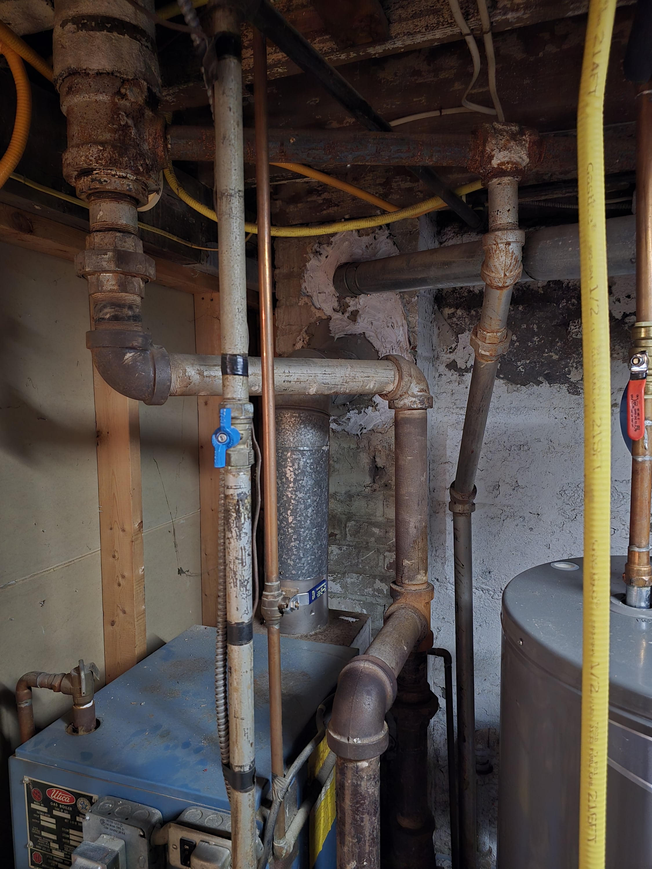

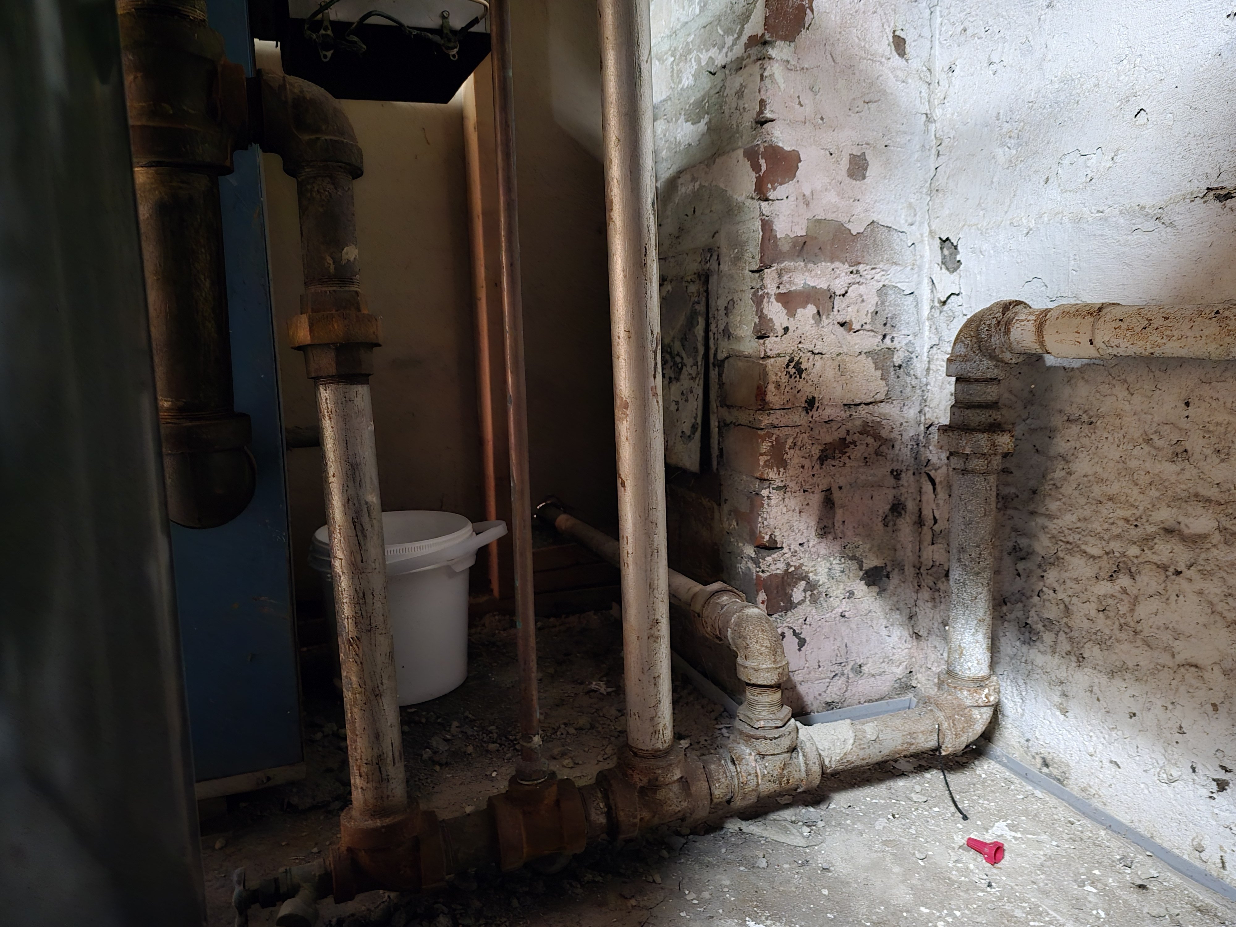

Details on my system: The house was built in 1951, Northeast PA region. It currently has 6 radiators, one cast iron baseboard, and two capped pipes where radiators used to be, but have been replaced by a standalone electric baseboard. Interestingly, there are 3 pipes leading into the wet loop from the radiators, seeming to make 3 separate loops. One leads from the main loop around the house, but the other two, while I'm not sure, seem to be from a radiator in the kitchen, and from the baseboard. A lot of the pipes are not insulated, which I plan to insulate once I know the system is working. Photos are attached.

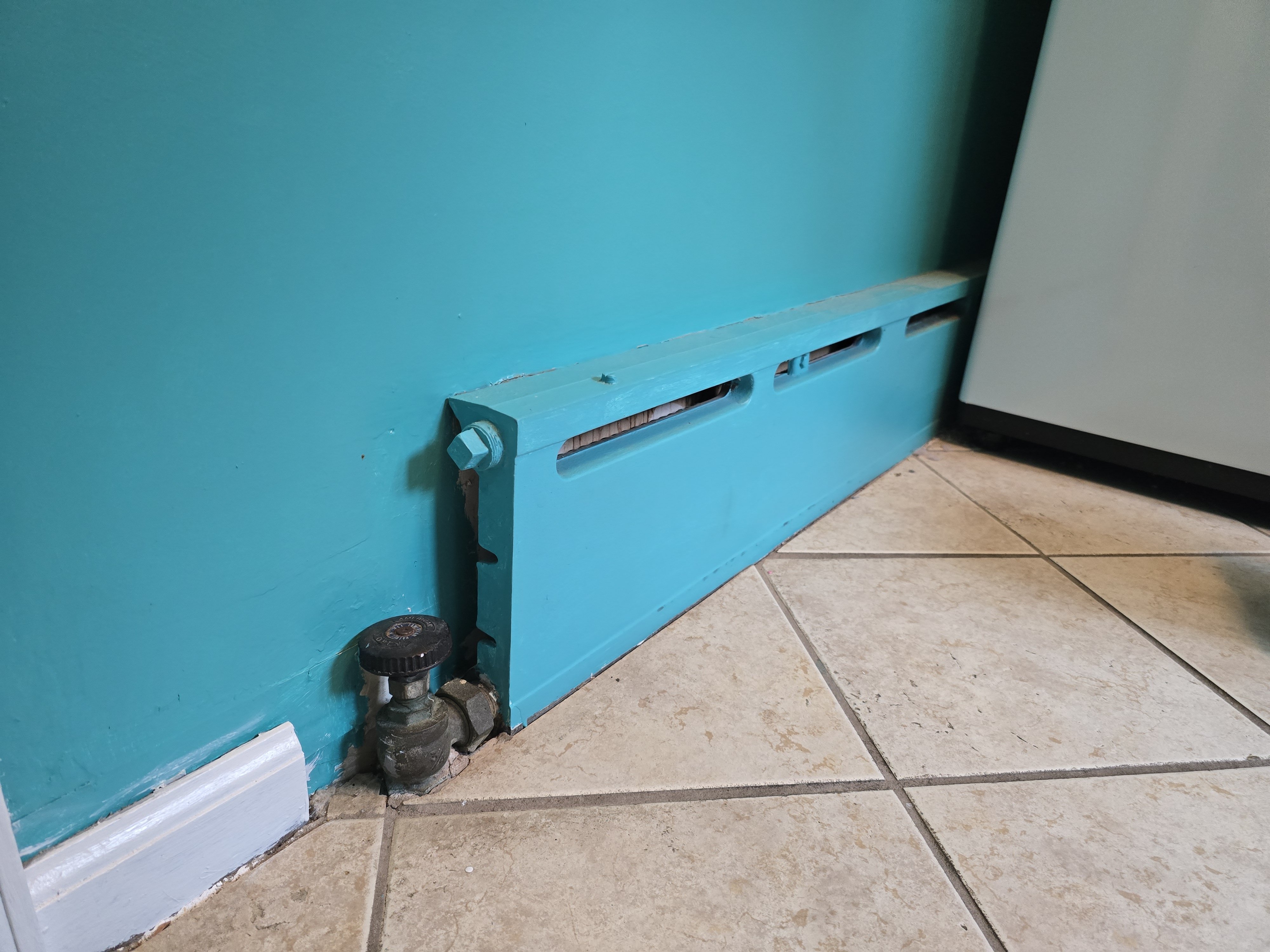

The cast baseboard has me worried, since it's a one-pipe, and in the book Dan mentioned that the setup can cause water hammer. Is it safe to have it on, or better to keep it shut? It's in the laundry room, so it's not really needed.

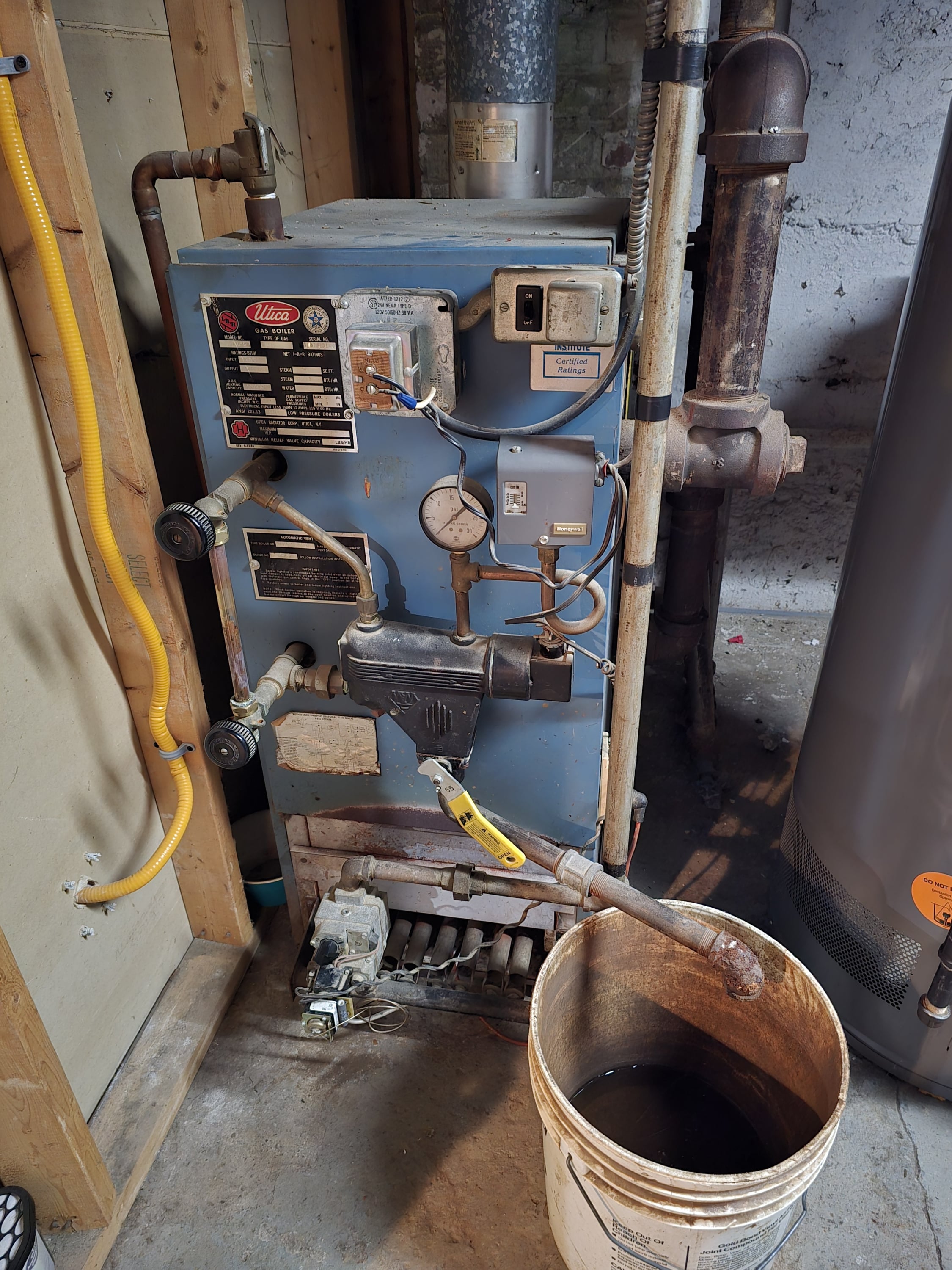

From what I saw in the book, I plan to do a leak test, and a low-water shutoff test. For the leak test, how do I know when the water has reached the header? And are there any other tests I should do, besides firing the system up and making sure every radiator gets warm?

Well let's see… for the boiler. There's no harm to filling it to the header. You can usually tell by the pipe getting cooler. Be sure to lower it back down, though, before you fire the old girl up!
The other two checks are the low water cutoff, and depending on the type of cutoff than can be variable. Some advocate lowering the boiler water level to below the cutoff; the boiler shouldn't fire. That's great — if you have a place to drain the boiler. If you don't… some (probe type) have a "test" switch which at least tests the electronics. Your type doesn't have the electronics, but it does have the valve with the big yellow handle. That should be opened once a week or so to blow any crud out — and if you do that with the boiler running, the boiler should shut off while you're at it. Be sure to have a bucket under it! Yo don't want water to get into the burners! Pressure control — the only reliable way to test that is to fire up the boiler and see what it does. The pressure control should shut off the boiler if the pressure goes to its setting. Simple enough — but if it's the code required 0 to 30 psig gauge, it can be hard to see any pressure building aat all!
Now on radiators. Yes, cast iron baseboard can be problematic, but it can also work. Make sure that it is slop0ed to the inlet valve so that it can drain — and make sure that that inlet valve is open and stays open. Don't close it! If it hammers — and it might — try putting a slower vent on it.
Not sure about some of the other piping. However, the big cast iron radiators put out wonderful heat. See if you can keep them… nothing else will do as well.

I filled the boiler up, and no leaks presented themselves. Then I lowered the water to the top 3rd of the sight glass, turned the boiler on, and drained the boiler from the yellow handle, but the burner never turned off, and I got nervous before it was fully empty and shut the burner down. So I tried it the other way - with the boiler off, I emptied it completely, and then turned the burner switch and pilot on, and… the burner happily lit right up! I shut it off real quick, but I guess that means my low water shutoff isn't working. How do I go about testing and replacing it?

I started disassembling the float, and testing each piece.
- The wiring, when disconnected, shuts off the burner.
- I confirmed with my multimeter that the switch opens and closes when the prong is moved up and down.
- With the float still in the housing, I tried wiggling it up and down by the stub that flips the switch, and it seemed to move freely.
- I pulled the float out, and mimicked the water rising by lowering it into water, and it floated properly, so no air leak.
- I looked inside the housing, and it seems pretty cruddy in there.
So every link of the chain seems to be operating fine, the only issue that I can imagine that caused it to not work is the crud build up in the housing (although the float itself wasn't actually too dirty, I suspect this boiler may have been serviced since its installation). My next step is to remove the housing and blow off valve, clean it out as best I can, and then reassemble and test it all together. Any tips for removing and cleaning it out, or just go at it with a wrench and elbow grease? Is it fine to use auto part cleaners (of which I have many cans), obviously with the housing removed from the boiler so nothing gets in it?
Update: I removed the float switch and housing from the boiler, cleaned it out well, replaced the gaskets, hooked it back up, and it works great! Didn't have to buy anything new except the gaskets and the 3/8" plug on the bottom to replace the old corroded one. Now, when the water is low, it shuts off as it should.
