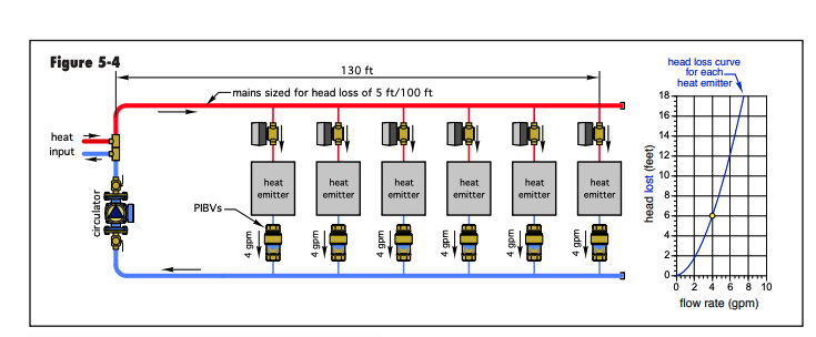

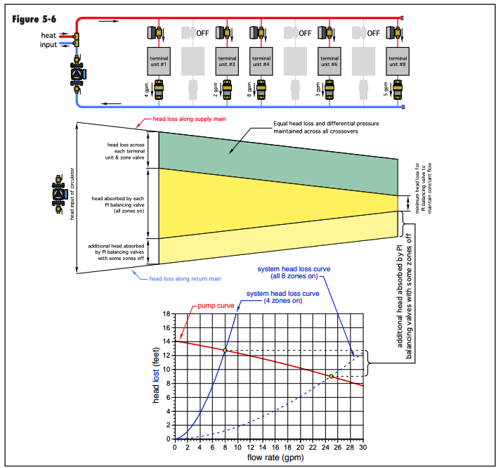

    A automatic PIV pressure independent valve works great on that many coils. You buy the gpm each coil needs.
    You will spend days trying to manually balancing 50 coils.
    Ideally a delta P circulator that modulates as valves or coils come and go.
    Screenshot 2026-08-08 at 9.18.58 PM.png Screenshot 2026-08-08 at 9.19.15 PM.png
    An ECM delta P circ, Grundfos Magna, could cut pumping power down by 50% maybe more.

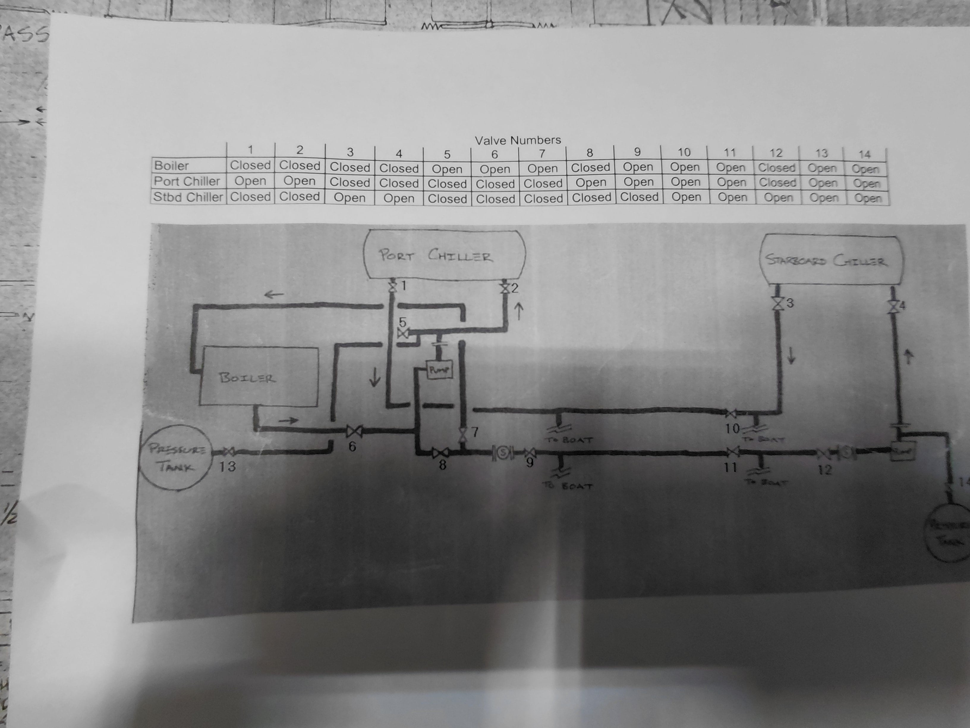

    So taking a trip down memory lane. The Ship origionally had two chillers and two circ pumps. When the moved the boat to the pacific north west they decided they didn't need the second chiller so the removed it and its pump. Then they just opened the connecting valves, and upsized the single pump. As a part of that the re routed the boiler from the suction side of the pump to the discharge side, and slapped in a couple plain steel tanks.

    The air sep should be on the hot supply from boiler. Move expansion connection to suction of pump.
    With a plain steel tank you have an "air managment" system. Air vented from the purger needs to go into the steel tank.
    IF you had a diaphram or bag type expansion vessel, air can be expelled. Assuming there is a fill system to replace expelled air.
    With glycol you want a fill tank, not a water connection for filling.
    30- 35% glycol should be adequate. Look at the glycol tables for "burst" protection %
    If the boiler gets valved off, add a sep on the chiller. On chilled water piping, the air sep goes on the return side, the warmer temperature zone.
    With steel in the system, a magnetic dirt sep may be wise also. Or use combination separators.

    A PAB pressure activated bypass would be an option if the coils have on/off zone valves
    But an ECM circ in delta P mode adjusts gpm based on the number of valves open or closed
    A Grundfos like this can cover 75 gpm, a 600W pump!
