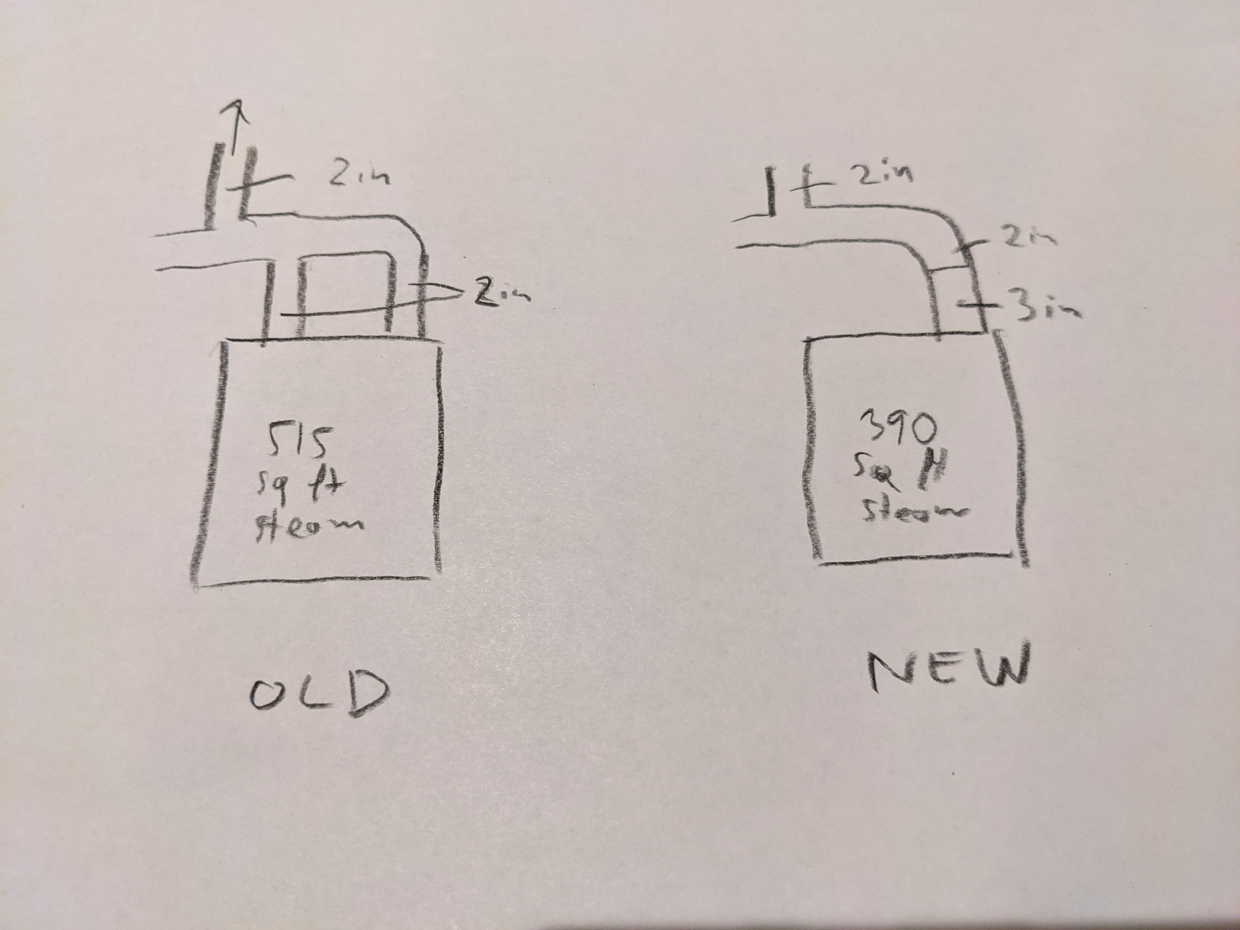

I'm slowly replacing my steam Burnham boiler (capable of producing 515 sq ft of steam) with slightly smaller Williamson GSA-150 Series 2 (390 sq ft). The boiler comes with 2 top opening (1 is sealed at the factory).
My original set-up (Burnham) had two 2in raisers coming together in a header and sending the steam via 2in pipe further into the system. It worked very well.
I'm trying to keep as much of original piping as possible. The new boiler (Williamson) has two 3in openings (despite manual claiming 2.5in). I'm thinking of having one 3in raiser reduced to 2in header to send steam to the system via original 2in pipe. Am i OK in my thinking?

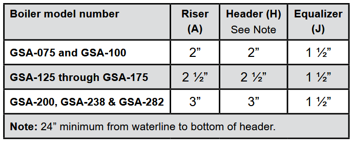

    The manual for that boiler states 2 1/2” riser and header which is the answer to your question about a 2” header.

    The manual calls for 2.5in raiser and 2.5in header.
    The manual doesn't says whether i should use 1 or 2 raisers.

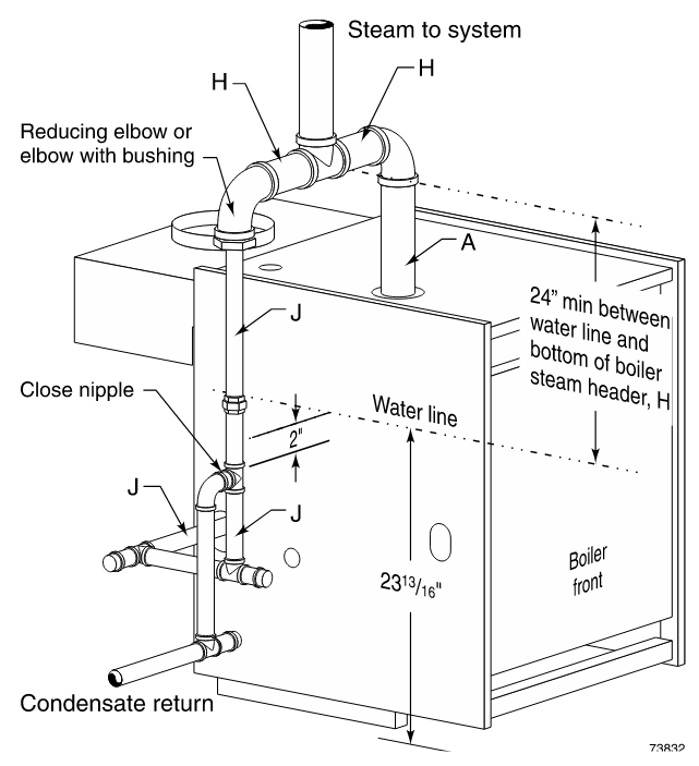

    look in the manual it wiil show a drawing of the piping for your boiler

    The manual does not say that the boiler has a 2 1/2 in tapping for the supply. The manual just suggests using a pipe size of two and a half inch. The boiler does have two, three inch Supply tappings. But the manual does not recognize the one on the right side. But you are certainly welcome to use it.

    If my old (larger) boiler had two 2in raisers going into 2in header into 2in main… Would the fact that there were TWO 2in raisers rather then ONE 2.5in raiser like i plan to do, REALLY keep the steam that much drier?

    No to beat the dead horse over and over... If my current boiler (390 sq ft) is 24% smaller than my previous one (515 sq ft), then it seems ONE 2.5in raiser = TWO 2in raiser x .76. (more or less)
    Or am I missing something?

    As shown in the drawing in the first post, I'd go with one riser — when using two risers, swing joints are needed. They are not shown in the sketch, but maybe they are there… If not, it'll be cheaper and more effective to go with one riser, and going up in size.

    you still need a swing joint between the equalizer and the header. if the riser comes up and makes a 90 with a threaded fitting and connects in to the side of the header that makes enough of a swing joint for the risers.

    Why do you need a swing joint between the header and equalizer?
    because the boiler block may expand at a different rate than the pipe, just like with the risers. technically soemwhere between the header and the return connection from the equlaizer/hartford loop. usually you end up with enough play in there somewhere if you do it with threaded fittings.
  • ChrisJ
    ChrisJ Posts: 17,763
    Do you have any manuals calling for this?
    I know it's common across all brands if there's two risers that they must have swing joints but I do not recall ever seeing it for the equalizer. I assume because the return tapping doesn't line up with the supplies, so you need an offset regardless?
    It is right here. They don't tell you why they do most of the things they do.
    ethicalpaul Posts: 9,075
    edited August 10
    That's a swing joint? I don't see how that would prevent issues with the block expanding at a different rate than the piping…
    I would say the swing joints are the elbows at the top of the risers…not that they actually swing, but they give more distance for the pipe to flex.
    it will let this section of pipe move with the boiler possibly along with rotation at the hartford loop fitting. it doesn't take much.
