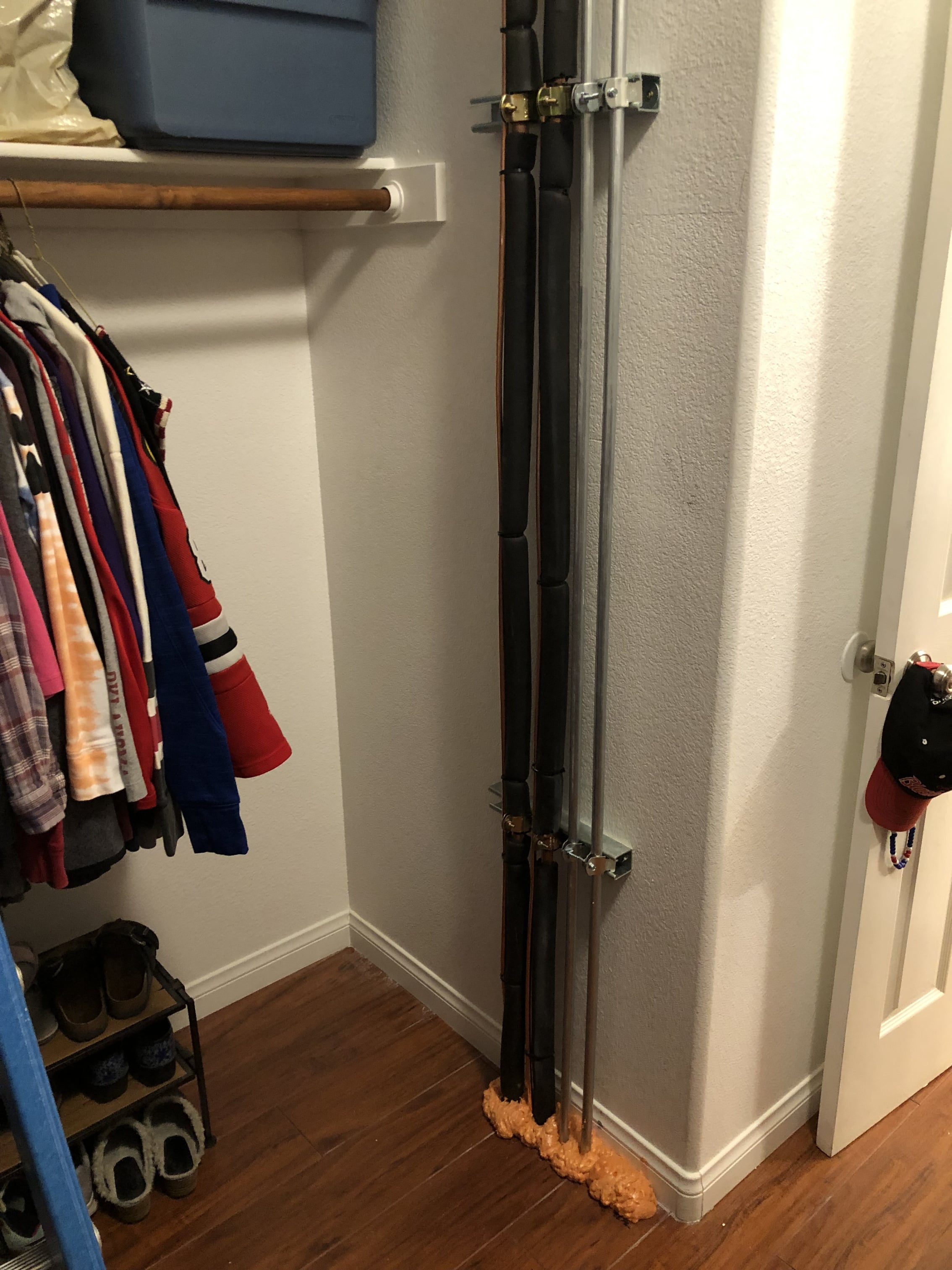

    When I was contracting, my go to was Mitsubishi’s Hyper-Heat with multiple indoor heads I think you could use 5 indoor cassettes to one 5 ton heat pump. I forget what you call it but the refrigerant lines were piped to a centrally located terminal, that you could install out of sight, and from there just one lineset to the outdoor unit. I used them a lot on anything with a drop ceiling, basement, or accessible attic. That way, I could keep most of it hidden.

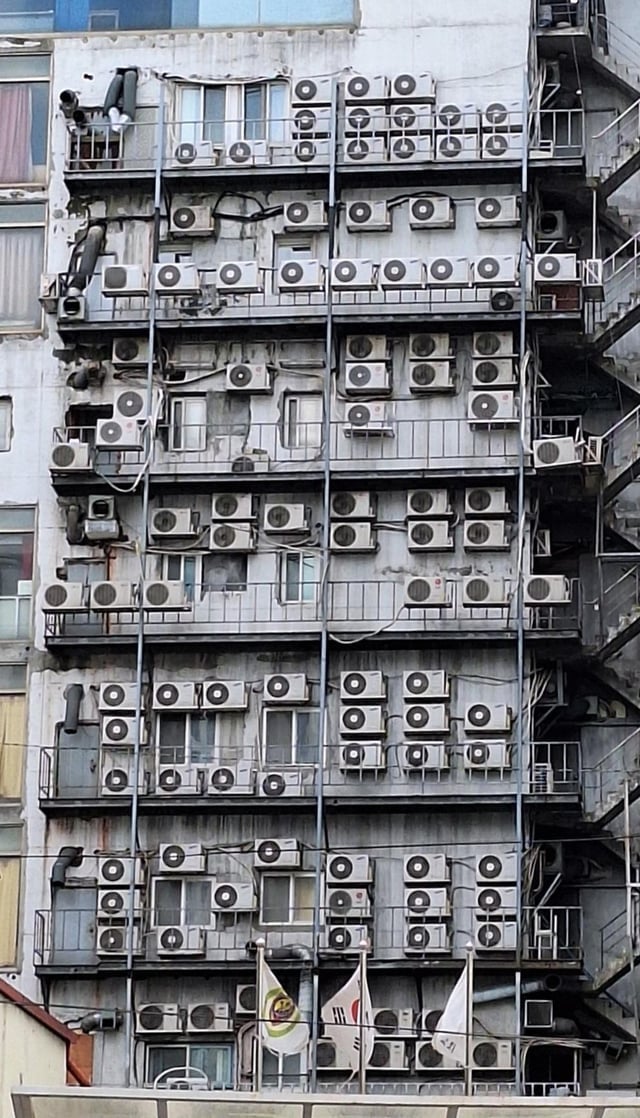

    Space is at a premium in Tokyo. In some apartments, movable walls allow a space that would normally contain only two rooms to function as six or seven different living areas. As the walls shift, kitchen furnishings fold or retract to create a living room, and a bedroom can then fold out from the opposite end.
    As far as the outside of the building:

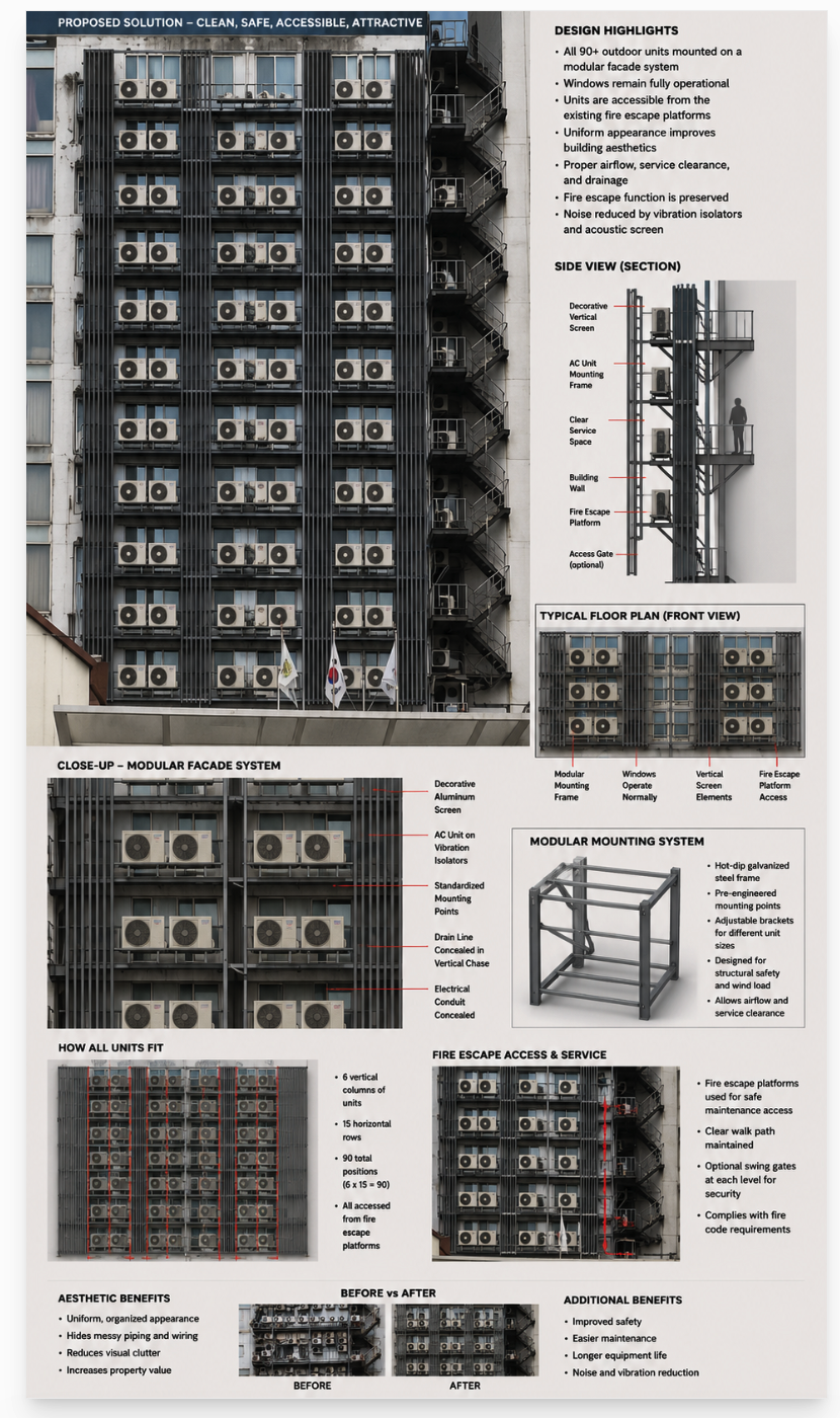

    The larger concern is what the building will ultimately look like after the first outdoor unit is installed and additional owners begin adding their own equipment over the years. Without a coordinated plan, it is impossible to predict the final appearance.
    However, when the system is planned as part of a complete building renovation, the outdoor units can be incorporated into the facade design and included in the permitting process. The installation should enhance the appearance of the building while also remaining functional, accessible, and easy to service.
    The mounting system should also provide flexibility for future equipment. More efficient outdoor units may be larger, so the design should include adjustable mounting positions and enough space to accommodate different unit sizes.

    As you see in the pics, don’t go to Europe or Asia, as that is commonplace. Minisplits are popular like that because they are cheap and disposable.

    As mentioned above, I will go to great lengths on mini-splits to avoid compromising the aesthetic of the building’s exterior. I always gave my customer that as an option. In my example, I referenced a 5 ton Mitsubishi heat pump with 5 indoor heads/cassettes. I installed it so there was only one set of refrigerant lines coming through the wall straight to the unit. Same goes for the power supply. What’s not to like about that?
