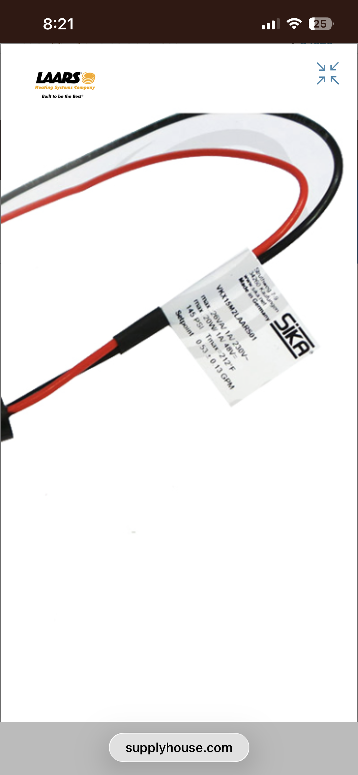

    hot_rod Posts: 28,704
    This is the brand you see on many tankless and combi DHW heat exchangers. It needs to be low lead for potable water.
    https://www.sika-usa.com/products/flow/flow-switches/
    I have also used the Harwil, they are PVC and screw into a FIP tee branch.
    https://www.harwil.com/flowswitches/
    These are both excellent brands.

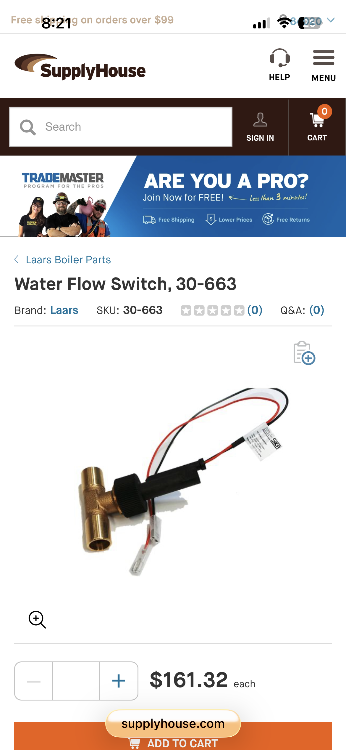

    you might buy it with the tee. It needs to be in a tee if the correct size to regulate at low flow condition, .50 gpm, for example
    The rating on the switch shows the gpm range, so size to the flow not pipe size
    Listed as a LAARS, but I suspect it is a Sika.
    The Harwil brand are used in spa applications, so they tend to have higher flow capacities

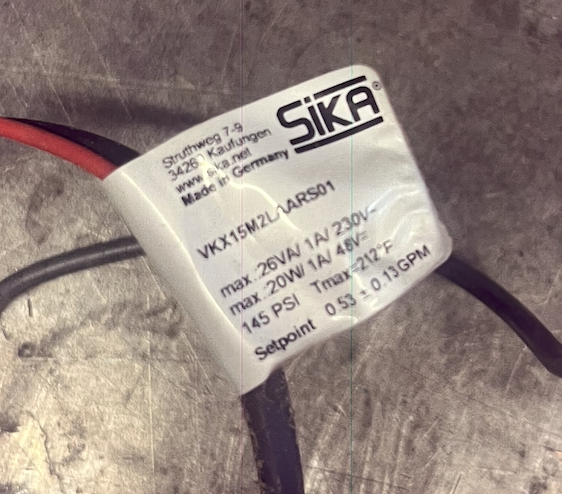

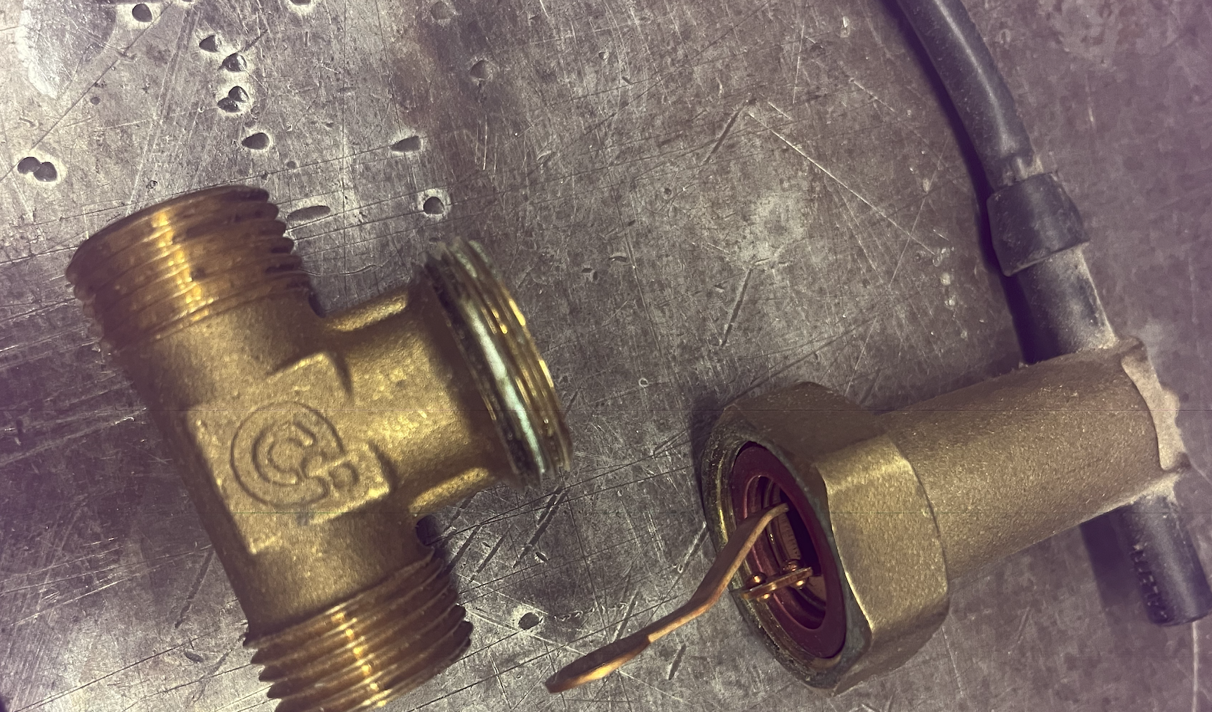

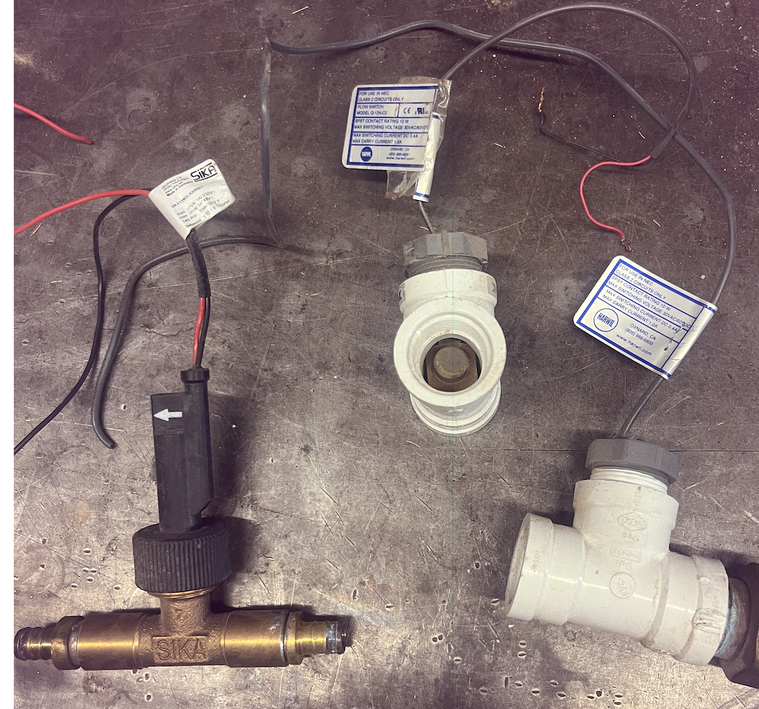

    Here are some of the switches I have used successfully. These were all in systems I built and experimented with.
    I don't know if Sika ever made low lead bodies, we asked for years. The have a branch office in Madison, WI, start there. We worked with them when we were doing solar HX systems.
    This Sika is a 1/2" body, it may be too small for your application. But it is the exact switch in many tankless and combi boilers. In combis it is often built into the pump/ HX block.

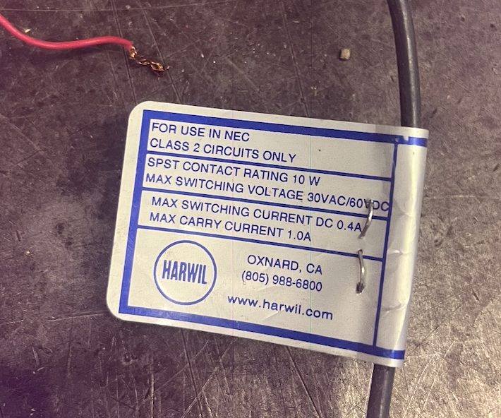

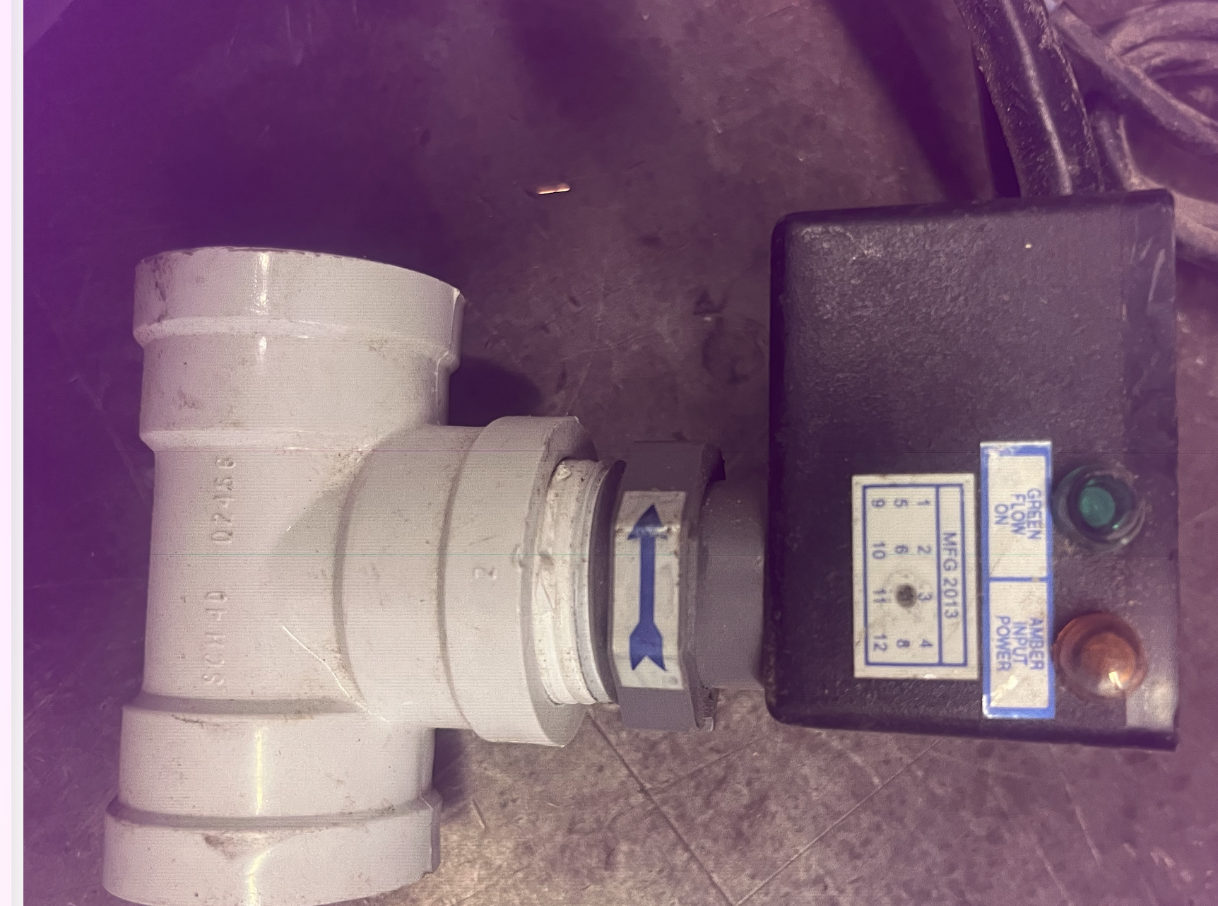

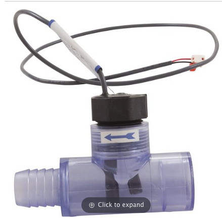

    If you go with Harwil it is available with this PVC fitting, FIP on all 3 sides so you can adapt to copper, pex, etc. Or get a 3/4" low lead brass tee. Just be sure the paddle doesn't bottom out, and moves freely.
    The bottom pic is from an online Spa Supply. a clear PVC tee would allow you to assure it is engaged :)

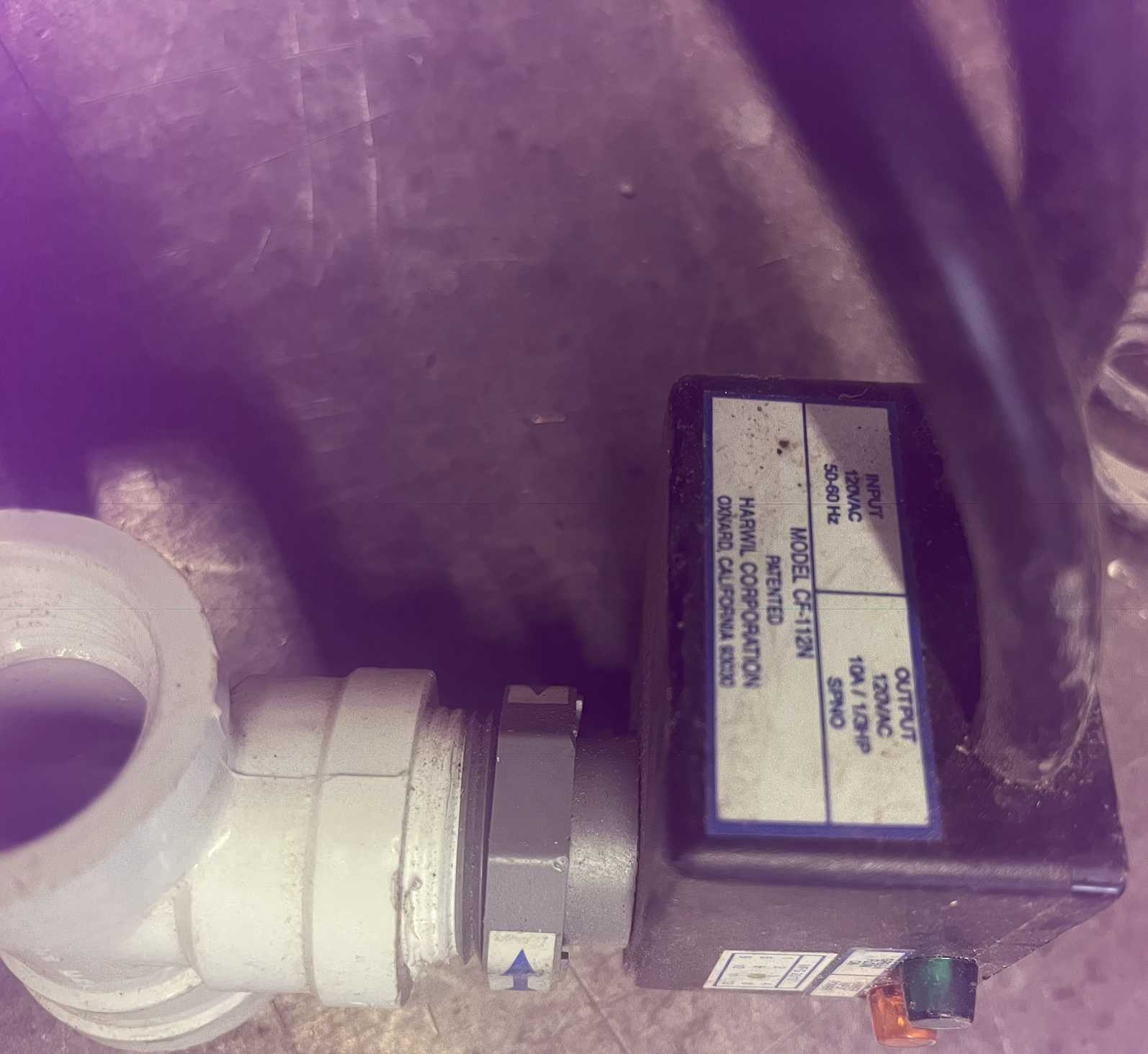

    The Harwil I would run through a relay as per it's voltage spec. Again, it is for the Spa industry so 24VAC is the common voltage on controls. It is a simple reed switch connected to a paddle, basically.
    Screenshot 2026-07-29 at 6.38.59 PM.png Screenshot 2026-07-29 at 6.39.29 PM.png Screenshot 2026-07-29 at 6.39.21 PM.png Screenshot 2026-07-29 at 6.47.22 PM.png Screenshot 2026-07-29 at 6.35.09 PM.png

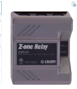

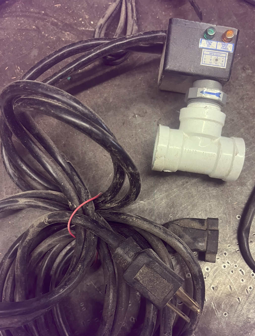

    I have a bin full of GFS samples, found this version of the Harwil. A 120V with junction box, indicator lights and input/ output cords. It may be an OEM part?Also a Caleffi version, also an OEM component.
