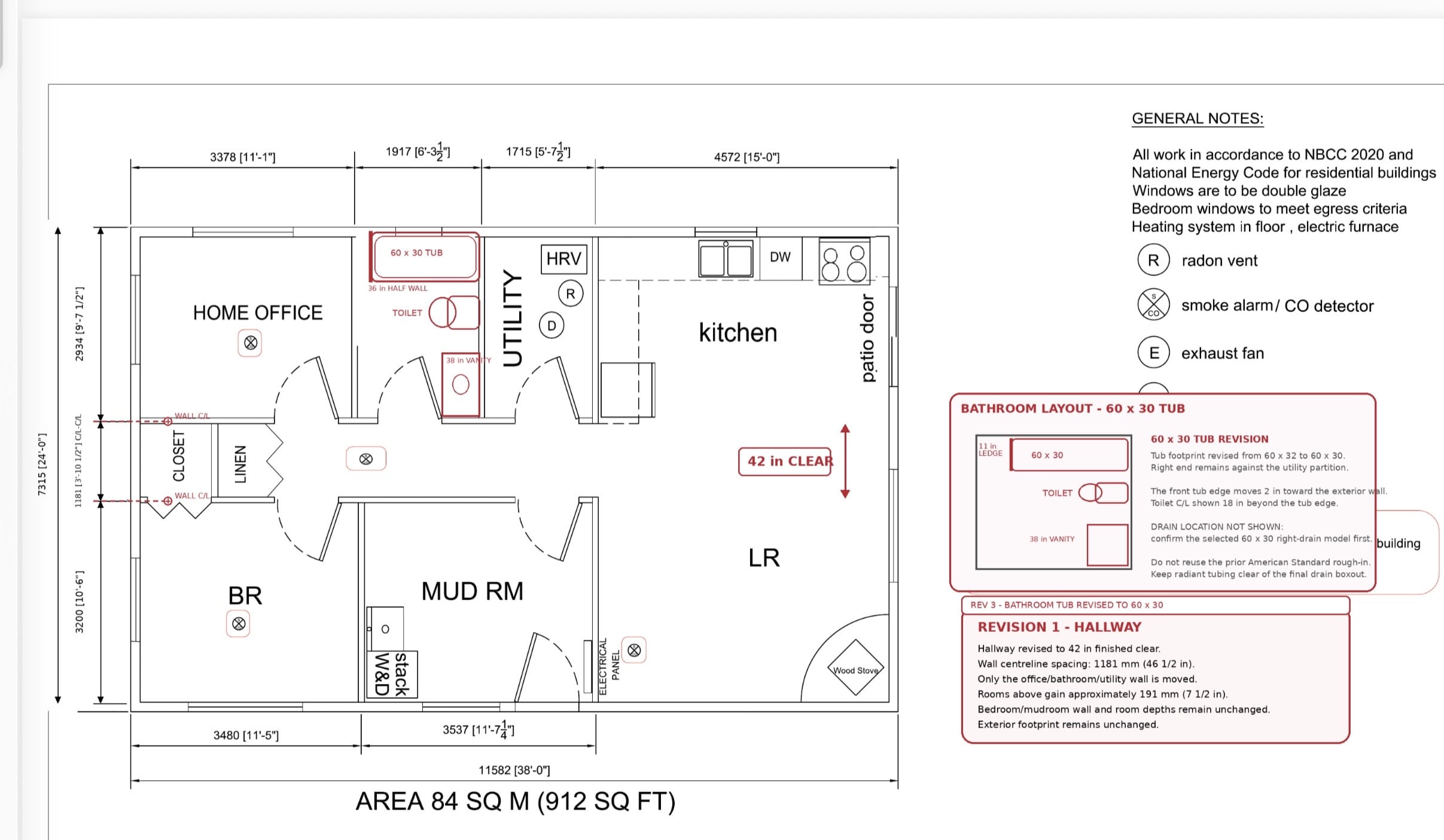

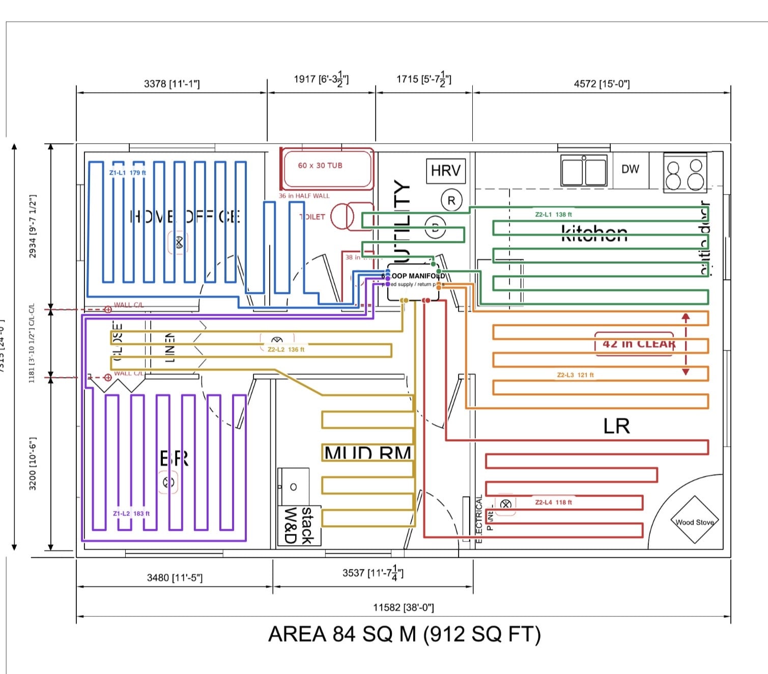

Hi,
Just looking to see if my loop design is correct for a small home we are building.
Attached is a floor plan and the design I created. If anyone has experience with loop design and can provide some feedback it would be greatly appreciated.
Thanks
Bruce.

    Where is the rest of design?
    Heat loss?
    Loop lengths, and flow rates?
    Are these loops in a slab, a build up with warmboard or similar material, or staple up with plates?
    What are the floor finishes in each room?
    Etc.
    On first look the utility room and the bathroom are wrong and will most likely result in uneven heating. And it’s definitely not a good idea to run tubing under the toilet flange.

    the heat loss is 9,102 btu/hr
    runs
    Loop
    Area
    Plotted length
    Z1-L1
    Office and bathroom
    179.0 ft
    Z1-L2
    Bedroom
    182.6 ft
    Z2-L1
    Kitchen and utility
    138.0 ft
    Z2-L2
    Hallway and mud room
    136.2 ft
    Z2-L3
    Living A
    121.1 ft
    Z2-L4
    Living B
    117.7 ft
  • Ideally, you will want to come in and out of the rooms through doorways and not under walls. Nails through bottom plates can snag and penetrate the tubing.
    And when you go through the doorways, crowd the tubing together in the middle of the opening to allow for threshold nailing at the ends.
    hot_rod Posts: 28,699
    The less 180 turns , the easier to install. Especially on mesh for a slab pour
    I typically do the outside walls first, an L shape loop. You could go through doorways also.
    Basically I look at the loop lengths every room needs and adjust the loops as you go, getting all the tube required into the space
    You will maybe get 6 different opinions, at days end they will all work

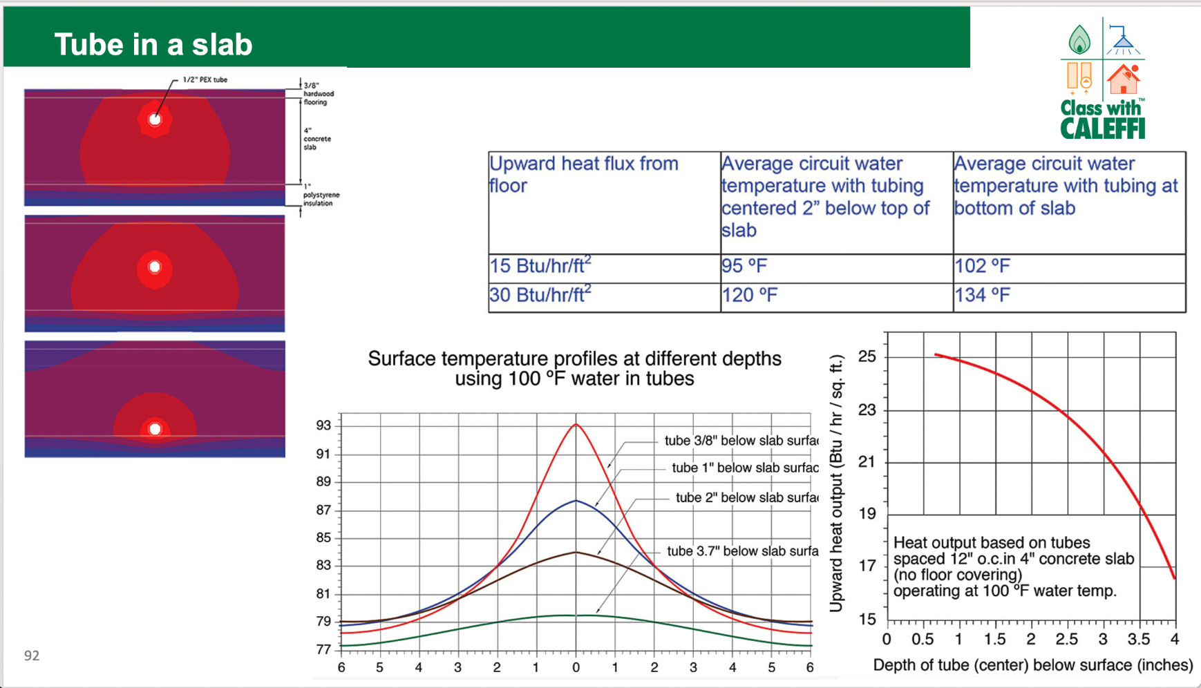

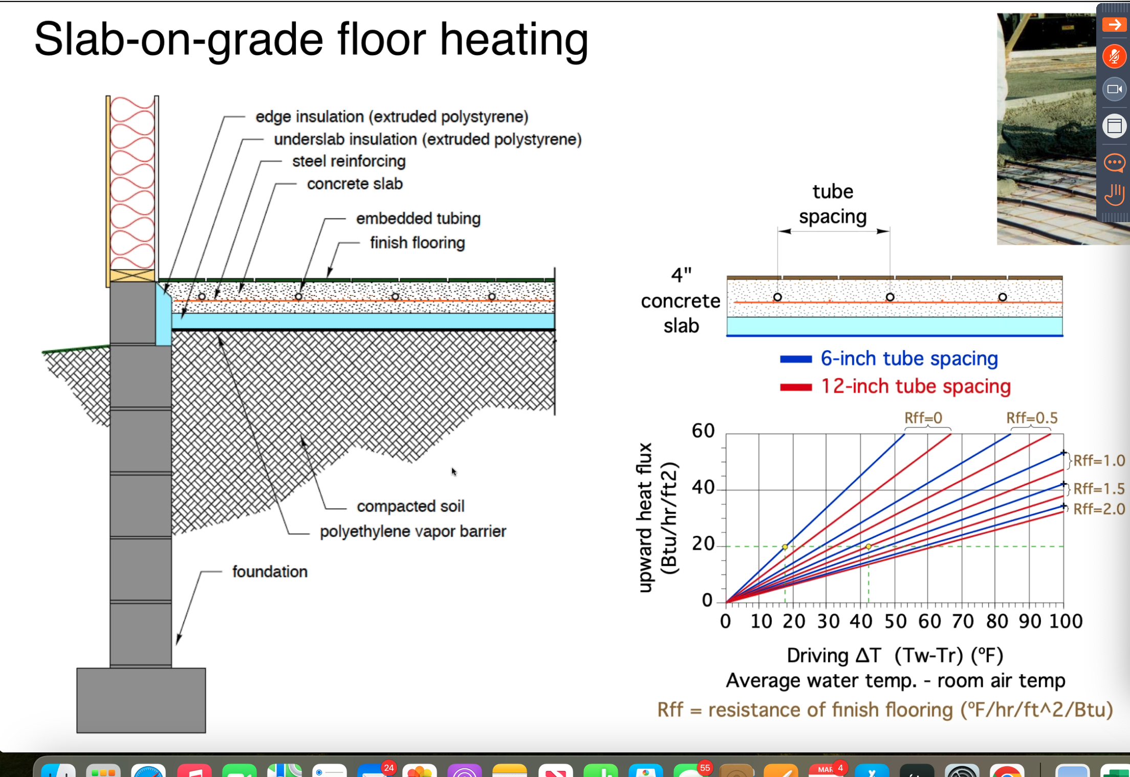

  • Tube spacing is important. Even when 12" spacing would satisfy the design, I would install at 9" to be able to lower the supply temperature to allow for greater boiler efficiency with a condensing boiler.
    For a small job, short loops I would even go 6" on center. 3/8" tube is needed for the best 6" design.
    If it is a slab, elevating the tube helps performace and efficiency, also.

    I agree with earlier comments, specifically to not heat the closets, Utility room, under the refrigerator, enter and exit through doorways, etc. I would also consider instead of the Utility room piping the Bathroom as part of the Kitchen loop since the Home Office loop is already longer, and run it below the tub if possible, and cram as much pipe in both the Bathroom and Kitchen as feasible. Because of the cabinets you have much less floor area to volume than in other rooms so I have run into problems keeping a Kitchen warm — even worse in houses with an island, but with your open plan this will not be so much of an issue — and no one ever complains about the Bath being too warm so I usually wrestle its pipe spacing as tight as I can get it. By making the turns bulbous you can get tight spacing with 1/2" pipe. (Especially if using PE-RT pipe instead of PEX.)

    If your heat load is 9k, why are you bothering with any of this? You are around 9 BTU/sqft, so on the coldest day of the year the floor will be 4.5F above room temp. Won't be cold, but nowhere near warm enough to be noticeable and that is on the coldest day. The rest of the time, the floor will be barely above room temp.
    Your heat loss is low enough that you can even heat the whole place with resistance heat.
    The in-between option for these low load homes is to put in resistance mat floor heat for areas you want extra toasty like the bath and kitchen. Heat the rest with an air to air heat pump. This about the 1/4 of the BOM cost of the hydronic option plus gives you cooling.
