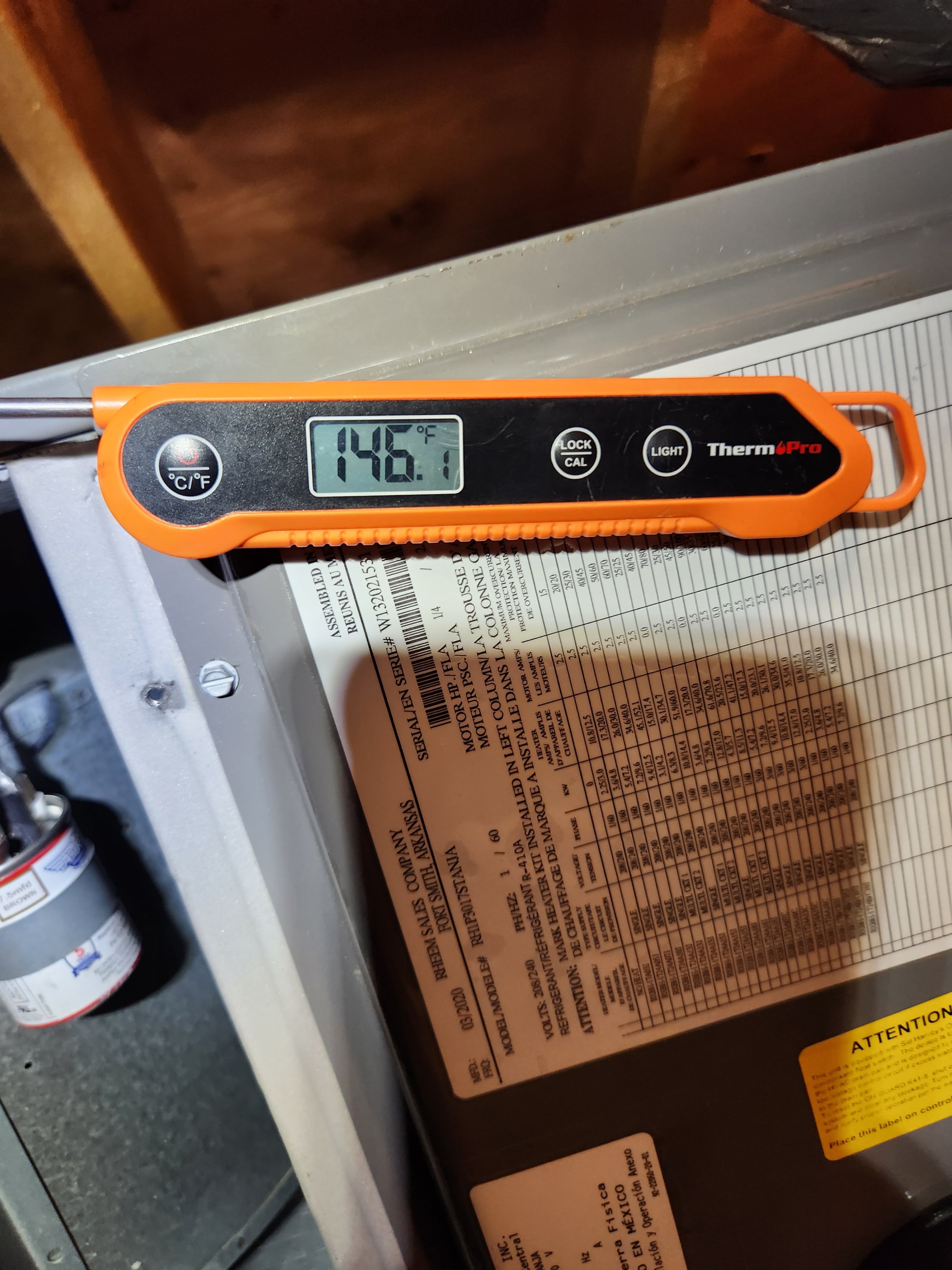

    Sometimes things just happen. July 4th I replaced a 7.5 MFD run capacitor for a blower motor. A very thorough maintenance tech did the annual in mid May. He noted the attic was not ventilated or HERS rated. When I got there about 3 pm on the 4th, it was 146° in the attic. That air handler was HOT! My steaks aren't that hot. A Turbo mini made quick work out of it.
